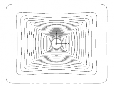

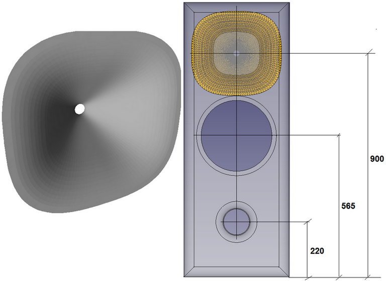

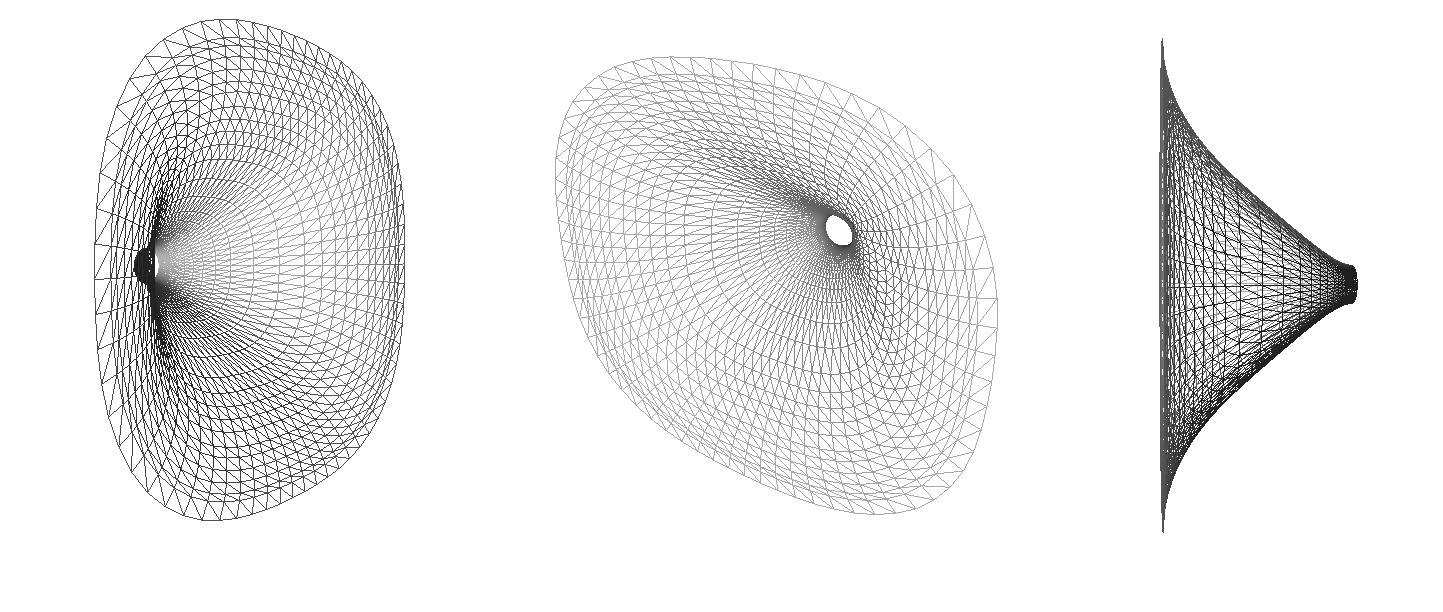

Do you share the drawings of your original design ?
Here is a tessellation of the one that i've drawn, but the dimensions shall not be right...
![](https://nsa39.casimages.com/img/2018/02/27/180227102637235508.jpg)

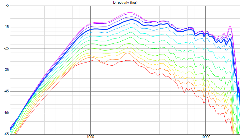

It is small and as such cannot control below about 1500-2000 Hz, which is too high for my taste

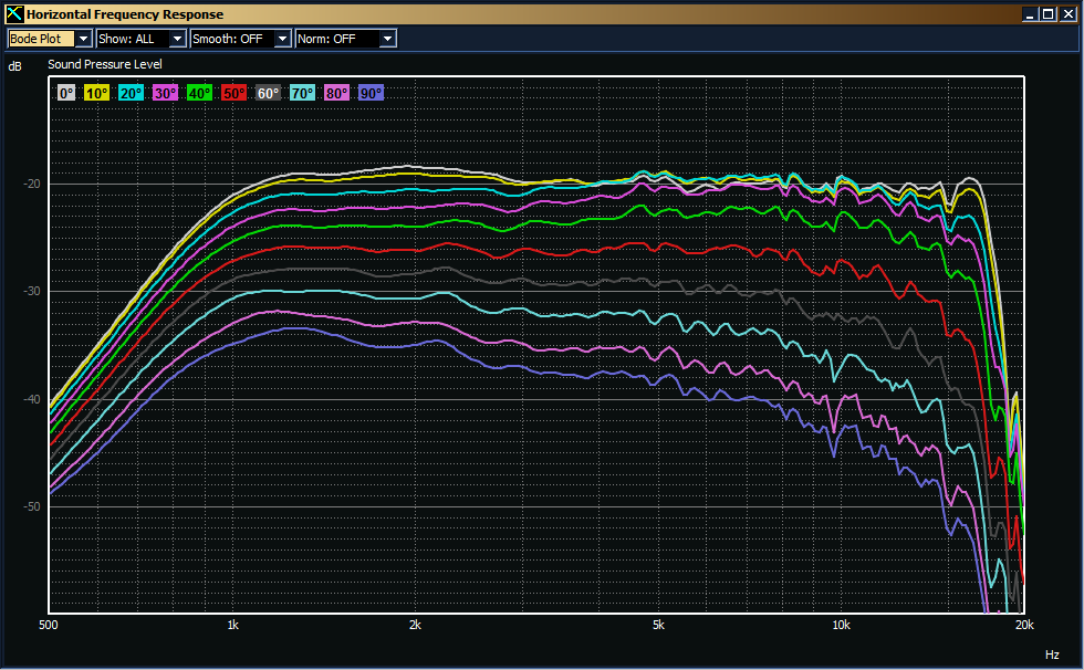

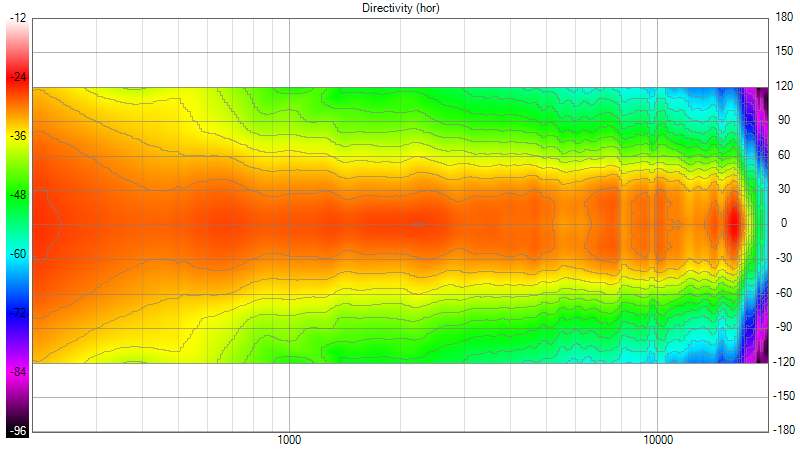

Many people have taken polars that, if I'm reading them correctly, do not concur with this. The 12 and 15 look like they are fine (horizontally) right down to the crossover point.
Seos 12:
At last, the SEOS12 Measurements - AVS Forum | Home Theater Discussions And Reviews
SEOS 15:
My living room "make over" (aka the "surrounded by bass" project) - Bass Gear - Data-Bass Forums

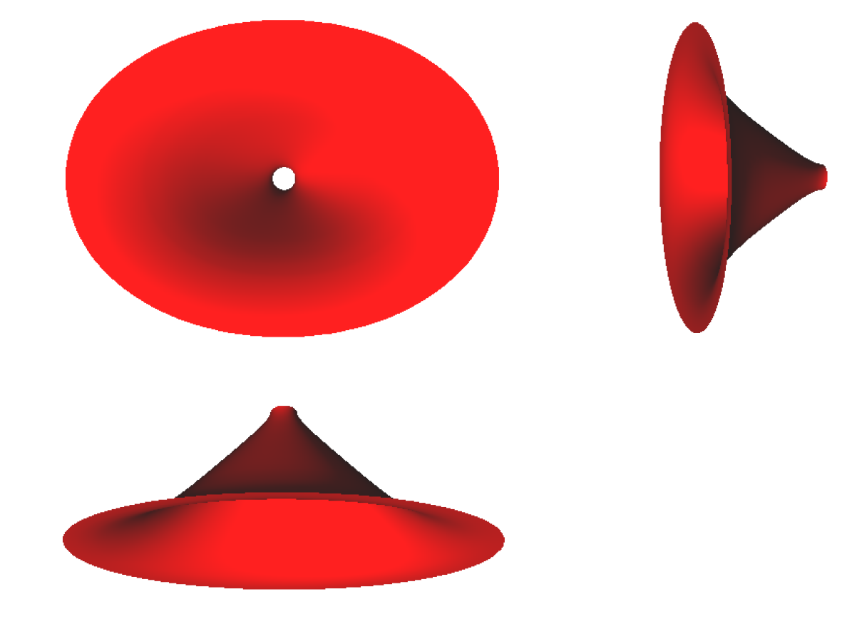

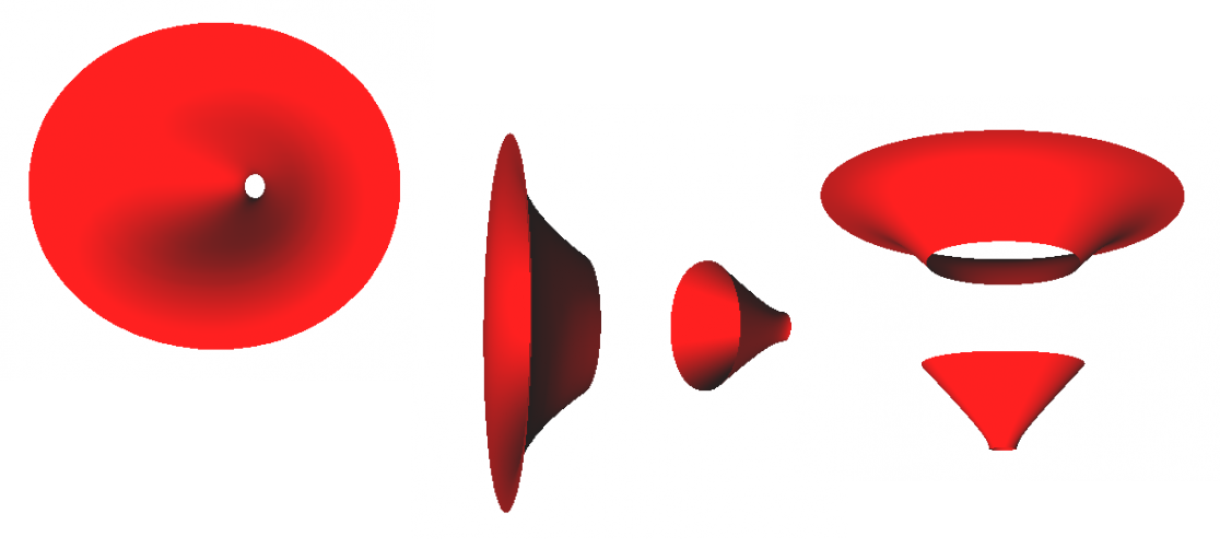

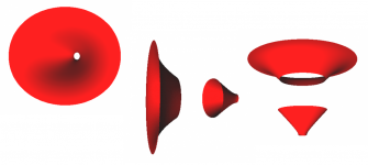

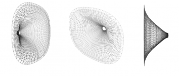

Speaking of different horns, I would like to try this. In any cross section with a plane containing the axis it is a hyperbola terminated by Euler spiral. So it's basically assembled from these two parts. The shape of a mouth can be arbitrary, superellipse seems just fine. If it was a circle, then it would be a spiral-terminated OS. I have no idea how well it will behave acoustically with a non-circular mouth. I've written an utility that computes the coordinates - if anyone is interested.
In the fabrication process a 3D solid generation is useless since the cost requied for a suficent quality part (3D printing) is more elevated than a new luxury car.
A matrix of points in order to generate facets seems more adequate IMHO
What is interesting, when I do this so the overal shape is rectangular, it comes out like this -... In any cross section with a plane containing the axis it is a hyperbola terminated by Euler spiral.
That's what I do. Then a friend of mine can generate smooth surface from these points in Grasshopper/Rhino - not my expertise.A matrix of points in order to generate facets seems more adequate IMHO
