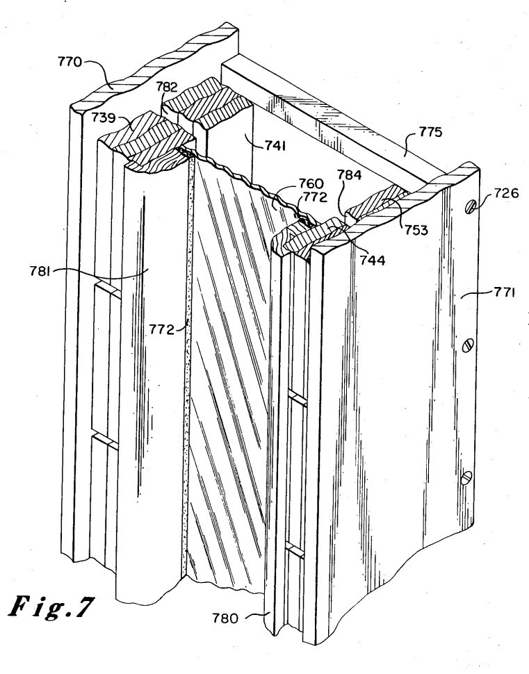

10 years ago Linesource posted this in another Apogee thread:
“I suspect Apogee had 4 reasons behind the Scintilla M-T ribbon design:
1) KEY.. Reduce cost by having only one magnet gap for both the M and 4xTs.
2) Reduce comb filtering by having Ts on top of the M. In the Full Range Apogee the 0.5" wide T was crossed at 10Khz with a 6db/octave slope to the 2" wide midrange, and even physically adjacent this M-T just met a 1-Lambda spacing and not 1/4 Lambda ideal goal.
3) M and 4xTs put 4xT aluminum foil in series to increase the resistance + SPL_area and hence give an easier amplifier load.
4) I suspect the Apogee engineers like the sound of the M-4T cardiod radiation and decided that they could both reduce cost and also provide greats sound even with a simple low order Xover. There were several positive reviews for the Scintillas which describe how coherent the M-T sounds.
If money is no object, I think a separate M and T ribbon is superior with the proper crossover frequencies and slopes.”
I’m interested in what others think about the Scintilla MR/TW arrangement vs the side by side configuration found on the FR and Diva models.

Your mid probably lost its original tension and should be retensioned with its specific gram weight back to spec.
I do not know this models gram weight but calling around to installers or Apogee should get you the Info
If you change to a lighter or thinner foil than stock you will increase foil resistance and might need a slight crossover adjustment
Note that if you decide to retension only, it will take 80+ hours to settle back into mechanical relaxation and will sound bright and harsh
at first until it reaches equilibrium
Laying the speakers down horizontal might show you a tension droop or mismatch between speakers to give you a ballpark
indication or idea that they need retensioning

Hi Muses,
a remark from my side; you say you use a h-frame for under 125Hz. So I guess your Apogees damping foam is degraded and/ or your bass-membran lost its tunes.
If the bass foil hits the frame, it produces harmonic distortions higher in frequency up to 400-600 Hz or even higher.
So maybe you are facing several problems; Mid- and high Ribbons not correctly tensioned and bass foam degraded and foil out of tune.
If the tension of the foil is too weak, changes of hitting bass foil against the frame is higher. Retensioning the bass minimizes distortions that arise from flabby foils. But you need a measurement device and patience.
I possesed Fullranges long time ago and in their original state, I never experienced unpleasent sound, even in original concert volume levels. And that had been driven with their transformers in place.
The Duettas give up long before; the treble ribbons start sounding shrill, if volume gets too high.
If they would be my speakers, I would obtain new mid and high-ribbons and let the rotten foam be impregnated with silicone. Or I would buy new bassfoils and change them by myself, or if money would allow, let them be installed by professionals.
I did this with 3 pairs of Duettas (silicone). The last repair had been most succesfull, because I learned how to fix it.
Front-Side is easy, back-side not so. But is possible.
Today I use silicone&more stuff 5B. Two components mixed 1:1. Once dried, it becomes super soft and dampens the foil very well. It creeps perfectly into the open cell foam. No more harmonic distortions from foil hitting mdf frame.
But it`s some effort and takes patience and a buddy who helps you. I suppose you won`t go this route, but if yes, I can give you hints and tips.
