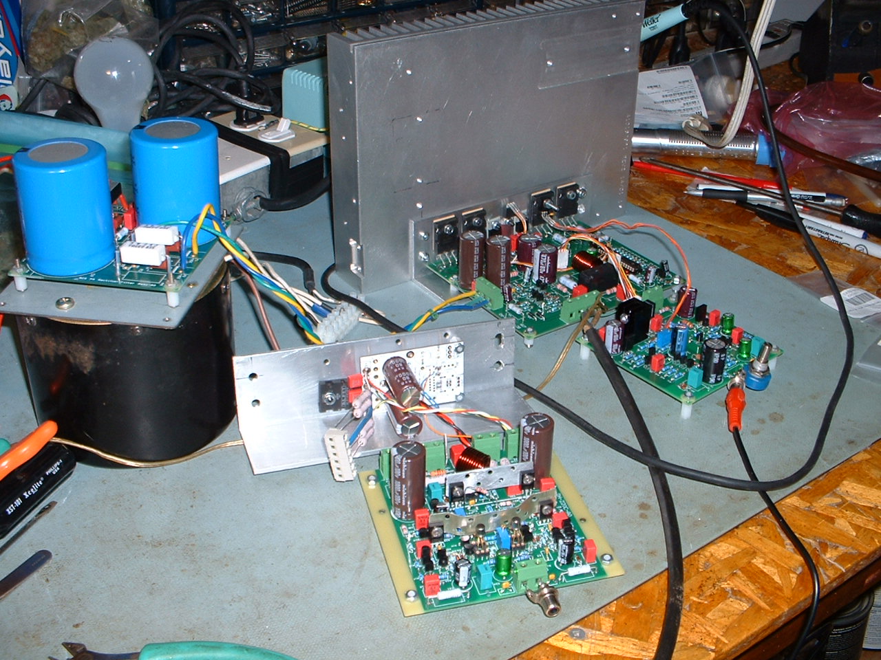

why not start a thread and discuss the virtues of both, I thought that I heard, could be full of it, found the Sansui AU-X "H" bridge was better able to drive the cheap 6x9 test speaker, better bass extension, in free air. why?
On the wiring subject, I can agree with terminating the speaker returns on the amp pcb, star on star grounding, it is working fine, on a amp that I am testing out right now.
I have a lateral mosfet up next for testing, the DH-220C, the pcb I am using to mount the laterals (old OPC LME49830 design), ties the sources, speaker return together, the Hafler design with Bob Cordells mods. I will use a pair of dual die Alfets.
Spent yesterday drilling, taping aluminium heatsink, to make a easy to use testing platform, learning more about working aluminum, part of DIY.

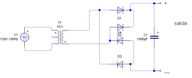

Hi All. I have a question that hopefully someone can explain.
In a audio amplifier we have a transformer where the secondary windings are isolated from the primary windings. If each of the secondary windings go through a there own bridge rectifier and form a 0v line. If the 0v line is attached to safety ground if there was a fault and for some reason voltage was to appear on the 0V line would the current then travel to safety ground.
I think not as the secondary side is isolated but I don't know.
Please help me understand this if it does.
Thanks in advance.
Thanks in advance.
The two windings are isolated and independent of each other. (if it is not an autotransformer)
The primary can not close the circuit to the chassis because you would short-circuit the winding and burn the transformer. There circulates the AC current that is "reflected" in one or more secondary windings. The bridge rectifier and capacitors to filter the ripple have one end connected to 0 Volt (ground) but always through a "load", never directly, it would also be another short circuit.
If I understood your question well .......
Here you can see the same drawn in a different way, and the load (R) that represents the circuit to be fed with the direct current.
The answer is no. It won't cause a short. If the a center tap of a secondary is grounded, does it cause a short? Same for any leg of the secondary. As long as it one and only one connected to ground.

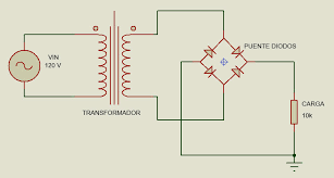

Hi Guys. Thanks for the responses.Here you can see the same drawn in a different way, and the load (R) that represents the circuit to be fed with the direct current.
With that picture in mind and with the Circuit GND point shown also connected to the Earth Safety Ground point. If the wire leading into the load resistor (The positive) was to short to ground. Assuming that your fuse did not blow would it trigger your safety circuit trip switch in your meter box. That is what I am questioning. Sorry I didn't explain that well enough before.
Elemental Watson, if two potentials of a different sign (+) and (-) are not joined by a conductor, no current will flow ...
That's what I was thinking. So what is the point then of connecting the 0v rail on the secondary side of the transformer to the chassis which is also connected to Safety Ground. I understand the chassis connection of the Earth wire is there just in case the live wire from the mains comes off and contacts the chassis but what's the point on the 0v connection?Elemental Watson, if two potentials of a different sign (+) and (-) are not joined by a conductor, no current will flow ...
Scott - I don't follow. I believe Stuart is saying the chassis protective earth is in place from the mains ground to the chassis ground point. It's this your protection? What is the need for a connection from the power supply 0V to the protective earth chassis connection.
