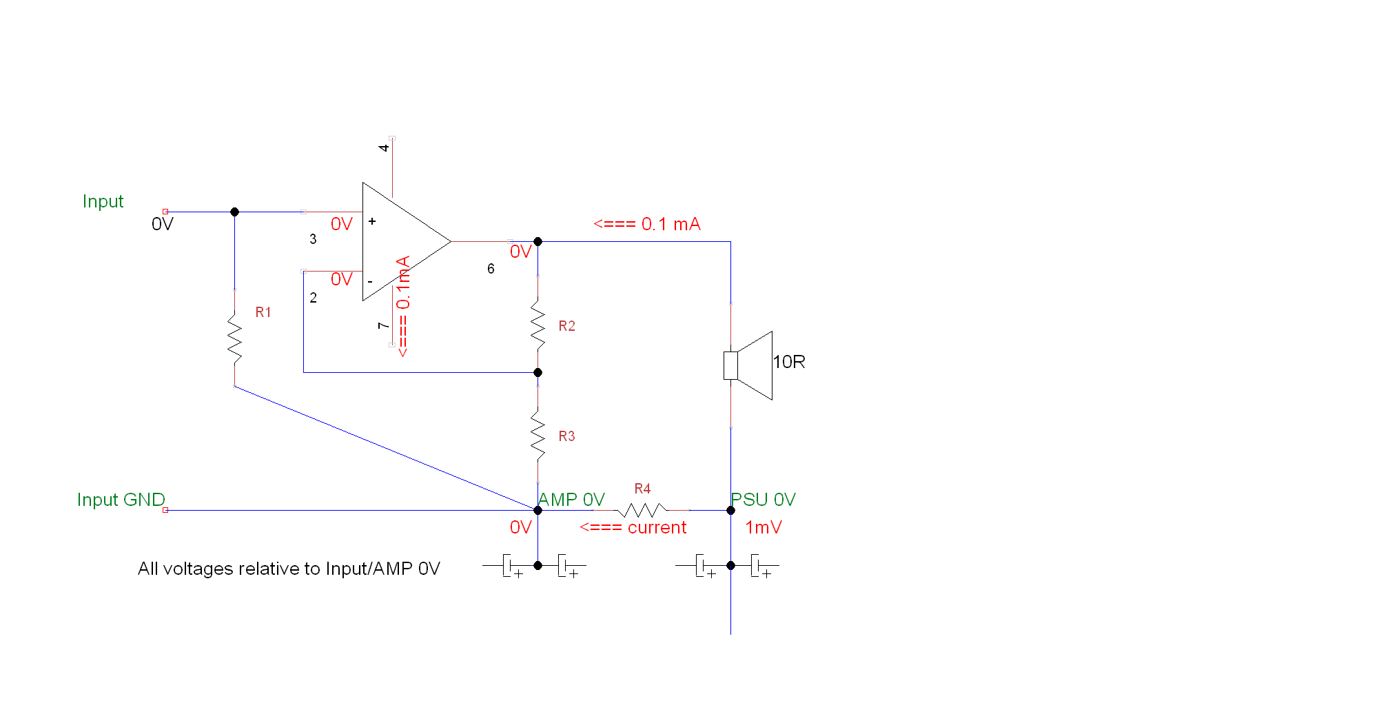

![tCad1feedbackerror1.png tCad1feedbackerror1.png](https://www.diyaudio.com/community/data/attachments/690/690019-419542dccbf2bc20148977338ea49e5f.jpg)
To simplify things, I have set the input voltage to 0V(and the output voltage is therefore also 0V).
The error voltage between power and amp grounds is 1mV, could be any amount, it is just to demonstrate what is taking place.
You will see a current flow through the load, through the amp, back to the PSU to force the output back to 0V. How else do you get 0V at the output?
1. What we want is for the voltage developed across the loudspeaker to be an exact non-distorted multiple of the input voltage.
2. So with an input of zero, the voltage developed across the loudspeaker should be zero.
3. In your example, we have an input of zero, but a voltage across the loudspeaker of -1 mV.
4. How has this happened? It's because current flowing in R4 has developed a 1 mV error voltage...
5. Which the feedback loop cannot correct, because R4 is outside the feedback loop.
Which of these statements do you disagree with, if any? And, which of the equations 1 through 7 in the circuit analysis I posted is not correct?

There is another way to look at this.
The amp keeps the differential input voltage at zero, minus the non-zero error of the feedback loop.
If the input ground is at +1mV, then signal input is also at +1mV, and so the amp will change the output to keep the negative input at +1mV as well. Since input ground is at 1mV and the negative input must be at 1mV, there must be zero voltage across the lower feedback resistor. The only way to satisfy this is if there is also zero voltage across the upper feedback resistor, as any current flowing through this resistor will also flow through the lower feedback resistor and cause a voltage across it. So the output must also be at 1mV.

The feedback loop is from the top of R2 to the bottom of R3. The feedback loop does not care what is going on to the the right of that ie the voltage drops etc across the 0V umbilical.
If you measured from the top of R2 to the bottom of R3 while injecting noise through the 0V return you would see no change in an ideal situation.
If you measured across the speaker, you would see the aforementioned voltage minus the error voltage across the 0 V umbilical.
If you wanted to include the 0V umbilical error, you would have to take the bottom of R3 to the right hand side of it.
Harry is correct on this!

You will not see a voltage change over R2-R3. You will see a change in output current. Could someone please simulate this.
So you agree that the voltage over the speaker is not what it should be. It is output voltage minus the voltage between PSU and amp. And, that the current is not zero.

R4 only exists if loudspeaker return goes to PSU
