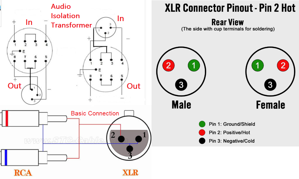

Why?I just ordered a Schiit Modius DAC and it has Balanced outputs. The balanced have different chips and I'd like to compare the two.
So how do I wire the XLR input into my preamp?

The Modius DAC has different OP for the RCA and XLR outputs. I'd like to try them both is the only reason I asked.
Lots of good advice.
Though I made up a XLR to RCA interconnect as per the Neurochromes instructions and it works great to connect my SS balanced pre to my UCL11 SE tube amp.
Easy and effective

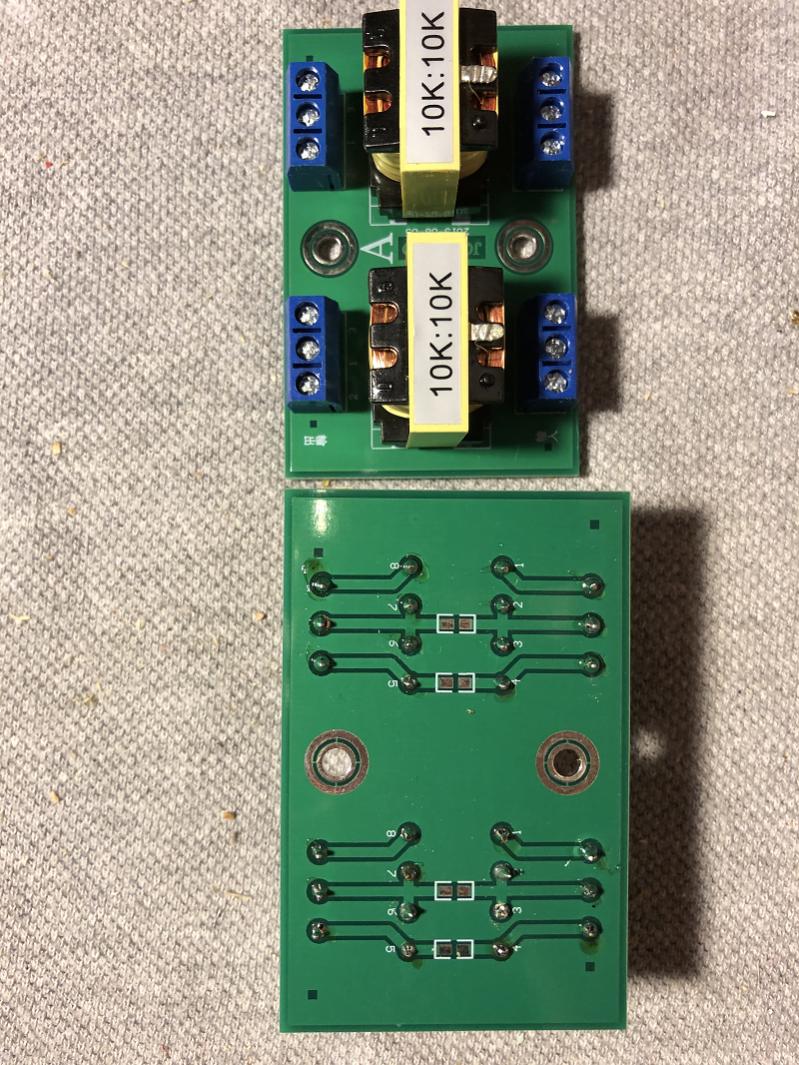

I use the Jensen JTP14-1 for low gain setups and JTP11 for more regular duties. They are essentially transparent to my ears and eliminate all ground noise and loops. Much better than active circuitry, and allows you to get the much better performance from most balanced inputs to your system.
It is necessary to keep them away from mains transformers tho. That can create some pickup that you don't want, though the Jensens ship with a 30dB mu-metal can. Some of the best recordings in the world were made on consoles using input transformers (and some lemons too, FWIW), so if you can use them correctly they are very good solutions.
If you want to get picky about it, you can use any number of active unbalancers, though I doubt any of them will be an upgrade over a decent transformer. The simplest method, used by many boutique builders, is to just use Pin 1 and 2. I really don't recommend that.
The Jensens are $150 a pair and very good for the money. A cheap Chinese clone is also a possibility but having used one such also, I don't recommend it either. They don't yet know how to make a decent transformer.

I am using these. Does sound different? Not really since I run under 3 ft. It's just convenience. I hook up both way, can be unbalanced to balanced and balanced to unbalanced

Pseudo-Differential Cable: Connect unbalanced source to balanced input – Neurochrome
Although I go the reverse, from balanced/differential to SE (UCL11), I wire the interconnect the same way.
