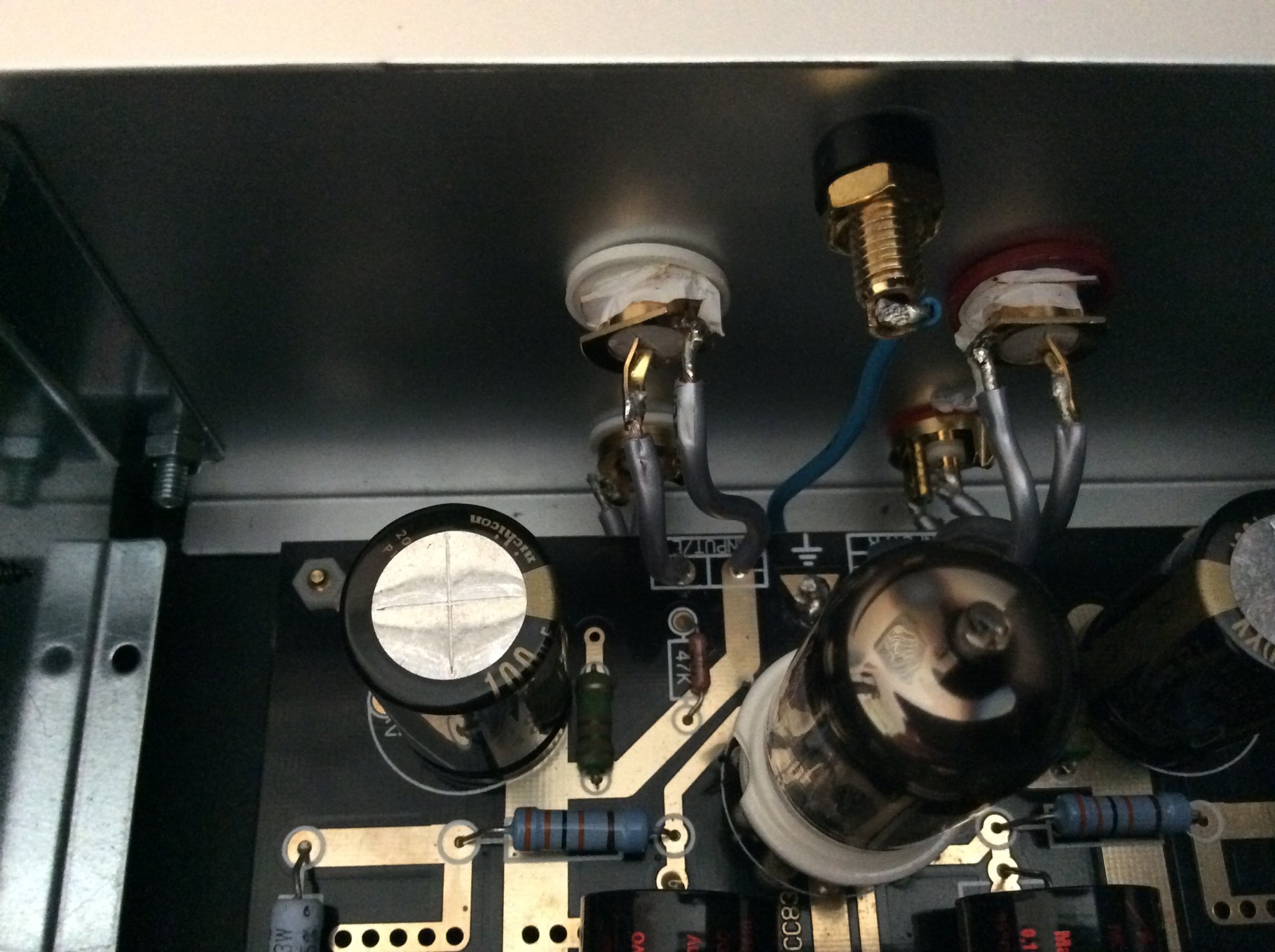

yesterday I placed the transformer outside the box but same result, there was hum + a hiss (I guess because of the wires), see pic and sorrry for the mess :
my rca connections before (it works fine this way with the power supply coming with the kit):
and the rca connections after shorting them ( I guess this is what you refer to when you say "shorten the rca inputs", it's connecting the negative input to the ground of the PCB),
and guess what, the hum was gone but the hiss was still there
so I placed the transformer inside the chassis but I get hum + mechanical hum so I switched all off I'll continue trying this afternoon

Sorry, but "the connecting" is wrong.the rca connections after shorting them ( I guess this is what you refer to when you say "shorten the rca inputs", it's connecting the negative input to the ground of the PCB),
The turntable phono cable grounding lug (between RCA connectors) is tied to the PCB "ground" (whatever it's mean).
Is grounding lug insulated from chassis?
Shorting is means short RCA pins together (hot to cold).
Is RCAs "cold" pin insulated from chassis?
