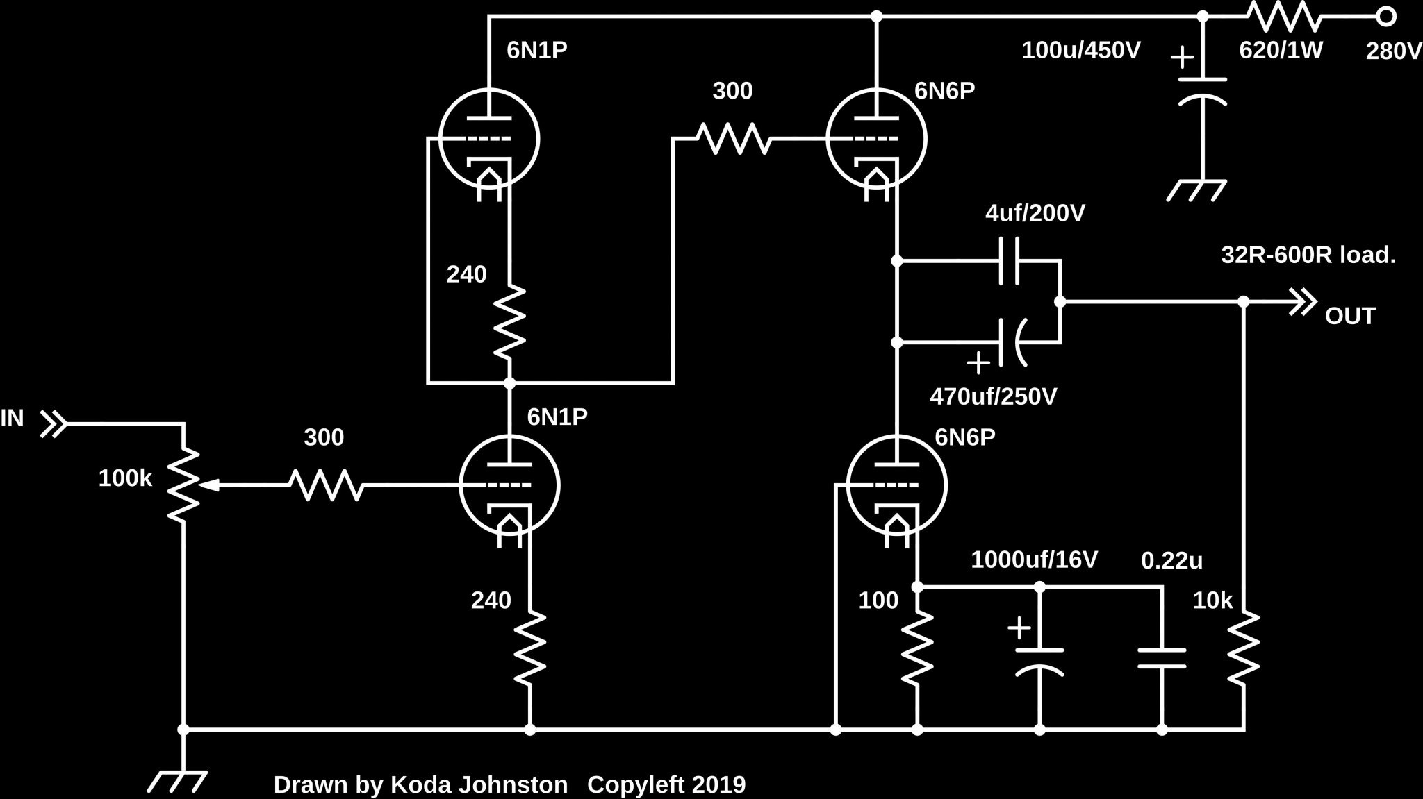

I was living so far with a tiny bit of AC hum with my headphone amplifier - 6N1P-EV input, 6N6P output.
I have a 6.3V secondary, sadly when I had my trafos made couple of years back I didn't think about DC heaters and 9V.
Anyway.. I'm willing to sweat and learn.
How do I best implement a humdinger pot ? Can a multi-turn precision trimpot be used here ?
I'm just looking at one's datasheet: 100 Ohms, 22 turns, 750mW.
There are also 500R, 1k, 5k and 10k variants of the very same type (all 750mW).
I'm already using a virtual center tap with 2x 100Ohms resistors (if I remember well) towards ground the usual way. Not sure what causes that little remaining hum: the tiny differences between the two resistors (which is normal) or can I take the DC balance "done" and I still need to address AC balance ? What do you think ?

Trying to get rid of the increased hum and due to lacking 9V secondary on my toroid i thought a humpot is the way to maybe go below hearing treshold.
(Just for reference, circuit schematics attached for all who're interested).
Any help appreciated.

The new tube is the problem, it is not quite up to spec if the previous one hummed much less. Try another of the same if you can. A hum adjust might not help enough. Get a 100 ohm pot, put pin one to one side of the heater and pin three to the other end of the heater. Pin two goes to ground. Remove the virtual ground resistors you already have, this replaces them. If you have both too much current is being grounded which might cause hum and wastes power which you transformer might not have to spare. A single turn pot of decent quality is all you need. Half watt or more, more is better. Set the pot to the mid point to start out!

Another option is to add a higher value, maybe 1K Ohm or 2K Ohm, pot in parallel to the existing 100R + 100R. The larger value makes it a finer adjustment, so multiturns aren't really needed. This is a good plan generally, reducing DC current in the pot's wiper..

A humpot allows the symmetry of the AC heater voltage around 0V (or an elevated voltage) to be adjusted for more asymmetry to one end of a heater compared to the other end. That can help neutralise the net hum signal reaching a high impedance input grid of a valve - especially an input stage grid. If one side of a heater circuit has wiring that is physically closer to the input grid than the other side of the heater winding, then the input grid receives more capacitance coupling of hum signal from one side of the heater than the other. Most circuits and layout have quite low asymmetry, so a humpot provides no discernible improvement, but every layout and build is different, so a humpot may be able to noticeably reduce that form of hum ingress. That form of hum does not relate directly to how the cathode is bypassed (that is a different effect due to current flow through the heater-cathode insulation).

trobbins you're right.. the suggestion above didn't help so I opted for DC at 6.3V secondary. Just to try it, 6V heating is still acceptable and if it falls below that, that's too weak then (although specs say 5.7-7V).
Anyway, using 4x good-old FR607 diodes (1000V, 6A, Vdrop=1.3V, 500ns) and 3 caps with altogether 18000 uF after it, I got ~8.5V DC unloaded and 6.45V on full load by the heaters. Wow. So apparently I could use my overspec'd 6.3V secondary for DC heating these 4 little tubes, however, without stabilizer.
So far everything is fine but I still need to search because as you told me, hum enters in many ways and it's still there. Insane.
Now I got an advice from a friend: I shall maybe try and change the 1N4007 diodes on the anode voltage side to my pack of Hexfreds from Vishay (600V, 15A, 23ns). Since the charging time for capacitors are short with Graetz bridges, it's important not to use slow recovery time diodes and now the 1N4007-s are really slow with their 1.5 us rating, that's 1500 ns compared to the Hexfreds' 25ns.
The heaters have the FR607 diodes now, providing DC.. 500ns.. maybe I'll swap them too.
