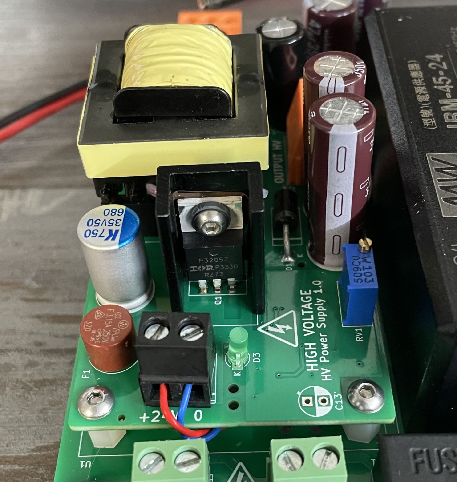

I tried another heatsink with a sheet of Thermalfilm for the MOSFET. I find it more effective than the Chinese heatsink. The temperature stabilizes at 48/49°C for a room temperature of 27°C. Tested à 350V/61mA.
There's more space between the heatsink and the transformer.
Stef.
Same Sky HSE-B2111-038
Mouser: https://www.mouser.fr/ProductDetail/490-HSE-B2111-038
DigiKey: https://www.digikey.fr/fr/products/detail/same-sky-formerly-cui-devices/HSE-B2111-038/7319795
