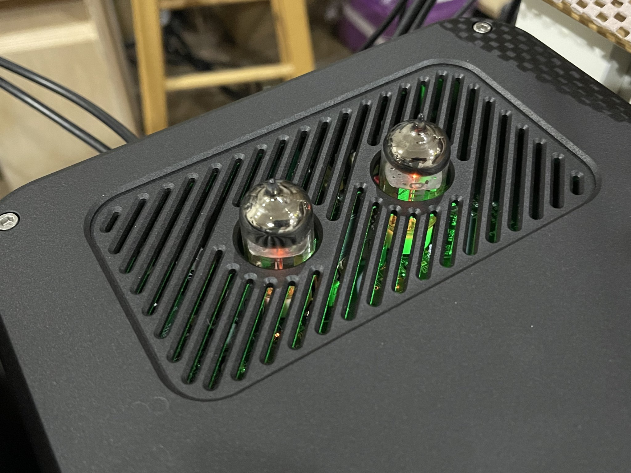

A new ventilated top panel is now standard on the second production batch. Looks cool and lets the amp run cool. 🙂
