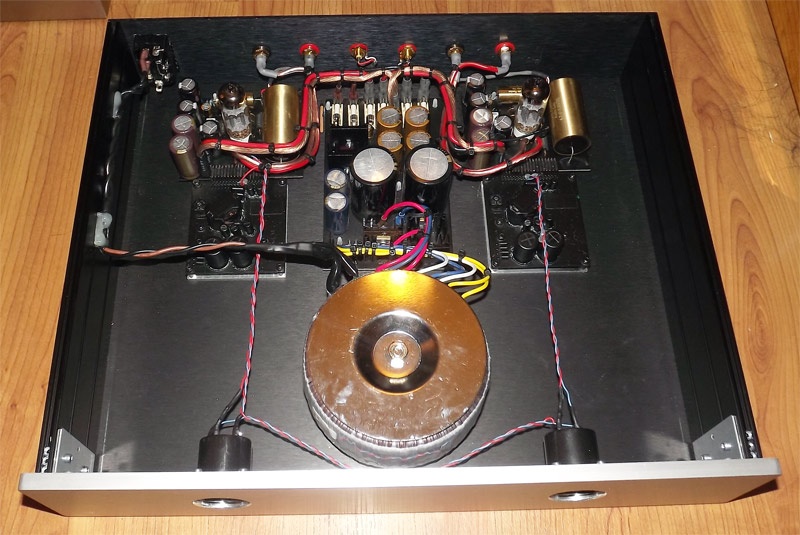

I remember your work with the UCD modules 🙂 !

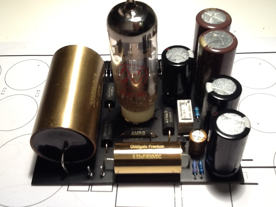

You use a very linear tubes ? or one made for its "thicker" sound signature ? JJ, certainly not choosed by luck
Wel done too for the Obligato (and it's cheap) . You sold a populated pcb, a cheap non populated one, or nothing ?

When using opamp inputbuffer i prefer the LM4562. Combined with SMPS you need good voltage regulator like HXR or TPS. If not you mesh up the good sound. With linear supply LM317/337 is good enough.
You mean you tried the 2604 already for its smoother signature ? LM4562 is neutral if I remember.
I like the idea of the tube : less stages than an oap... I talked also about this one above : OPA1602 | Precision Amplifier | Operational Amplifier (Op Amp) | Description & parametrics !

I have build/tried a lot of input buffers for hypex UCD oem. Lm4562 is just right for me. The difference between opamps is very small. Therefore i build the opamp input buffer with a dip8 socket so customers can try out several opamps(AD827, LM4563, NE5532, TL072).Difference between tubes and opamps is bigger.
Personal i use unbufferd Hypex module. My sources all have 9Vrms output voltage . In between i have passive volume control/ input select. I have good experience with less parts is more sound.
