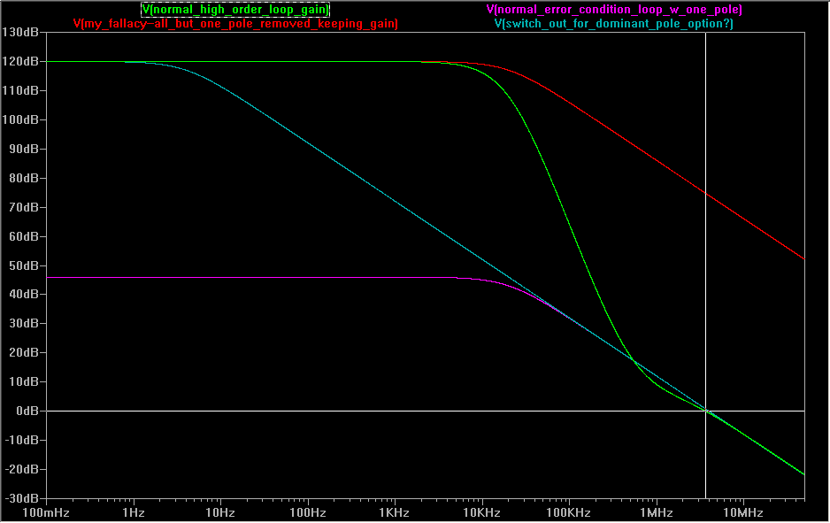

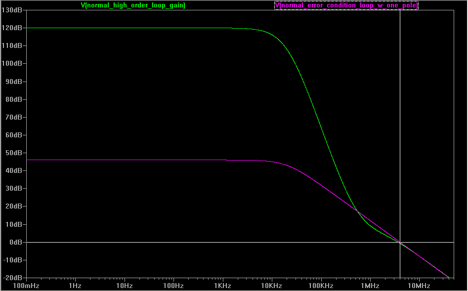

Bruno,
To clarify my confusion:
That the gain is also eliminated was the more difficult realization.
In the following hypothetical example, I now understand that the stable circuit would move from the GREEN 4-5th-order loop-gain to the MAGENTA first-order loop-gain (when divergence/error is detected.)
When I imagined "simply remove a few poles from the loop", I pictured the RED trace in the following graph. I intuitively understood the zeros were also eliminated, but I thought the remaining pole would be working on the same large gain. Clearly the RED loop-gain would be a disaster.
I also wonder if an alternate approach, switching in a dominant pole and switching out the high-order circuit (BLUE trace), is another potential solution.
If I'm "off in the weeds", please let me know. Otherwise, thanks again.

Bruno,
