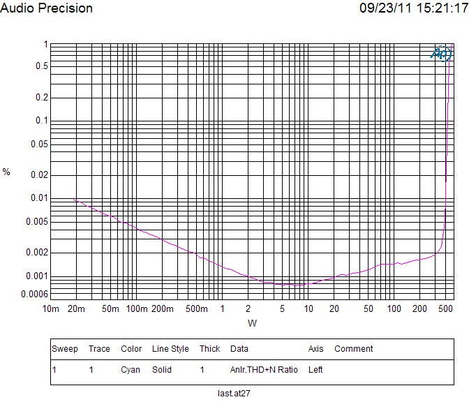

Hello Bruno,
Nice specs! Did you by any change measure "THD vs Frequency" for lower powers (1W, 100mW, 10mW) The plots for 10,100 and 250W are less handy for a guy like me with a high effeciency speaker (Geddes Abbey clone)
I can see from the "THD vs Power" plots that it looks excellent for the frequencies shown, but I would very much like to see the complete picture...
Many thanks,
Wim

?? The graphs at Hypex give THD specs down to 10mW output. Clearly the ncore has excellent behavior and a sensible bandwidth. At power output below 1 watt (perhaps much higher in this case), noise will swamp distortion (I expect noise is the cause of the steady slope to the left of 5 watts output in the graph on page 4, labeled "THD into 4 ohms at 100Hz (blue), 1kHz (green) and 6kHz (red)")....Did you by any change measure "THD vs Frequency" for lower powers (1W, 100mW, 10mW) The plots for 10,100 and 250W are less handy for a guy like me with a high effeciency speaker (Geddes Abbey clone)...

This only shows 3 distinct frequencies, I would like to see the complete frequence responce.
I agree it will be higher, but I would like to see if this is caused by noise only, or there is something else also.

Why would I need something else? Total unweigthed noise of the ncore is 24uV, and all other specs look fantastic also. I just would like to see if anything changes in the low power region...

The plot you're asking for would be a set of horizontal lines because the analyser would see only noise. The high power THD vs frequency plots were taken to show that at other frequencies THD remains roughly at the level found at 1kHz. If you look at the FFT spectrum at 1W you see that distortion is already quite far down. The spectral composition remains the same at other frequencies. Distortion at 100mW and 10mW is below the distortion of the AP's generator. I take it your question is: does this amplifier do anything unexpected at power/frequency points not in the data sheet? Answer: no. The three THD vs power plots and the three THD vs frequency plots are made to give a representative cross-section of distortion performance and you can safely interpolate between them.
I should add that also at these low powers Ncore has way lower distortion than esoteric circuits purportedly invented specifically to have good low-power behaviour. When some designers (I saw a name flash by just now) claim their amp is "best below 1W" this simply means their amp gets steadily worse above 1W, not that below 1W it does better than any other amp. Of course they want you to think they're saying the latter. This is called the "bait and switch" fallacy. Don't fall for it.

Thanks for your answer. Now I cannot wait until I can buy some of these modules

Just a quick update to say things are still moving on the NC400 front. The whole discrete shebang (regulators, op amps) is working OK, the power stage seems to do its job as well. Modulator (unloaded) linearity took some tweaking. Attached pic is the THD vs power at +/-65V (Apologies for the colour).
Is this plot directly comparable to the one of the datasheets of the UCD400HG etc ?Just a quick update to say things are still moving on the NC400 front. The whole discrete shebang (regulators, op amps) is working OK, the power stage seems to do its job as well. Modulator (unloaded) linearity took some tweaking. Attached pic is the THD vs power at +/-65V (Apologies for the colour).
If so, very impressive !
