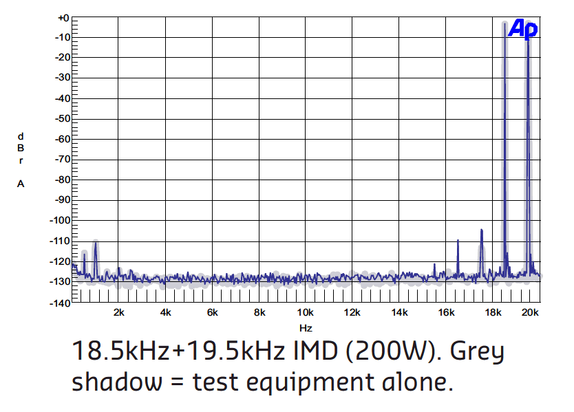

Bruno, although you somewhat covered it already (you basically said that good IMD performance for the input below 20 kHz range most likely results in good-ish IMD performance for the input within the power bandwidth), it would be really interesting to see the results of actual measurements.

what measures? continuous signal with fft?
apart from that, listening to the problem is immediately apparent.
I remind you that we are talking about a high end amp, not a PA.
an audiophile feel immediately when the voltage moves. this is perfectly measurable by other measures (dynamic).

One can certainly infer that good IMD performance readins just below 20k most likely would translate into reasonably similar performance above 20k simply based on common sense and on the fact the 20k boundary is in fact arbitrary, but the actual measured numbers would be cool too.
People talking of fast bass and taking a snare as an example when discussing THD and IMD belong more to the highend charlatan camp than to the engineering camp IMO.
Keep in mind that most amps - switching and linear - don't have as much feedback as the nCore and almost never does it stay at these levels within the audible band. Most amp's perfomance starts to worsen way below 20 kHz. So accusing Bruno of optimising the sub 20 kHz range at the cost of > 20 kHz is definitely quite naughty (to say the least).

Tell me, how would you achieve low IMD if you do not have low THD?
