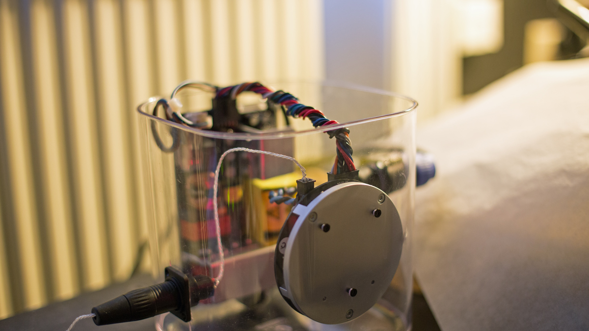

But when connecting a single end source as described in manual we get a lot of hum/buzz. But no DC. At this time there is no chassie for the nCores so I can't do it exactly acc to manual but source ground to cold and + to hot. Nothing to "pin1".

I suggest you try to connect the inverting ("cold") input and the input cable shield together at the input end of the nc400 input cable.

my experience XLR pin 1 needs to be connected to ground return of the source component, and the shield wire of the nCore module for there to be no hum.
If I had to connect a single ended source, I would wire the XLR jack as recommended by Hypex: Pin 1 to chassis, then shield wire from nCore module to chassis. Then I would make an RCA-XLR cable with sheild tied to pin 1 and RCA G, pin 2 to RCA hot, and pin 3 to RCA G.
You can test this without a chassis by attaching the sheild of the nCore module to pin 1 of your XLR jack, I think you will have silence if that sheild wire connects to your source G.
Also, have you confirmed that your source has <50 mV DC, make sure, as the nCore is DC coupled and cannot have significant DC on its input.

In any case, to be clear - the inverting input and the shield of the nc400 input cable should both be connected to the ground of the input at the point where unbalanced becomes balanced.
So you don't have anything to drain earth currents?
Pin 1 needs to go somewhere or you've lost the reason why balanced (xlr) gives benefits
Connect it to the screen on the nCore input cable
Which in turn connects to ground at the amp
If you look at the data sheet you can see this is what is recommended, except that the diagrams assume the case is conductive. So with a conductive case the connection between pin 1 and the screen of the input cable is via the case
OK I need probably to spill it all. My pin 1 in the XLR input connector is connected to the earth and the ampon in the input connector of the nCore. This gave actually 1,7-2,4 V DC on the output when pin 1 was connected to Cold. (pin 1 to Cold gave the DC with or without the preamp connected).

The XLR Pin 1 in a balanced analog audio interconnect is a shield not a ground. This shield is always connected to the chassis at the send end, but it is sometimes not connected at the receive end. Other times a hybrid connection is made at the receive end using a series capacitor (or anR/C network).So you don't have anything to drain earth currents?

My nCores has XLR Pin 1 is not connected because I have no conducting chassis.
Tie XLR pin 1 to XLR shield/frame (all or most XLR have four terminals, one of which is XLR shield; there's no reason not to shield both the XLR plug and jack themselves regardless whether or not amp chassis is conductive).
Following the above instructions, for conductive chassis, unless paint or anodize prevents it, XLR pin 1 carries source shield to XLR frame then to the entire chassis, either via direct contact jack-to-chassis, fasteners, or both.
Please forgive me for this correction, meant only to promote the use of common audio terms which are easily identified and seldom confused: "load" and "source."
For NC400, Hypex tech instruction was to tie XLR pin 1 to shield of XLR jack. IOW this is sole correct wiring instruction, not optional, though other components may wire differently as you state.
OK, just to be clear - you have the shield of the nc400 audio input cable (and the nampon input lead) connected to the XLR pin 1, with non-inverting input to pin 2 and inverting input to pin 3, right?
So how is your source connected? With a RCA-to-XLR cable? Or some XLR cable you have made yourself? How is it wired?
