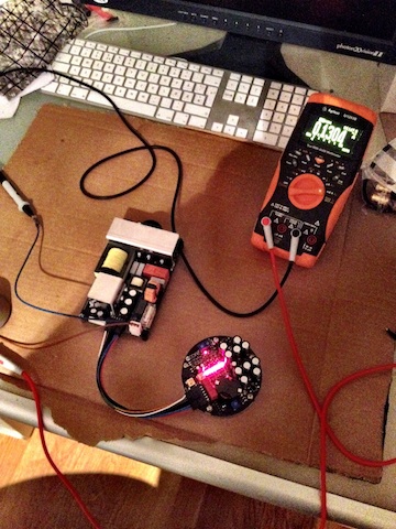

just took a brief look. no-one mentioned the MCU yet. does it have temperature monitoring too? that would be nice.
The firmware flow chart fell off somehow. I'll fix that one of these days. The temperature monitoring is briefly mentioned in chapter 8.
Something not mentioned in the data sheet is that the MCU logs errors. Nothing much but things like "amp turned off because of overvoltage/undervoltage/overtemperature/overcurrent etc" plus the associated readout.
