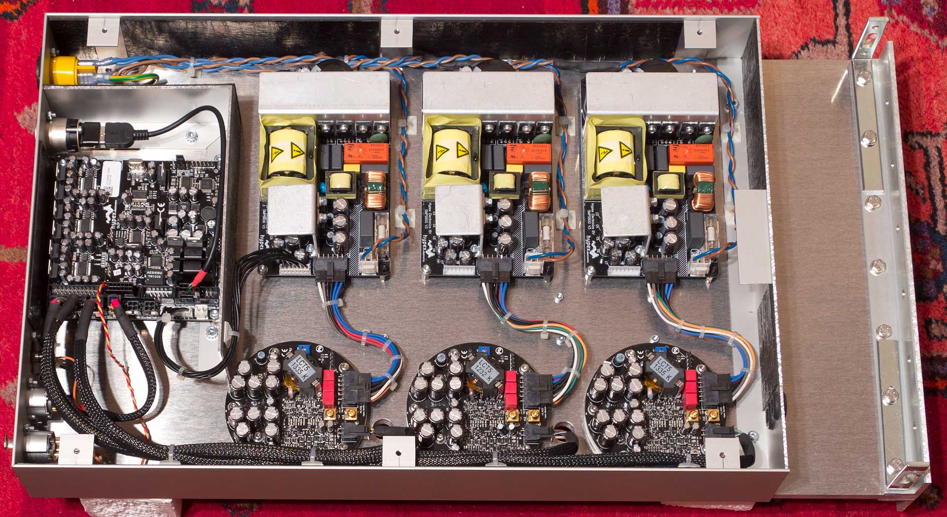

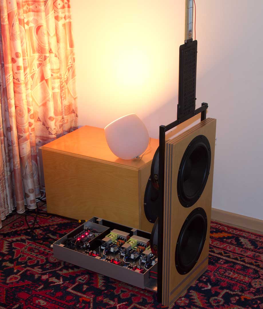

With regards to the placement of the modules and power supplies, here're two pictures of my system:
The base plate is 10mm thick aluminium. I wired the drivers directly to the amps to minimise the contact resistance and preserve the benefits of the extremely low output impedance of the NCore modules as much as possible. It also saves me the hassle of figuring out what connector to use and no connector is as good as no connector.
The system is totally quiet, you need to press your ear against the mid to be able to hear a faint noise and it's just noise. There's no hum, whistling or popcorn noise at all.
In case you're wondering why the amp for the tweeter has a separate power supply, the tweeter is a direct drive ribbon with a 2Ω series resistor.

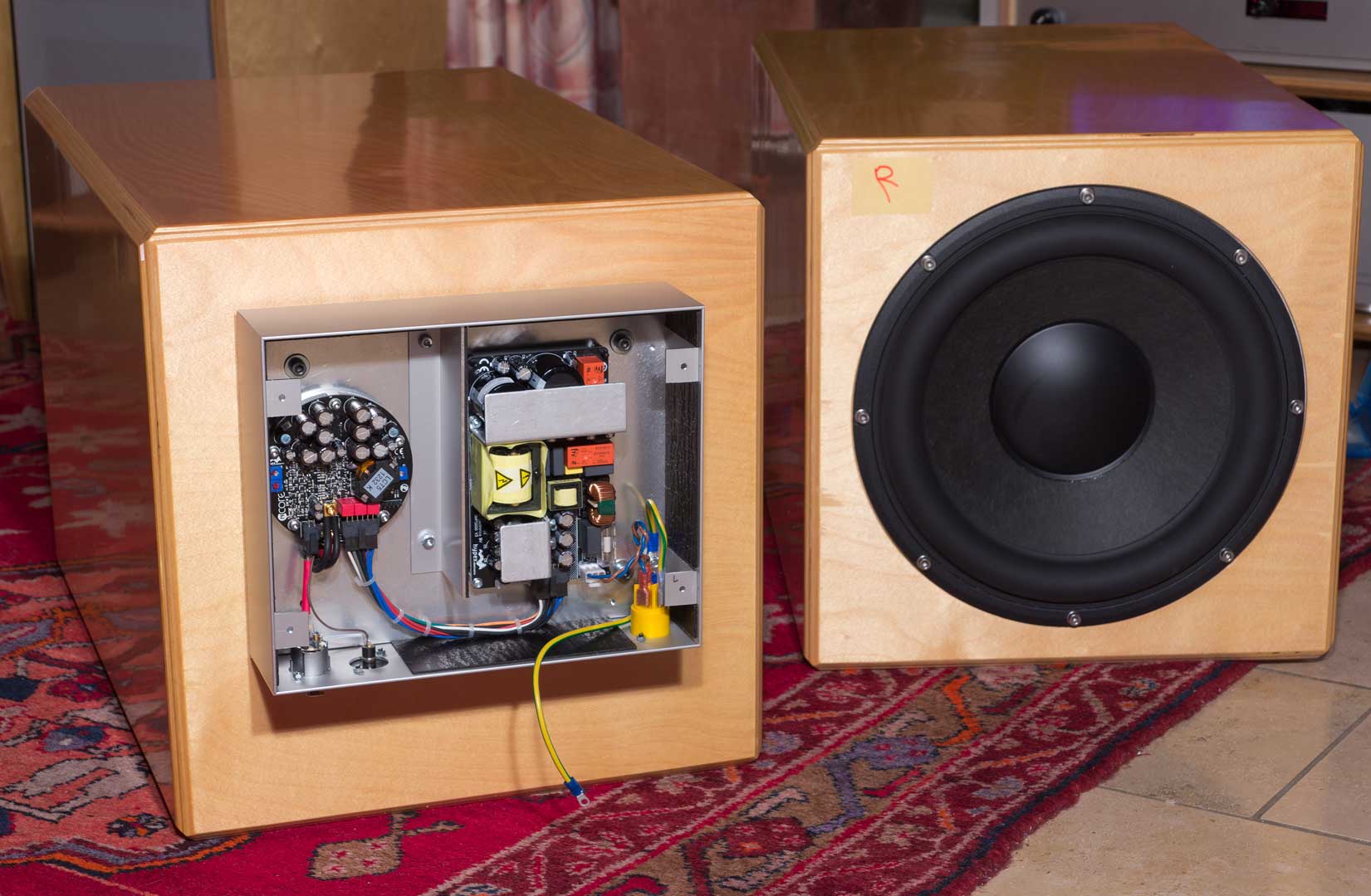

The subwoofer with amp:
![subs-front-back.jpg subs-front-back.jpg](https://www.diyaudio.com/community/data/attachments/506/506360-8f7b96e5c8c778f01af00ef4c3649817.jpg)

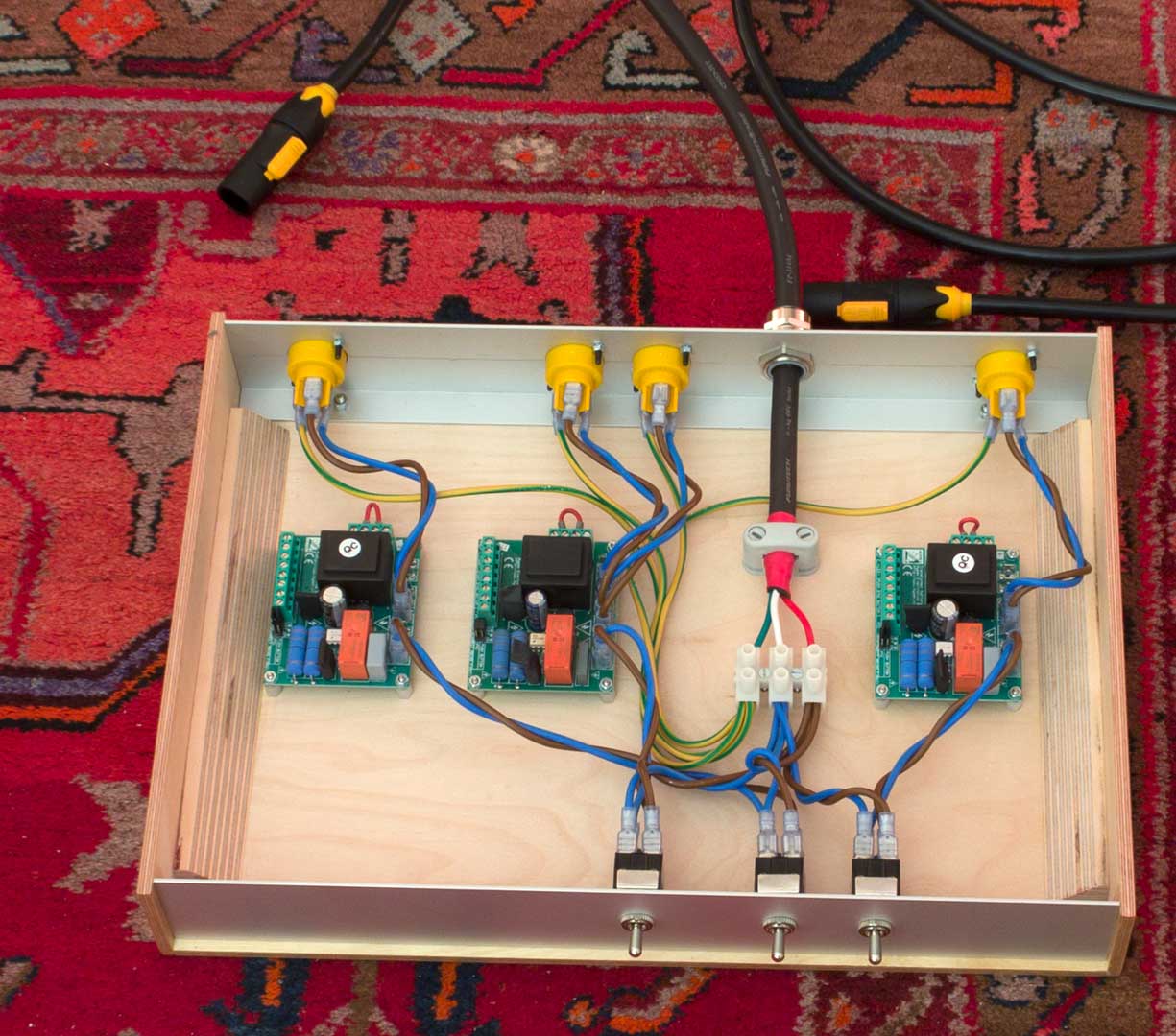

To power on the system I build a simple switch box with three softstart units as I found that switching on three SPMS modules simultaneously trips the circuit breaker in my house.
![softstarts.jpg softstarts.jpg](https://www.diyaudio.com/community/data/attachments/506/506356-192314e222cb2e4fd8d762c0f7344526.jpg)
The NCore modules get the amp-on signal from the DLCP, this provides for a click and pop free startup and shutdown. Well, actually there's a lot of clicking going on at startup but that's because of all the relais in the power supplies. I like the steampunk feel of it
In case you're wondering, the Furutech mains cable is leftover from my audiophile days. Nowadays I just use decent mains (Belden) and signal (Mogami) cable with Neutrik connectors.
