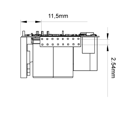

https://www.hypex.nl/media/54/e3/8c/1645786771/UcD180LP_OEM_R12.pdf

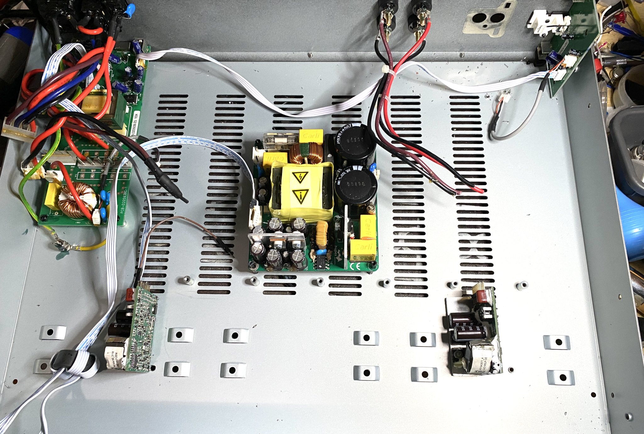

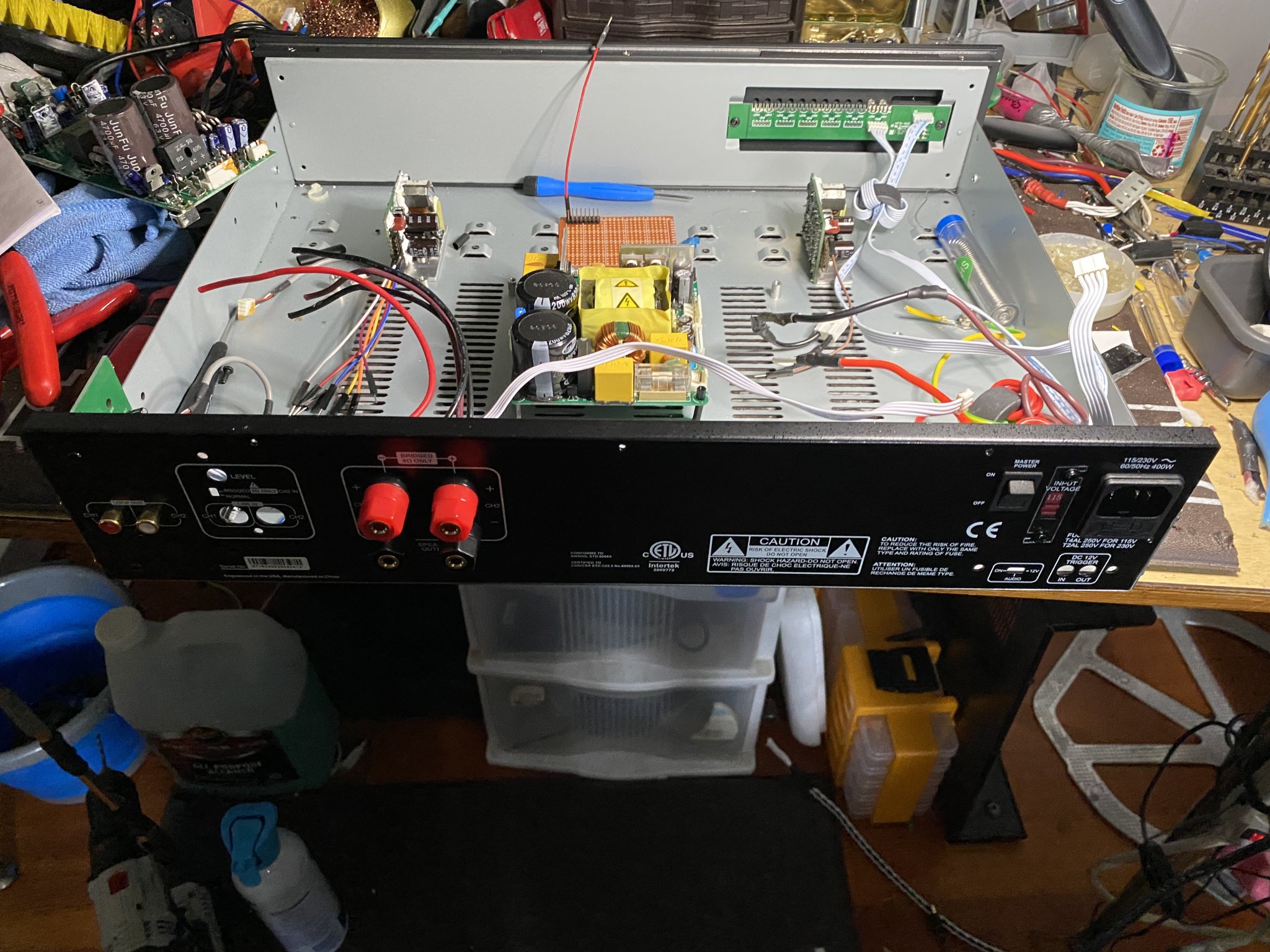

SO i bought a Power Amp chassis and gutted it, got it super cheap and its in mint shape. An episode EA amp originally. Heres how Im moving along.. Got some prototyping board and was going to riun the leads from the 16 pin connector of each to it and then combine things.
'I am confused as to how to wire this single ended. This amps been a chore. I hope its worth it in the end lol. I have the 180LP Oem 16 pin. Ive run jumper wires form the 16 pins to a protoype board to try and tie stuff together as well as to a Power distribution break out. What ground am I using as in what pins for RCA input? Also is there not supposed to be the earth ground attached from the AC input? IM reading mixed discussion on that.
My advise is the following: try reading again and more carefully what Hypex itself suggests, may be you shouldn't read too much further.
At that point the relevant chapter seems to be 5 Connections.
