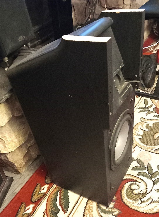

I CHOPPED my Dayton sub to make a Guitar Speaker Cabinet!
I used this sub a few times in the early 10 - 12 years I owned it. Divorce time my ex and her friend werent very careful loading it into my pile, so no chance of selling due to chips and surface scratches. Used it in an early iteration sound system here, until I went to OB and V instead of P wave bass. Been down in the garage ever since, never hooked it up to the system there. Sooo,, rather than build a new construction -

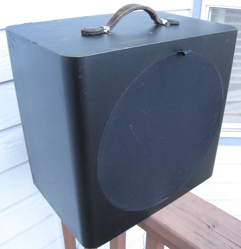

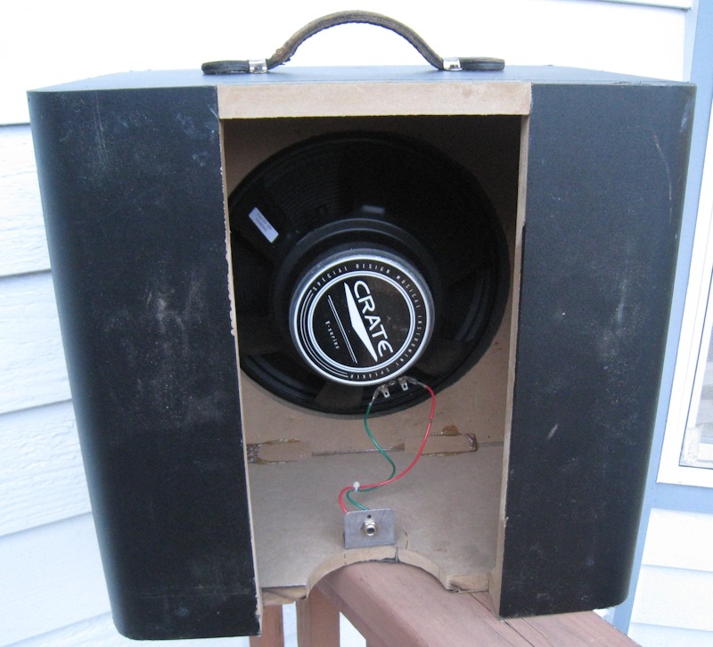

I glued the two back pieces in place, where the rear aperture ends up vertical. Cut to save the original radius. Size is basically the ample shelf space the amp chassis needed on top. I'll probably fill the notch, as I have plenty of wood there left over.
Handle on top, some rubber feet for the bottom. Coat of paint - wish I had the paintable tolex stuff on hand - and should look fine for me. I have the round grille for the front, held in place by Velcro. Granted, it's a lot heavier than a pine board enclosure....

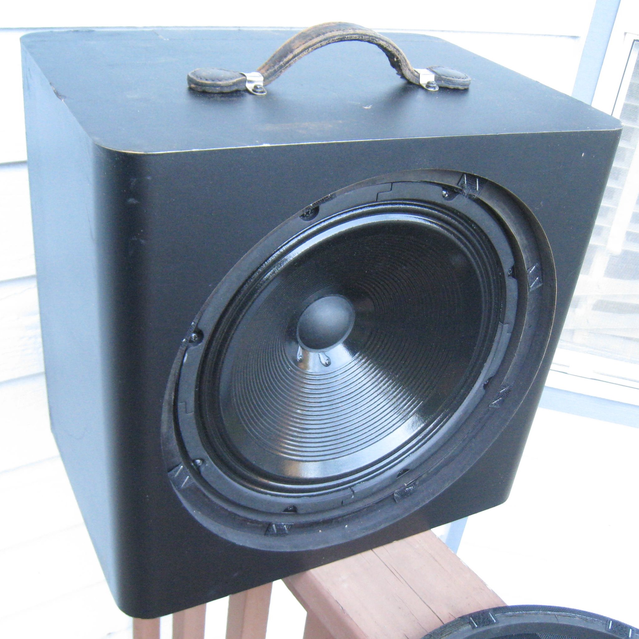

Final form for now - until I get to the store for some nicer paint. The Crate speaker arrived today, in as-new condition. Complete cabinet weighs 26 lbs; something I can still handle ;')
The shiny stuff on the cone is interesting. "Every driver comes with our exclusive Cat Spray Protection - just wipe with damp cloth! Only from CRATE!". Or Beer spray...

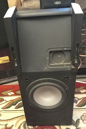

I repurpose the lf section of my old Martin Loga Aeons into a pair of subs and sued a Dayton Audio DSP-LF to equalise them.
I need to finish them but struggling to think of how!!
The drivers have a 35Hz free air resonance and 57Hz in the sealed box. In the Aeons they worked upto about 400Hz but now only needed for upto about 140Hz.
Cone weatherproofing. It does tend to affect the breakup modes, so will have some impact on the tone. Doesn’t add much mass but does make it a little stiffer. The breakup rise will start at a higher frequency compared to without, but typically go higher in amplitude.
Where is the amplifier going to sit? Inside the box somewhere?
