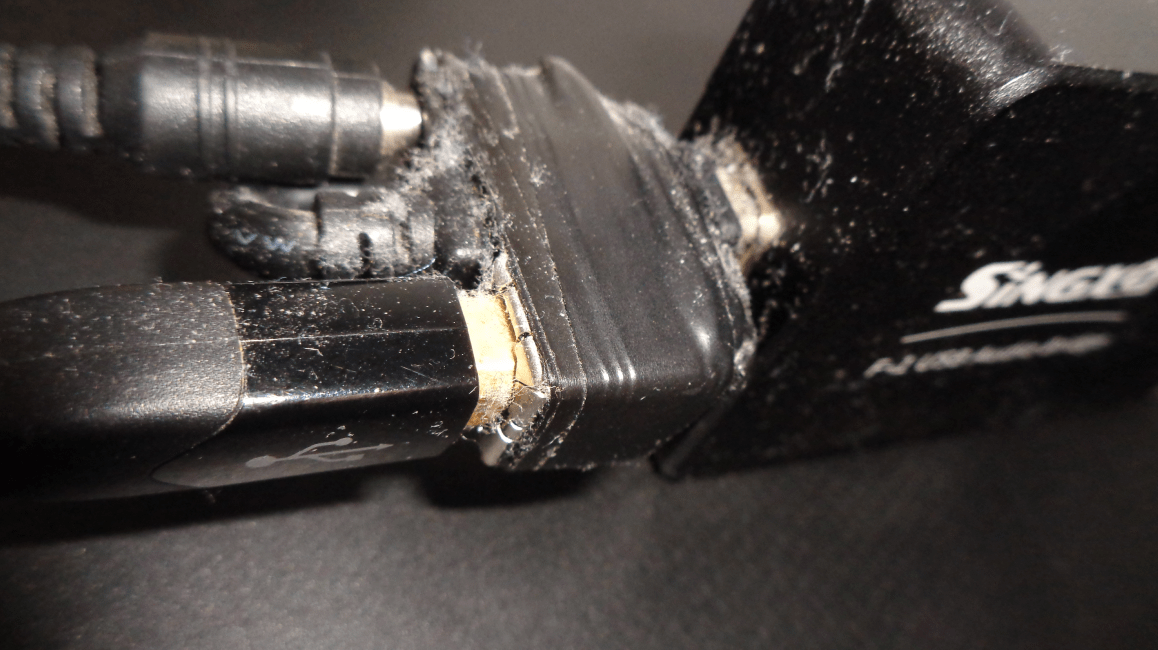

Some devices will not work, because Vbus is used not only for power but also as a signal for "connect/disconnect".you can also just disconnect vbus
To put a resistor at GND is not a good idea.
yes some devices use vbus for detection or even powering the usb sectionSome devices will not work, because Vbus is used not only for power but also as a signal for "connect/disconnect".
some are happy with only gnd and even this isnt "really" needed in most cases but just so your dac initally connects
connecting ground over a resistor gives you basicly the same potential and a way so your dac connects normally but isolating gnd "further" without galvanic isolation
if you use a external power supply you need to directly connect its ground to the dac, the resistor needs to sit between dac/power supply and the pc
as far im concerned there is nothing wrong with this method, the designer of ifi`s idefender told me that its basicly what the idefender does (tho the idefender is more "fancy" since it switches automaticly between pc and external power)

regarding a isolator, it could be potentially beneficial (just a guess tho) to also use a resistor on ground before isolating, while galvanic isolation is "good" i dont think its perfect (but i guess this could be easly tested by a modified cable before the isolator)
but with this you would lose the ability to use power from the pc
if you use a isolator and external power use the resistor on ground between pc and isolator, you can directly connect the external power supply to the isolator and therefore the dac
the resistor value isnt "that" important but at some high value point the dac isnt connecting anymore .... 100ohm uses the ifi idefender, 100-300ohm should be safe and everything above is experimental
Please note that cable or isolator the point does not change because the 5VDC coming from the PC (or other) are still needed from many devices (Isolators, DAC, USB SATA Bridge, etc).
I've more than one USB audio device powered by an external power supply and only Singxer F-1 XMOS Digital Interface does work with the Vbus wire detached.
In my experience all ADuM chips I've (3160, 4160, 4166) need the 5VDC wiring in order to work.
