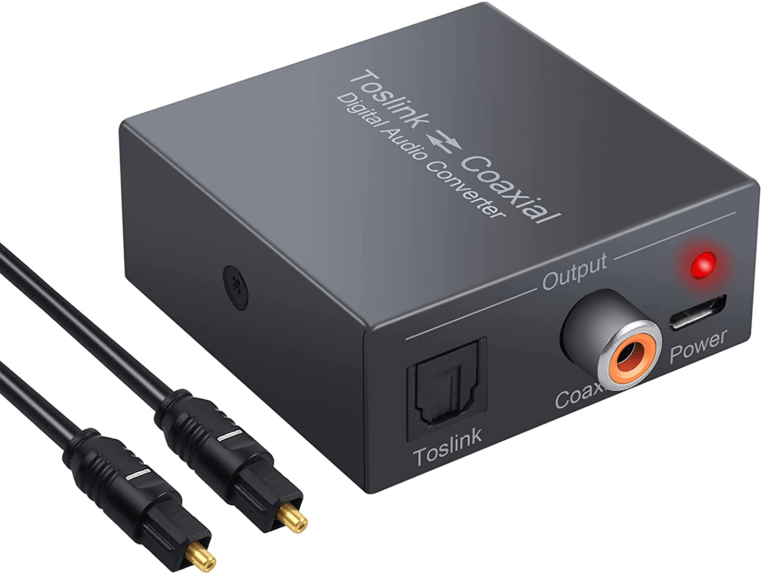

This will most likely work for you, and if the card doesn't support Linux (doubtful) you can return it?
https://www.amazon.ca/Audio-Adapter-External-Sound-Digital/dp/B06Y27TDJ9
https://www.amazon.ca/LiNKFOR-Digital-Converter-Bi-Directional-Splitter/dp/B07QTP7FX5/ref=sr_1_5?crid=39A0GPK34VM59&keywords=optical+to+coax&qid=1654451122&sprefix=optical+to+coax,aps,73&sr=8-5

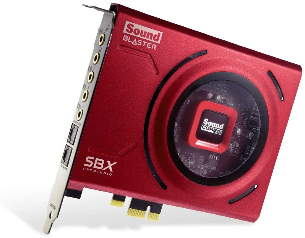

FWIW: I'm using this now with the DEQ2496 I bought from Pano because it was the only solution I've found. Even then, ALSA doesn't fully support it (I can't get 24 bit to work, 16 or 32 only)
https://www.amazon.ca/Creative-Internal-Headphones-Discrete-Supports/dp/B08HYPH5T6
