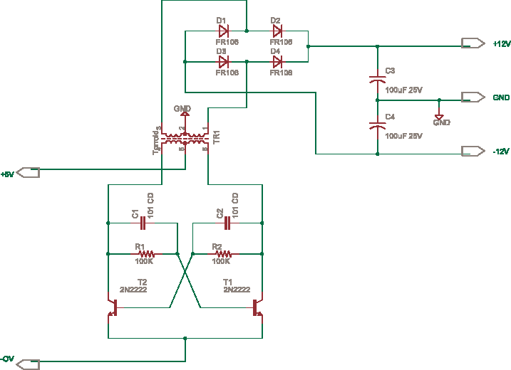

i managed to build it using two NPN TIP35D 25A 125W transistors
only used two 1K's and no capacitors and it works great!
can even be powered by a set of 4AAA batteries. it works exceedingly well
with 12V it can even power a 120V oscillating table fan directly!
I'm thinking of changing the two resistors to something lower like 200ohms or so. would that help? or would a darlington pair work better than lowering resistance of the resistors?

http://www.chinaicmart.com/uploadfile/ic-circuit/2009793442234.gif
I used that diagram. but what I have is 1/2W 1K resistors. and TIP35D's with 11.7V DC (from a small wall adapter power supply to test with before using a battery or something)
somehow ive managed to cram the TIP35D's onto a breadboard to make the circuit easier to build
one of them (top transistor) gets very slightly warmer than the lower one for some odd reason... dont know what could be causing that... possibly the transformer isn't wound right im guessing?
The resistors get a little bit warm. with a 20W light bulb on the output of the center tap transformer
20 watts is literally the max. anything more and it just seems to stop outputting useable power
but it can actually drive a 20W induction AC motor efficiently! and im very impressed by that.

Ok, so it's this with 1k resistors and similar transformer, right? The transistors won't be sharing current equally in a simple circuit like that, without emitter resistors or very close matching so yes, the waveform will be skewed and one transistor will be dissipating more power due to a couple of reasons. A 'scope would show you in an instant but I guess that's not possible unless you take your circuit to a college, school, repair shop, friend etc.
The transistors don't share current, they switch alternately. It works due to differences between pass devices. Search ZVS - Zero Voltage Switching.
Sure Jason, I stand corrected. I realised as soon as I posted that I should have said something like "supply equal power" rather than "share current" but the term "sharing" communicates the idea better.
Is there a way to make it more equal or slightly more efficient? and possibly have a higher output frequency? how could I use capacitors or different resistor values to get a higher output frequency?
