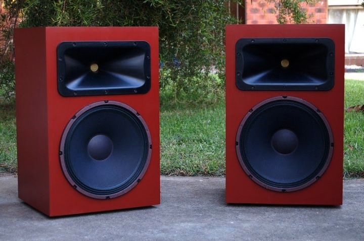

I suspect you'd appreciate a speaker with a wide frontage. Something with a low baffle step. Maybe an econowave style speaker.
What is an econowave speaker?I suspect you'd appreciate a speaker with a wide frontage. Something with a low baffle step. Maybe an econowave style speaker.
Budget is around $800. I can build the enclosure for pretty cheap at work. I will just source wood where I can from scraps.
No mids in that build? What is the frequency response of a system like that? With only the woofer and the tweeter.
The compression tweeter works well even below 1kHz so there's no gap. Response is what you make it, do you use an equaliser?

I do not use an equalizer.
Would a tweeter like this be a better match? This fall off around 500 hz and I'm finding large, 12-15", drivers that fall off around nearly the same point. Might not even need a crossover as they are pretty well matched
