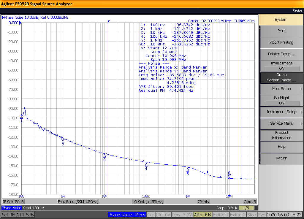

Which is to say you don't care about close-in phase noise at all?For my purpose the clock performance is sufficient...
I somehow fail to follow your course of reasoning...Which is to say you don't care about close-in phase noise at all?
This is 768kHz zero signal DAC -> ADC loopback clocked by Si5340 - the peak at 54kHz is switching frequency of a cheap SMPS adapter powering the rig, the highest bin is some REW processing artefact - not many people test REW at these samplerates:
And 350kHz @160db (i.e. below the 24th bit) sent to the DAC (apparently the 4M FFT statistics drills down to tiny signals):
I do not claim these are SOTA results but the clock performance is OK for me. Compare with other ES9822 768kHz measurements available on this website and elsewhere.
But again - this thread is about I2S, not clocks.
That is looking at noise floor, not close-in phase noise, right?
A whole thread on how to look at it: https://www.diyaudio.com/community/threads/phase-noise-in-ds-dacs.387862/post-7063038
The programmable clocks generally have rather poor close-in phase noise, which why they sorta hide that information.
If it doesn't matter to you, that's fine too.
