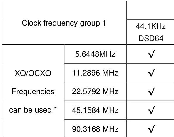

Nothing to do with High Resolution / DSD in this case. Purely, the Clock only. Clock frequency group 1 @5.6448 MHz.
For DSD @5.6448 MHz, it's considered 1-bit but for Redbook @5.6448 MHz I wonder if it can also be considered 1-bit? It's not documented because it is such a niche use case. Again I never got into Andrea's thread, so I never learned the Math. Something like 5.6448 MHz divided by 178 == 44.1 KHz. That's why bisesik posed the question about 90/98 MHz. Redbook @ 44.1 KHz works best as it's easily multi-pliable and divisible @5.6448 MHz. In this niche use case, 5.6448 MHz and 44.1 KHz play nice with each other with good synergy. For bisesik, his oversampling works best at x16.
Not sure what you mean exactly. AFAIK the official Red Book standard defines CD format only: 44.1 kHz 16-bit stereo.
You get like 5.644 MHz when you have 88.2 kHz 32-bit stereo, but clearly that’s multibit PCM, and happens to be the same bitrate as for two-channel DSD64.

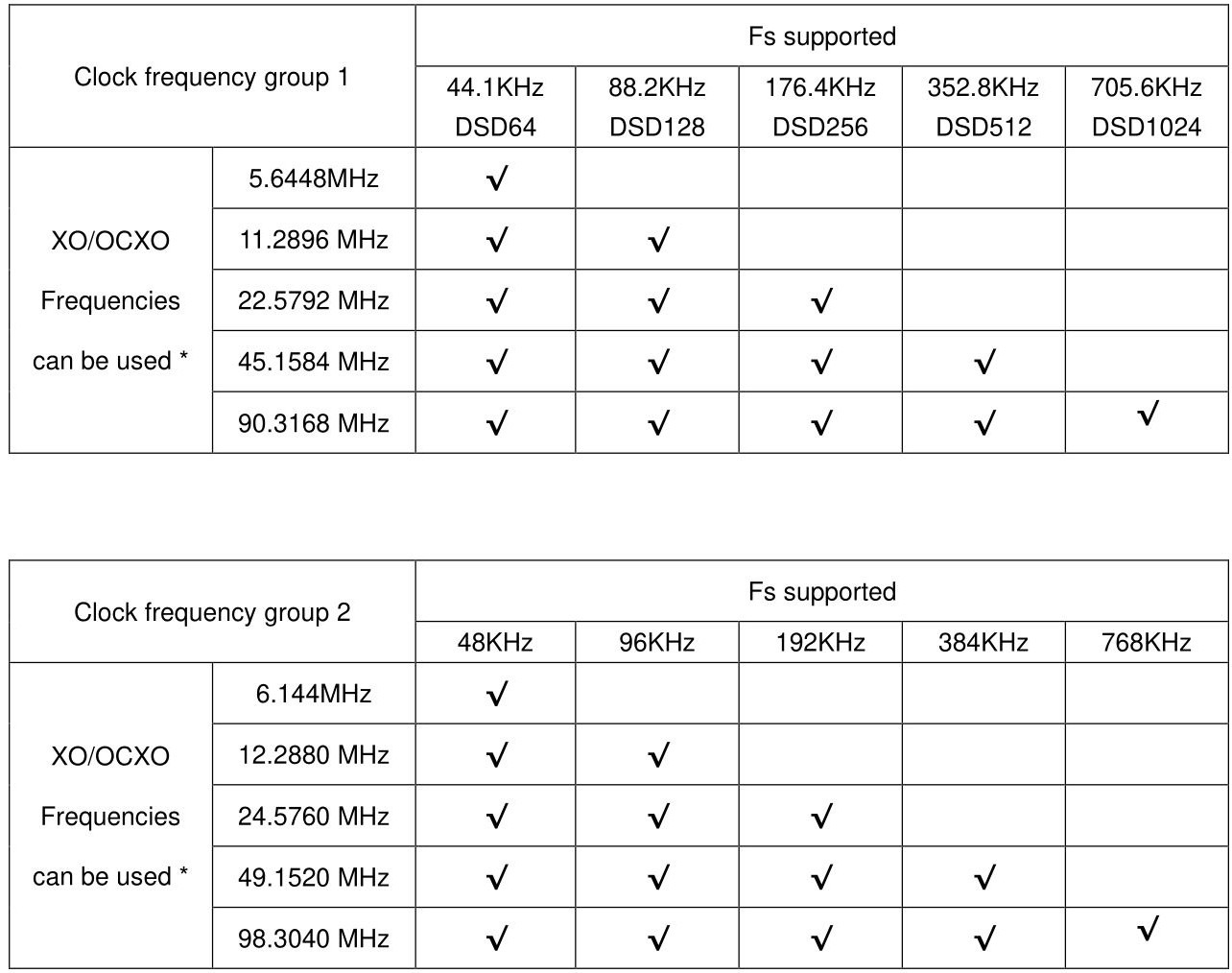

As you can see in the Clock frequency chart, 5.6448 MHz only does 44.1 KHz. Unfortunately, I never got into the Math as to why.

44100 x 16 bit x 2 channels = 1.411 MHz. Make it 32 bit which is a usual I2S word length and you get 2.822 MHz. That’s 64fs. Having a 5.644 MHz master clock allows you to reclock (must be at least double the bit clock to do it with flip-flops) as well as run DACs at a minimum 128fs, typical 256fs master clock.

Thanks for the Math, but it's never going to get to the bottom if it's considered 1-bit or not? It's a really difficult question to answer so I'll check in with Andrea.
