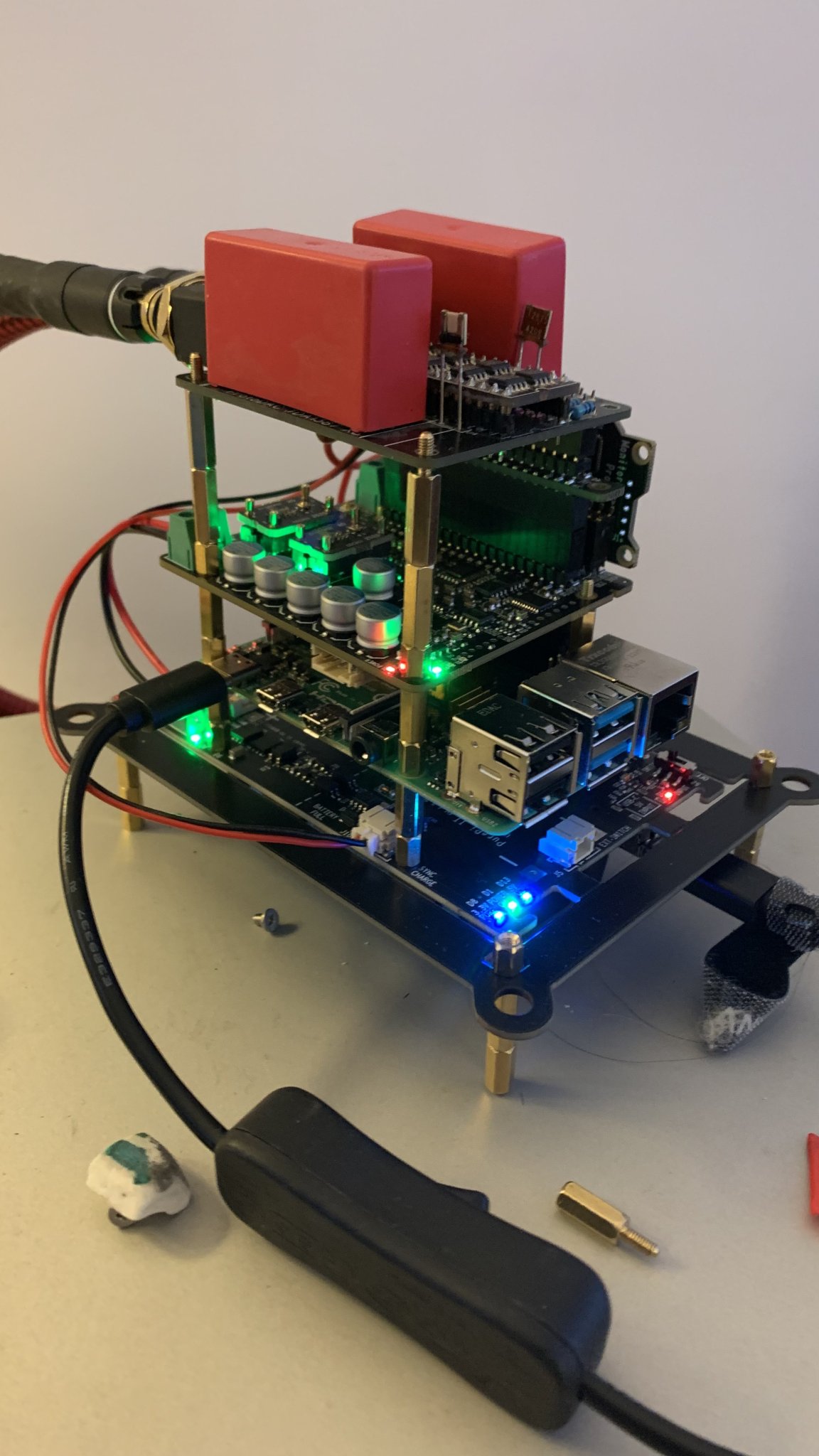

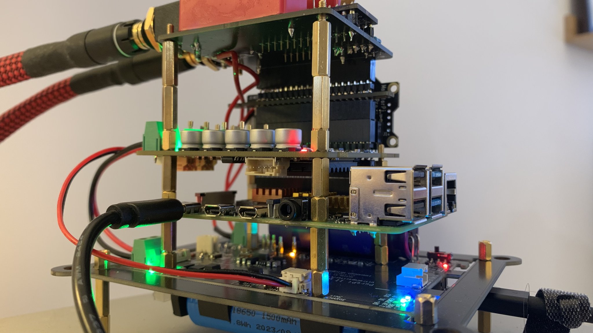

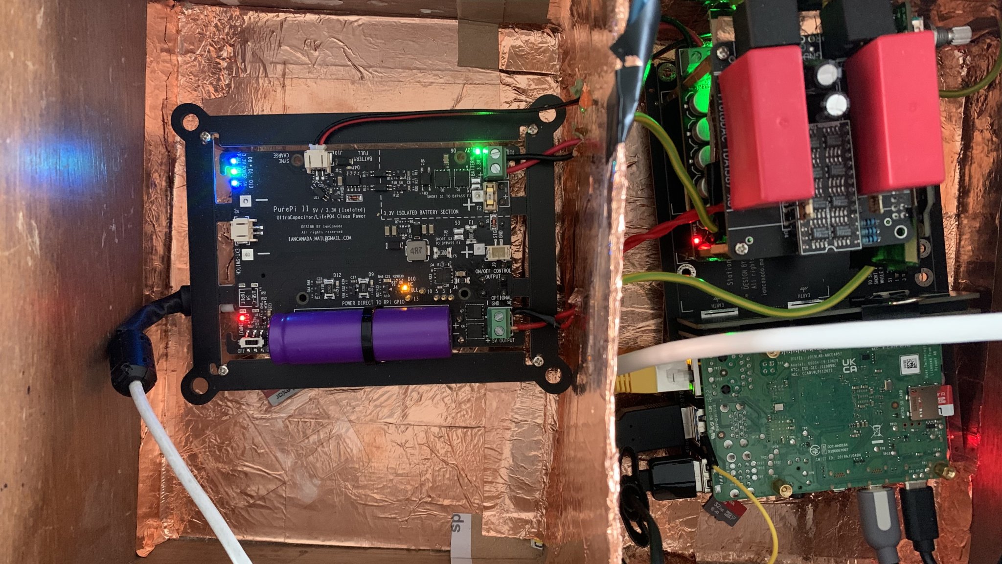

Hi gentlemen !
2 weeks out of home. I have done my homework today. For this try,
Everything works fine now. I assume that the problem was from the USB C cable connected to PurePi. With Thunderbolt 4, the curent seems high enough. The setup is stable.
A/B listening with Cary 800 DVP owned by a friend. ProtoDAC/Q7 has little more deepness and wideness. The big difference is ProtoDAC/Q7 is more enjoyable. Music is easier with it.
Thank you all for your help.
Many thanks to @hifiamps for your advisements to achieve this setup. 5V is much better than 3V 😉
Thank to @Gabster 2000 to inspire us with his YT channel. It helps me to jump to this enjoyable journey !
Max

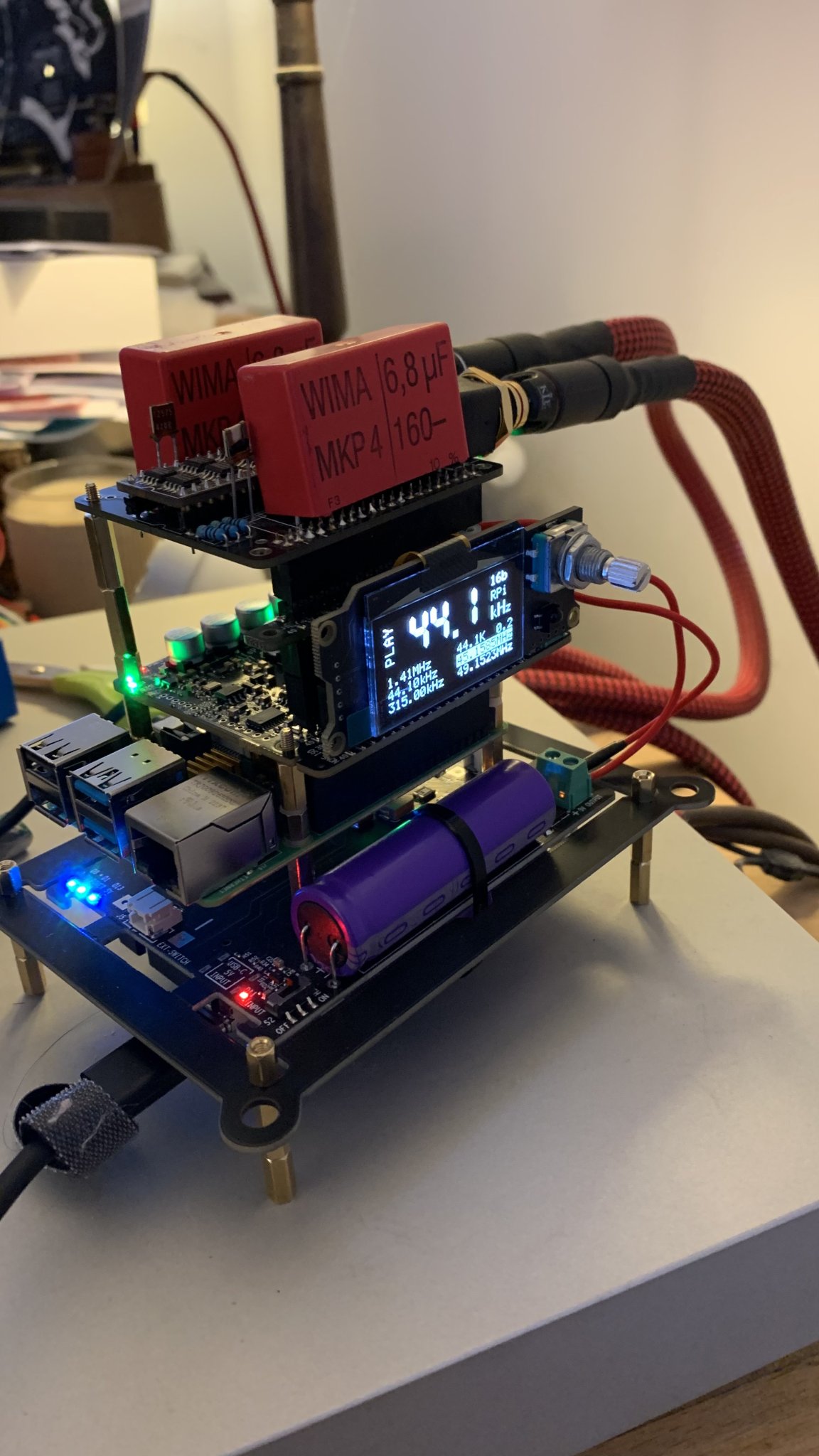

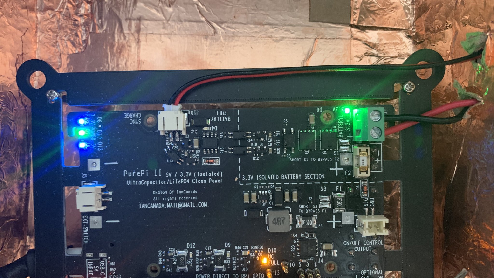

- PurePi powered by Apple MPB charger with Thunderbolt 4 cable (next step should be transformers, ultracapacitors and regulators)
- RPI by generic charger 3A@5V (thank you Mark),
- Q7 powered by 3.3V from LifePO4 batteries mounted on PurePI board (next step will be ultracapacitors)
- ProtoDAC (love it !) powered by PurePI 5V ultracapacitors with GPIO 2 and 4 pins cut (thank you Mark).
Max

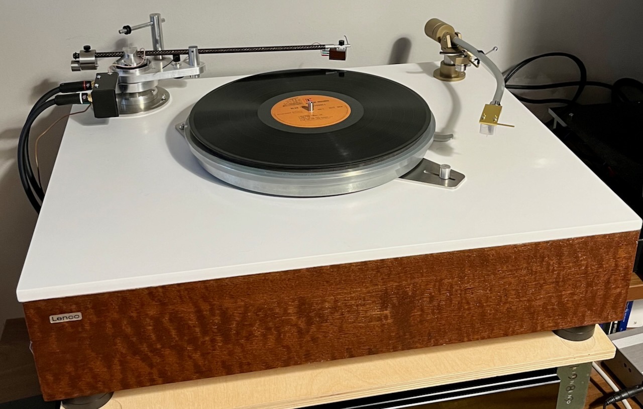

In any case, when you say the that FifoPi Q7 + ProtoDAC compares favorably with your Lenco L75, I can fully appreciate that your've placed the bar at a very considerable height. Impressive!
(enclosed a photo of my Lenco L75)
If I understand correctly, the Cary DMS-800DVP is just a streamer and the Helixir is a DAC. So, you compared those two combined with the FifoPi Q7 and the ProtoDAC, right?
As a matter of fact, I am sure the FifoPi Q7 is definitely a great component. I have also finished my streamer based on Ian Canada's components, including two LinearPi, three UCconditioners, a StationPi Pro, a FifoPi Q7 and a TransportPi AES. You can see all of them here...
I can confirm that the streamer sounds great. Much more detail, clarity and sense of reality than before using the streamer. But my question is more about the ProtoDAC. I wonder whether using the ProtoDAC is better than using a dedicated external DAC (say, worth 2-3K€).

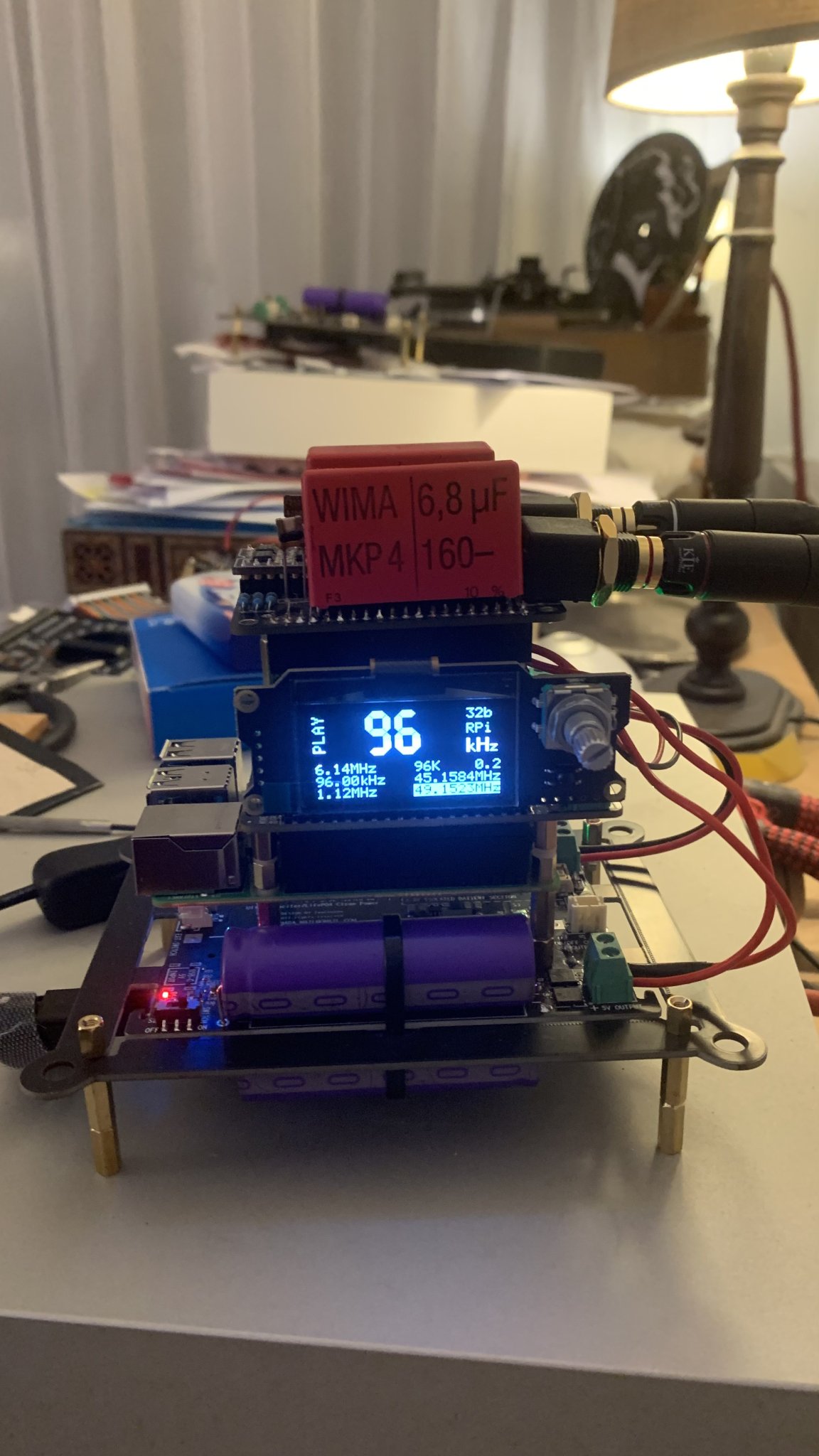

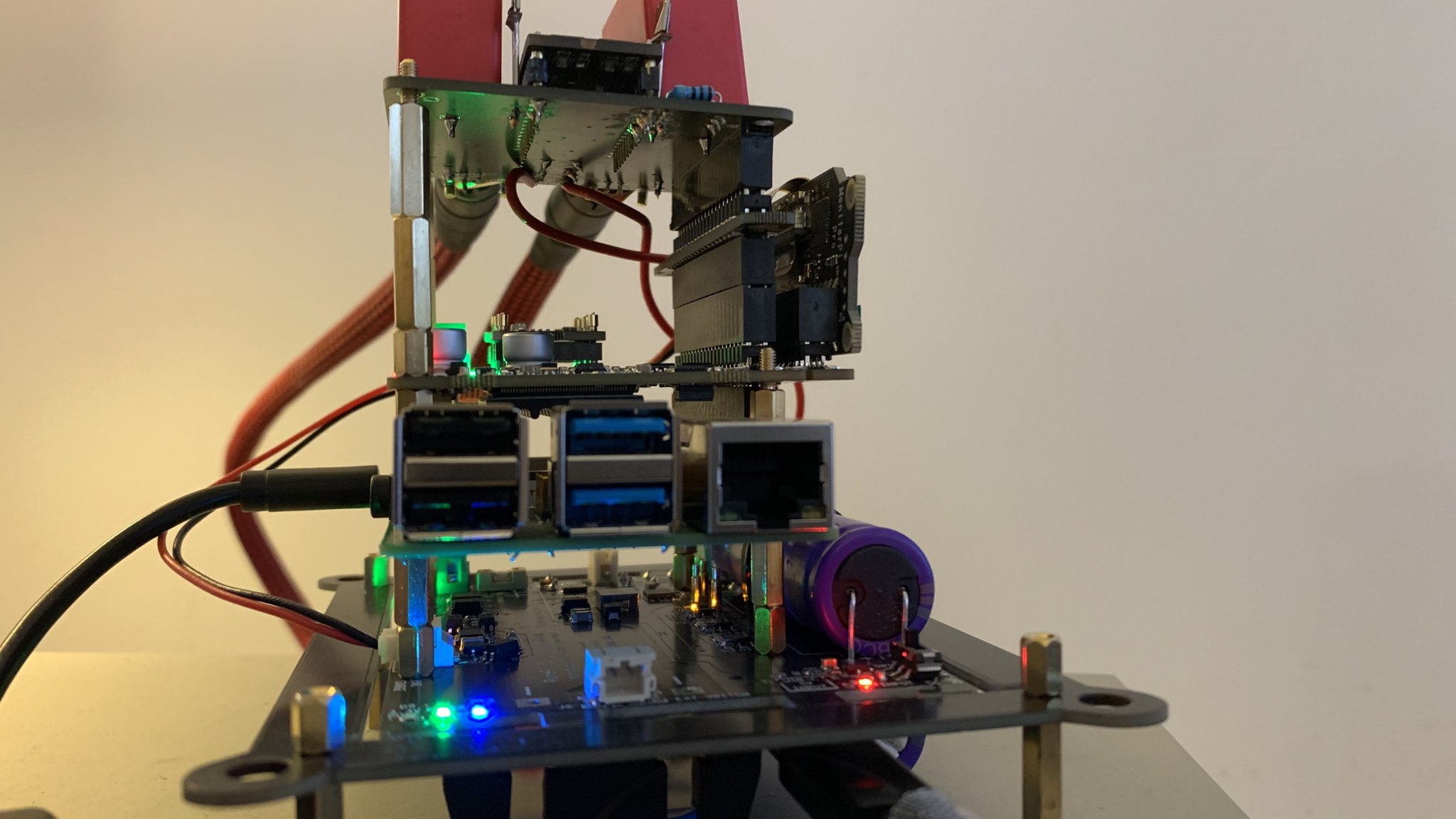

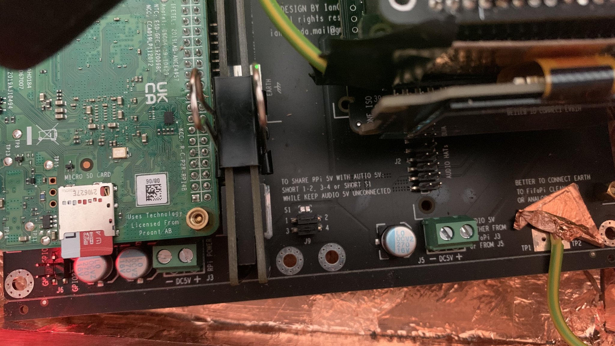

@MaxB_70 If I understand correctly, you have placed your FifoPi Q7 on top of the RPi. (And the ProtoDAC on top of the FifoPi Q7).
I've also tried the FifoQ7 on top of the RPi, and the RPi powered by its standard 5V power supply. When I used the StationPi Pro to separate the RPi and the Fifo Q7, and also powered everything with Ian Canada's ultra capacitors (UCconditioners), the sound quality improved considerably.
So, perhaps you may still have some further room for improvement, which is not just marginal. If you are happy now, you may be much happier if you proceed to some further adjustments/modifications.

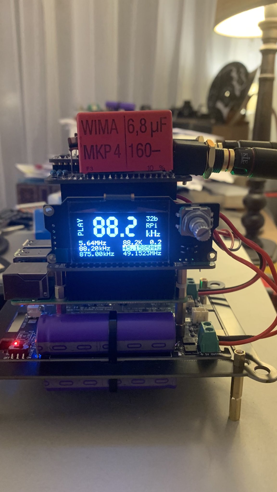

@pkonstantinidis " you have placed your FifoPi Q7 on top of the RPi. (And the ProtoDAC on top of the FifoPi Q7)." Exactly. PurePI supply Q7 (LifePO4 batteries) and ProtoDAC (ultracapacitors).
For further improvements, you're totally right :

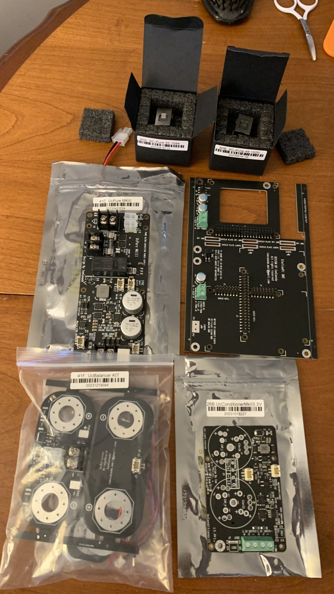

In my order to Ian (GP2023), I have also
StationPi SMT,
UcConditionerMkII 3.3V ( Maxwell 325F 2.7V UC to be ordered) and UCPure for Q7
UcBalancer ( eaton 3000F 2.7V UC to be ordered) for ProtoDAC
then RPI will be supplied by PurePi
In few weeks I will have time to set it up 😉
StationPi SMT,

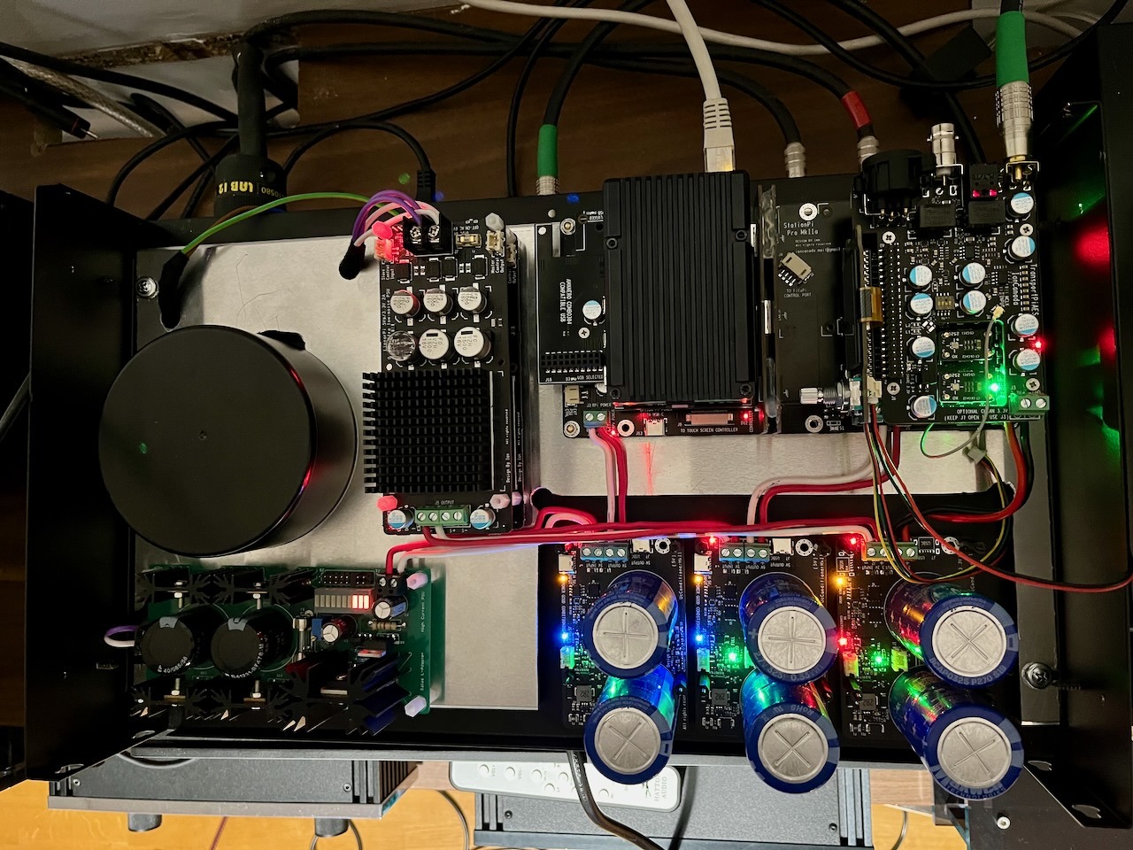

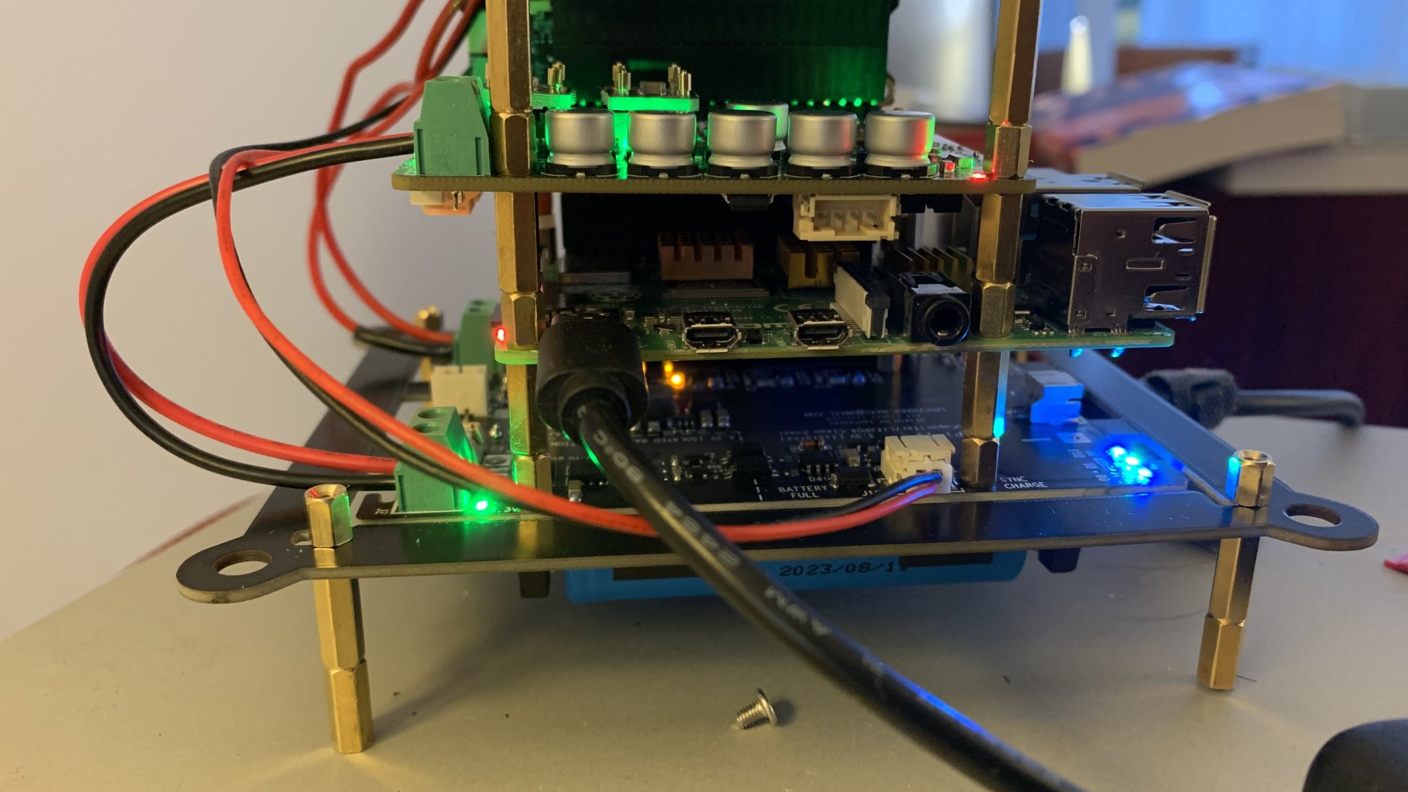

Max, I have a very similar setup to yours, can you post a photo showing the wiring side of your setup? (opposite side from the USB A ports on the pi)@pkonstantinidis, I have already the Ian's parts I mentioned above. I ordered directly from Ian as he managed a group buying in last December and offered to consumers % off. (https://www.diyaudio.com/community/...and-s-pdif-fifo-kit-group-buy.207438/page-265). There is no taxes between Canada and Europe. So much more interesting than Audiophonics. 2 days to arrive in France ; 10 days waiting at Charles De Gaulle airport (thank you French customs...). Packaged so well by Ian.
"By the way, aren't you using an output stage for the ProtoDAC, like Ian Canada's OPA861?"
I did it like Gaby show us.
"And since you'll power the ProtoDAC with UcPure (5V), it will be even better."
Right now, ProtoDAC powered by PurePi 5V ultracapacitors (GPIO extension pins 2 and 4 cut) . So, your advice leads me to think that PurePI 5V ultracapacitors must power RPI, and UCPure must charge 3000F ultracapacitors to power ProtoDAC. Am I right ?
There is another option : UcPure charging 3000F ultracapacitors to power Q7 and ProtoDAC powered by PurePi 5V ultracapacitors (thank you Mark for your advice). Maybe, you have an idea ?
"I am also tempted to go for a ProtoDAC, but I would prefer to find an already prebuilt one, if possible, with the best quality parts. Living in Europe (Greece), I would rather get the ProtoDAC from within the European Union, to avoid any unnecessary hassle with the Greek customs."
I have seen that Mark gave a link to Holland. It seems pretty well.
I have assembled it by myself from Mark's kit (USA).

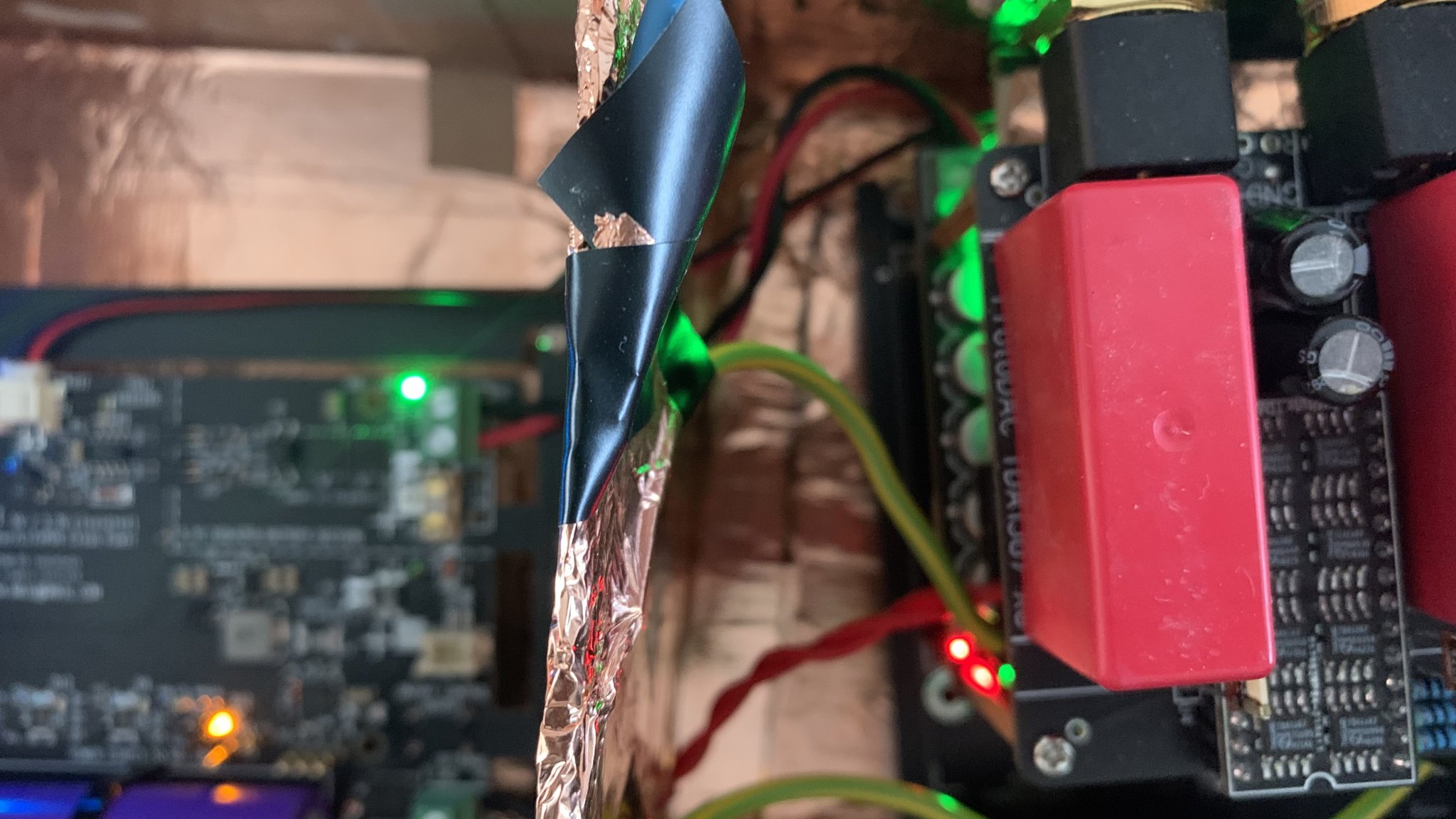

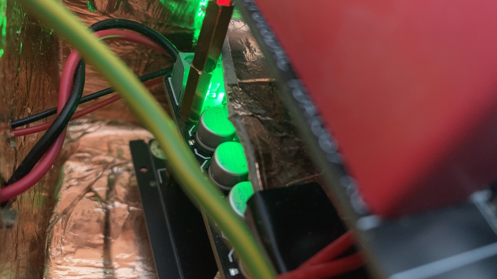

@dgcoffee ,
already boxed. Hope it will help, otherwise I will unplug and take other pictures.
- Digital Line Level
- IanCanada FifoPi Q7, no sound output
