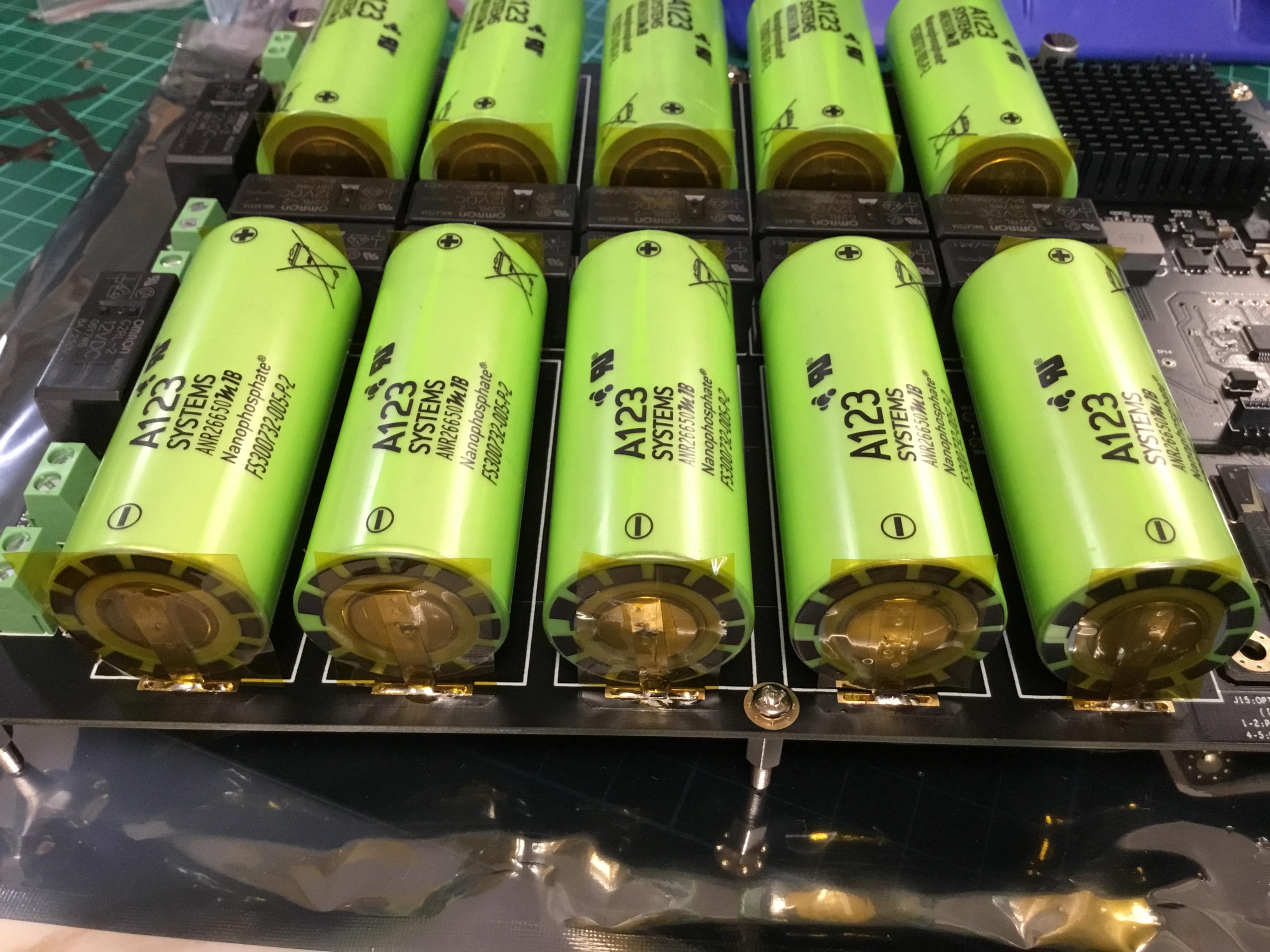

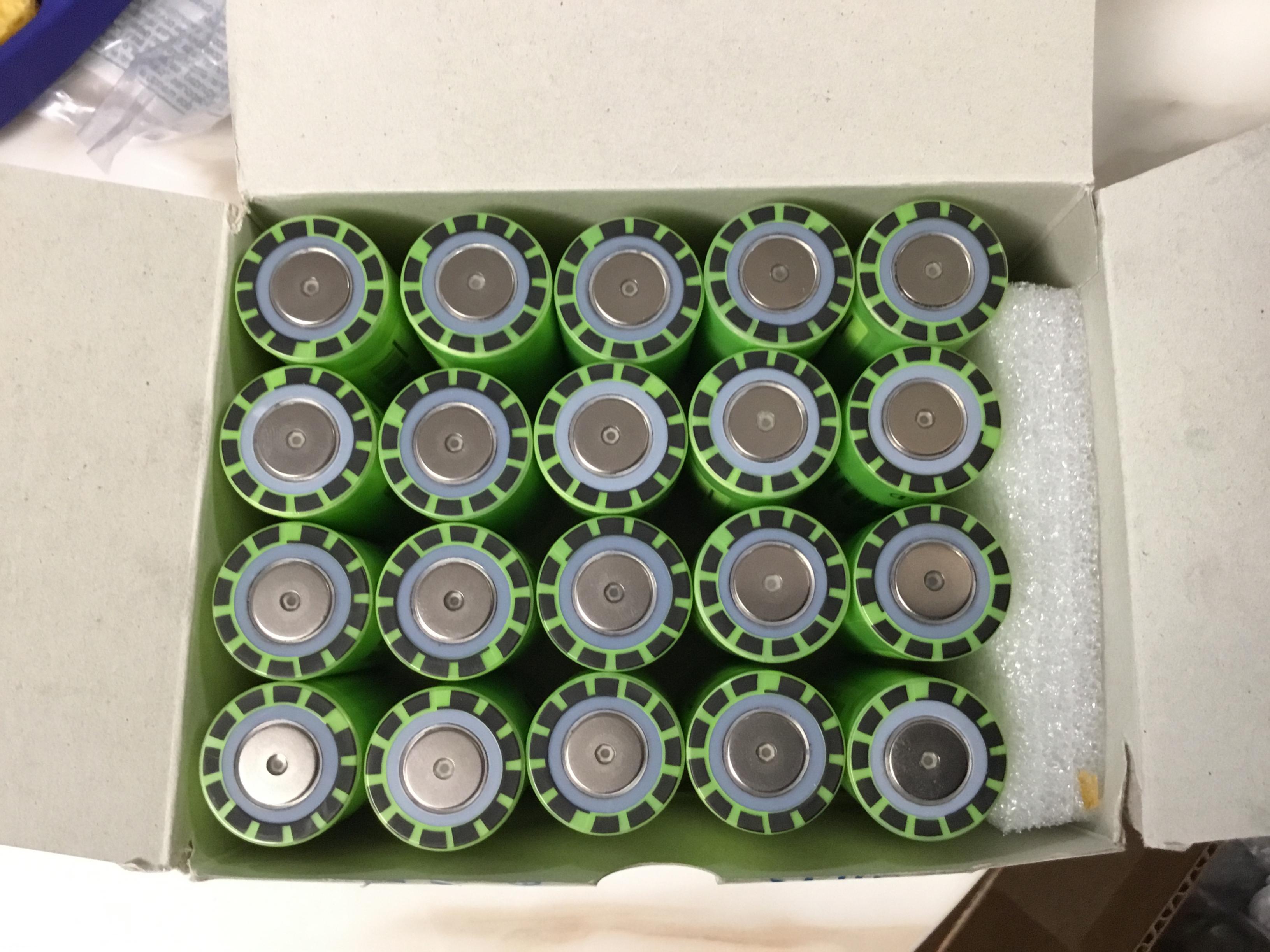

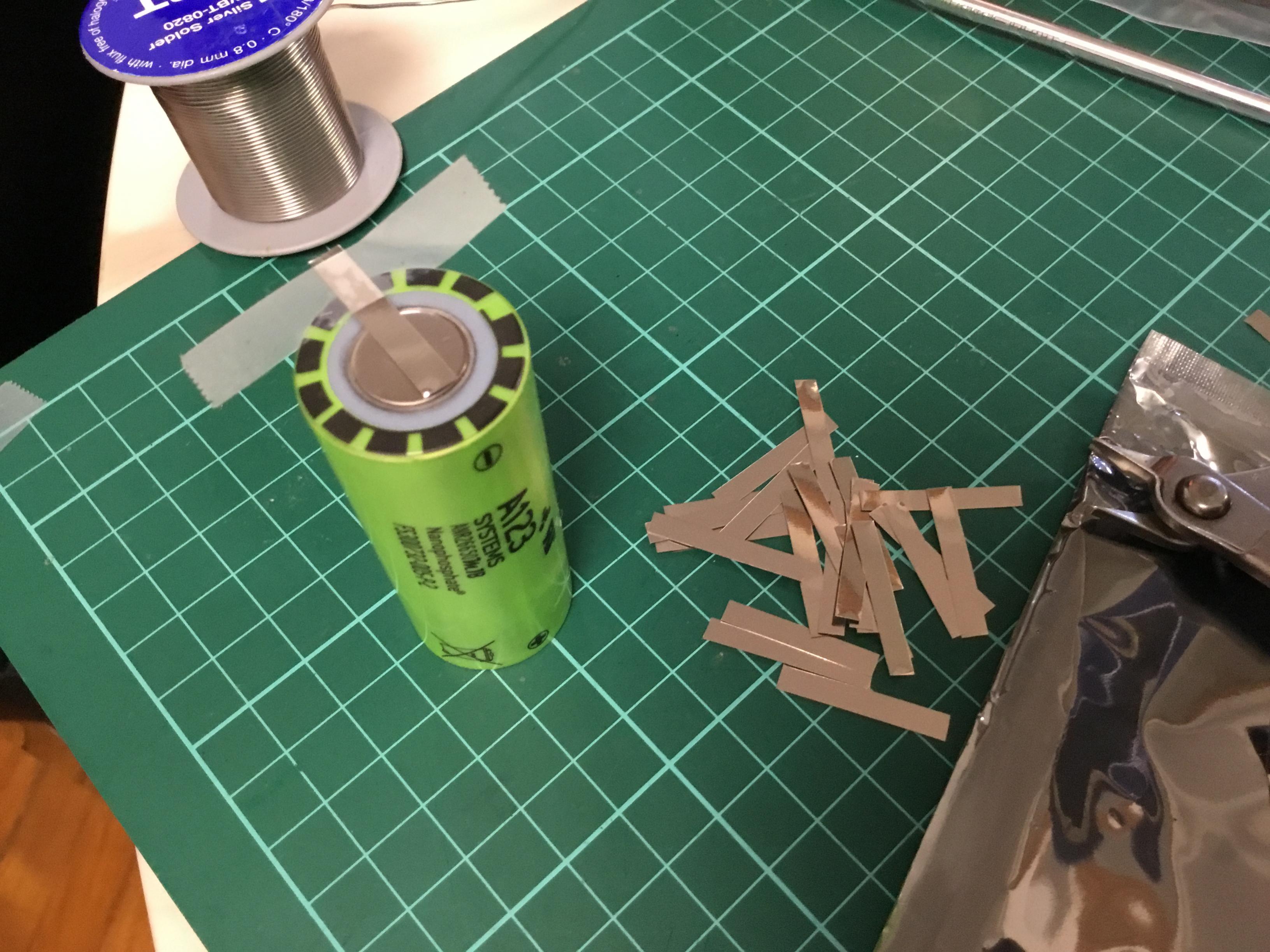

The cells ... but no taps ... so has to weld them myself!

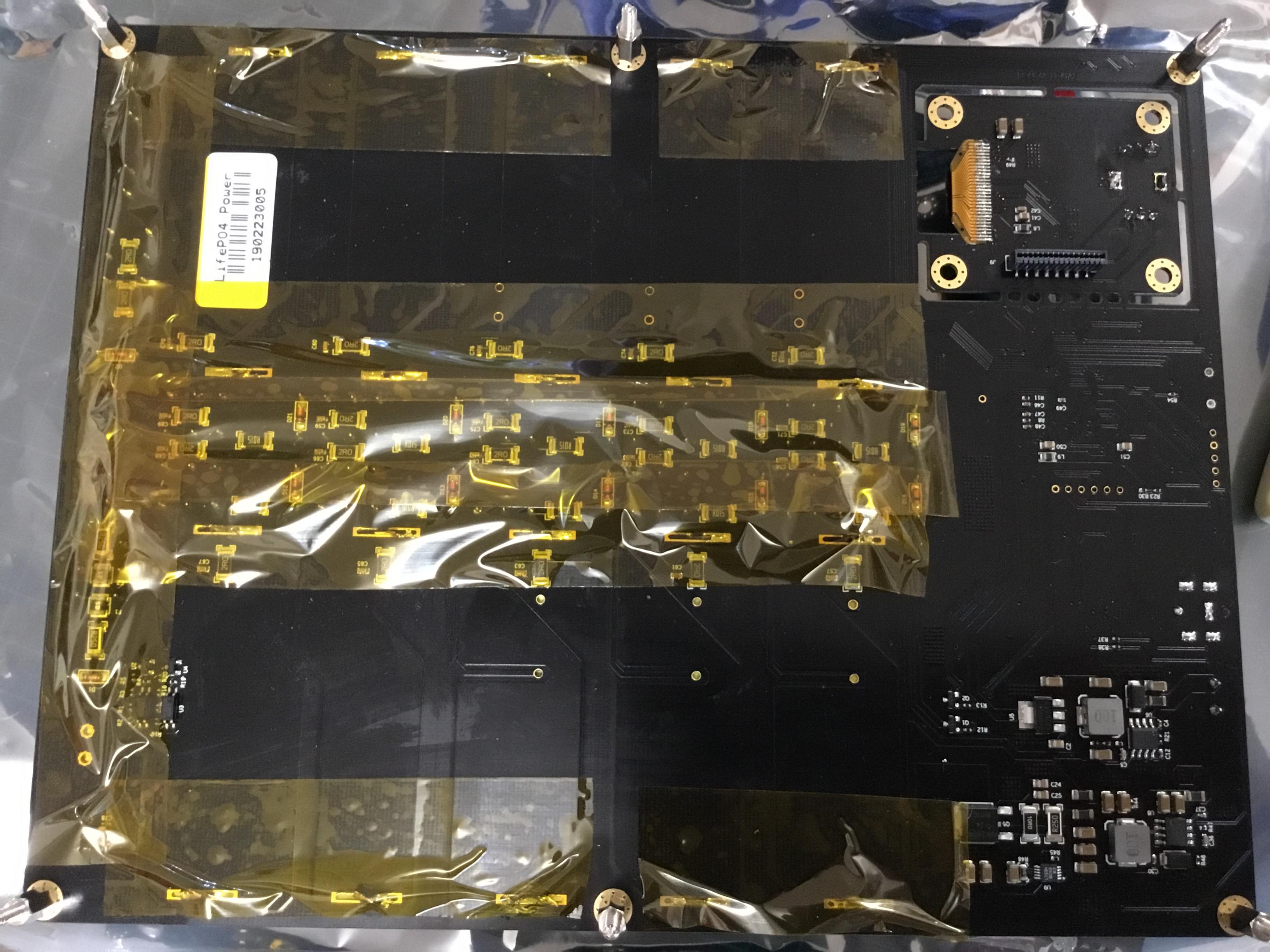

Nice thing is that I can align the cells exactly where I want it. I placed tapes on both ends of the cells as well as under the board for added protection.

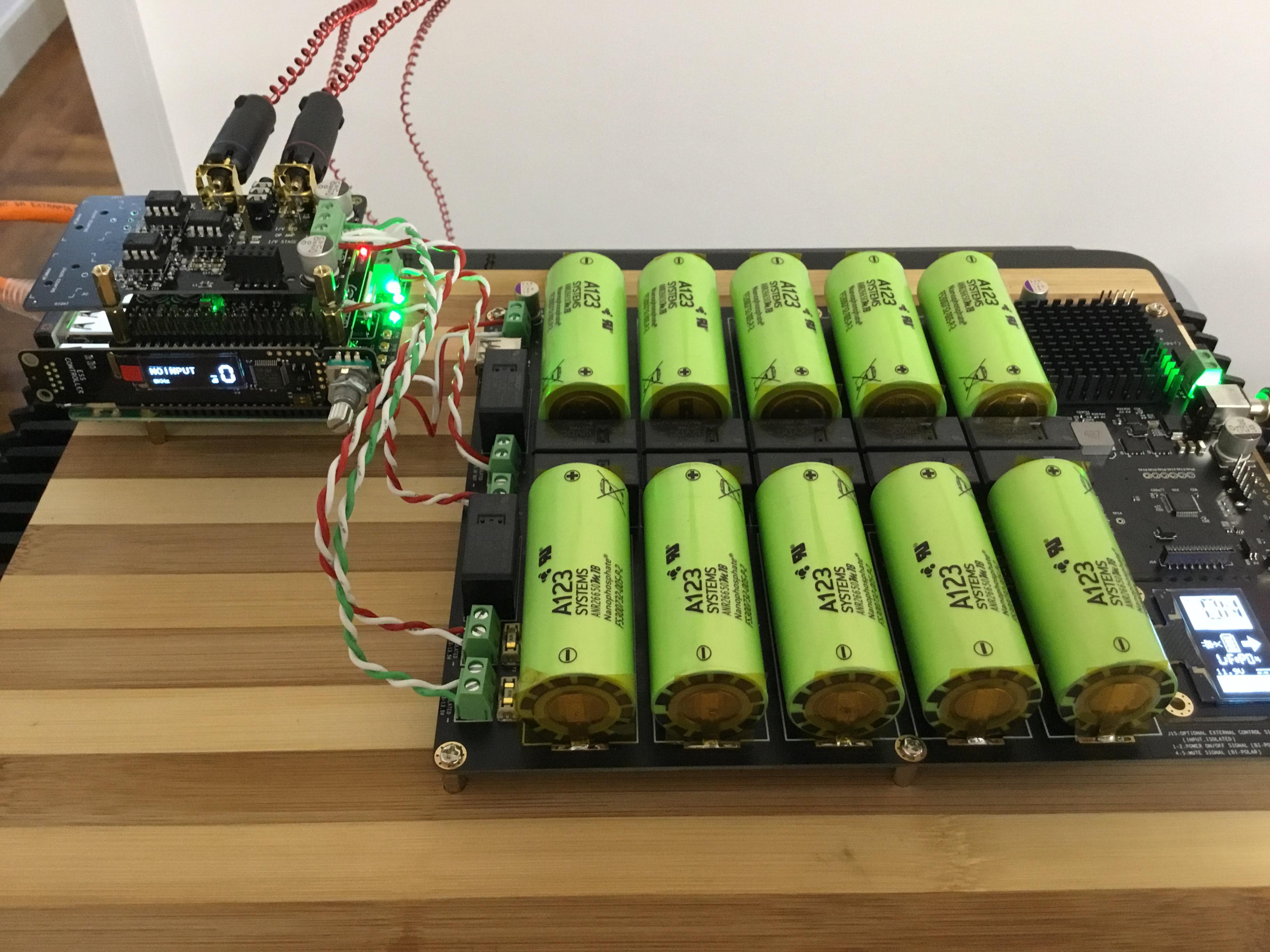

I just assembled the setup. Need some advice on setting up the dac hat in dietpi.
I installed dietpt, roon-bridge, and raspotify. The roon device is visible and can be selected:

However when I play a song via roon there is no sound output. Roon shows the song actively playing and there is no error reported. Perhaps I need to configure the DAC hat somehow?
Any pointers are most appreciated!

@Greg Stewart, @Ian,
I installed piCorePlayer and tried two DAC settings: (can't find a Generic I2S option)
- Generic/simple ESS9023 DAC
- HiFiBerry DAC+
In both cases the situation is the same, i.e., with fifoPi locks on, ESS DAC board locks on both L & R channel light up, but displays "NO INPUT" and no sound output.
At this point I think I may have some hardware issues. I'm thinking since the fifoPi/DAC board both locks on when played a song that suggests data are coming into the boards? But somehow it's not being processed for output?
I also tried resetting via the ESS Controller and during the reset I saw a very brief flashing of sampling rate 96kHz (which is exactly what I was playing at the time) in the display but it reverted back to "NO INPUT" right away.
Please advice if I missed anything or anything else I can try. Thanks!
