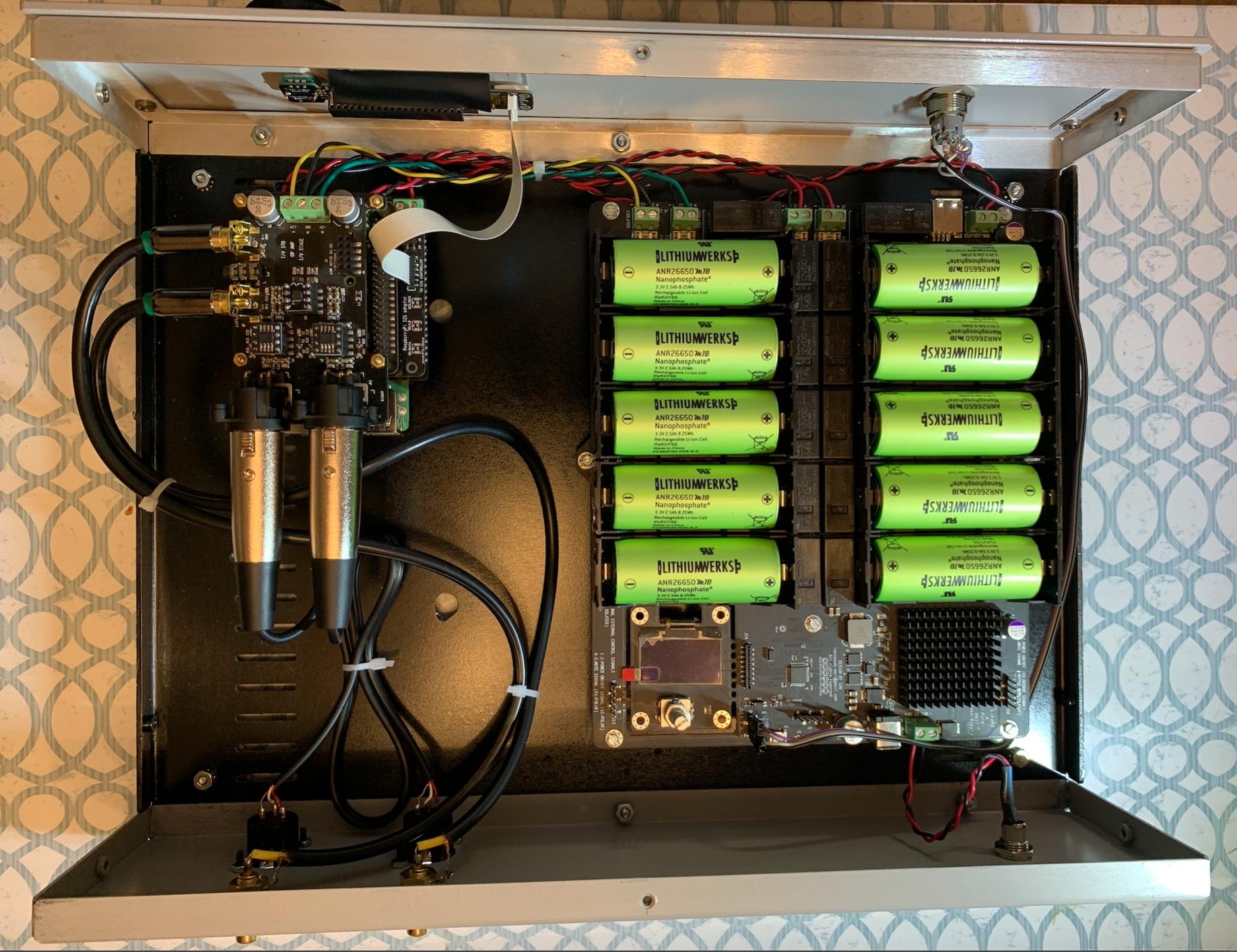

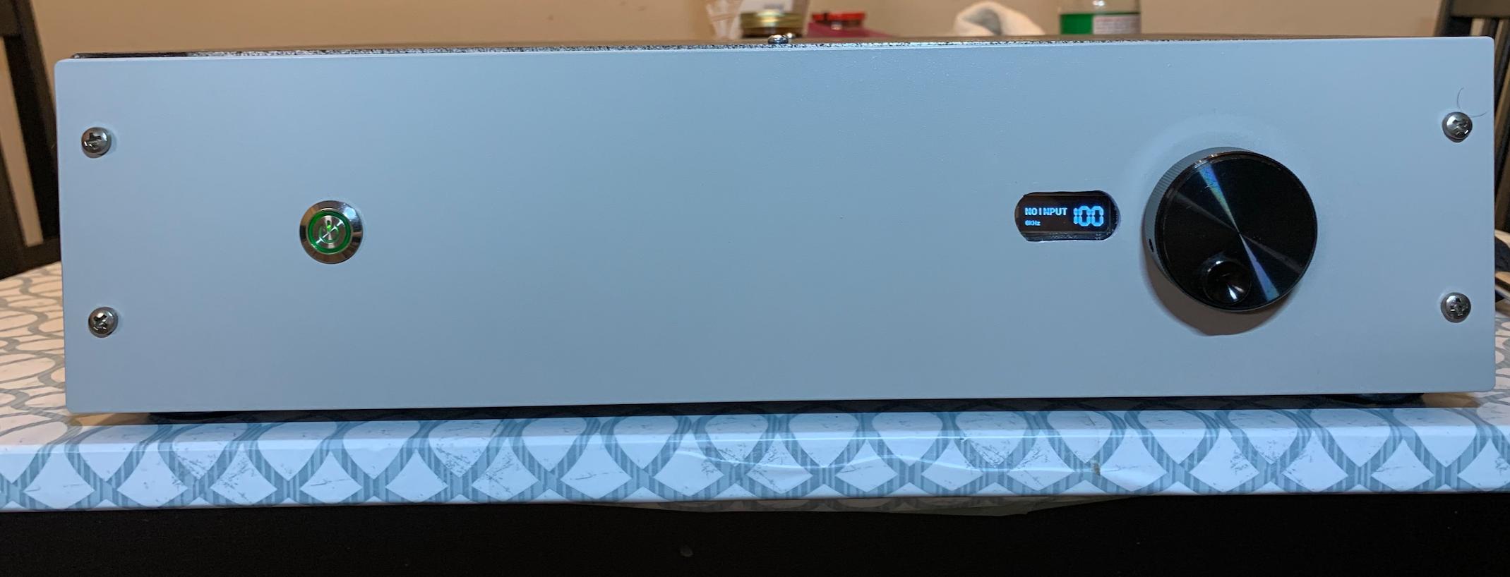

Finished Ian's goodies ....
Thought of sharing the awesome DAC and LiFePO4 in a home built enclosure. Been listening to it for sometime before putting into the enclosure.
Finally repurposed one of my old Par metal Amp Chassis to build this.
@unixdeveloper
You did great job, much better than my wood base
There still some ways to improve the sound quality. Hopefully I can post the solution today how to upgrade the LifePO4 3.3V rails to ultra capacitors hybrid power supply. It will be another improvement, especially for the FifoPi clean side. And I can guarante, very easy

@unixdeveloper
You did great job, much better than my wood base. Congratulations!

Ian, initially the setup was on a wooden block like yours to make it easy to experiment with different options.
I ran into one issue when I used a CCHD-575 22/24 pair, FiFoPI LED indicators near the OSC were flashing and there was no lock. I assumed the problem was with the clocks. Once I put back the CCHD-950 45/49 pair it started working again . At what situations the LEDs near the clocks flash on FiFoPi?
I didn't have much time to debug that further. I will reflow the clocks and check if they work properly before installing them again.

@unixdeveloper
Normally is the XO adapter soldering issue.
BTW, 22/24 MHz will limit the Fs up to 176/192 KHz
