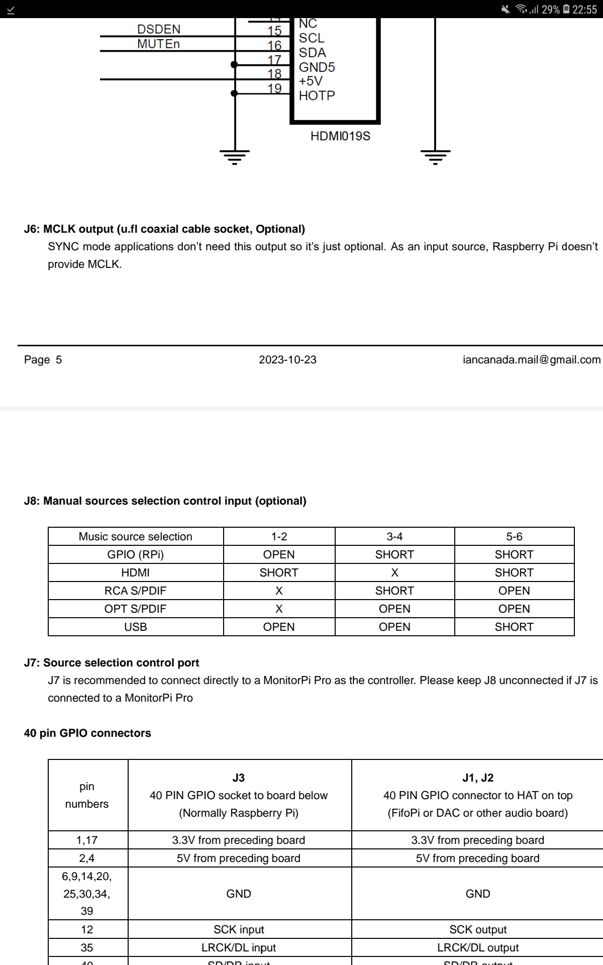

Did you try short open open?Hello. I have lots of staff from Ian. My latest is receiverddc input board. Im building dacnad want to have some inputs. Dac have one big oled screan nad dont want to add next. Problem is with manual input select J8. Receiverddc manual is not clear in this part. By shorting pi 2 with pins 1,3,5 i can chouse hdmi,rpi, usb and coaxial. But how to activade A optical? Very thanks for help.
You can get also a MonitorPi PRO and control easily the inputs.

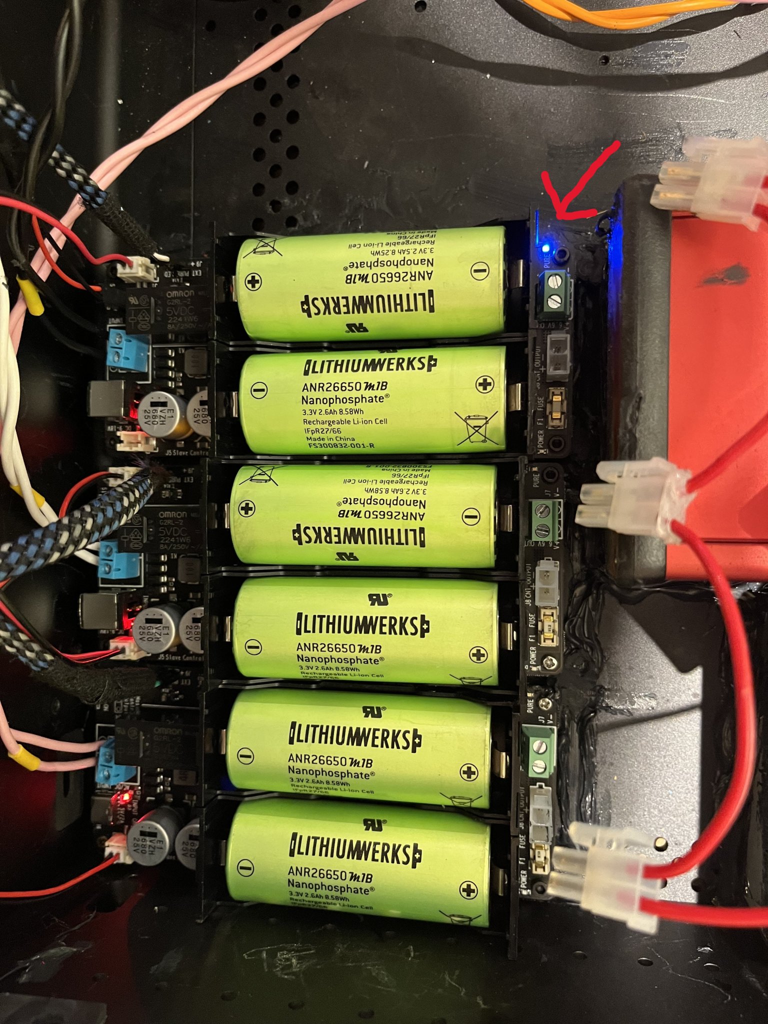

I have a new little problem with a lifePO4mini 6.6v.
One of my 3 lifePO4mini Pure LED D10 light stays on when master switch is off.
(When switch is on, LED D10 and LED D9 are light on and output power.)
Do you know what can be the cause?
Thank you for your help.

This is manual source selection optional control input. But it looks crazy, what mean X?for now i know that only way it works is:
Pin2 is 5v, pin 4,6 is gnd. Pin 1,3,5 is from procesor.
--all pins are not connected is rpi
-pin 1 is connected to pin 2 is hdmi
-pin2 is connected to pin3 is USB
-pin2 is connected to pin 5 is rca
Have try lots of options but no luck witch optical.

hello, I have a similar configuration. since I will mainly use the USB input, I wanted to control the selection via jumpers and I already had MonitorPi. Unfortunately this didn't work, I could choose RPI or HDMI. I wrote to Ian about this and he advised me to install MonitorPiPro. now it is working.Jest to opcjonalne wejście sterujące ręcznego wyboru źródła. Ale wygląda to szalenie, co oznacza X? na razie wiem, że działa to tylko w następujący sposób:

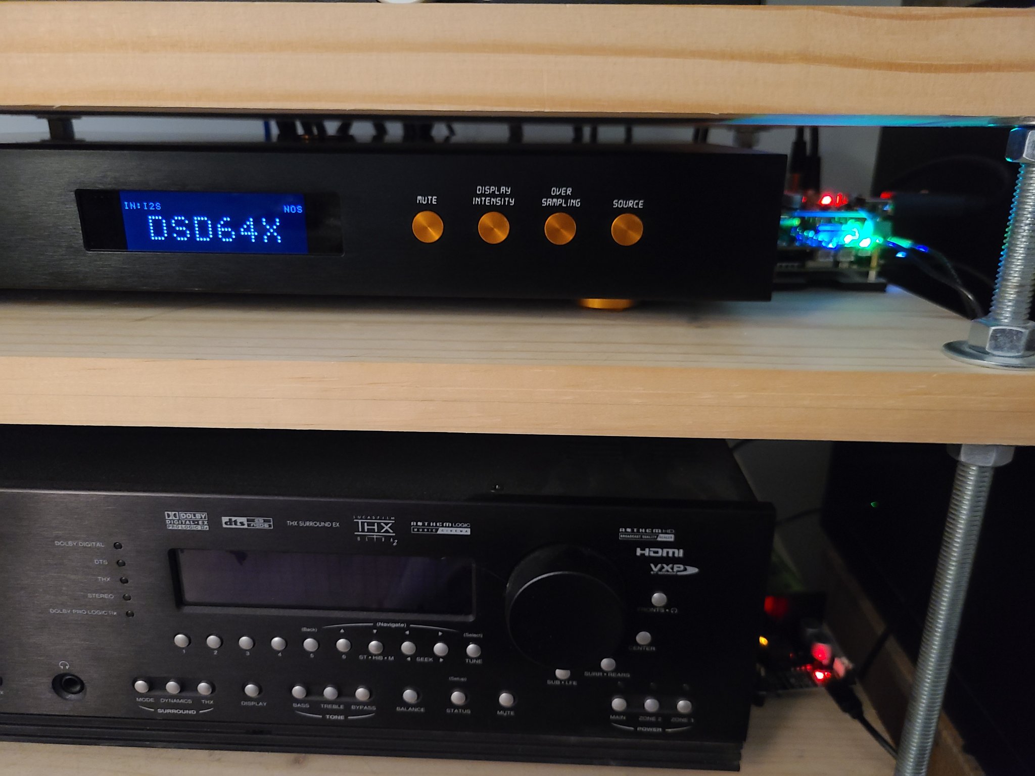

I've switched back to the rpi 4 as a sanity check. Recompiled the kernel & modules, and can confirm that the q2m overlay I mentioned above, which comes with the 6.6y kernel, works with fifioPi, up to 384/DSD128.
After looking over the output of dmesg more thoroughly, on the pi 5 the q2m/k2m "card" fails to be registered, and this is not the case on the pi 4. The pi 4 still shows the I/O -121 errors in dmesg when attempting to update bits, mute, etc, so it seems these can be ignored.
I will have to do some more learning about the new RP1 chip found on the pi 5, as it seems this is the crux of the problem. With the old broadcom soc found in the earlier pi's, i2c traffic can switch between master & slave mode on the fly, whereas that's not possible with RP1's i2c. However, there are multiple i2c busses available on the RP1, and from what I can gather from the docs, it should be possible to run one bus in master mode while the other runs in slave mode.

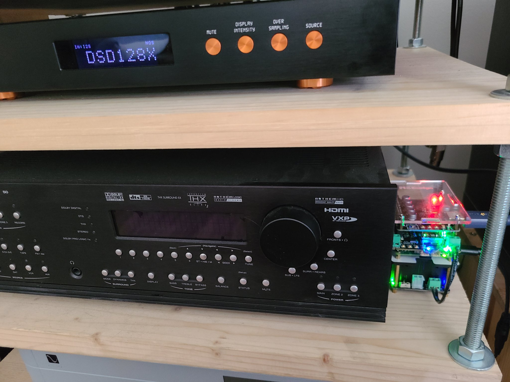

Finally got up to 384kHz working on the pi 5! Worked with one of the maintainers on github and he updated the drivers to support changing the pi 5's PLL for i2s on demand.
So now we can confidently say the Ian Canada HATs will work at higher sample rates on the pi 5.
The PR that makes this possible has not yet been merged into the 6.6 kernel, but you can get this patched version using the rpi-update command as mentioned in the PR comments:
https://github.com/raspberrypi/linux/pull/5999
I've tested extensively and everything is working in terms of PCM sample rates. Still can't get DoP passthrough to work but that's minor since the Q7 can still decode it.
Fun times ahead. Really like what I'm hearing.
