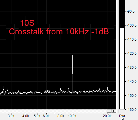

The same is said about using single op-amps instead of dual ones. However, without the mono mode of the DACs and with dual op-amps, the crosstalk attenuation at high frequencies is >110-120 dB, is this not enough?, usually the reason for dual mono is better separation between channels,

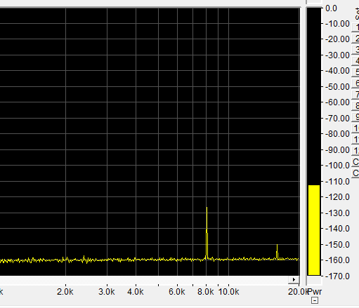

That's the thing easiest to measure. What about correlated substrate-coupled cross-channel noise? Again, as humans we tend to think of whatever is easy to measure as being all that exists, all that can exist. The cognitive bias in that case is called WYSIATI.Channel separation is fairly easy to measure with sweeps or multitone measurements. A well-implemented single-chip DAC can have channel separation below -120dB. With dual mono DAC channel separation can be -140dB. Both are well below audible levels despite what some may claim.
Which also brings up the issue of what is the difference between correlated-noise and distortion? They can both sound ugly/rough; they can both have a high crest factor too. If its too hard to measure one of them in a meaningful way then maybe its easier to build a dual mono dac and listen?
Try measuring its channel separation. You may be surprised.My dac already gives better imaging than my much more costly vinyl setup.
Dual Mono hardware mode makes an easier power supply arrangement. And PCB is probably more easy to design. For instance?Yes, exactly - why "dual mono"?
Alex.
Why would that not show up in multitone measurement?What about correlated substrate-coupled cross-channel noise?

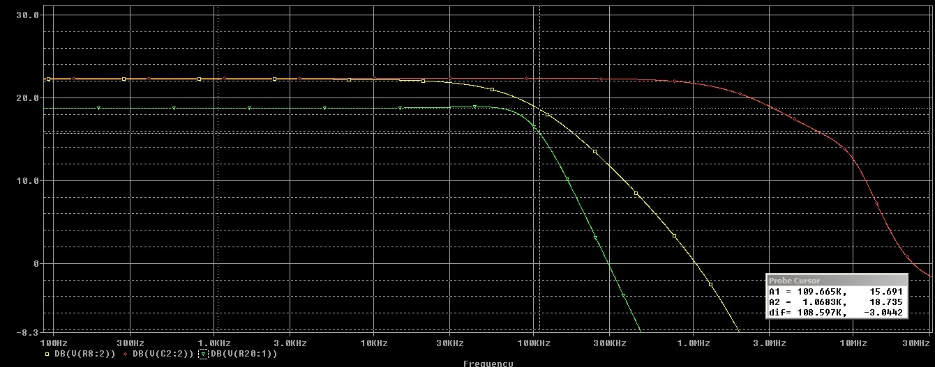

This is analog dilter Fo in datasheet proposed output circuit.
red is after Cfb, yellow/blue are after 1st stage of OP IV on ballanced output connector.
Green is after bal/se last OP circuit. So the noted Fo are more or less tha same as in the PDF.
But the circuit has some issues and not so good.
