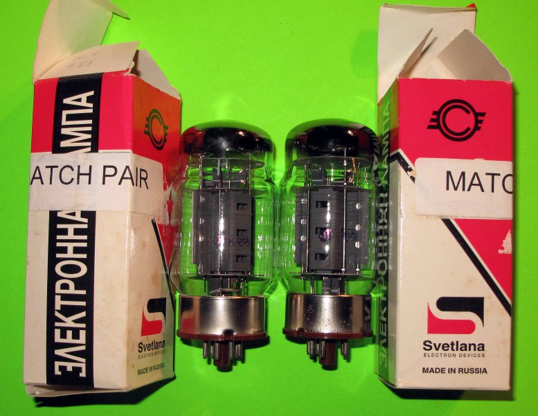

Thanks Kevinkr, I suspect that they are indeed from the original plant as well. The top of the box is yellowed and the date code looks to be from 2005. It's clearly 0005.
When I get a chance I'm going to install them in my Denise Had SE amp. So far an original set of EL34 tubes that came from a Dynaco ST70 have sounded the best.

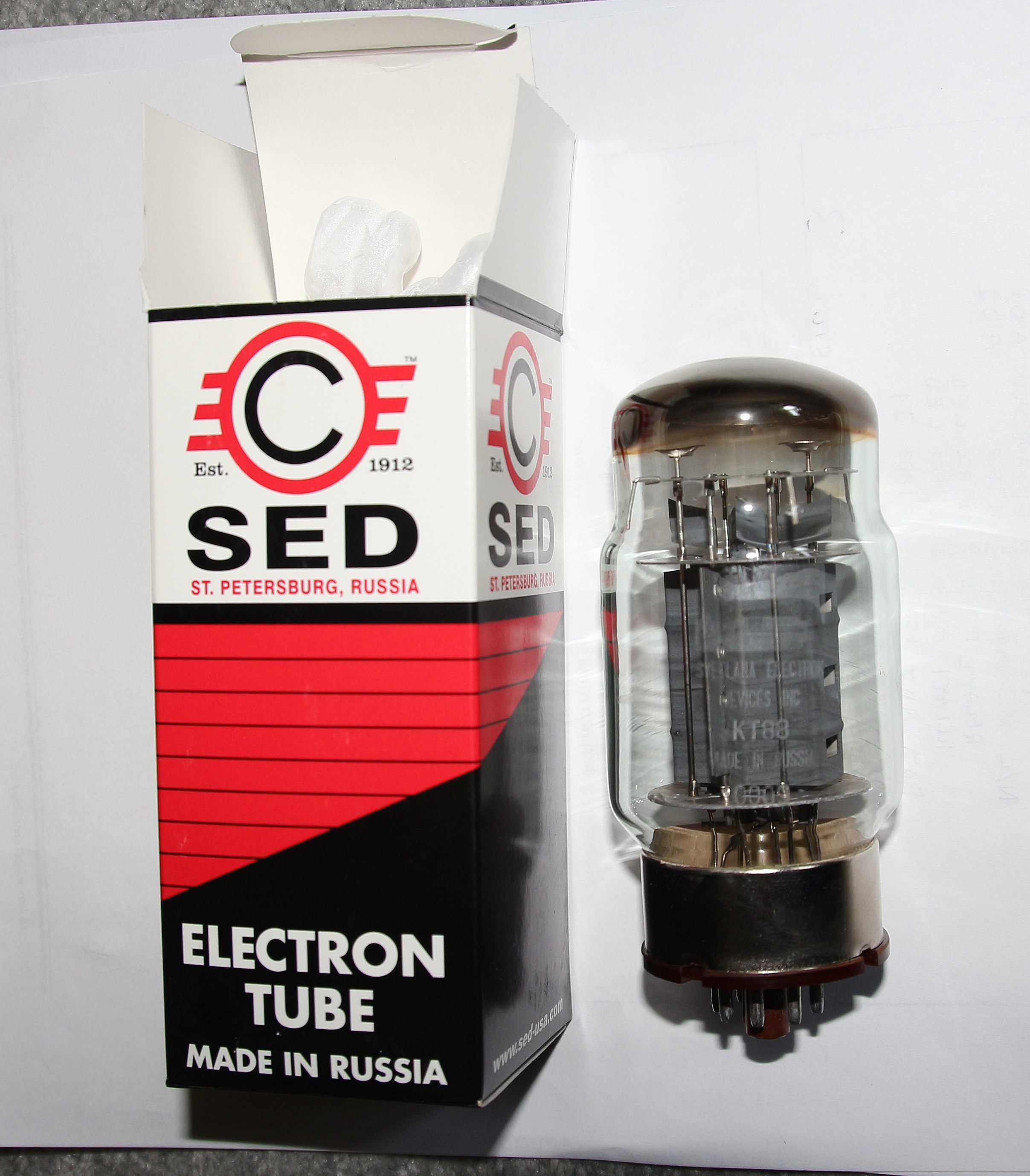

Does anyone have any KT88 that came from the Xpo-pul factory with the rectangular holes? I know all the new ones have the round holes.
