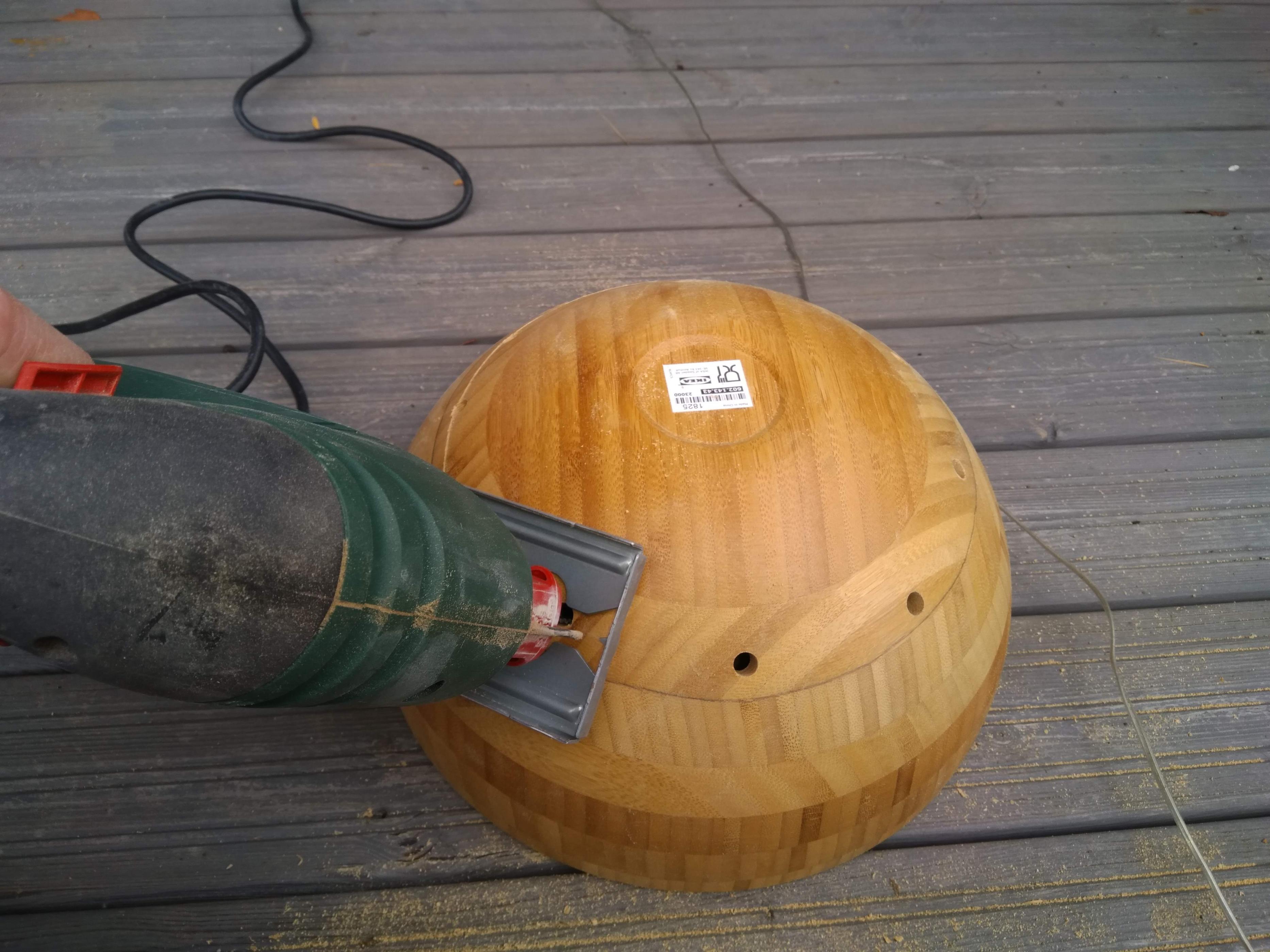

Two big IKEA BLANDA bowls make a nice "box" for a coaxial SEAS MR18 speaker!
Thread of the project https://www.diyaudio.com/forums/multi-way/322839-seas-mr18-3-a-2.html#post5605246

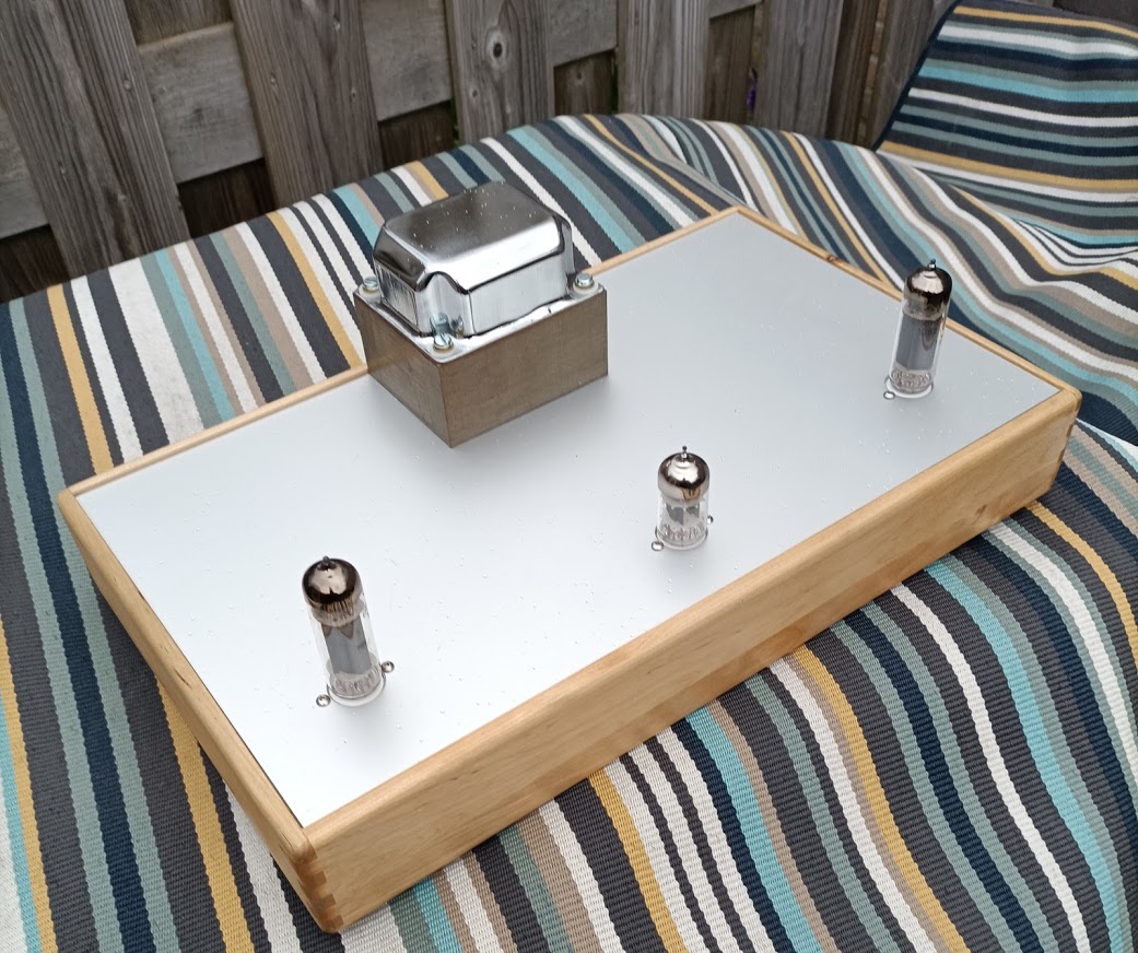

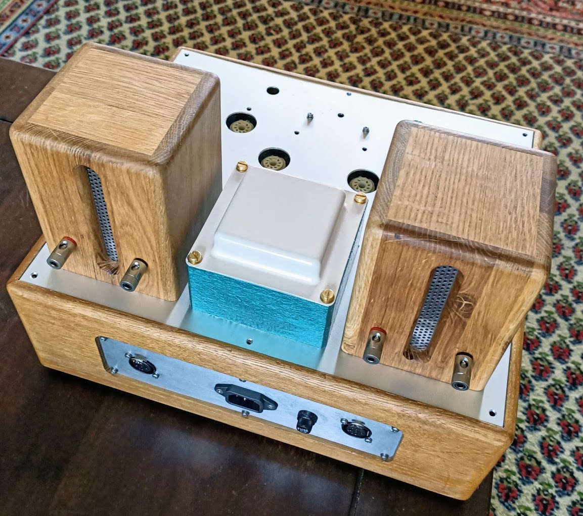

Congrats, this looks very fine! An excellent combination of oiled oak (I think) cheeks and the aluminium chassis plate.
Btw, there was nothing you could've also covered the power tranny with?
Best regards!
Best regards!

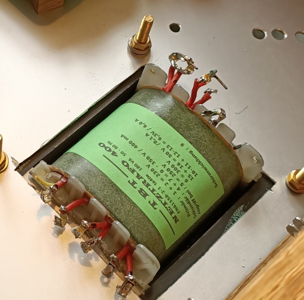

I guess so...would have saved me some grief...had to to some surgery to fit them this way. However...I like the contrast. And I did not have space unless it was a metal box.Btw, there was nothing you could've also covered the power tranny with?
And yes. Boiled linseed oil on oak.

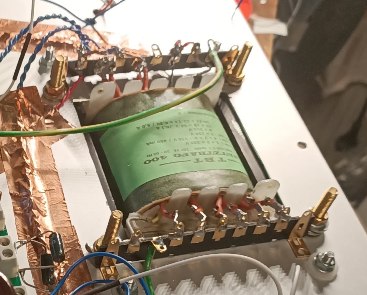

Hacking the transformer. Because the plastic bobbin and connections with this low profile version..extends all the way to the edge.

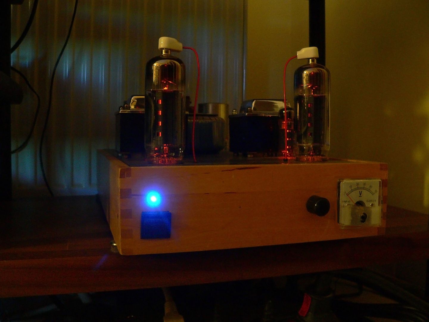

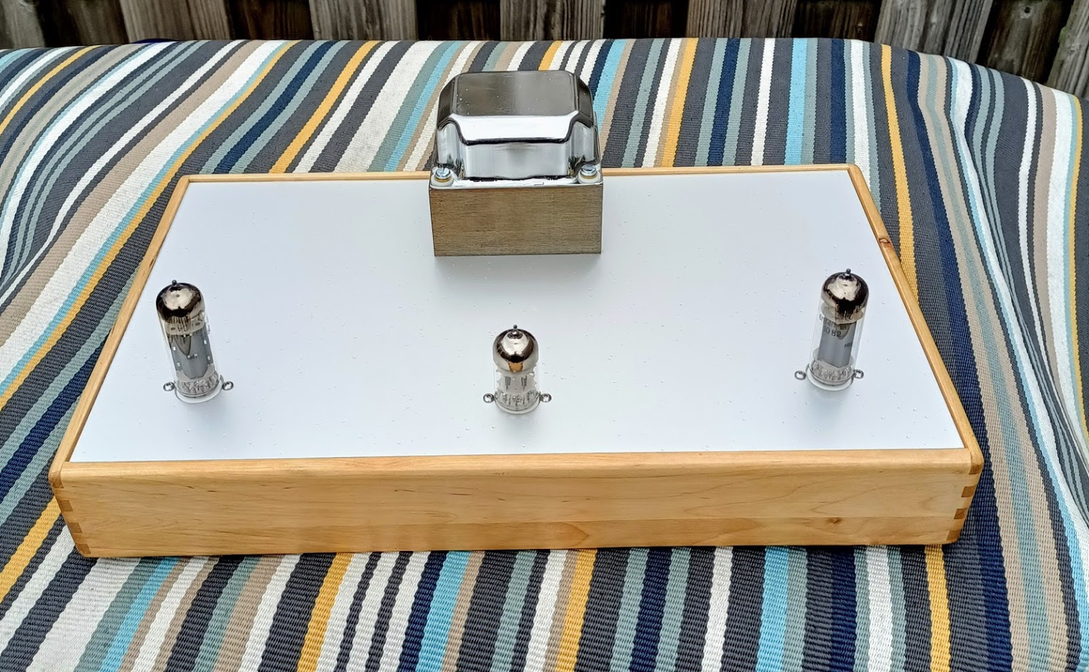

Right!!?. I've never done it with a metal top plate...but I will....just need some time to start.IKEA cutlery boxes are so handy for neat tube chassis. Here is a PL519 SE I built years ago

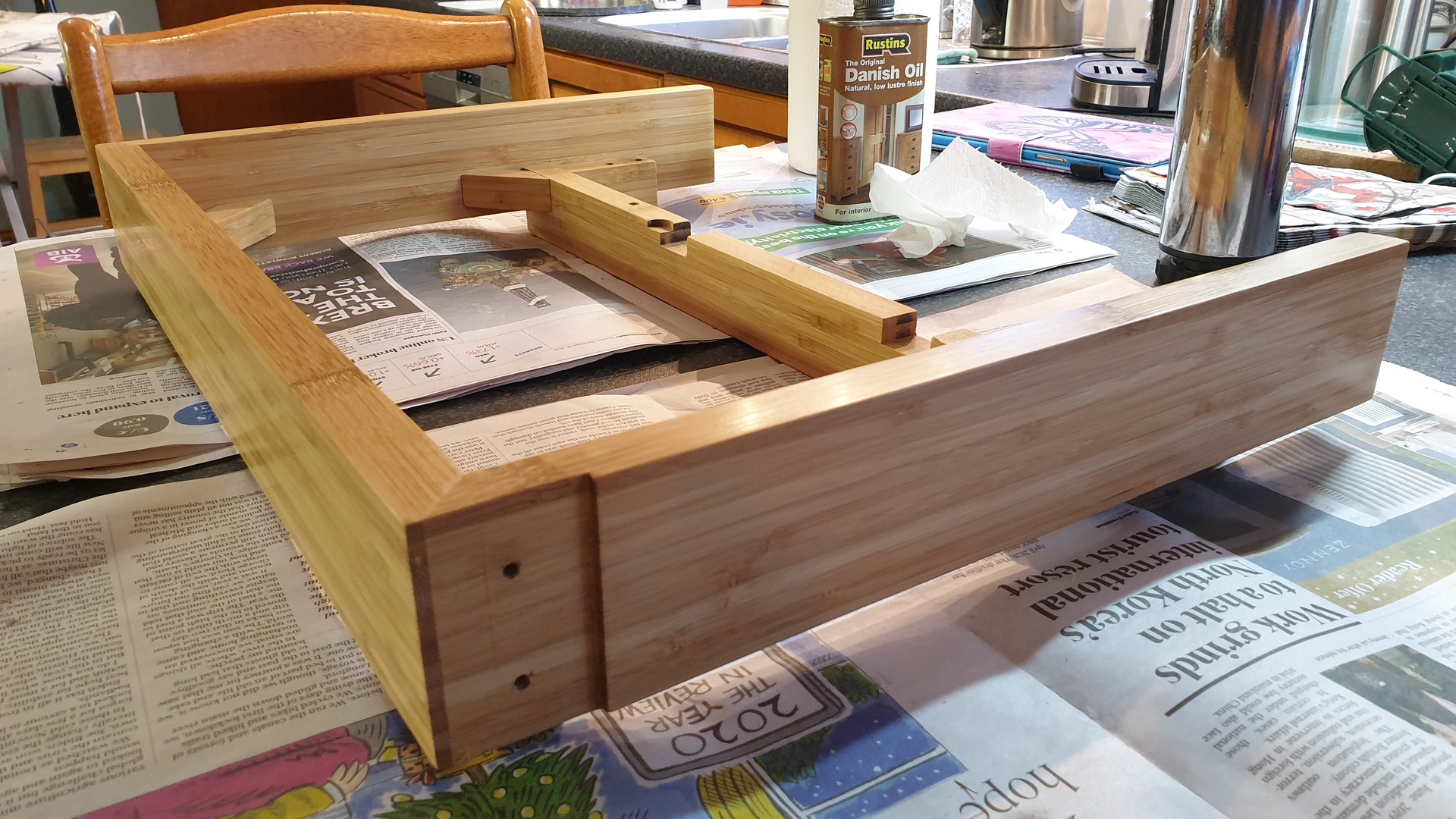

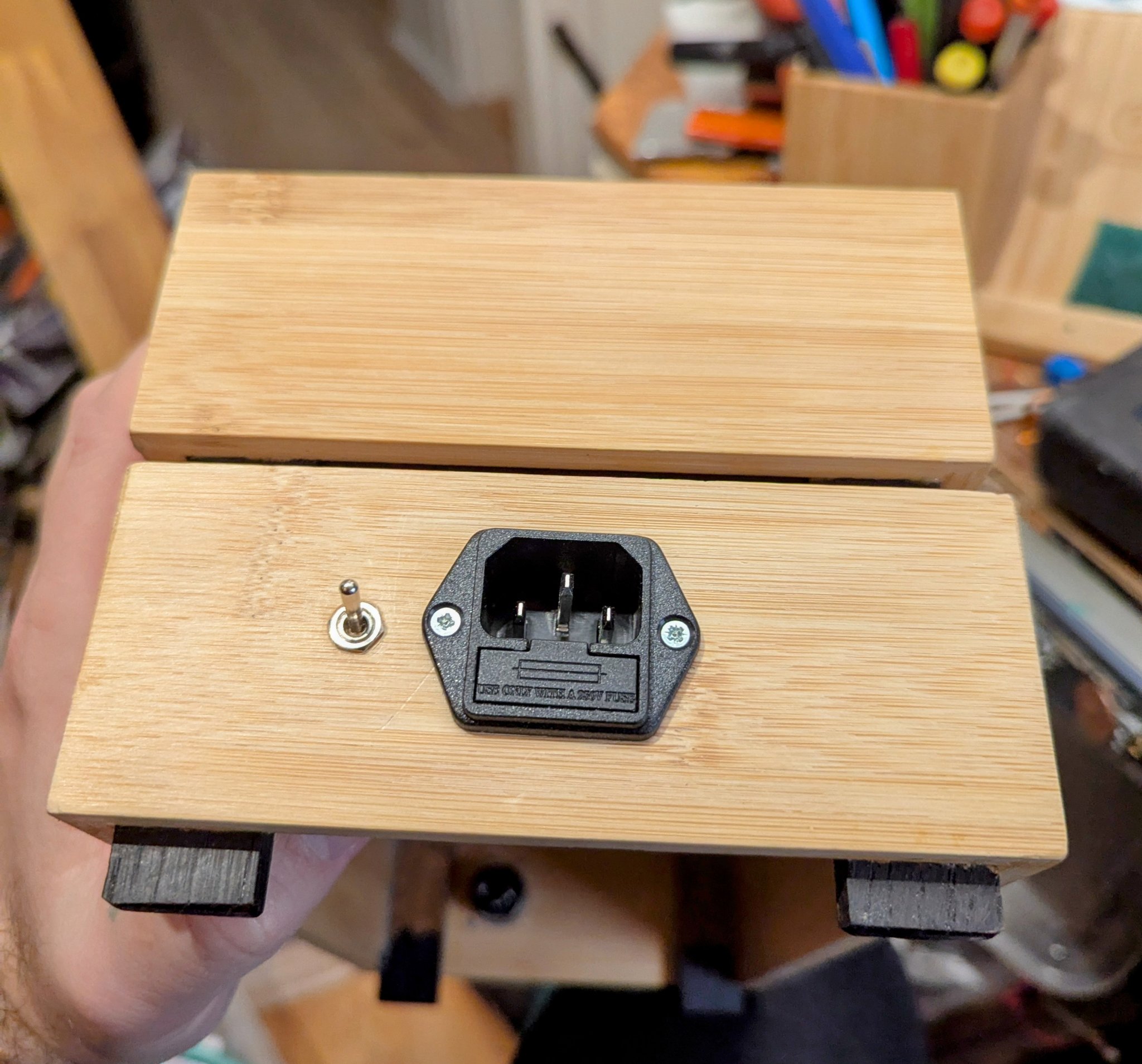

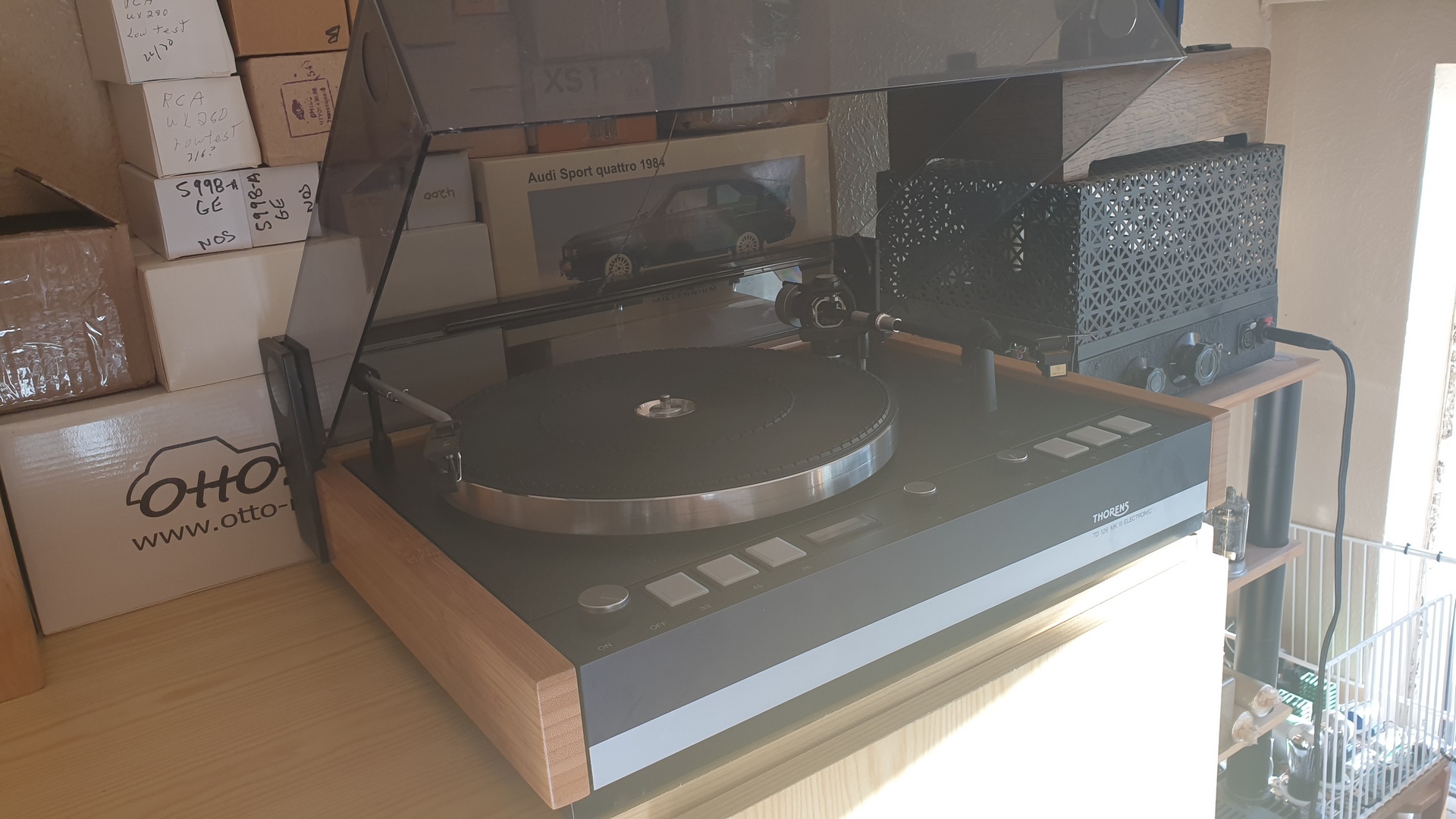

Great job.Restoring an old Thorens table, made a nice new base out of a €20 IKEA Bamboo Shelf
I know the construction has its limits (due to the hollow construction and little weight) but I find it a neat way to "quickly" make a double h-frame for 2x12".

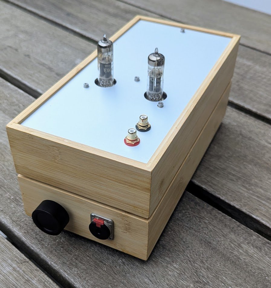

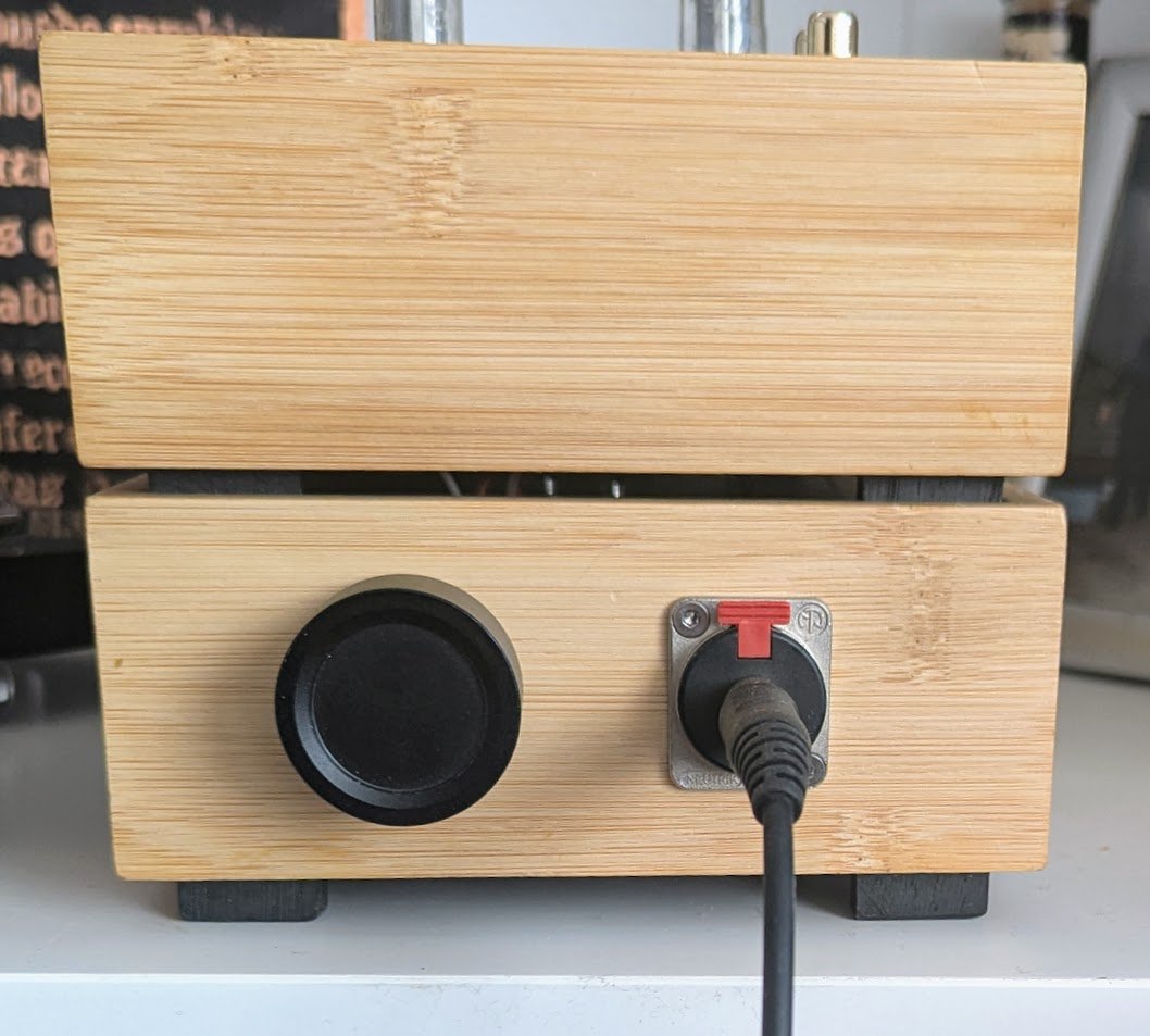

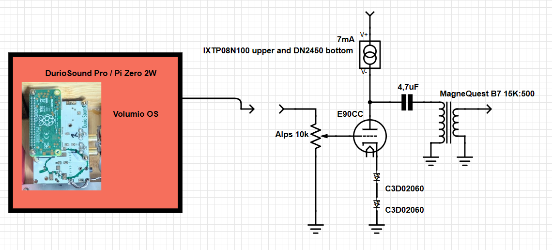

Headphone amp "Torpedo" clone. Parafeed.
Not a good idea to have a double decker by the way. If something is up...I have to unsolder all the wires. CCS is bottom Transformer upstairs...etc etc.
Feet oak from a laminate oak floorboard. Blackened with indian ink.
