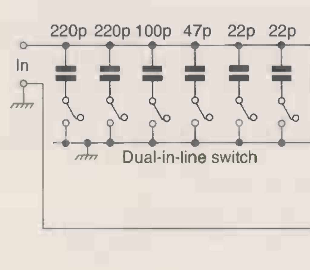

Thanks Hans. I'd figured this out. The missing ingredient is the recommended C. After some searching I've got 100-200p for DL109. But I still don't have a recommended C for DL107 ... though it's probably the same.You can simply extract the R&L values from the models at DC.
Be aware however that not all manufacturers use the same way of specifying, some specify the figures at a certain frequency, which of course does not give the same values as at DC.
Even in this august company, not everyone has a test LP and even then, there are arguments over which ones are pukka.You are right, an electric model is enough to obtain a difference. But still the easiest way is to measure the frequency response of the cartridge with a load of 150 kOhm using a test LP.
The best guide to what works is the maker's recommendations. We sorta know this for 47k & 100+pF cos that's what most MM cartridges were designed for.
@marcel, thx for explaining, but we shouldn't worry about a few tenth of a dB difference in this specific case, because with both graphs it's obvious that without any further correction this substitute for the Riaa 75usec pole is not the way to go for this V15 III cartridge.
Absolutely! 👍
Sortof! 😵
Early Japanese MMs were designed for 100K - not 47K.
And the specs for my Stanton WOS CS100 say 47K ... and 275pF.
I think 100+pF means > 100 pF, and 275 pF > 100 pF.
If you want a moving-magnet preamplifier to work well with the vast majority of cartridges, you have to make the input capacitance selectable. Hence the DIP switches and capacitor bank at the input of the preamplifier that was the original subject of this thread.
