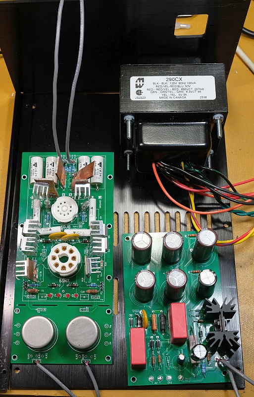

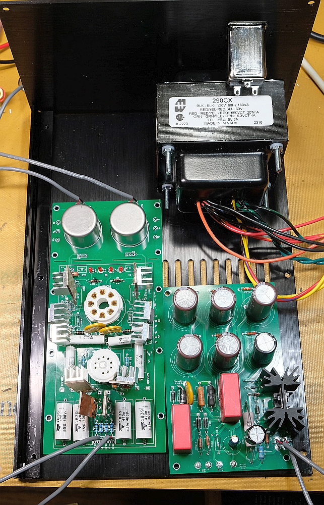

A question for the more experienced folks on this thread/build. Finally got a case in yesterday. On my other preamp builds I have gone with wide and deep cases, with good separation between power supply and preamp board and in and out connectors.
Here I am trying to keep a more modest size allowing for the height of the transformer.
So the questions I have are, will there be issues with the transformer and PS right beside the Impasse board, and/or if there isn't then would I be better facing the input transformers to the rear allowing for a close connection or flip the board so the outputs are closer?
Or does any of this really matter? Photos attached.
Tnx
David

I don't qualify as one of the more experienced, but here is my two cents.
1. input signal a short run to the Impasse board. tightly twisted of course.
2. trafo at the opposite end of the case from the input
3. if you have to run the mains power and the input in the same panel, have the mains power cord run as far from the Impasse board as possible and at roughly the same level as the Impasse board. I have read that a source that is edge level to a pcb with have less interference than on at a big height difference.
4. I might turn the opening in the trafo bell away from the signal pcb. I couldn't manage that because I had the F4 pcb on the other side.
In one build, I put the trafo at the front of the case and put the mains inlet on the side of the case with a 90 degree power cord. That way I got some shielding from the power cord by the case. It also meant a short mains run to the trafo. That meant the back panel was only input and output.
In my Impasse/F4 build, the mains power inlet is about 4" from the closest input transformer. The power transformer is 7 or 8 inches from the Impasse input transformer. It's closer than I would like, but the unit is quiet regarding hum. I admit, I was worried about this.

Good advice all. I think I can keep the case I just board for another project and order a roomier case from the store, then I can spread things out.
Thanks guys
David

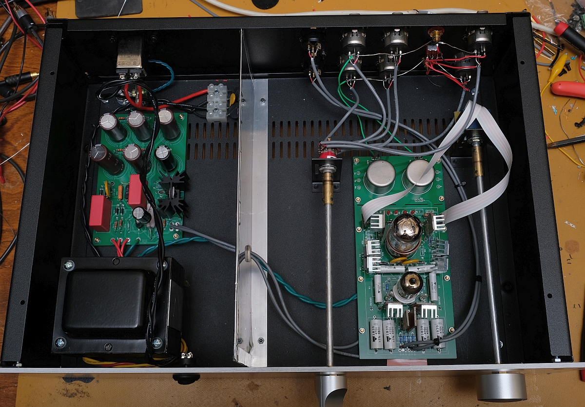

Thank you all for your insights and Jack for the boards. Went with a roomier store case per suggestions and a mu-metal divider to keep those nasty fields at bay.
A very nice addition to the F4 and MoFo amps I have constructed. I have recently completed the AKSA Lender preamp with higher gain daughter boards. So a listening session with the Pass diy BA-3, Sy's ImPasse and Hugh's AKSA Lender preamps driving the F4s seen in the photo will be forthcoming.
Regards to all,
David
