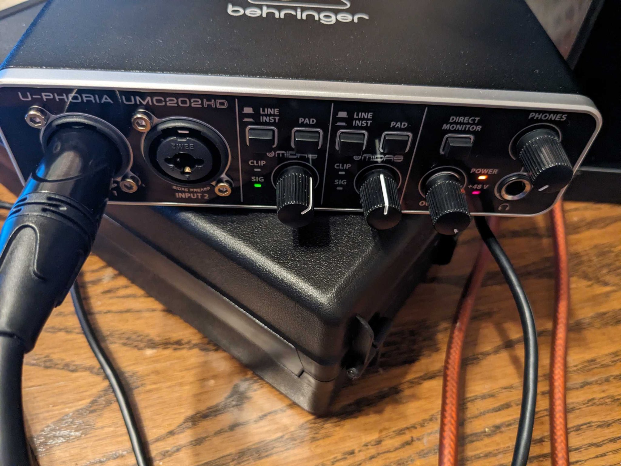

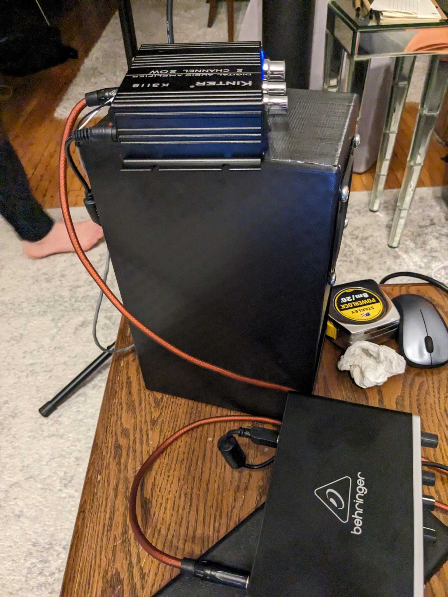

Yup, just picked up a bunch of measurement equipment.
