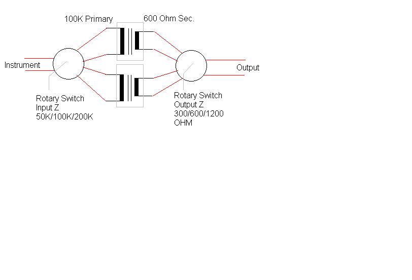

Hi Fezzle, As you had mentioned you are thinking of doing this for a bass guitar..I guess you may not be concerned about loss of twang. You are looking for a particular response from the DI transformer. One thing under discussion is amp input impedance which is a resistive/capacitive load. The DI transformer input is inductive/resistive (and bit of Cap).
I got to thinking that for a bass guitar this could be actually quite good for tone response with a reactive load of the DI transformer. In this case with passive pickup to transformer you are actually reinforcing the response at the low end frequencies.
When I said that those types of transformers typically are at max 100K range here is a trick that you can look at to play around with varying the impedance and response to your taste. If you have a 5 way pickup switch on your guitar, you know that you can play around with selecting 2 pickup coils in parallel, or series (phased in or out) for different sounds. You can do the exactly the same with 2 transformers. Series connected primaries will give you double the input impedance, parallel will drop it to half, and same goes for the secondary sides.
The picture above is showing a typical 5 position rotary pickup switch ( like on a PRS style)
I will just make a quick drawing to show what I am getting at.
