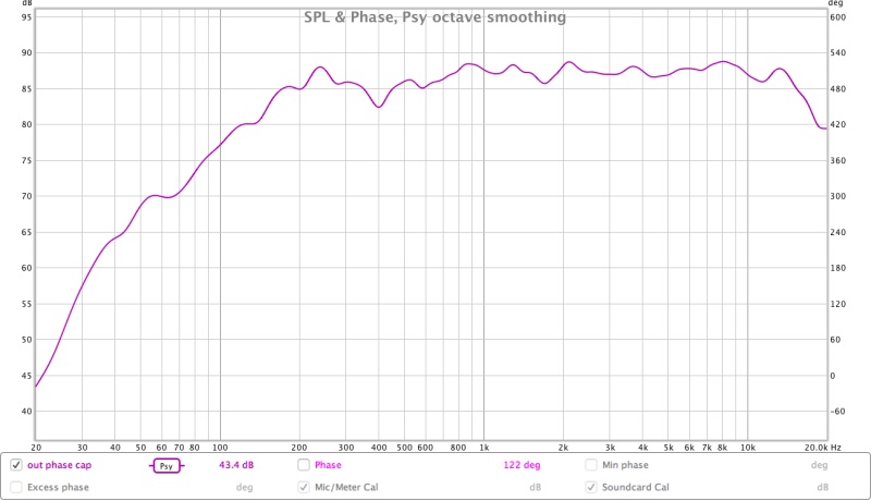

I just revisited the TC9 in the Nola clone, and I finally got it right.
Just by playing with C-C distance and phase, I was able to get the flattest response I've ever had or seen for a setup without active EQ, passive notches nor even BSC, and only one capacitor in the whole signal.
Clean, clear and detailed...
Measurements and pictures here:

I have them wired in parallel, with the 20uf cap between them. What it seems to do more than anything is; restricts the excursion of the top driver allowing it to still allow the higher frequencies, much like a tweeter. In the current setup I am using, The subwoofer is a key part so all the TC9's really have to do is mids from 105-ish (I go to 120 crossover to relieve it to even a lesser level of distortion at higher sound levels) up. I really thought I was missing a tweeter initially but now, it's all there. These things are sweet.
I'm using very little EQ at the source since it comes from my PC to the amp. All other tone controls are off.
Here is how much EQ I am using to boost the high frequencies into tweeter territory and it is not much. The bass frequencies are only really directed at the sub, since it is crossed over at 120hz, with just a tiny bit of mid bass boost on the Nolas, possibly somewhere near the roll off between them and the sub. I have some good speakers for reference and the little Nolas are holding their own among the best of them.
ETA: If I boost the frequencies from the 4-16k sliders any further, I could actually make these speakers quite bright. Less, and they start to warm a bit.
These speakers, and perhaps the drivers themselves shouldn't be given up on too quickly. I notice this with a lot of different speaker designs across the net, including the Fusion Tempests that I own. Users essentially condemning them to HT duty only. After a day of listening and analyzing my own, I had them dialed in to a very musical pair of speakers to where my entire living area is a sweet spot with zero room issues.

I need to try a vented version, but with the bottom TC9 sealed, thus cutting short lower than 200Hz, I was able to get a really nice flat response. No EQ applied to get this.
There's more to the 20uf cap than just limiting excursion to the top driver. Having done a bunch of tests, I can see it also affects the mid and lower end by eliminating overlap, and the out of phase also helps flattening the response.

This is without any EQ, and only that 22uf cap I had ( the 400Hz dip I believe is room related) ...
