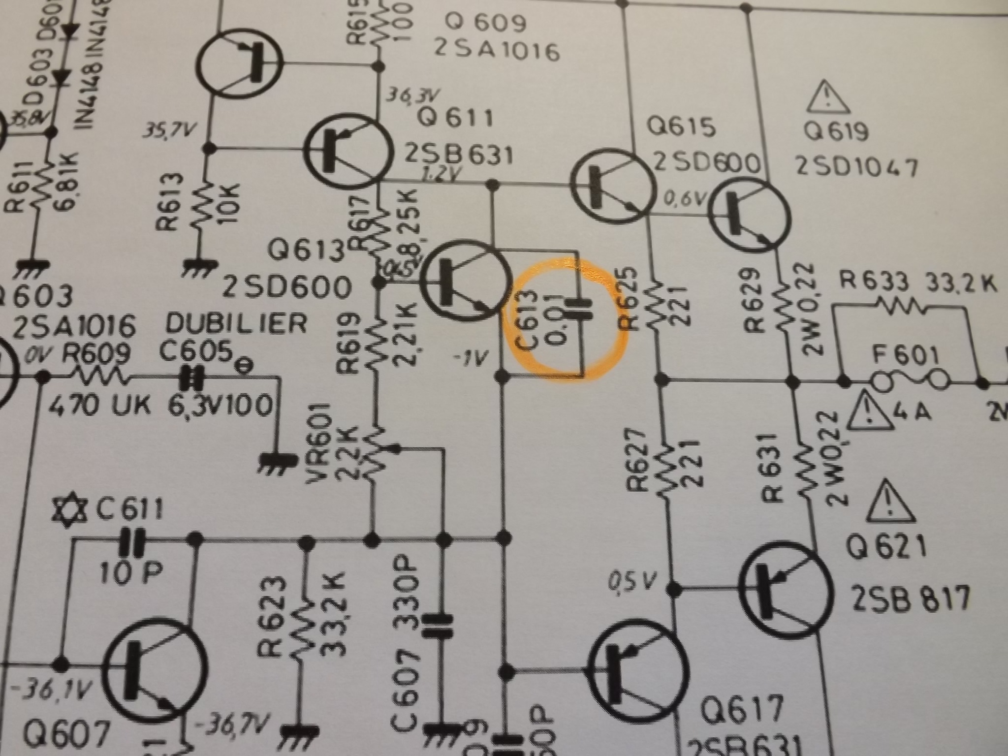

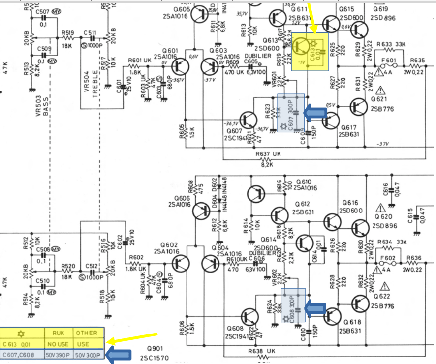

In post #889, I talked about C607 NPO 330 pF from the section of the circuit given there, and not about C613. In post #890 it's C611.
Hi Sam,
I am sorry that you are confused. I (and probably others) didn't notice that you changed the subject from the circled component, so let me try to clarify:
I was talking about the capacitor marked in yellow, whereas I think that you are about the ones in blue. Ok, let's discuss the blue ones in this post.
These are Rotel's unique way of stabilising the amp, providing a heavy lag load on the VAS collector. Most often they put in a parallel 33k resistor as in the RA-810A schematic above. It is brutal way of quenching oscillations, but it works (albeit with the resulting audible Rotel "softness" distortion).
Note the complete absence of b-c Miller capacitors around the VASs Q607/608.
Is the value critical? Well, yes and no.
Note the 30% (!) variability in value in the note box on the left bottom depending on what I always believed to be 'region' - but I am not absolutely sure what "RUK" stands for. (I mean, it can't be "Republic of the United Kingdom" as that would be quite an oxymoron.)
Does anyone reading this thread know?
And what regional(?) differences would warrant such differences?? Anyone?
Yes, if you use ceramic caps here they should always be NPO, although after the 800 series Rotel switched to Polystyrene film caps.
The caps marked in yellow is another issue. Why should one 10nF be used in the right channel, but (sometimes) not in the left?
And as they don't directly contribute to amp circuit stabilisation - why would placing a cap there cause instability? That is the subject of the next post.

Don't know what RUK may be, but out of curiosity I checked the service manual for the 976 and noticed something similar:
C607 / 608 (blue capacitors) are tagged 330pF in the schematic, but 270 pF in the BoM
C611 / 612 (in the -976 schematic, C613 / C614 in schematic above) er 1uF polarized in schematic and BoM
6) What happens if you put in, say, a 1nF (or 10nF) instead?
This will lead to amplifier instability (changing the values of any polystyrene capacitor, regardless of its location on the circuit).
