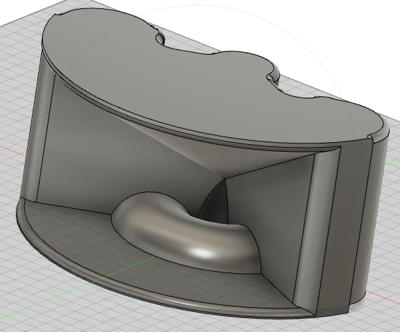

![tcsGivX.jpg](https://imgur.com/tcsGivX.jpg)
Here's a pic of the device that I 3D printed
Here's the Beolab 9, for comparison.
The lens is basically the same. It's not as big as the lens in the Beolab 50, and it's comparable to the size of the lens in the Beolab 9.

![k5Z7cxj.png](https://imgur.com/k5Z7cxj.png)
Here's the equalized horizontal polars. I think this performance is really good.

![cbrzbxK.png](https://imgur.com/cbrzbxK.png)
I think that the biggest opportunity for improvement in the B&O lens is that the vertical beamwidth is ridiculously narrow. Literally less than 10 degrees. Here are the vertical polars on the device that I printed. This covers just zero to eleven degrees, and you can see that there are *significant* variances even in that window.
My hunch is that the problem is twofold:
1) The plates at the top and the bottom are parallel, and this leads to harmonic resonances. Note in my EQ settings that I'm using EQ to tame harmonic peaks in the response.
2) If the microphone is above or below those plates, the response becomes terrible. I believe this is due to diffraction off of the edges.

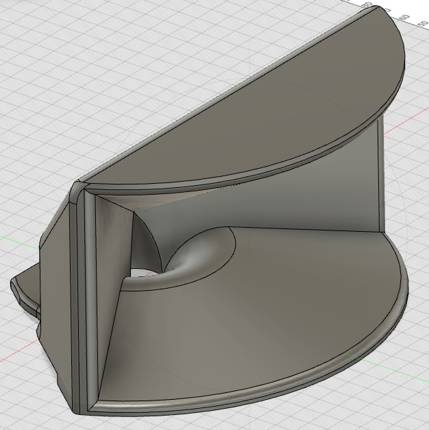

![uHucBxp.png](https://imgur.com/uHucBxp.png)
I made a 2D model of the lens I built in hornresp
![wXV55CY.png](https://imgur.com/wXV55CY.png)
Here's what the wavefronts look like at 15khz. Note the vertical null.

In one of my most successful lens experiments, I recessed the lens. So I tried doing that here. This seems to be effective. I was a little worried that recessing the tweeter by half an inch would be problematic, but it doesn't appear to be.
Something that IS problematic is a tendency for the vertical nulls to shift with frequency. For instance, at 20khz the null is straight ahead, whereas at 15khz the null is shifted upwards. This isn't ideal. I can live with off-axis nulls, but I don't want them 'wandering' based on frequency.

I tried angling it, but it didn't seem to improve things. One of the Bang and Olufsen patents has the lens angled *backwards* about 15 degrees. But the current device is flat.
Something I *did* notice is that the HEIGHT of the diffraction slot appears to make a big difference. 20khz is less than 6mm long, and I think what's happening is that when the diffraction slot is too large, the pathlength differences inside the slot itself start to wreak havoc with the response.
