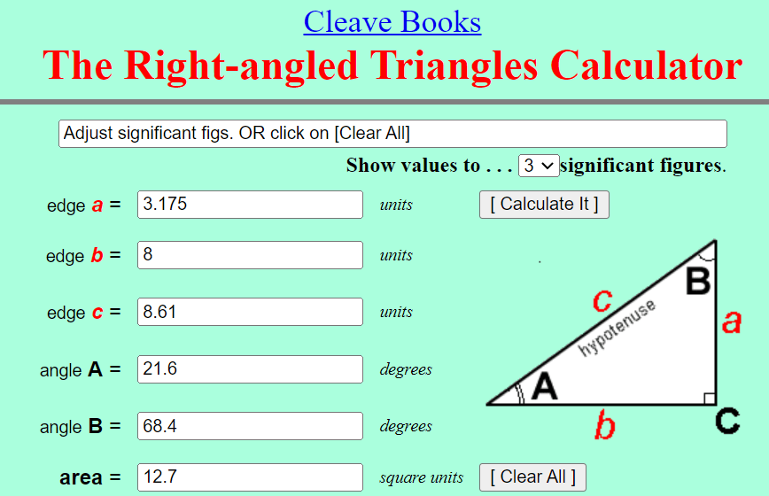

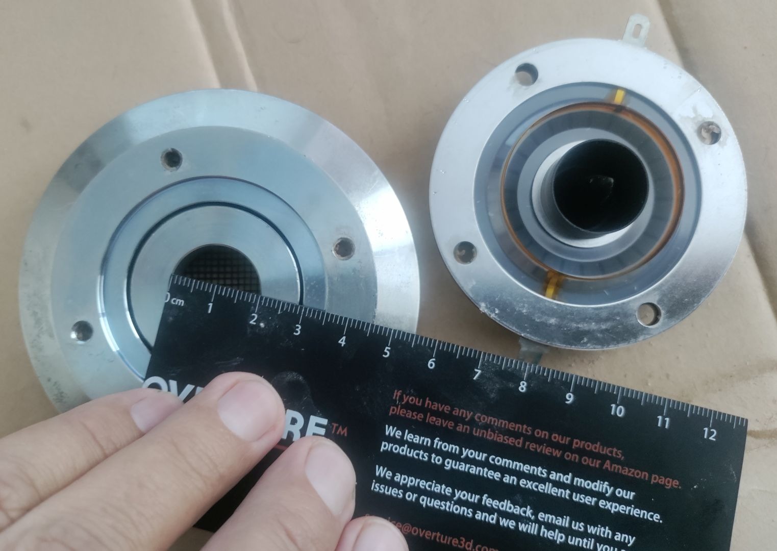

I took my N151M apart, and the exit angle is sixteen degrees.
I think when I calculated it the first time, I got the measurement off by 100% in my 3D software where I made the sim.
I took my N151M apart again, and learned I was right the first time lol
In fact, it looks like it's even wider than I thought, my calculator says "43.2 degrees"
Pictures of the phase plug and the math are attached. Basically, the exit at the phase plug in 19.05mm wide, and the expansion begins inside the compression driver itself. I think this is one of the reasons that the N151M has excellent polar response all the way up to 20khz; it doesn't really behave like a one inch compression driver it behaves like a 0.75" compression driver. 13,500khz is one inch long, and "typical" one inch compression drivers start to beam at 13,500khz because of this. 18000hz is 0.75" long, which is why the N151M doesn't beam until 18khz:
It's a testament to the good behavior of ring radiators, that the wavefront flattens out like CRAZY at 18khz. That's what that dip in the polars is caused by; you can actually see that it abruptly transitions from a beamwidth of 43.2degrees to a beamwidth of 0 degrees in a fraction of an octave.
