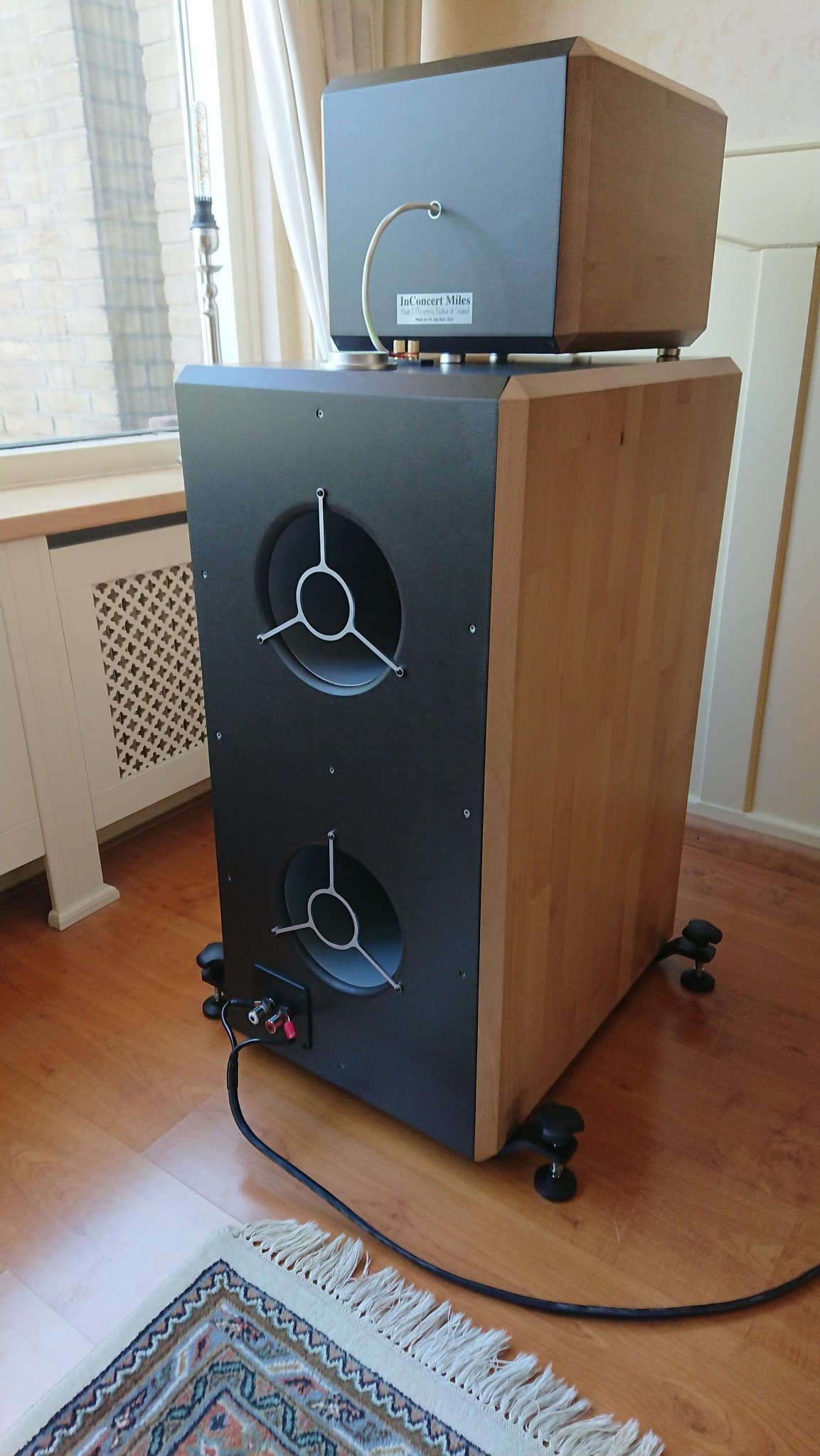

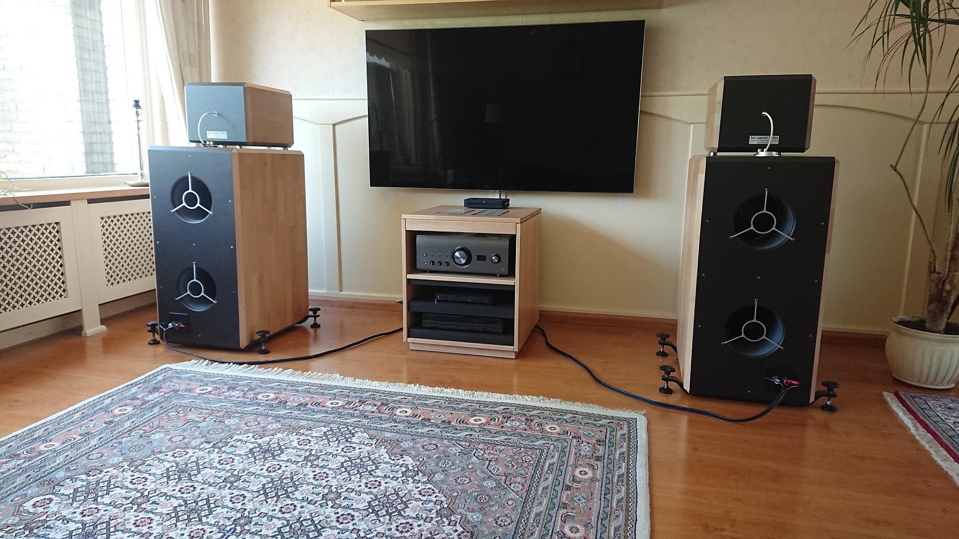

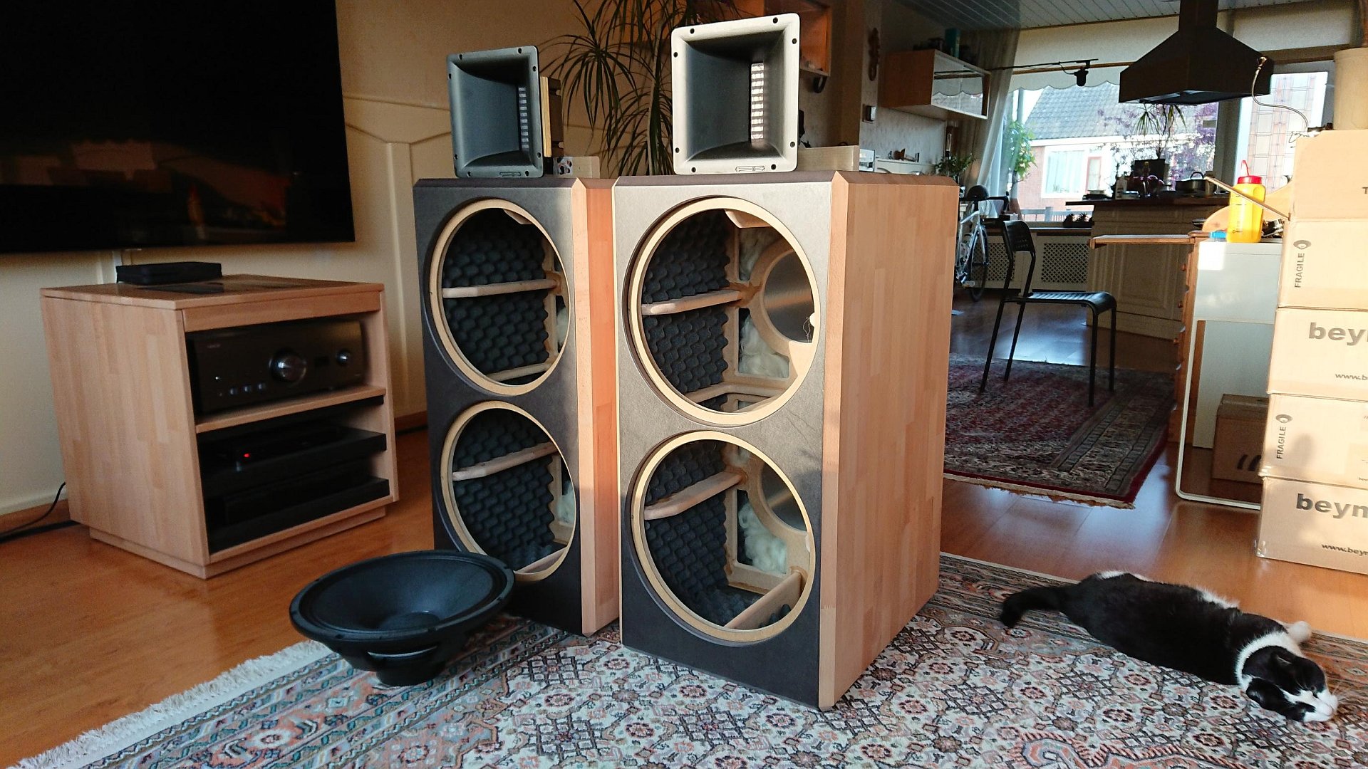

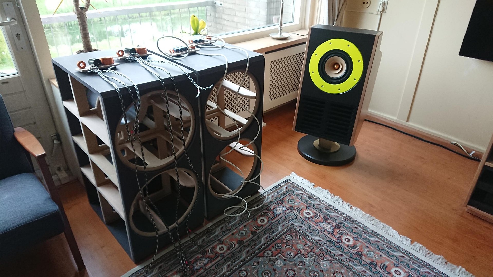

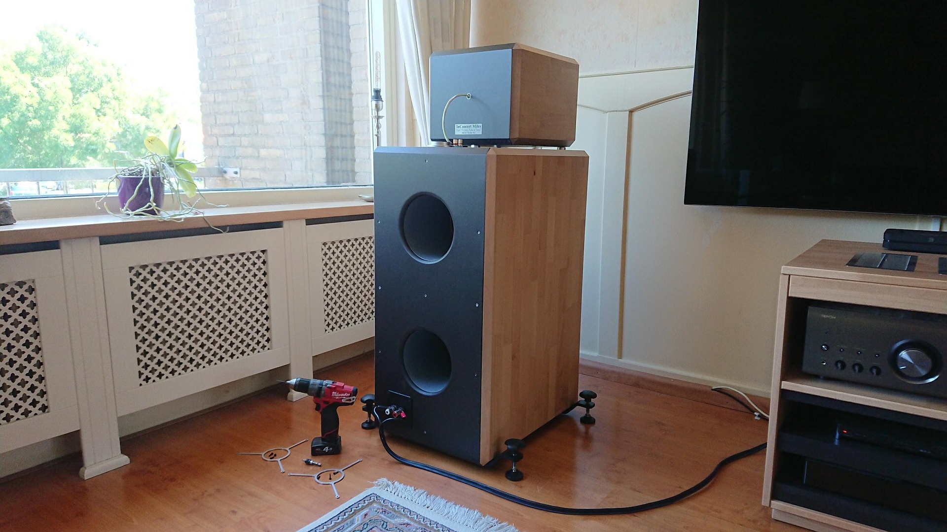

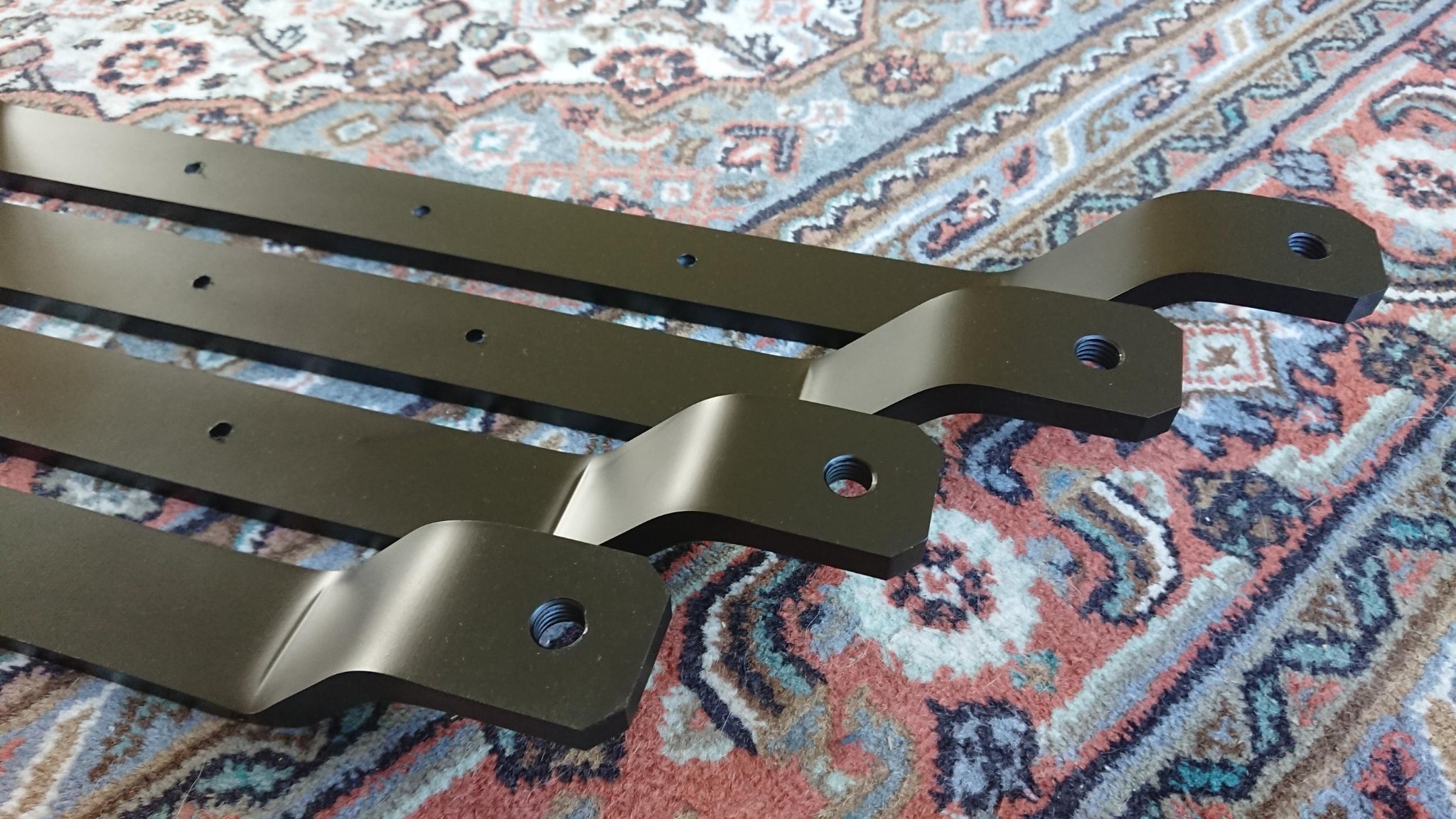

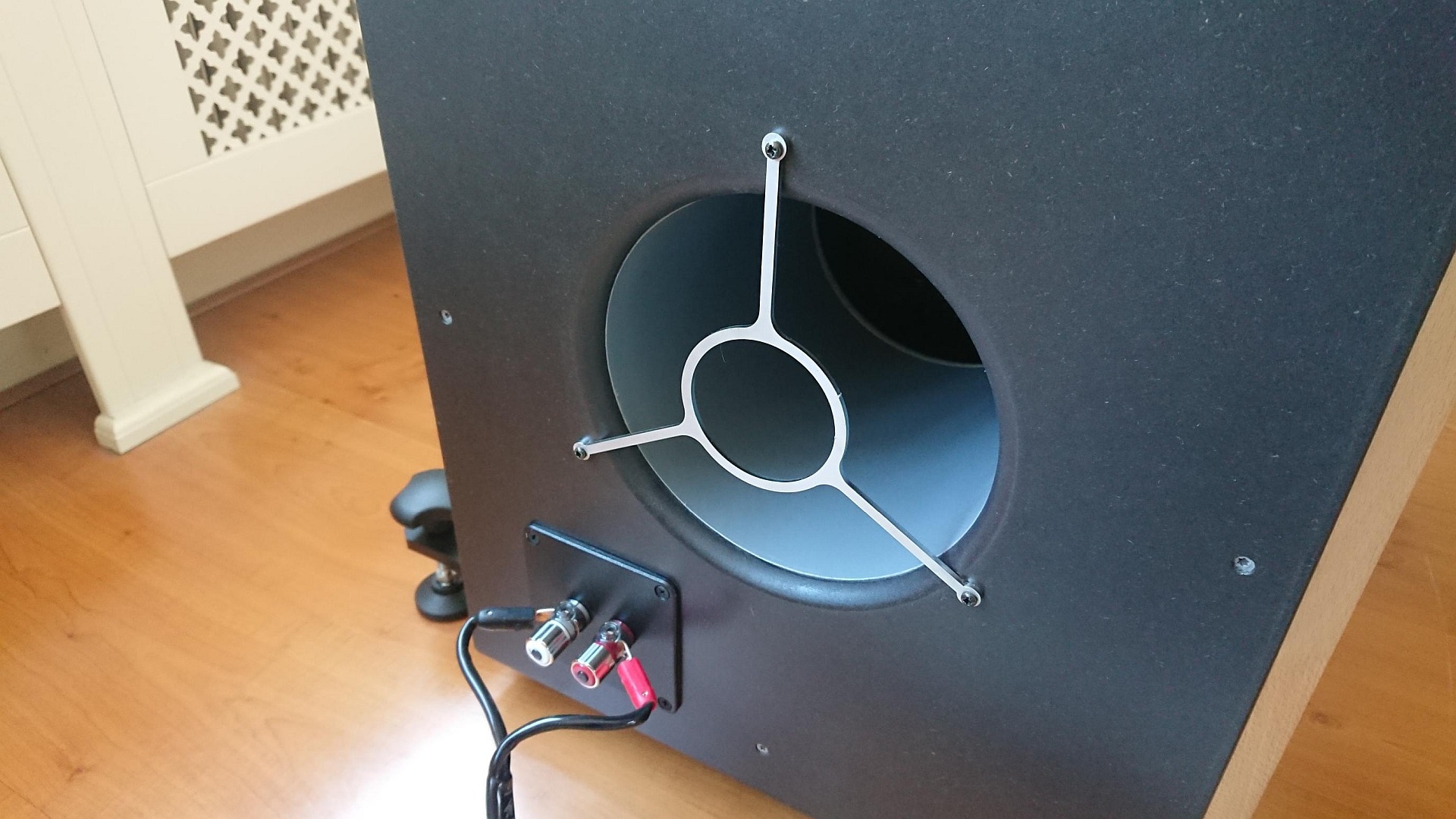

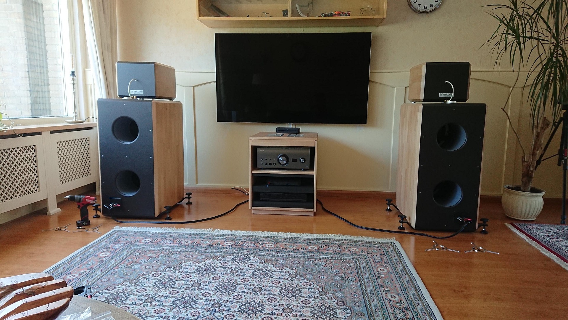

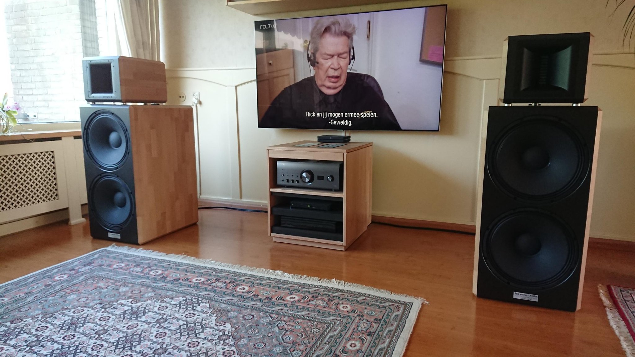

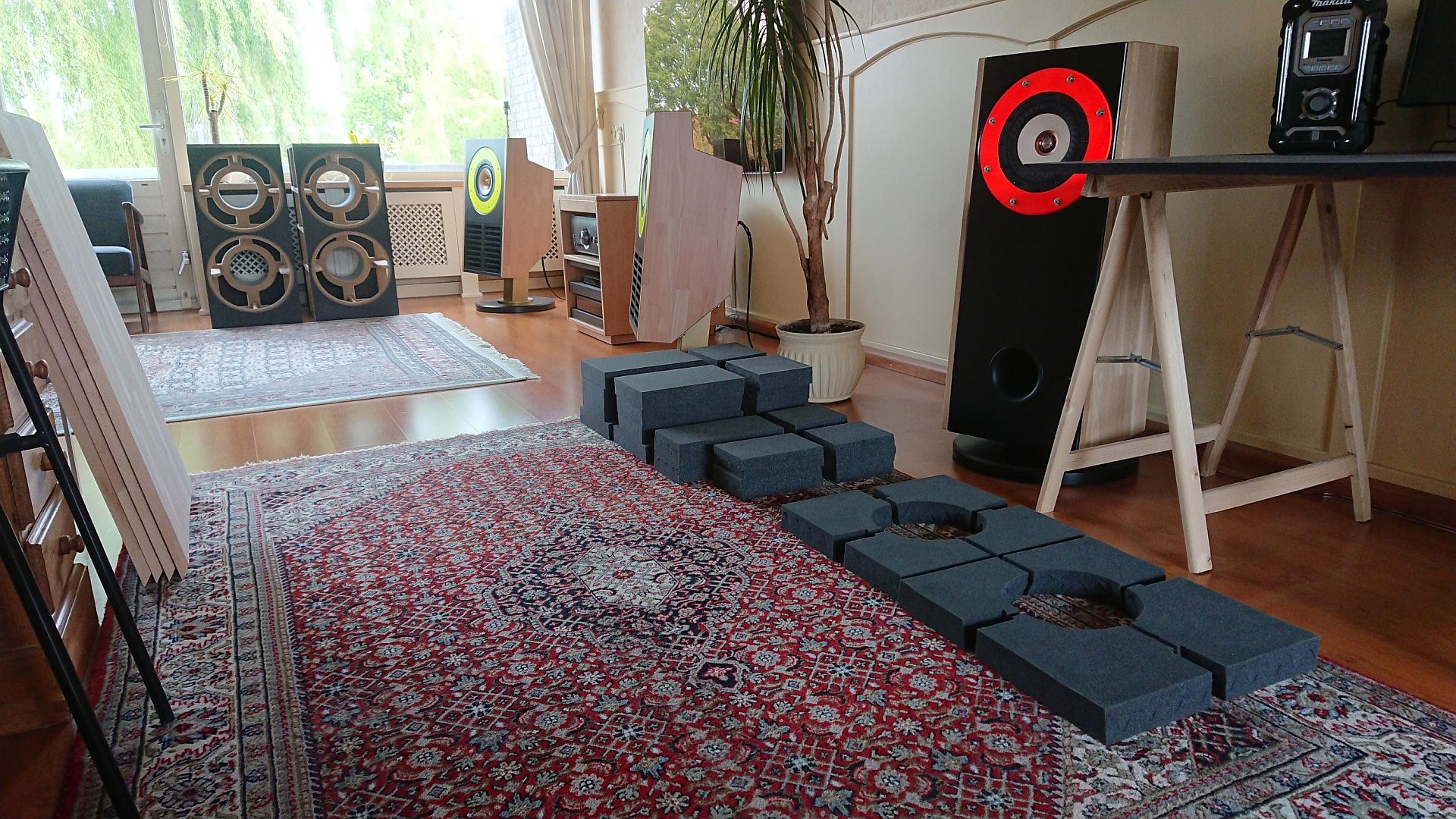

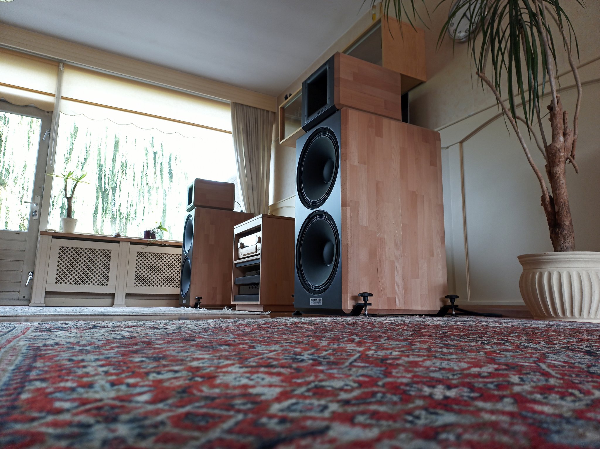

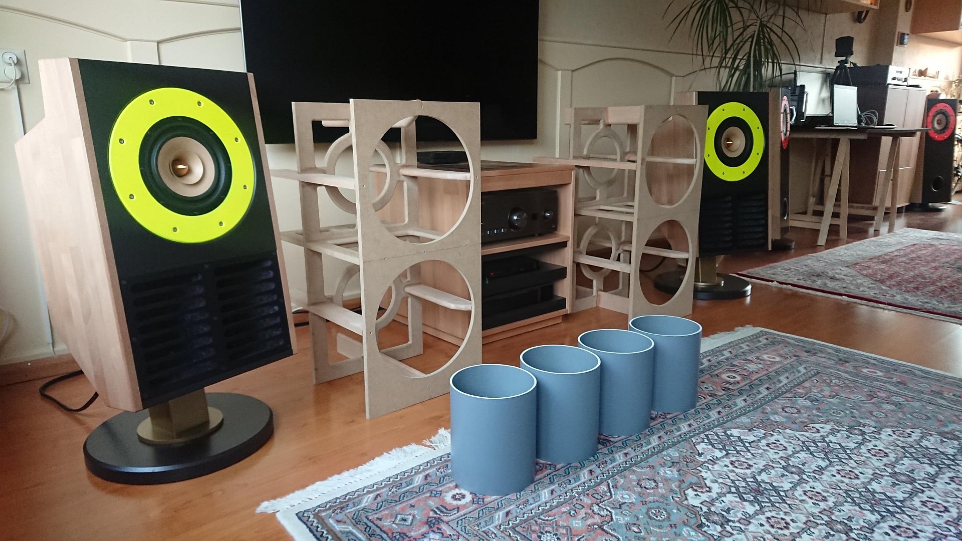

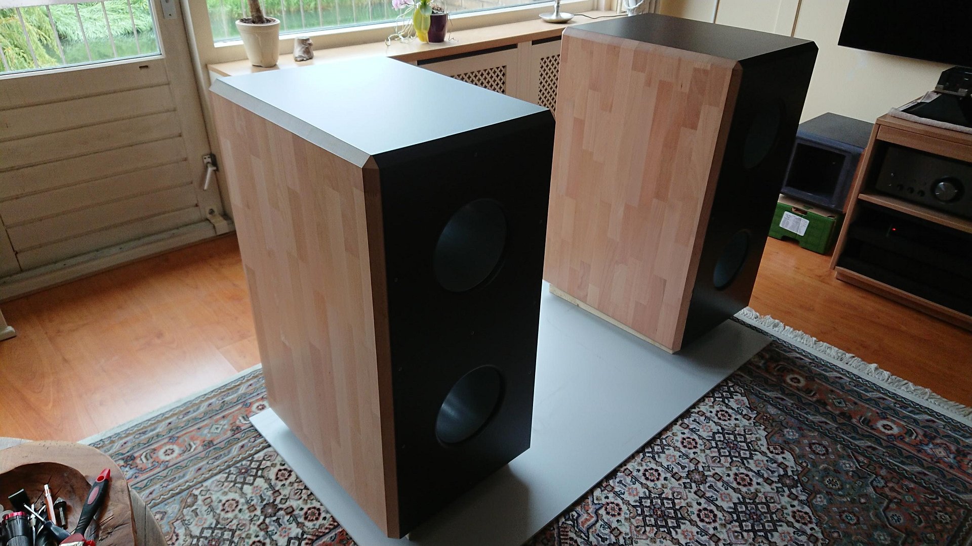

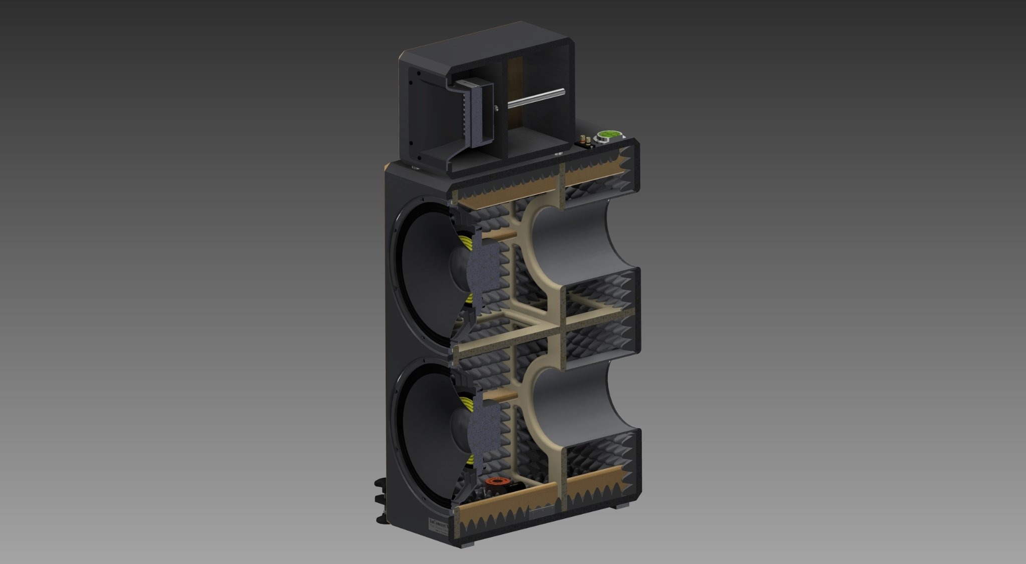

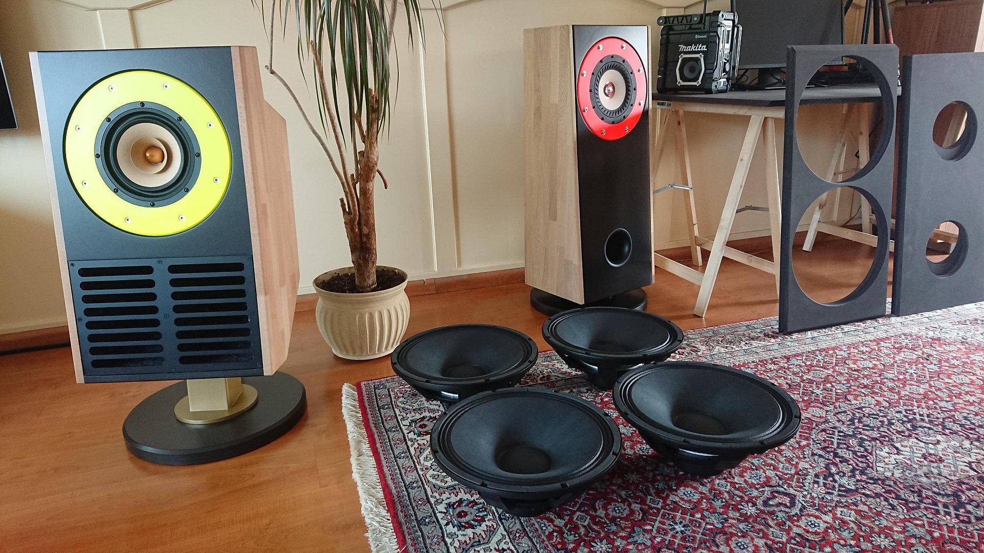

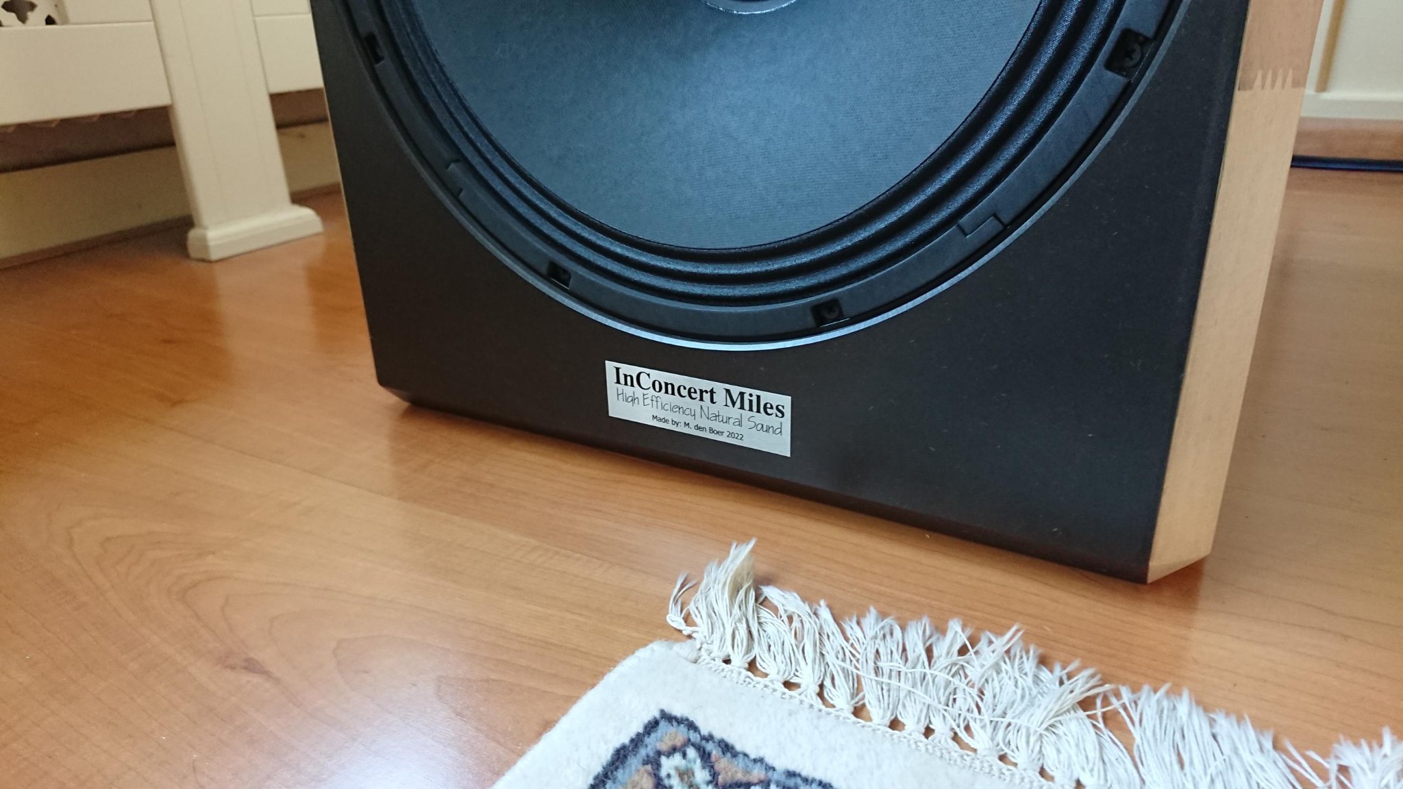

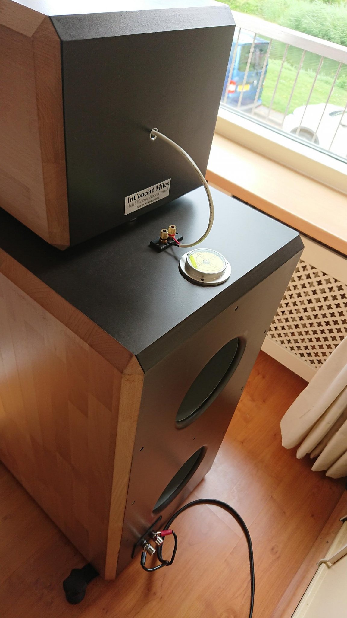

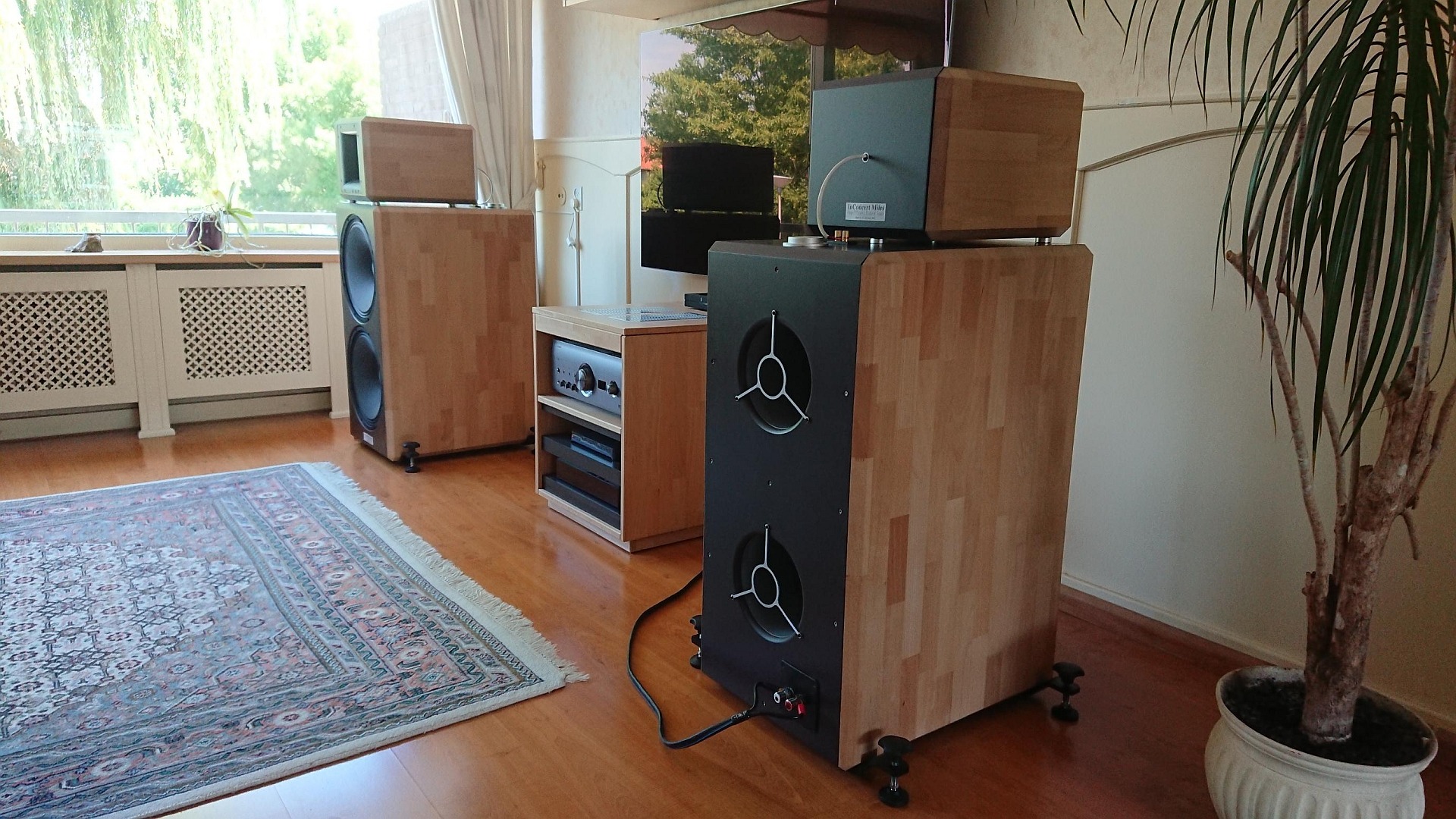

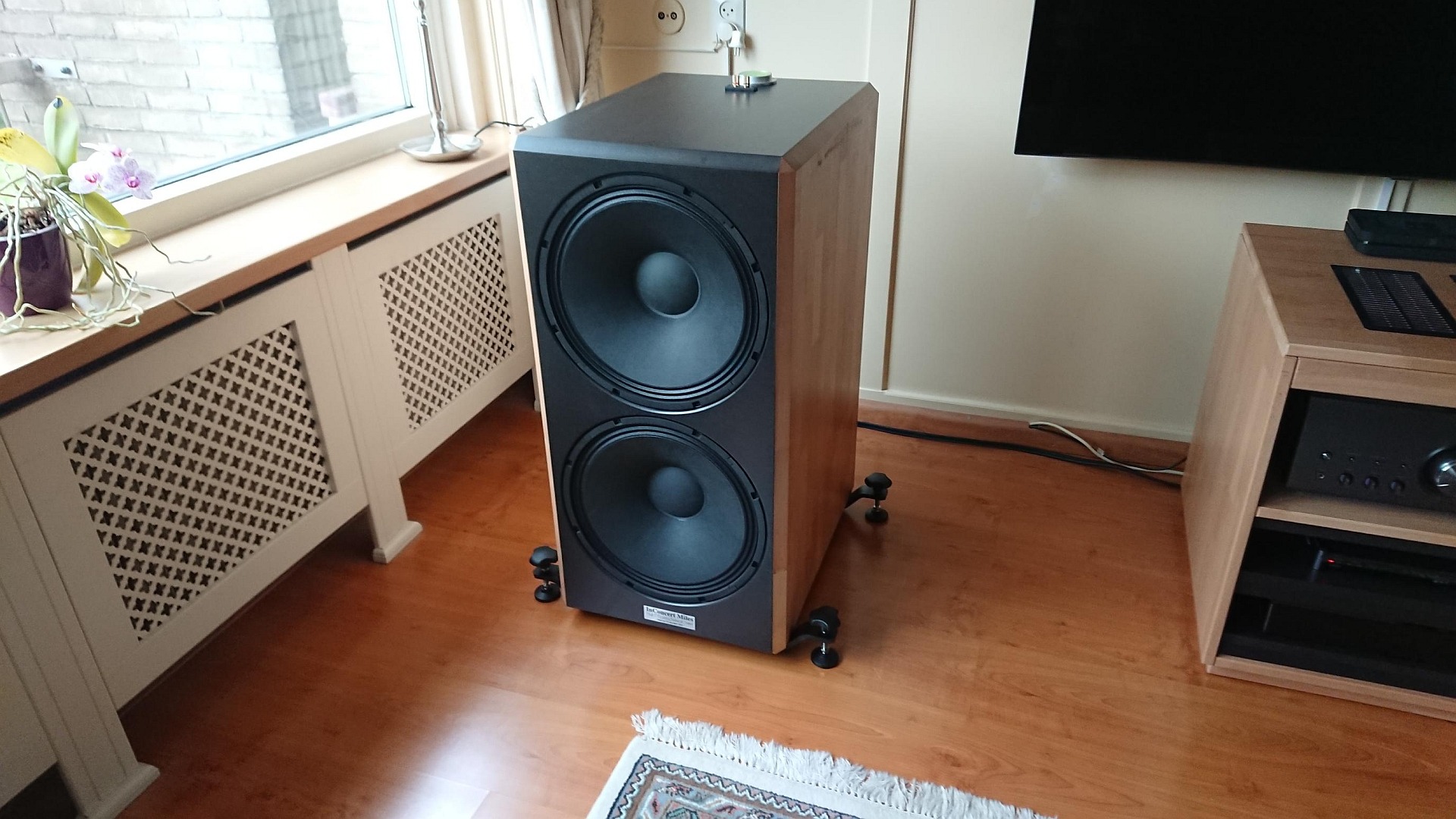

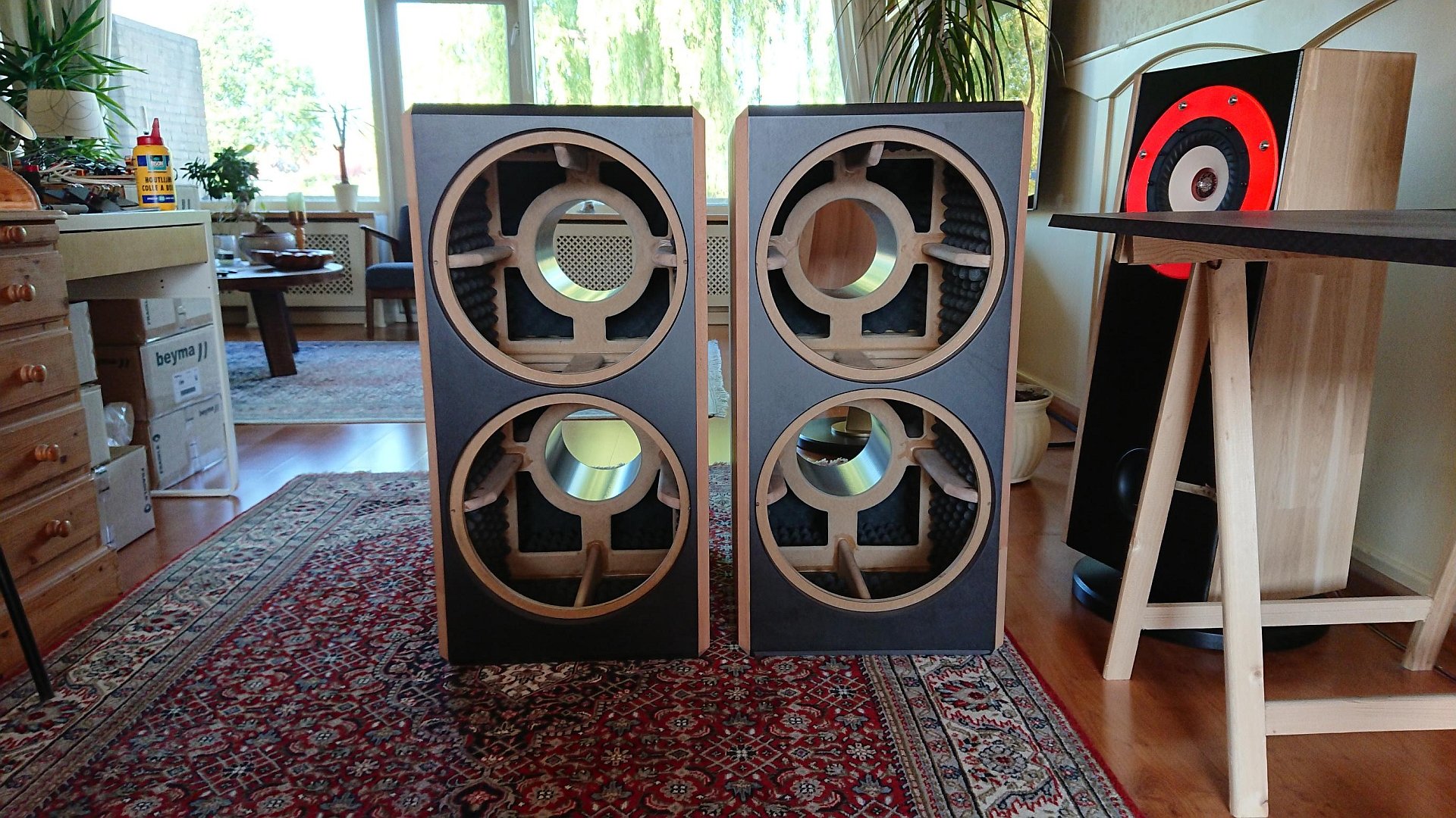

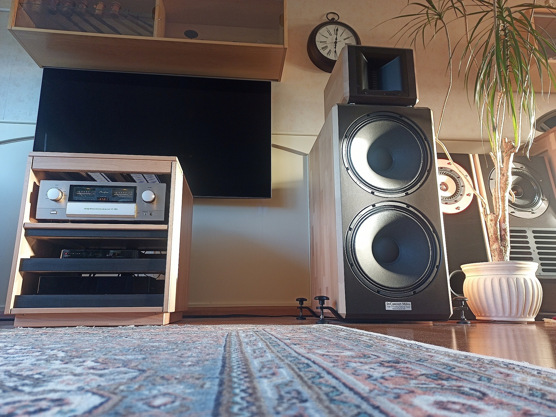

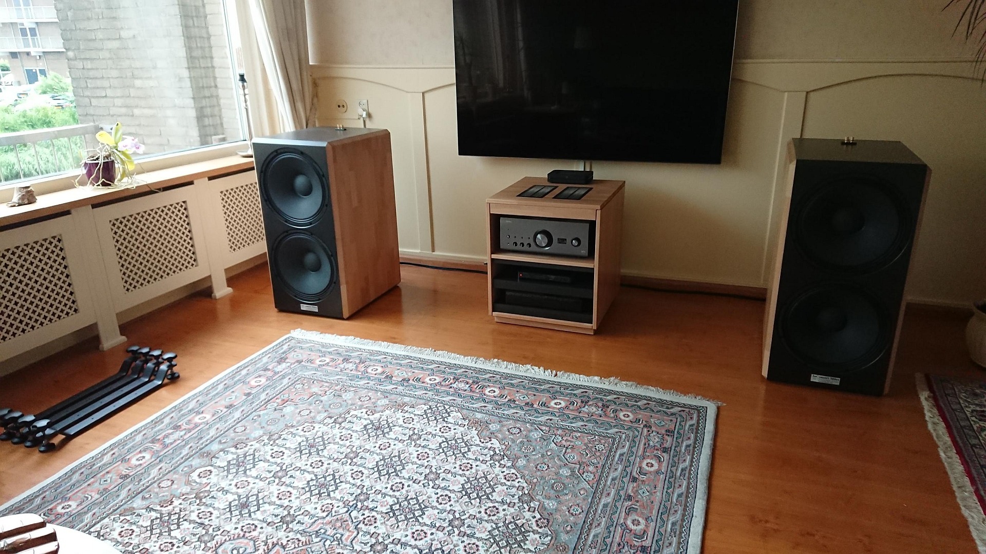

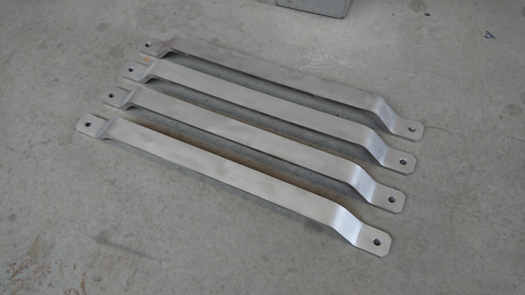

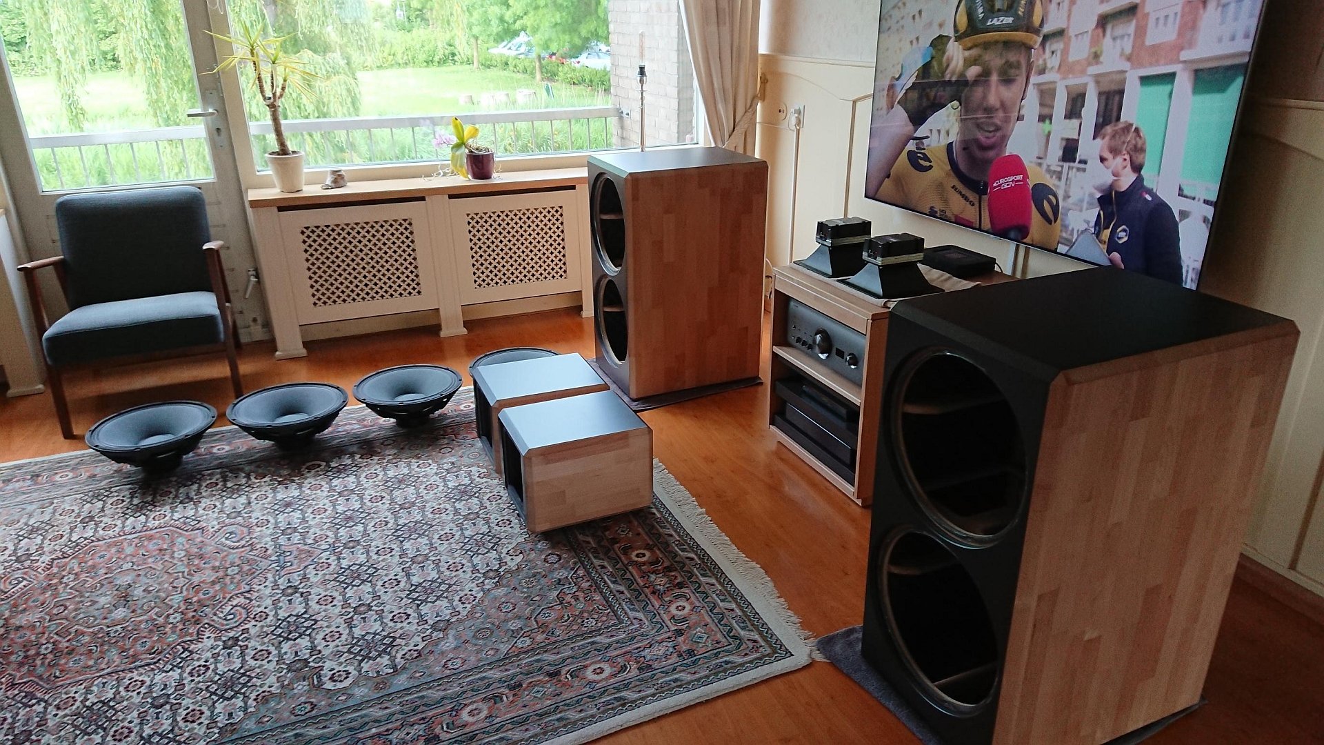

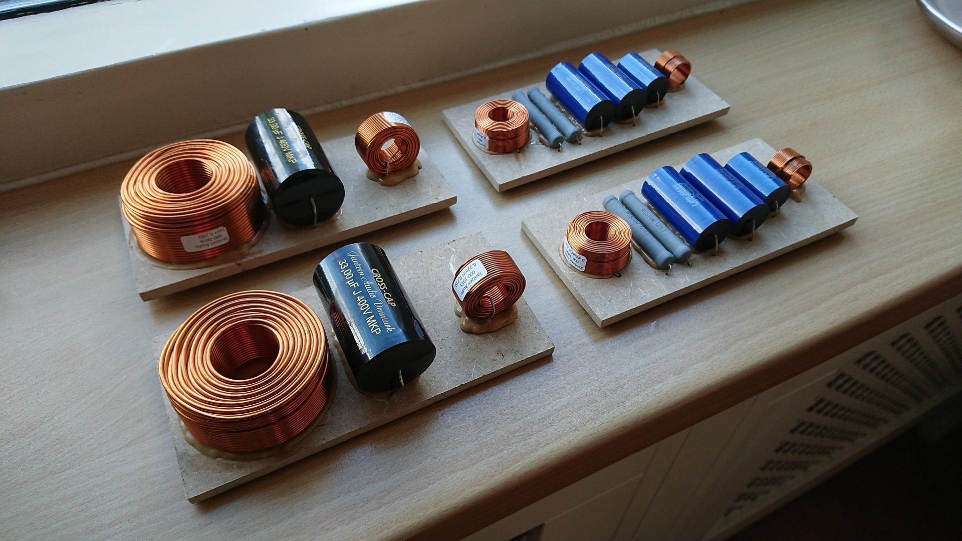

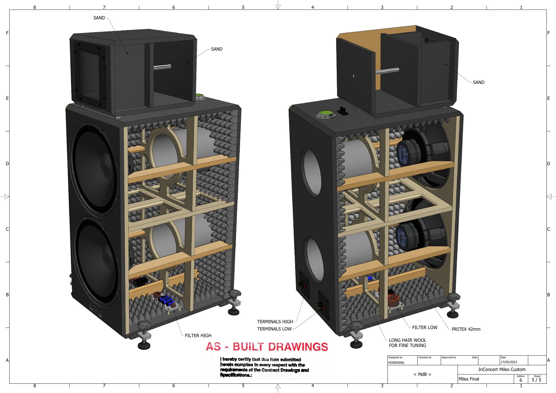

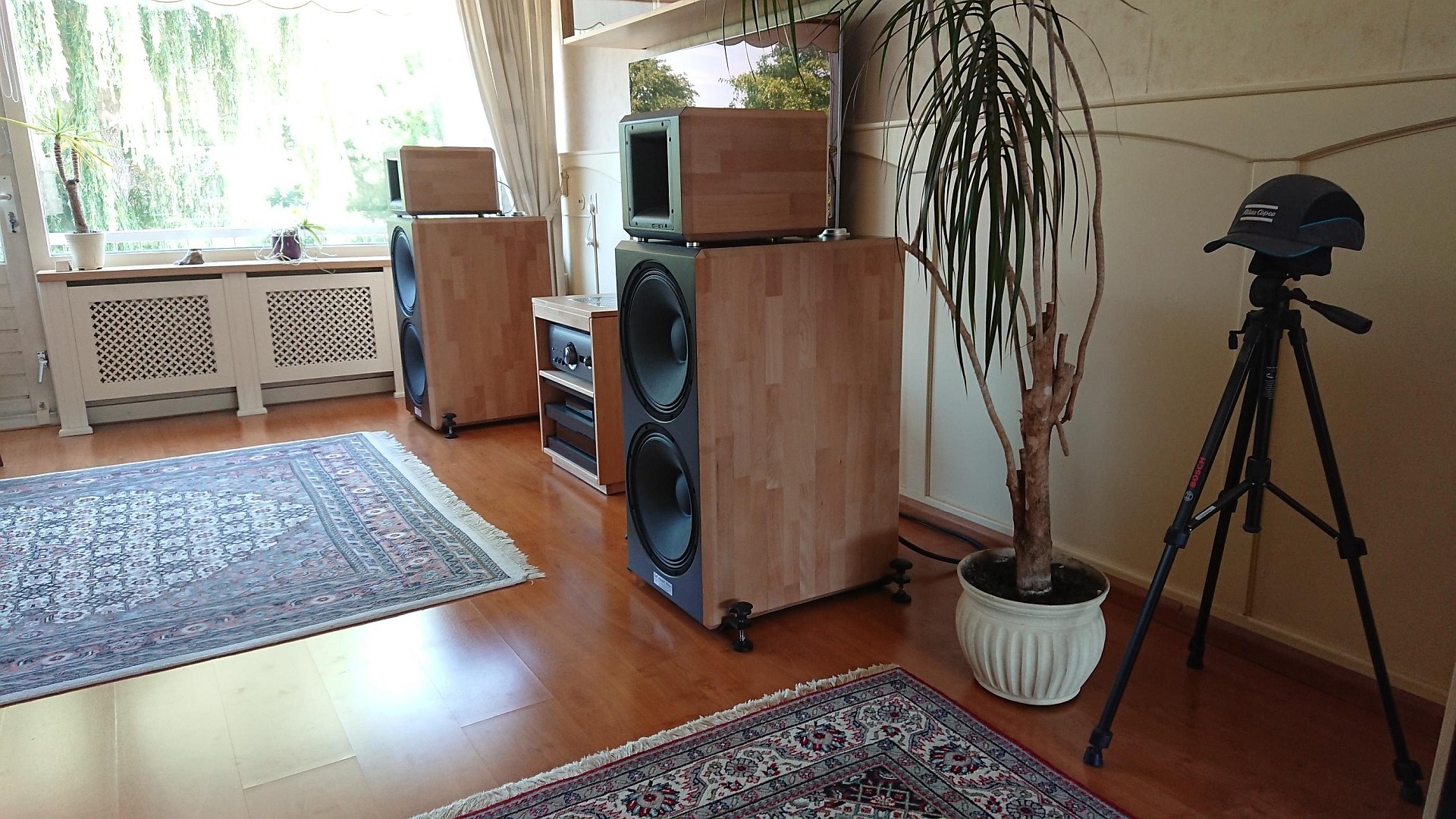

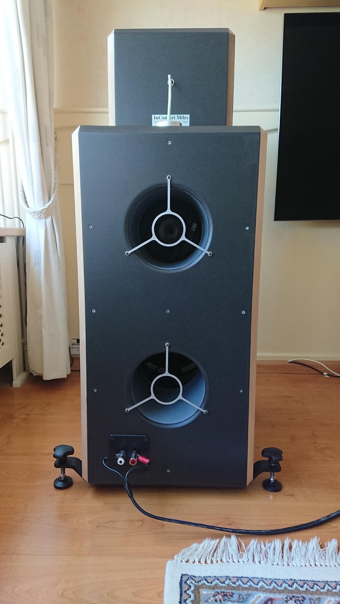

Hello friends.
InConcert Miles 2022.
Project finished.

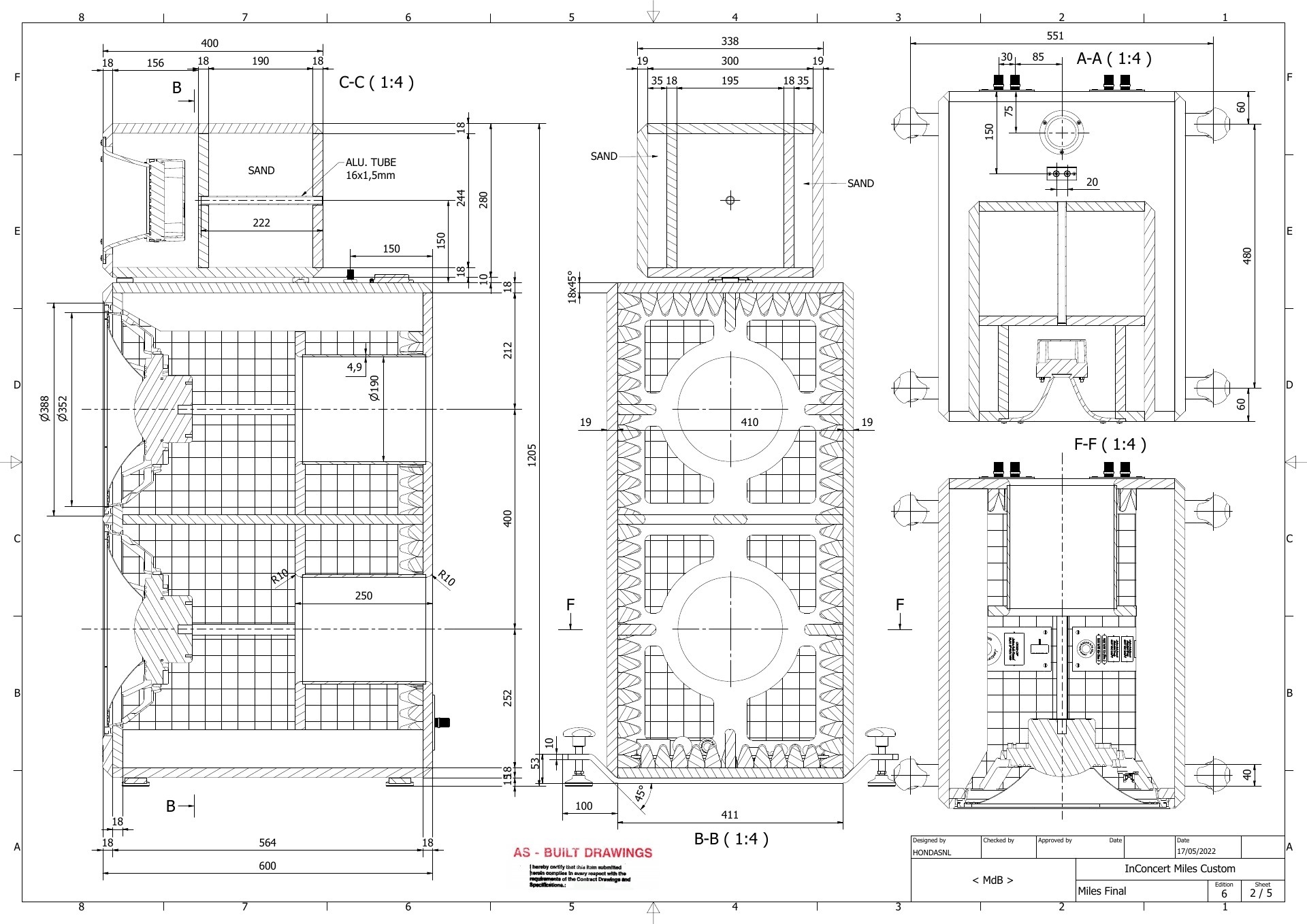

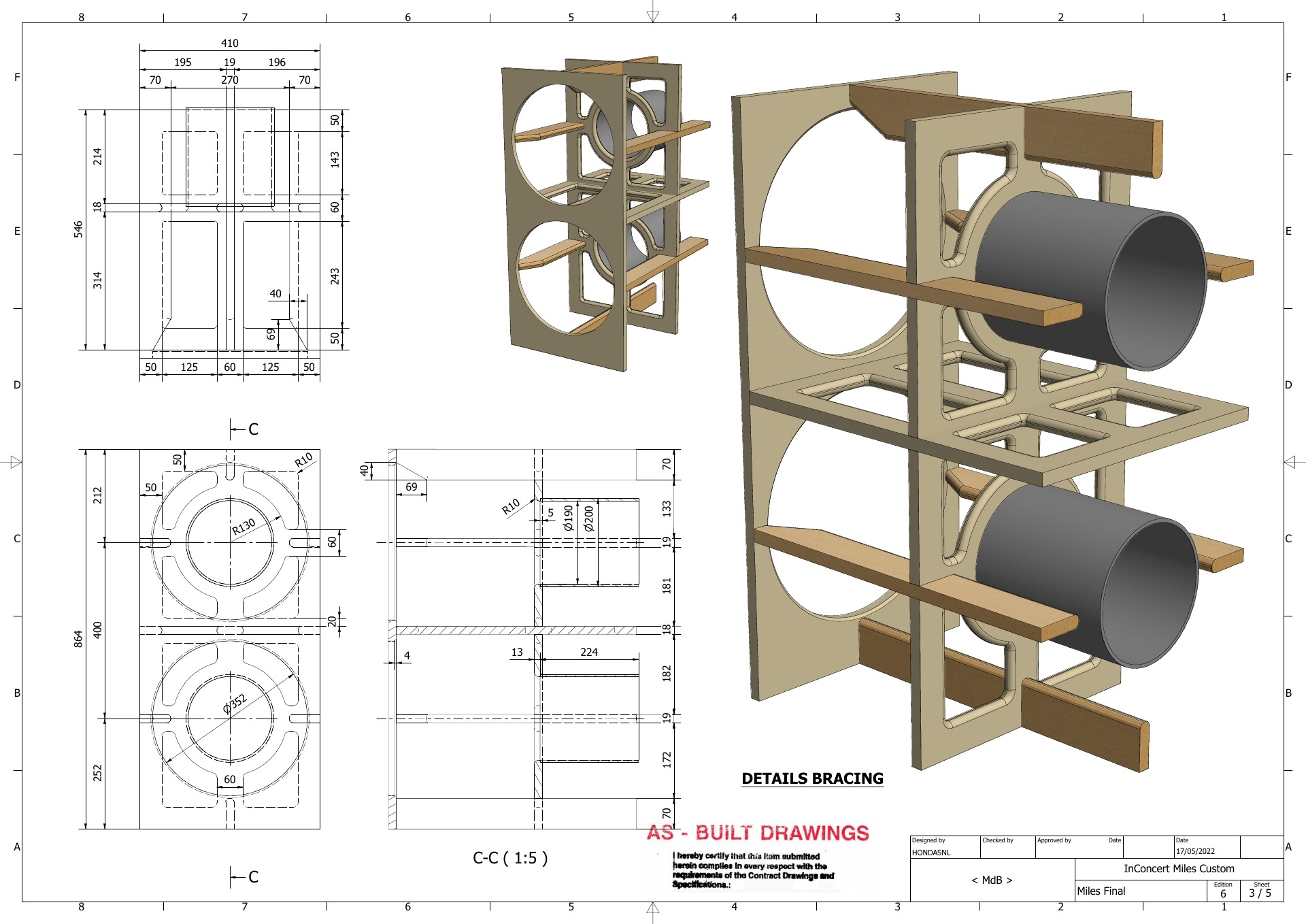

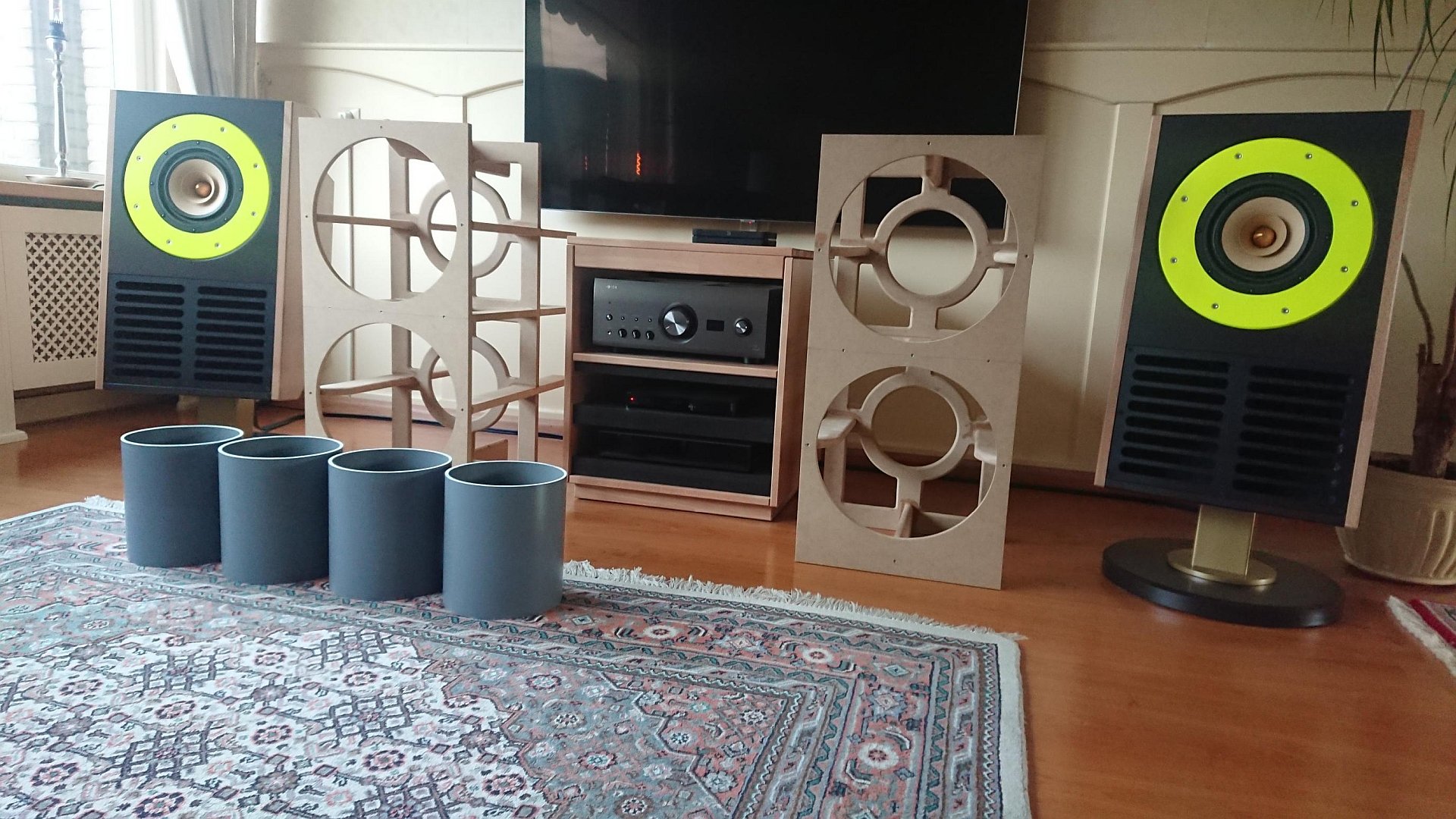

The original speaker was designed and constructed by Stig Erik Tangen.
You can find more information on the internet searching for "InConcert Miles".
Inspired by Hunsbedt Trebygg, "Karmann" from AVforum.ro, "BEF-NO" from AVSforum and "atledreier" from HomeTheaterShack".
I always had a weak heart for huge cone's.
Therefore I liked to built this configuration.

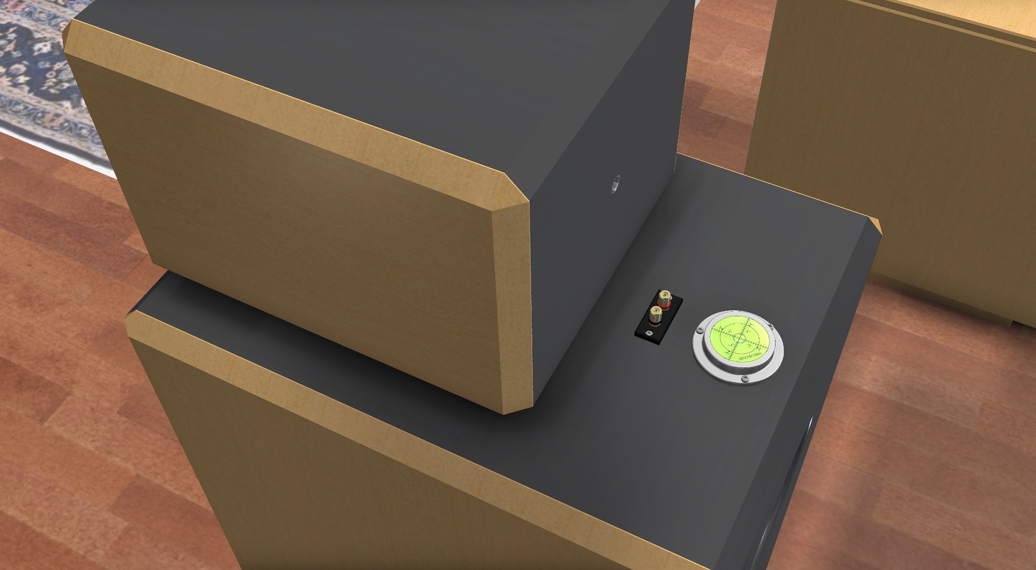

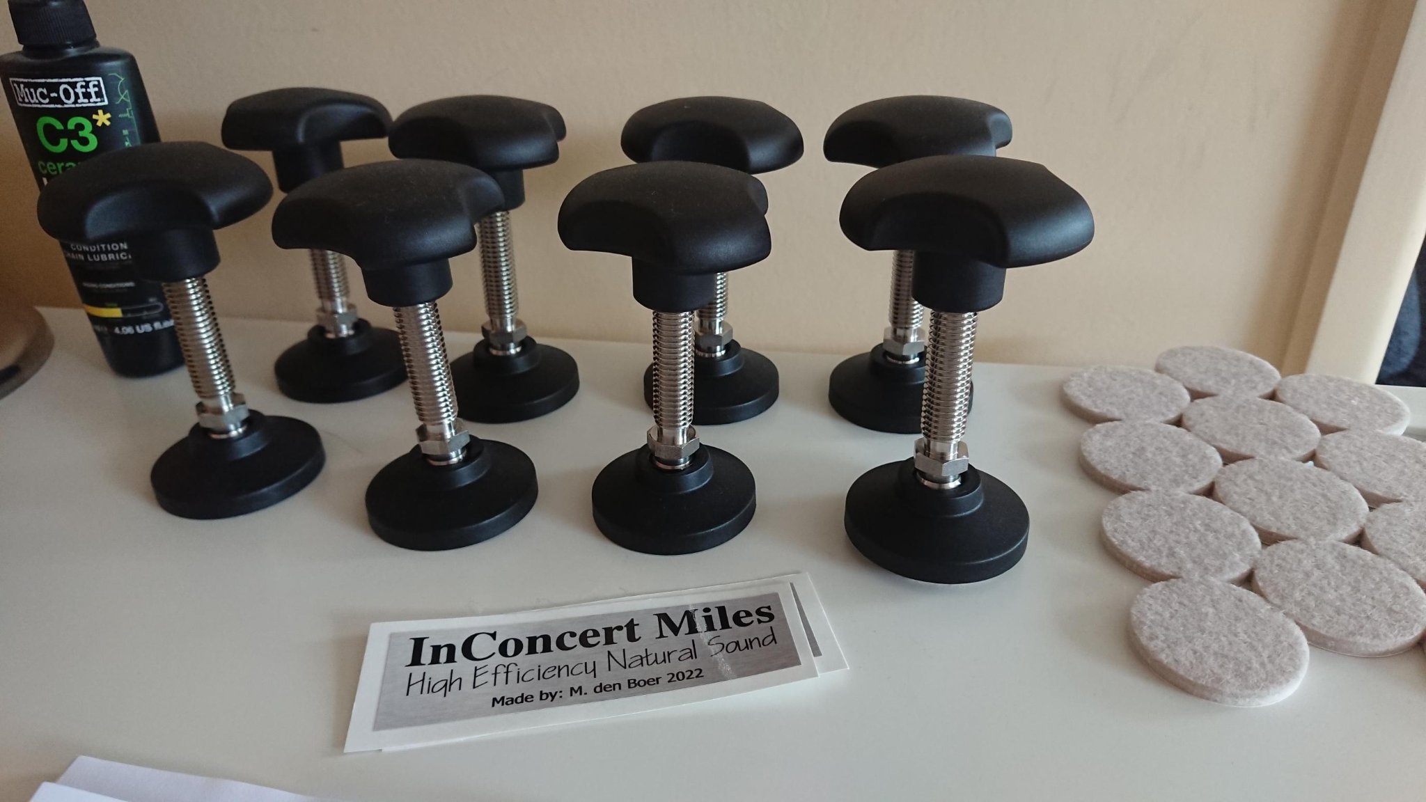

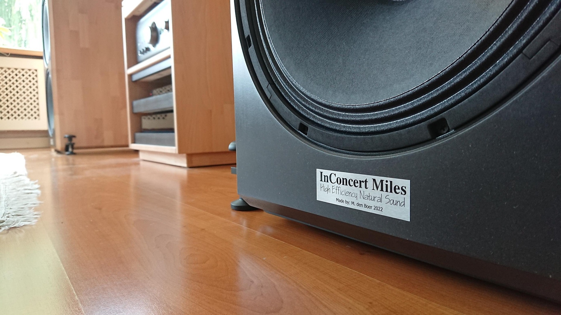

Here's the version in my own jacket.
Highs and lows designed and put in seperate cabinets.

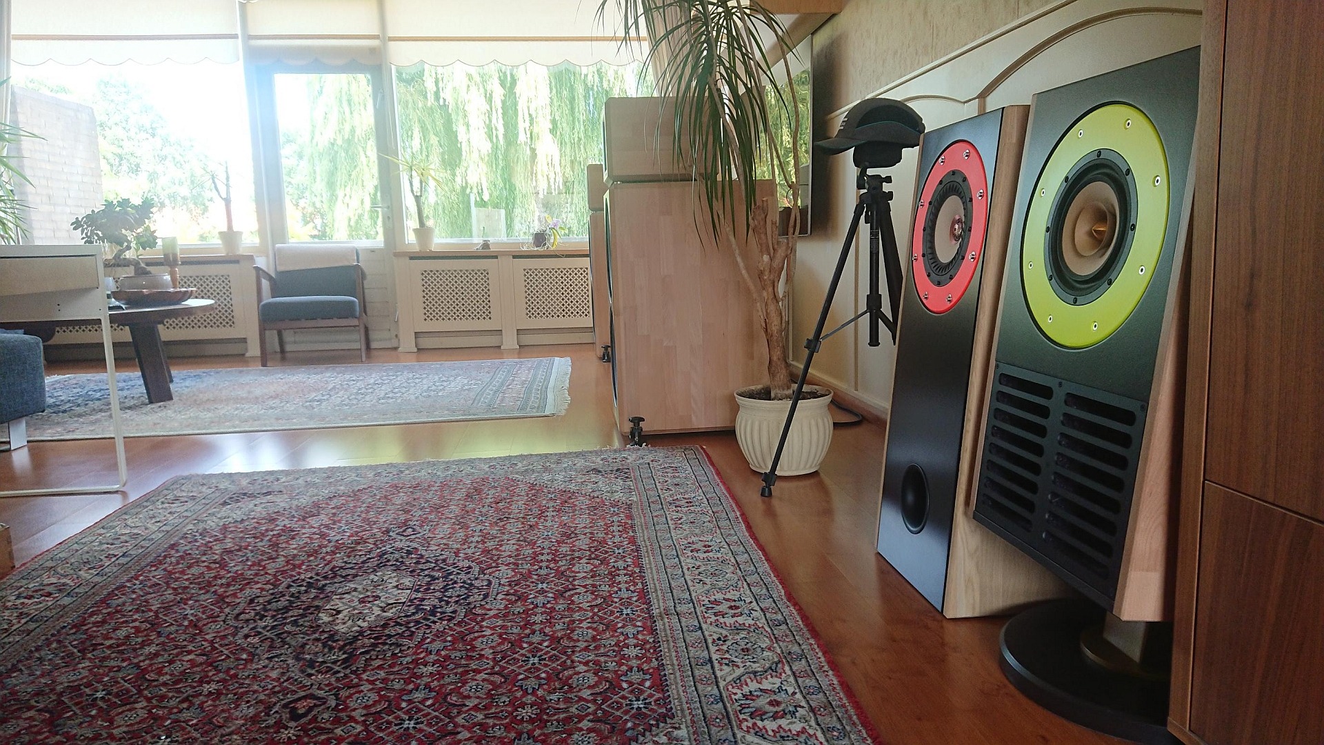

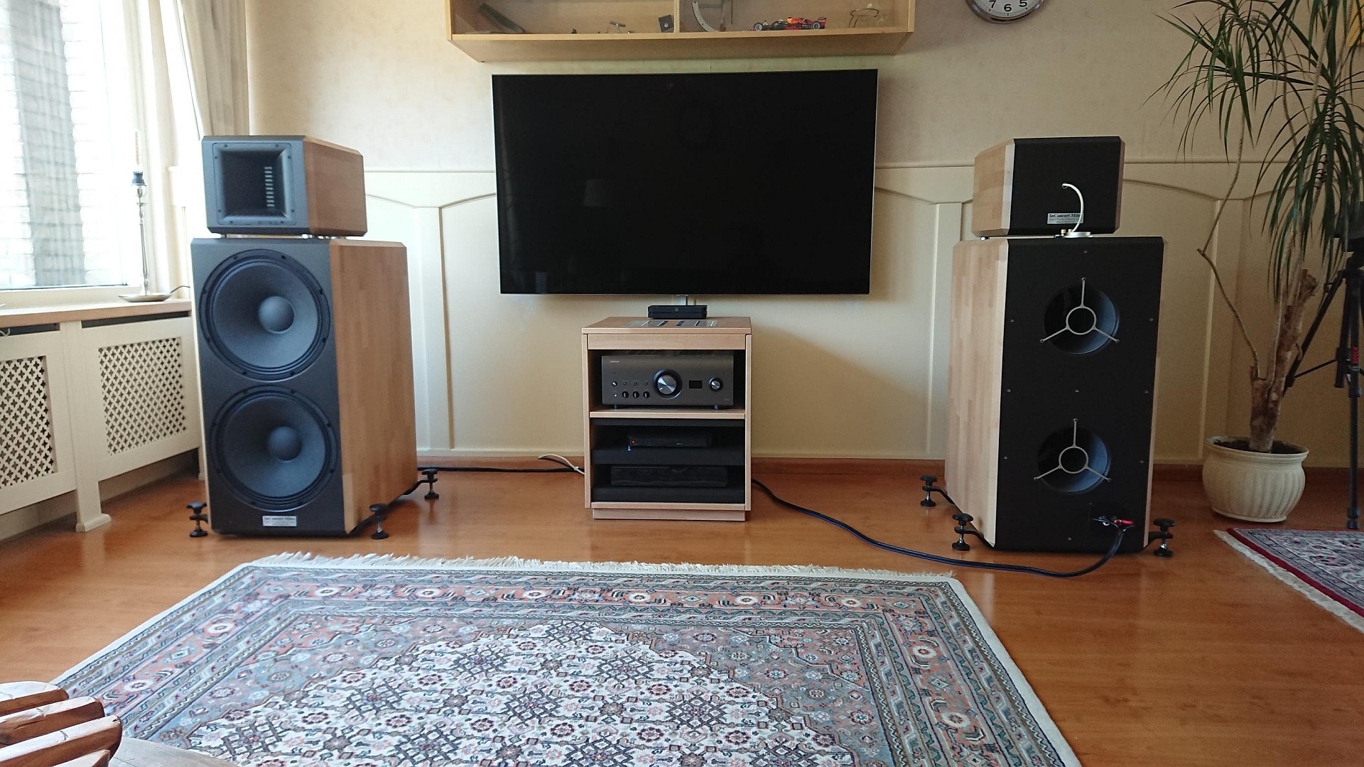

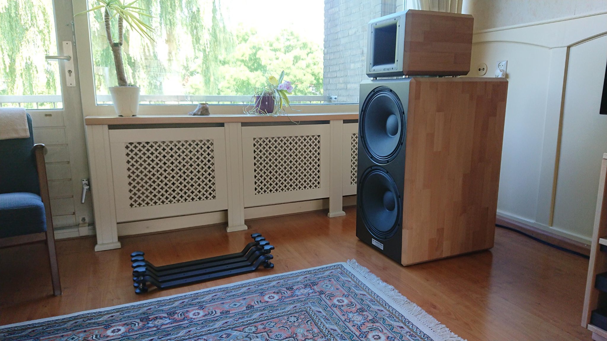

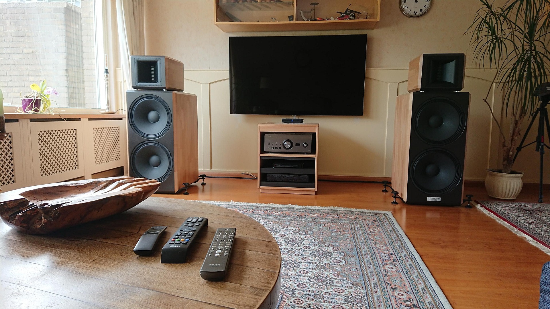

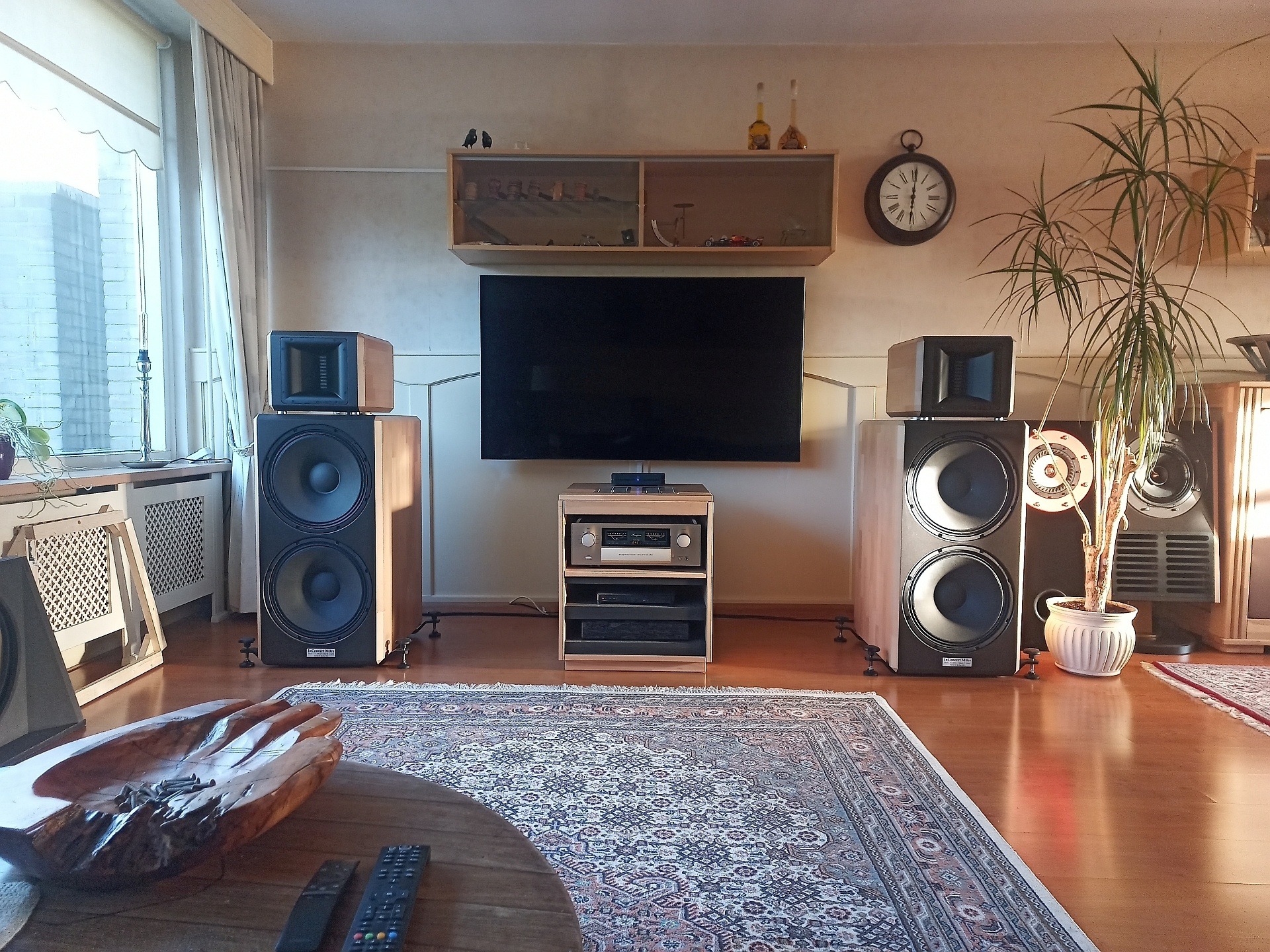

I already heard the test installation here in my living room.
This sounds as music in my ears!
High-efficiency speakers with a wonderful depth, spaciousness and detail.
Also a very nice 3D sound production.
And now they are ready!
Fabulous!
This is sounding huge great open and very deep in my living room!
Very Happy with them.

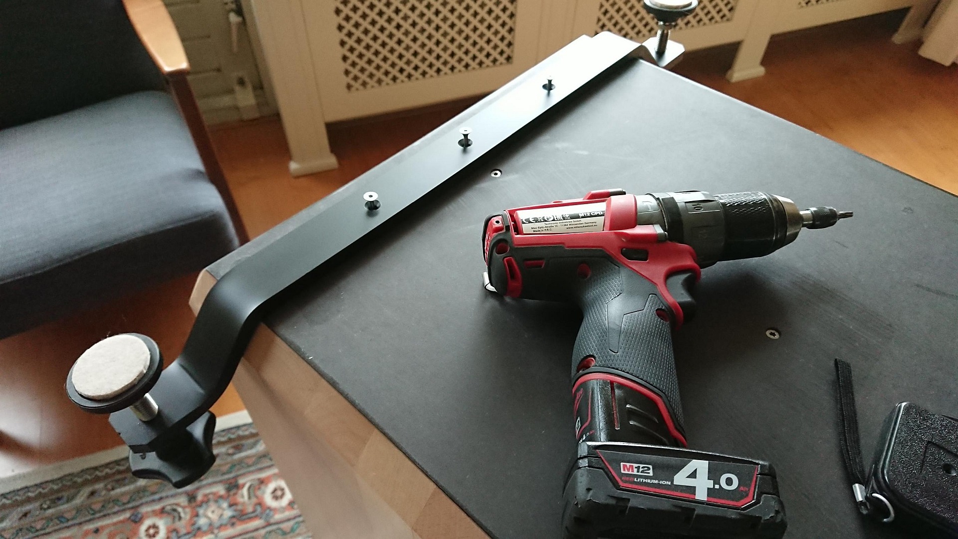

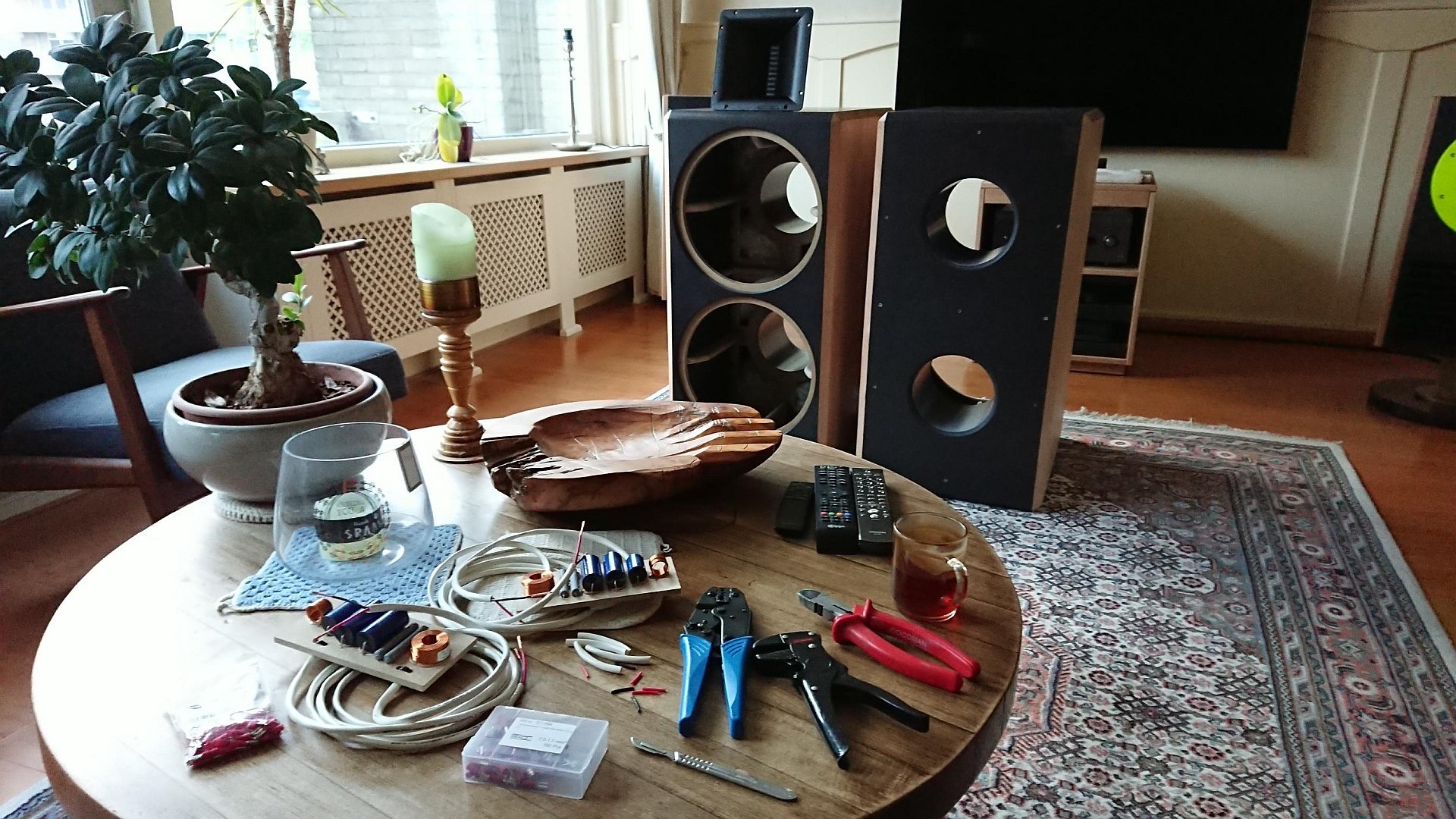

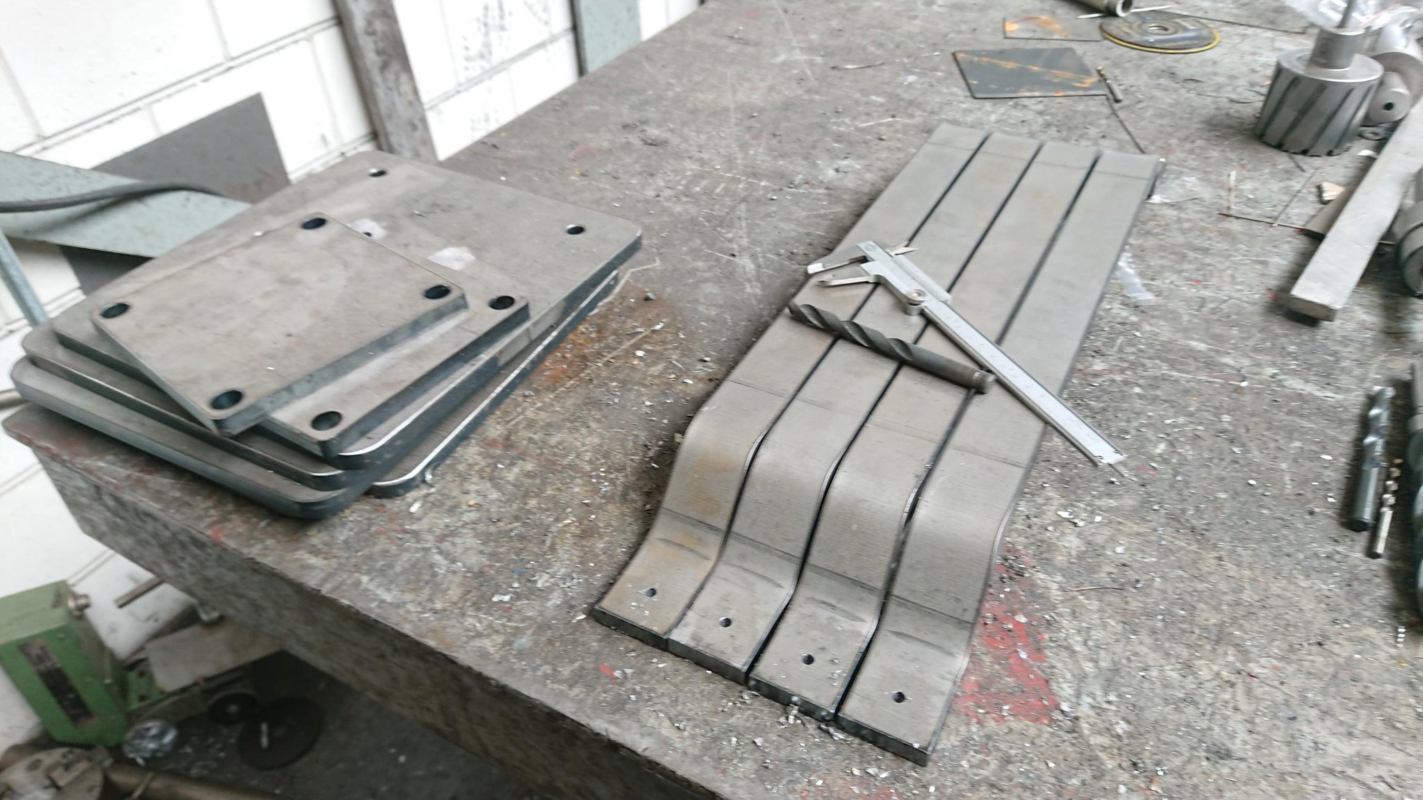

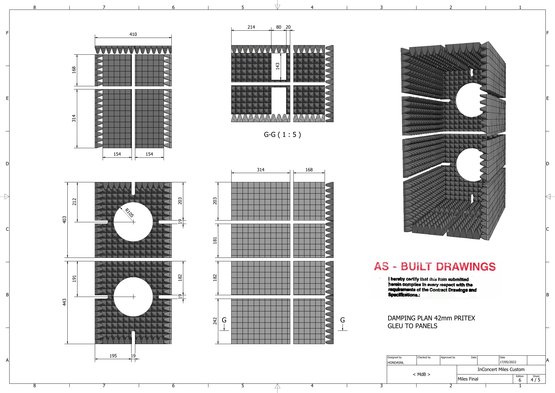

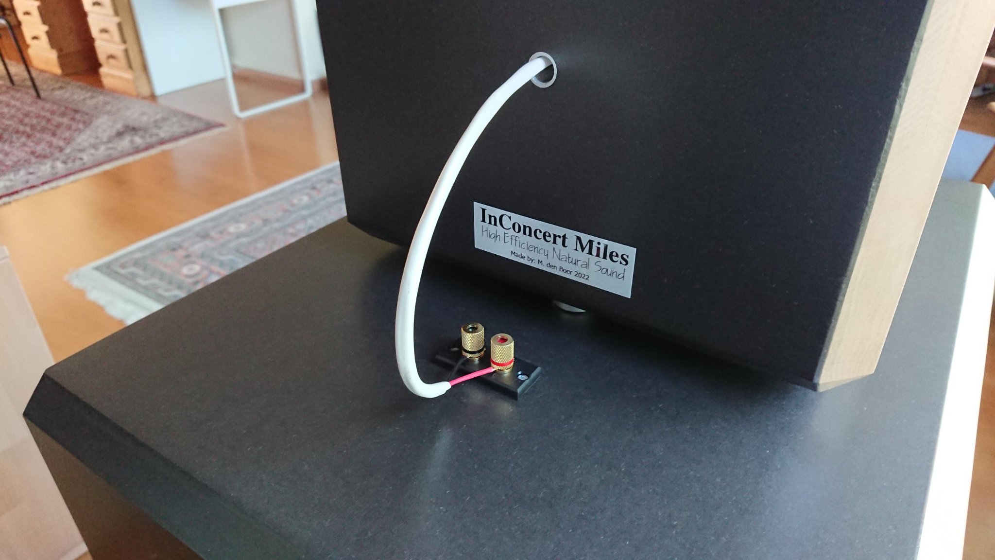

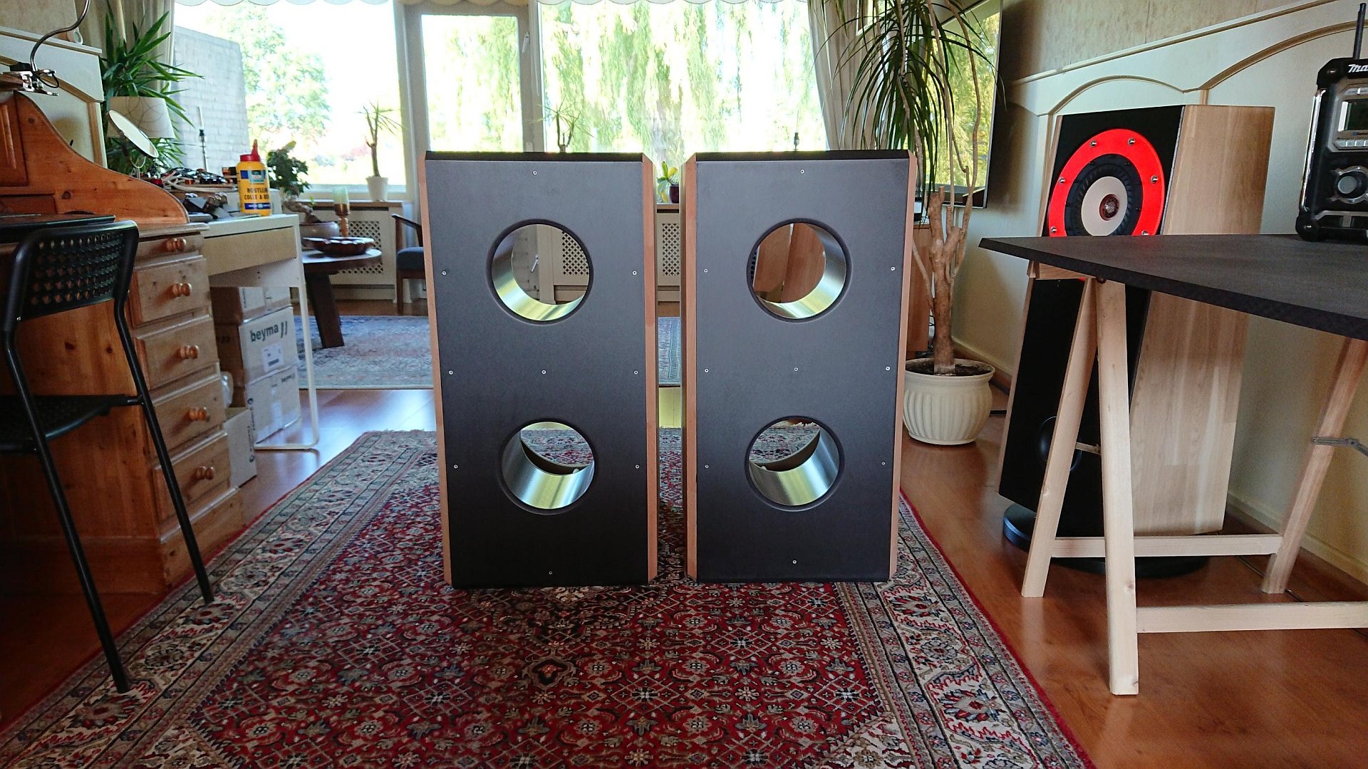

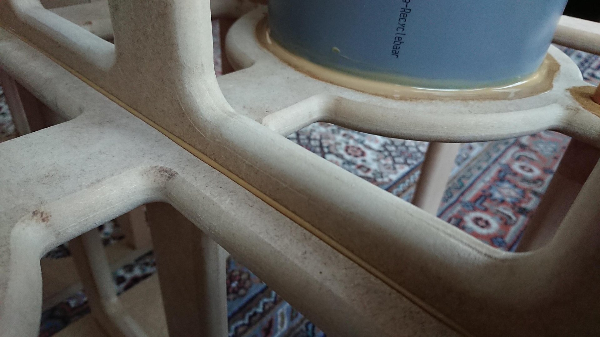

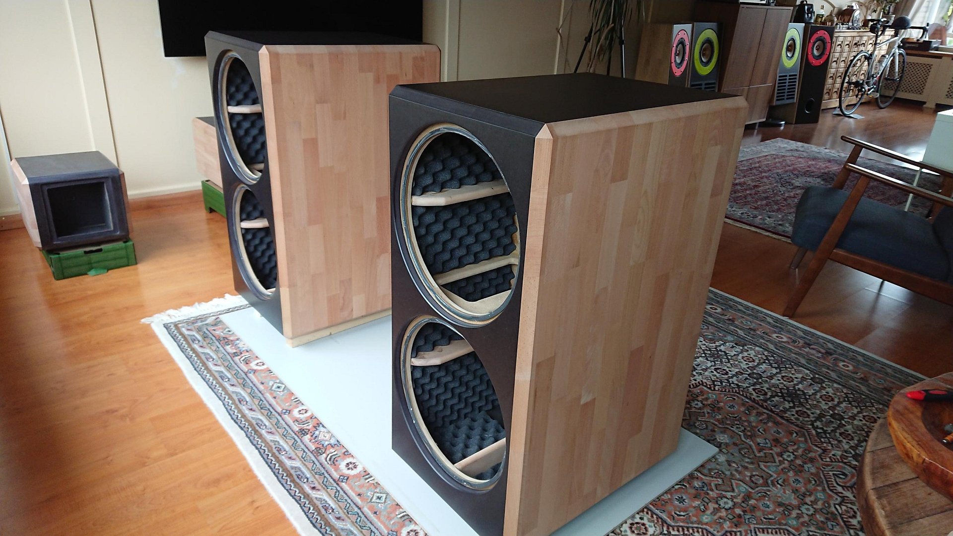

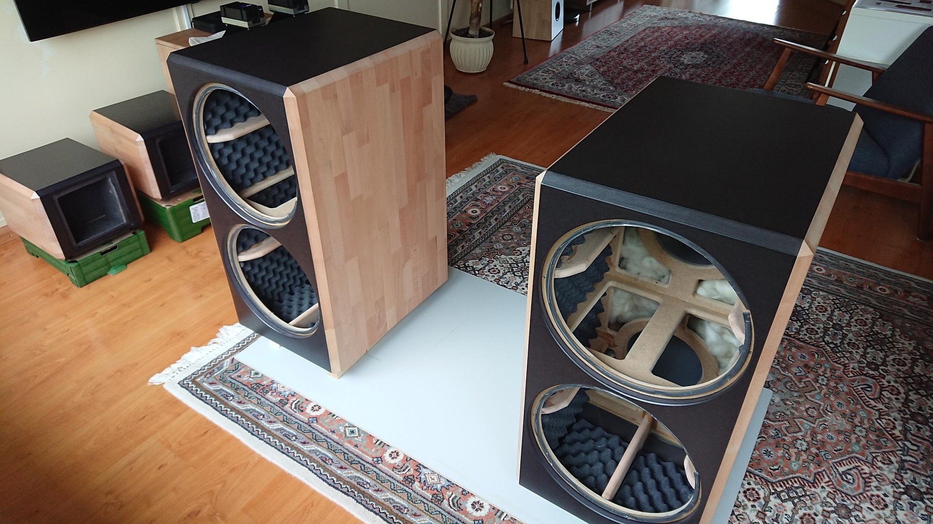

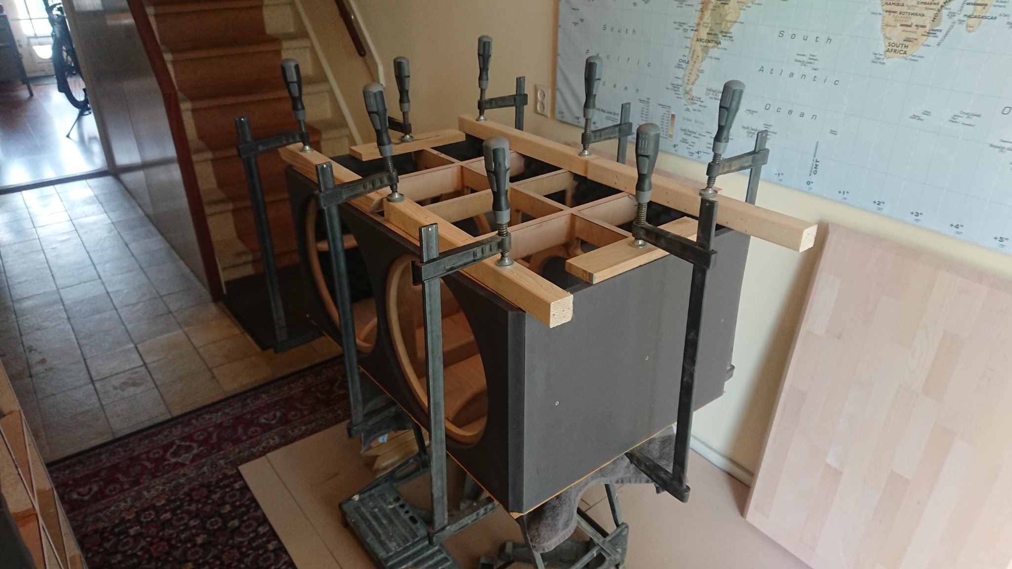

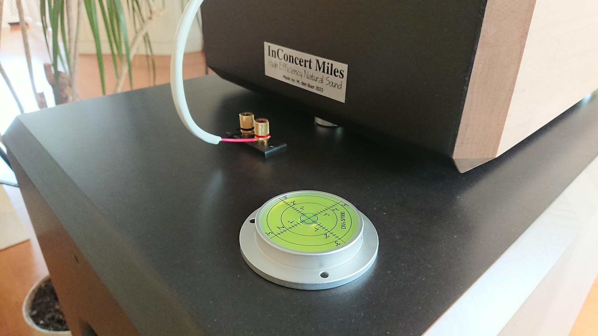

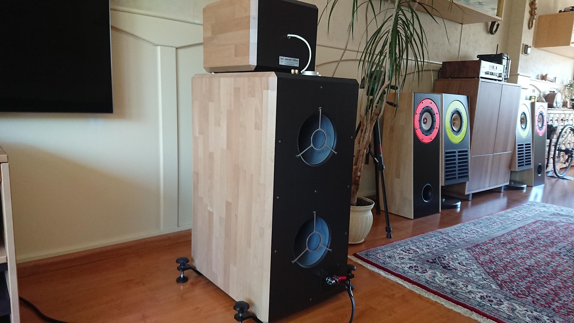

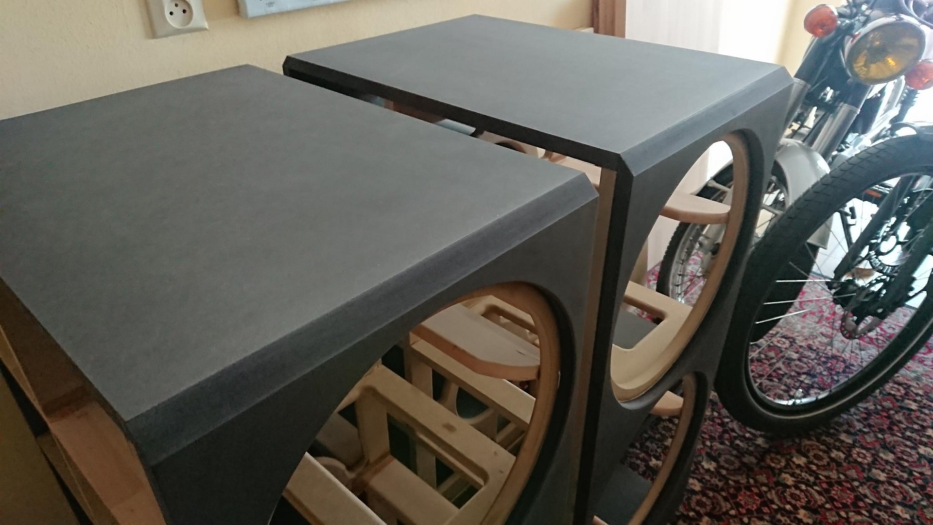

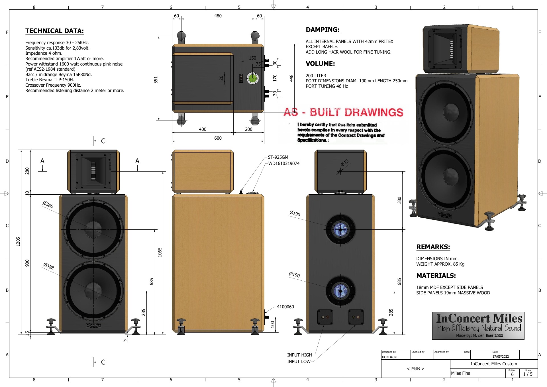

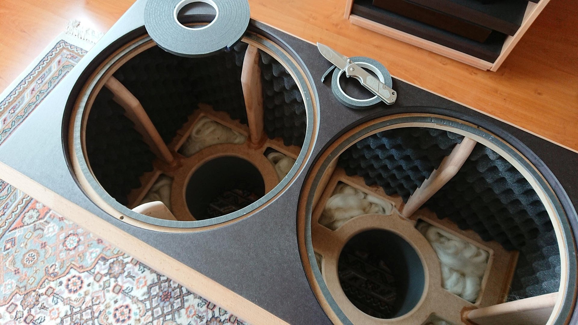

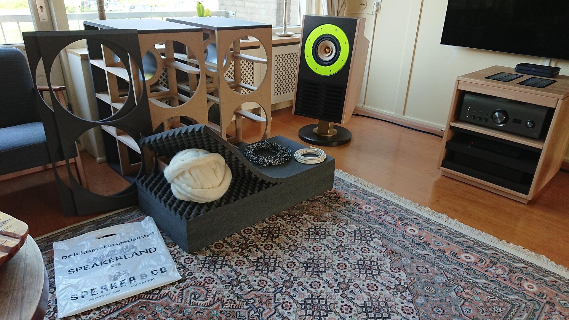

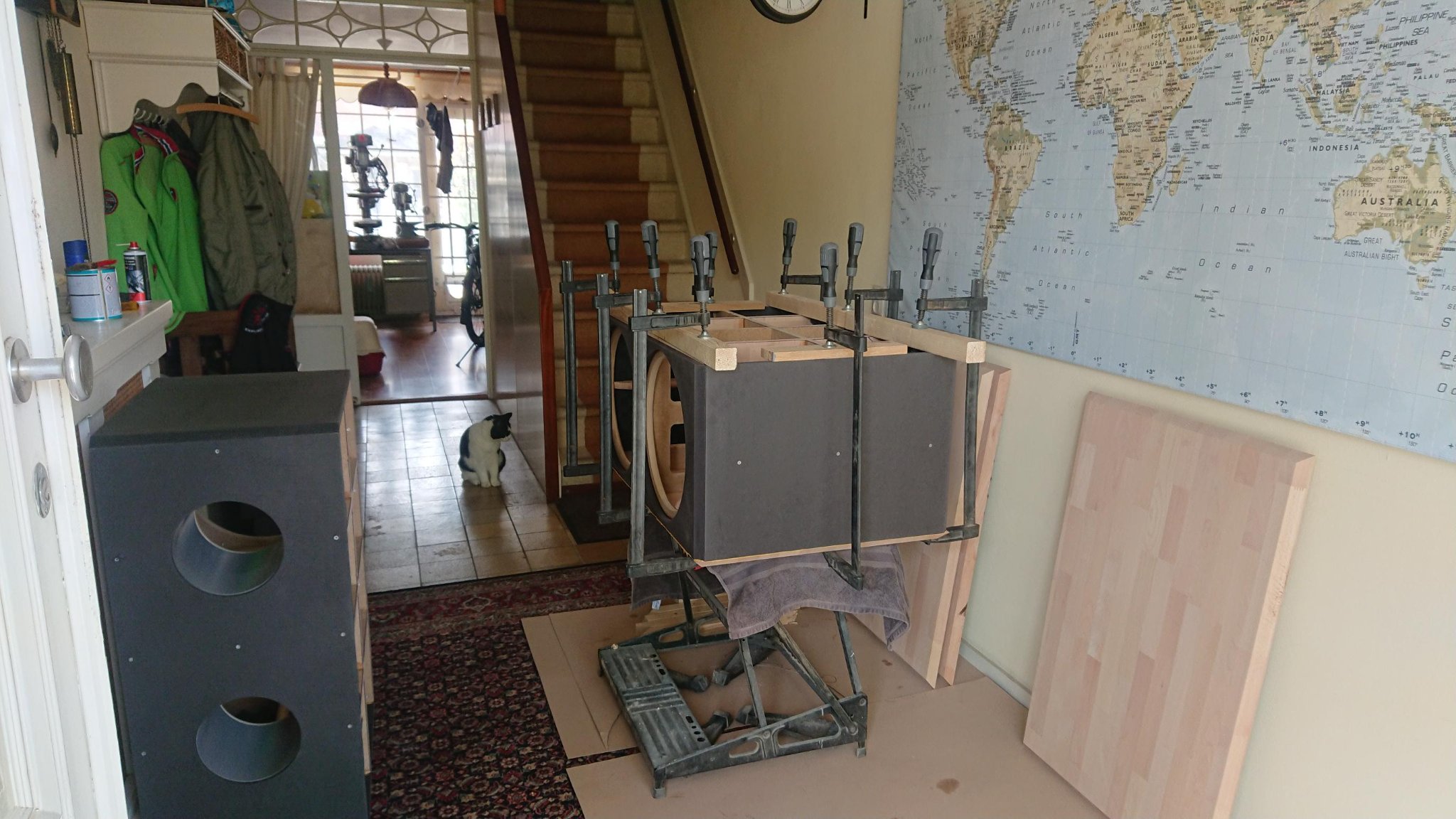

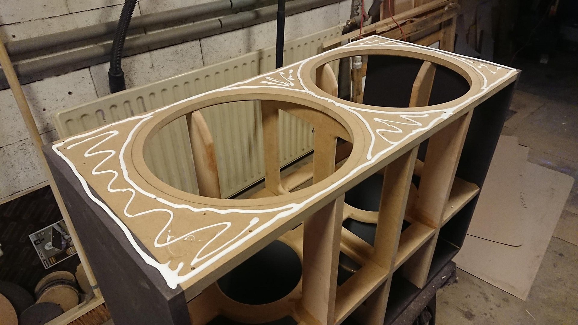

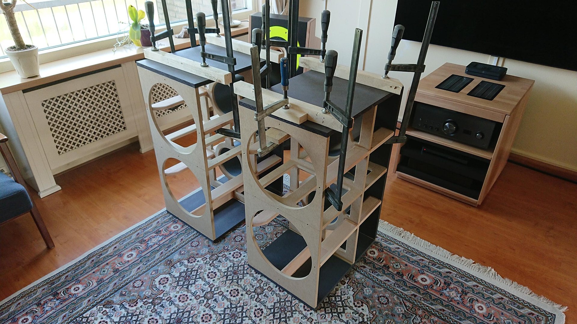

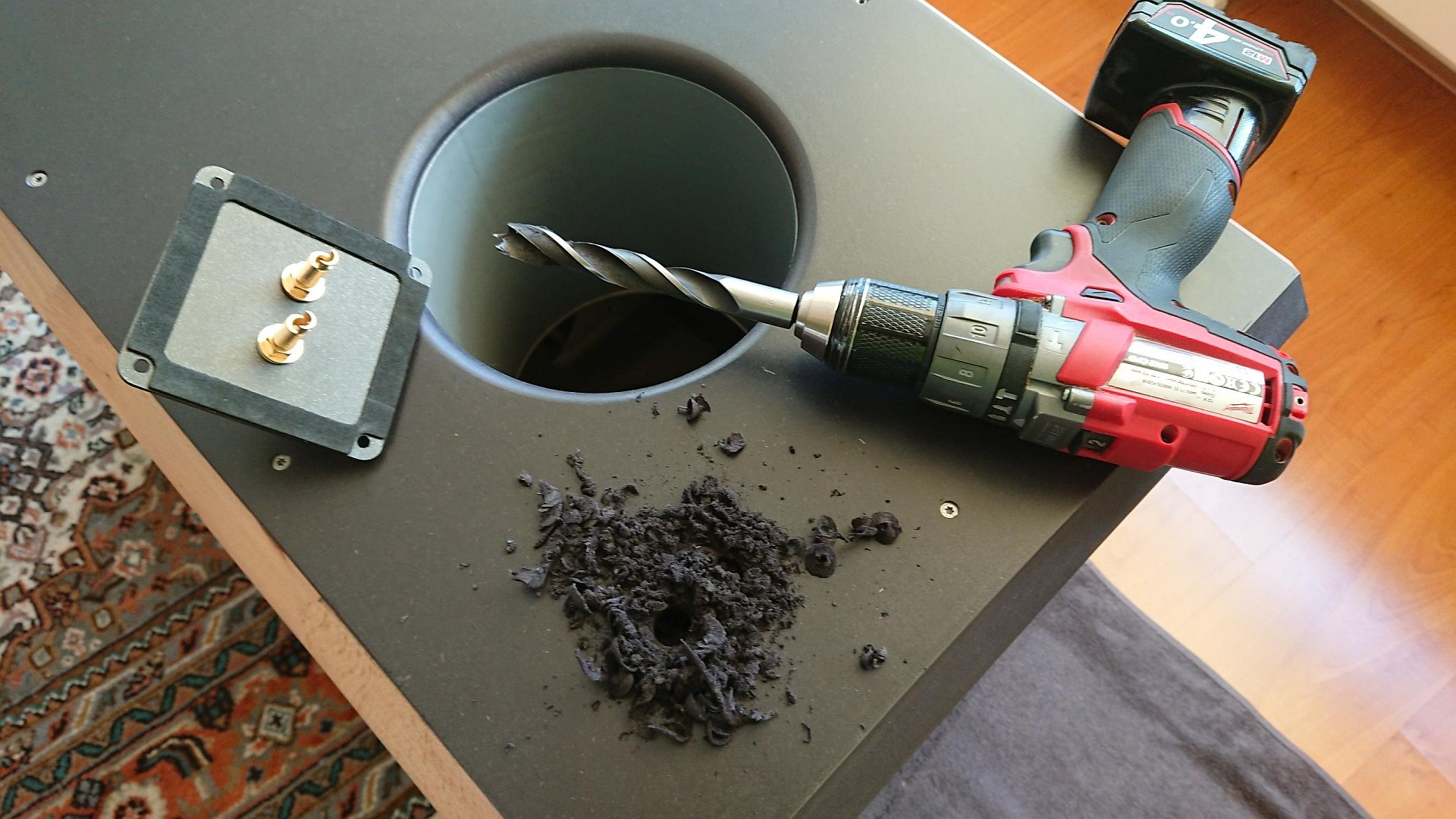

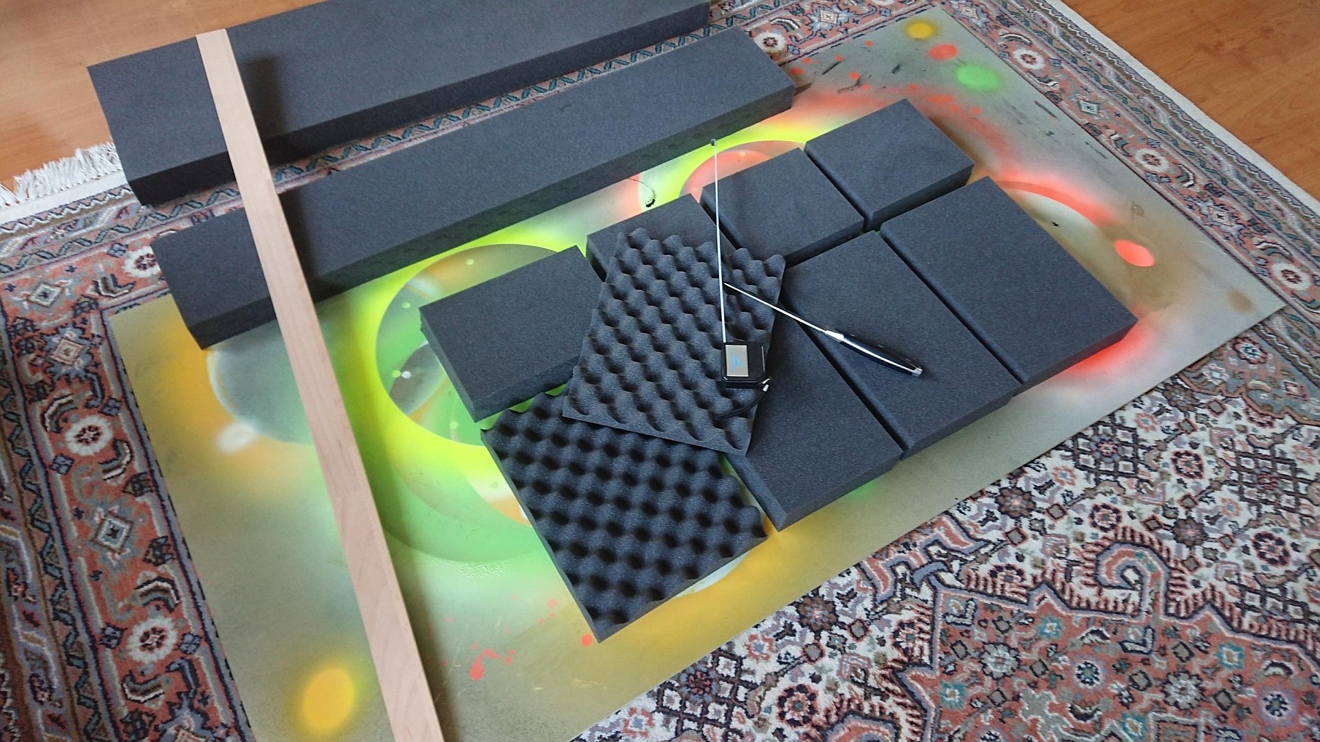

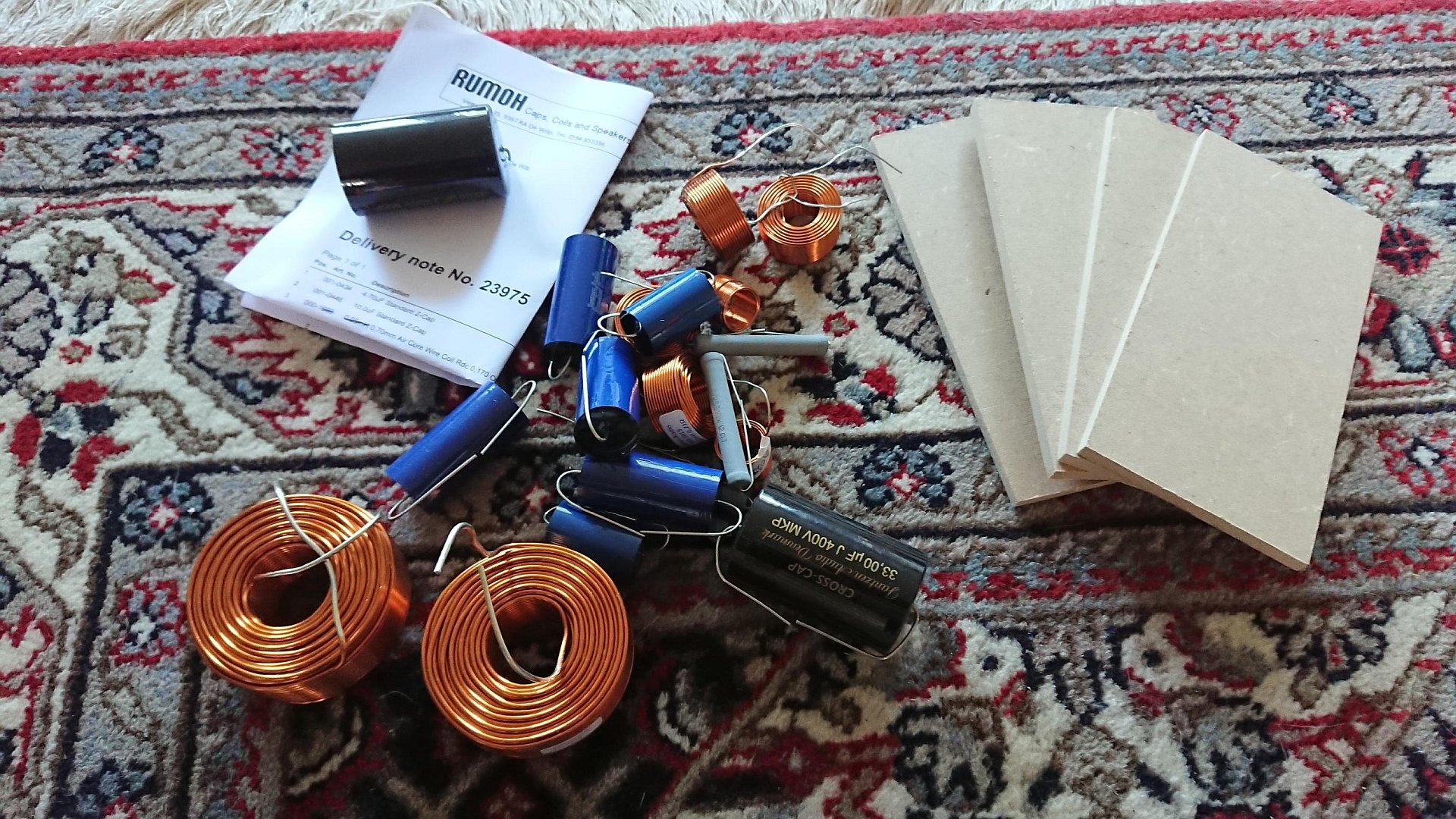

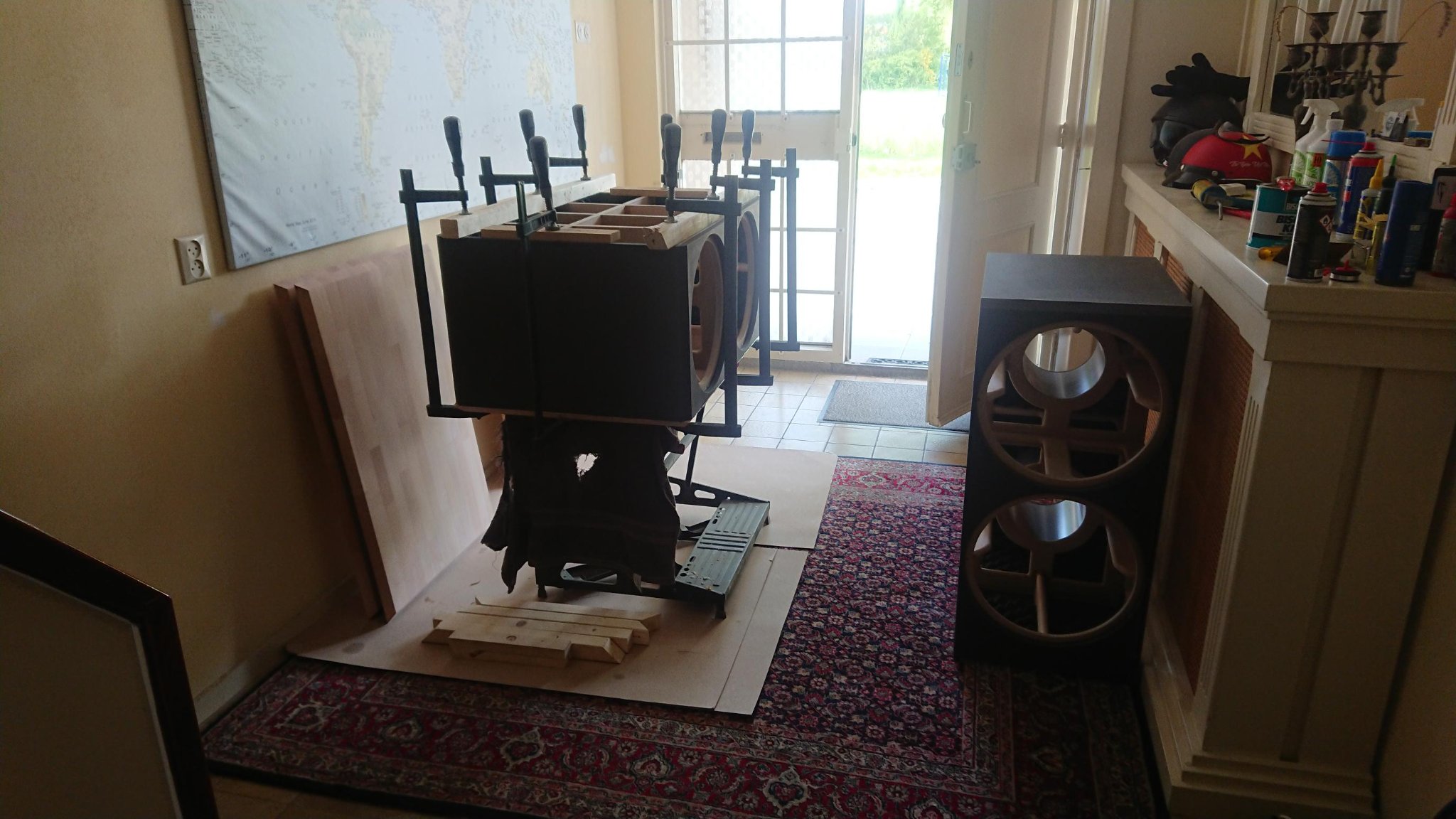

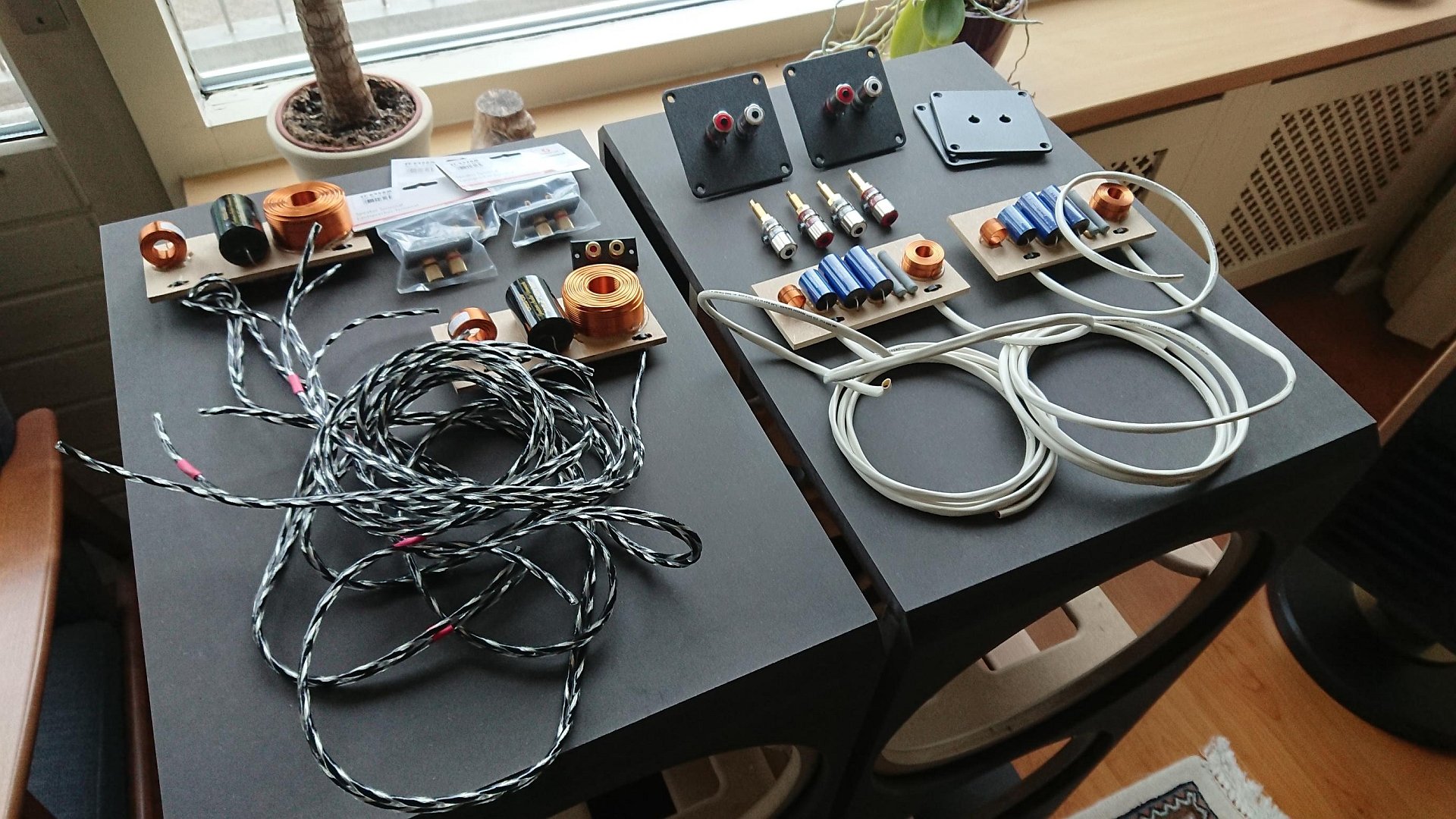

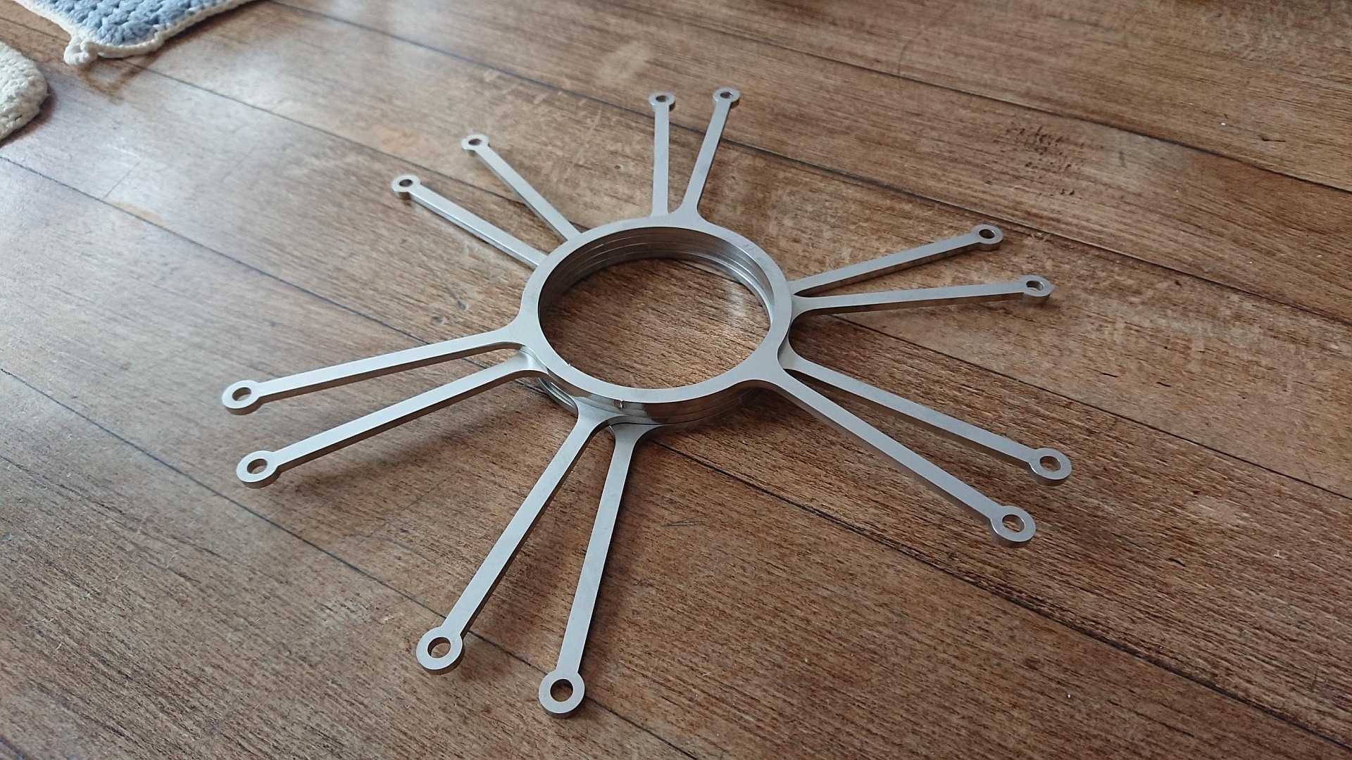

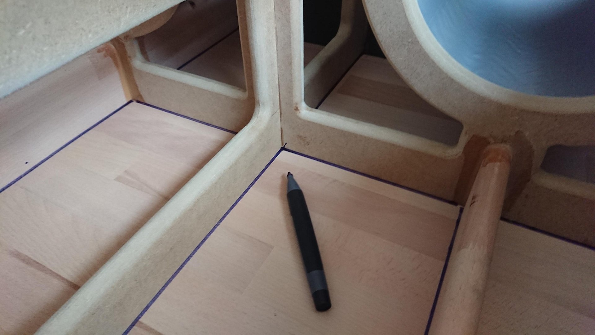

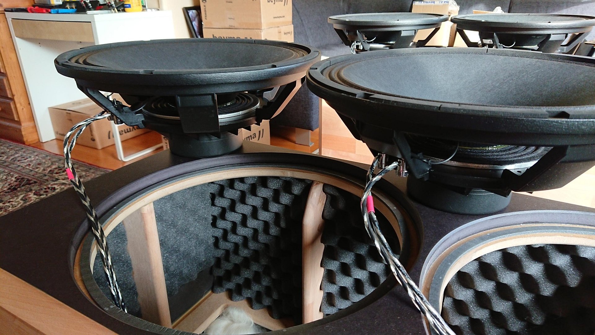

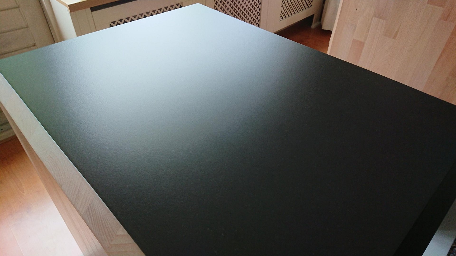

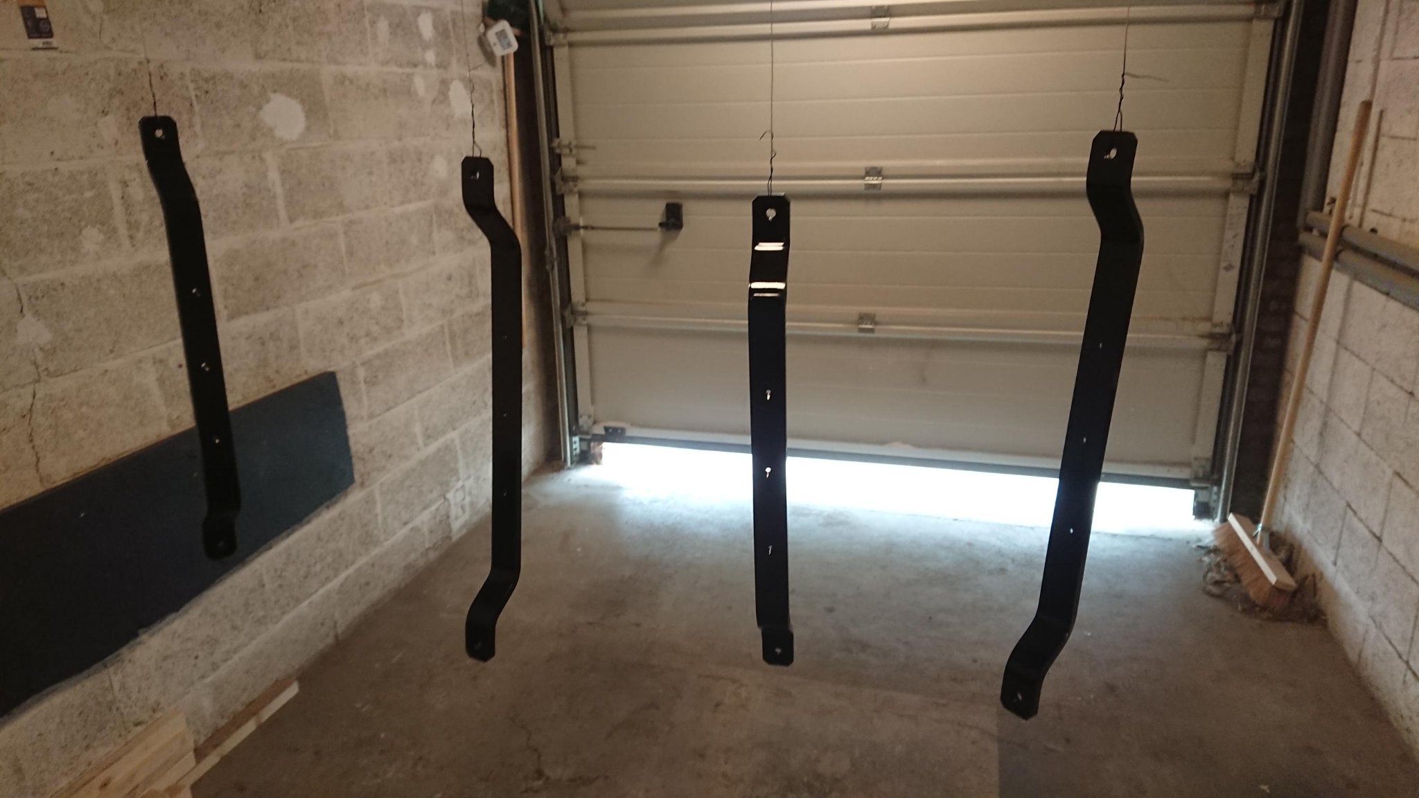

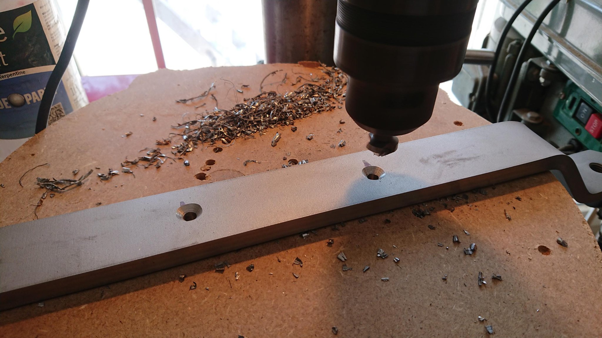

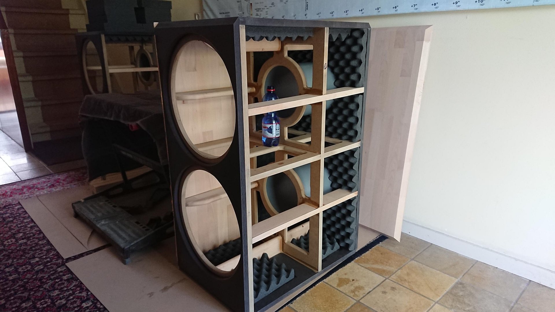

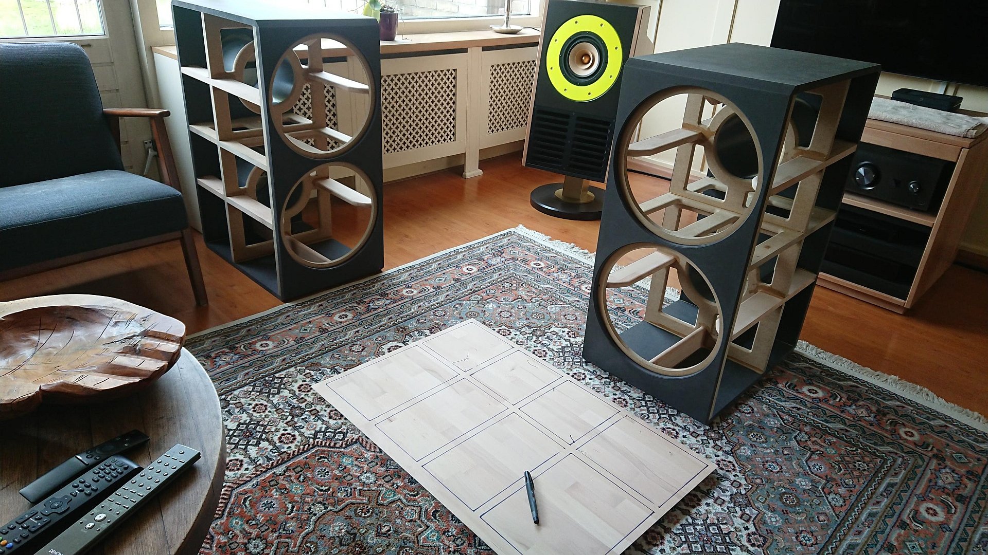

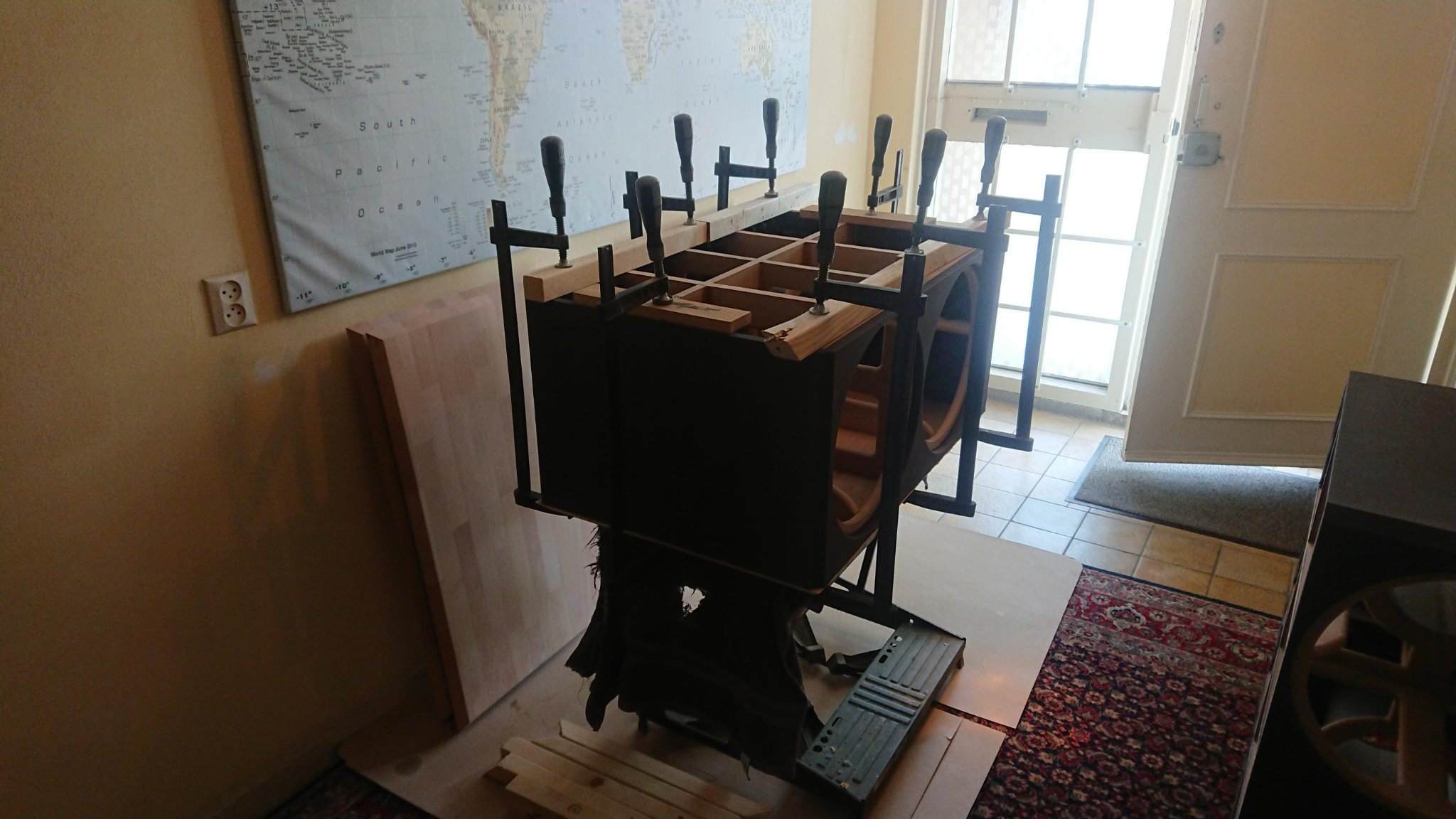

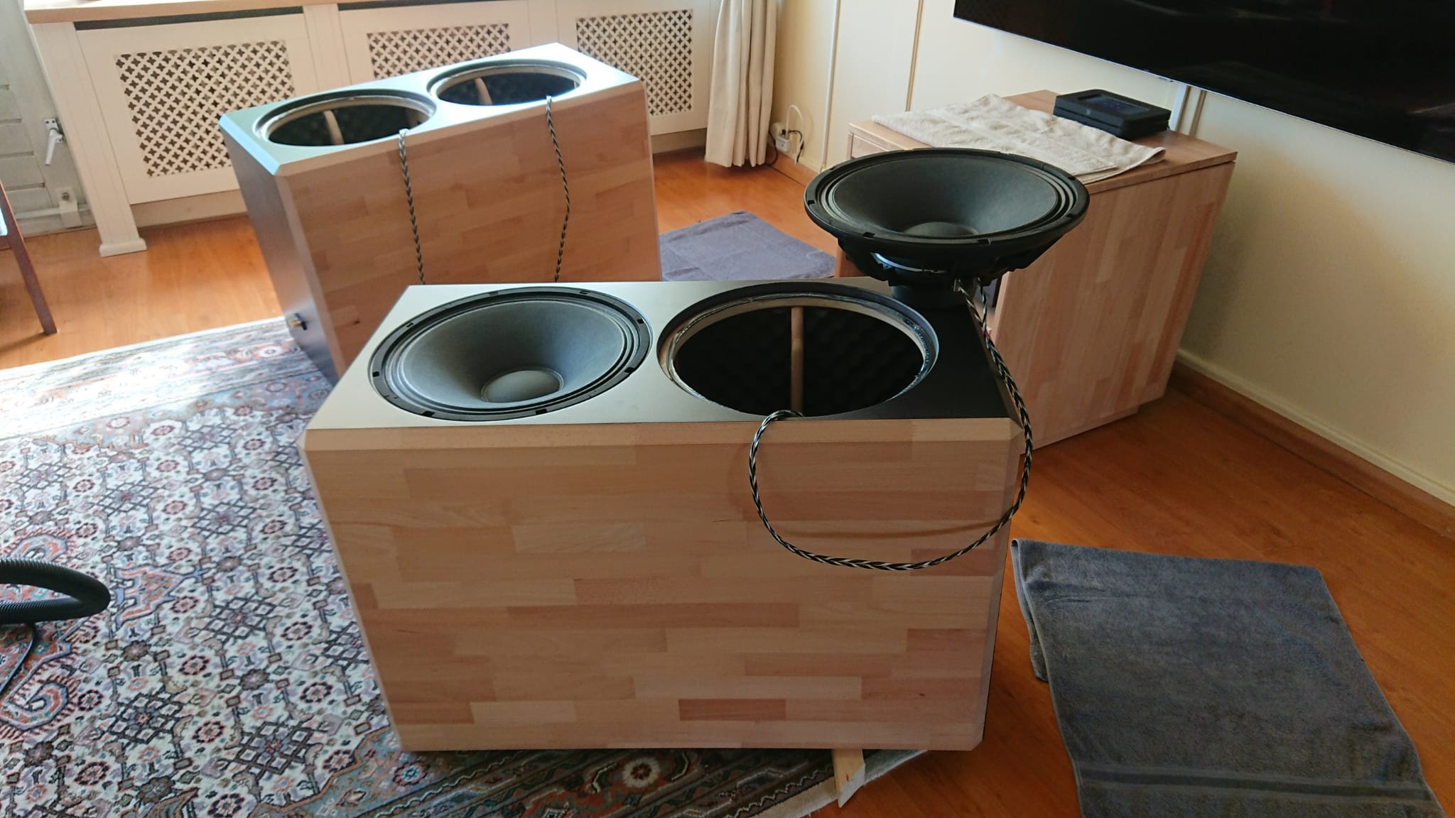

Here some pictures during building process.

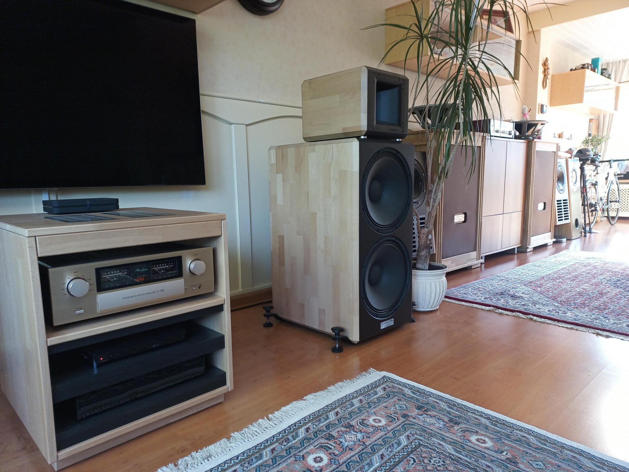

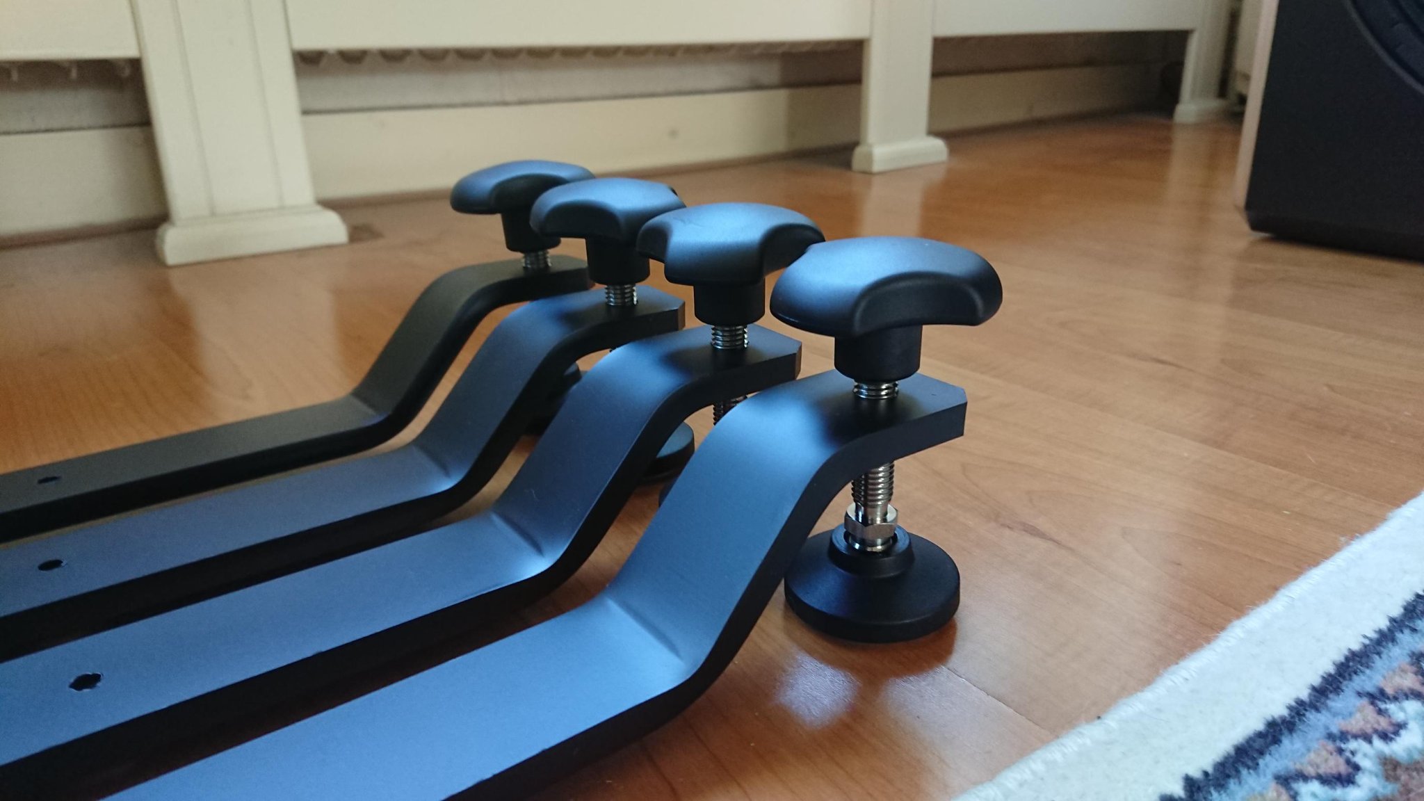

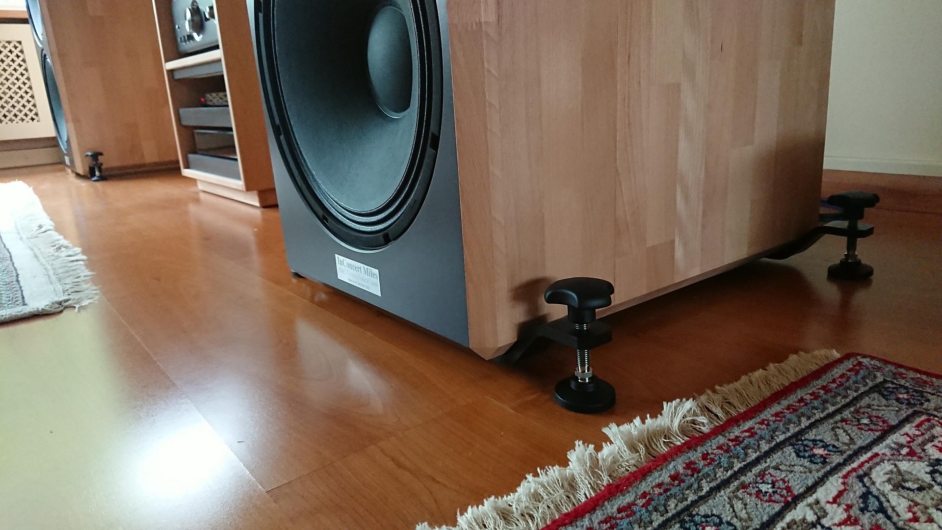

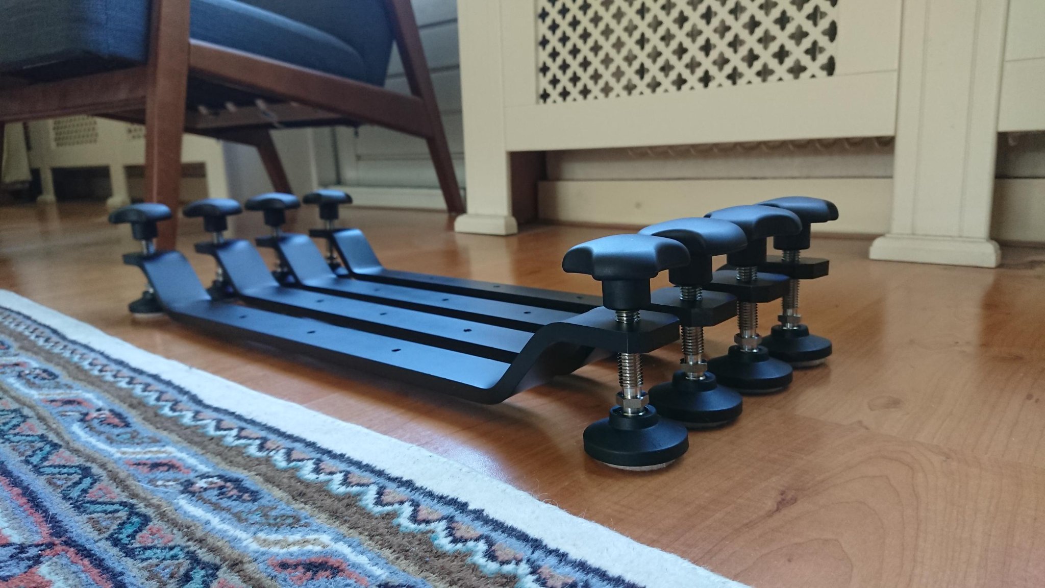

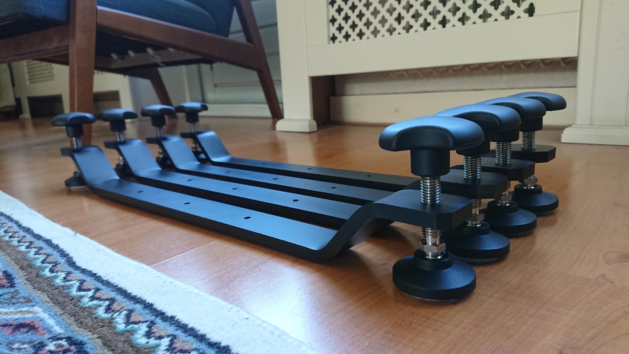

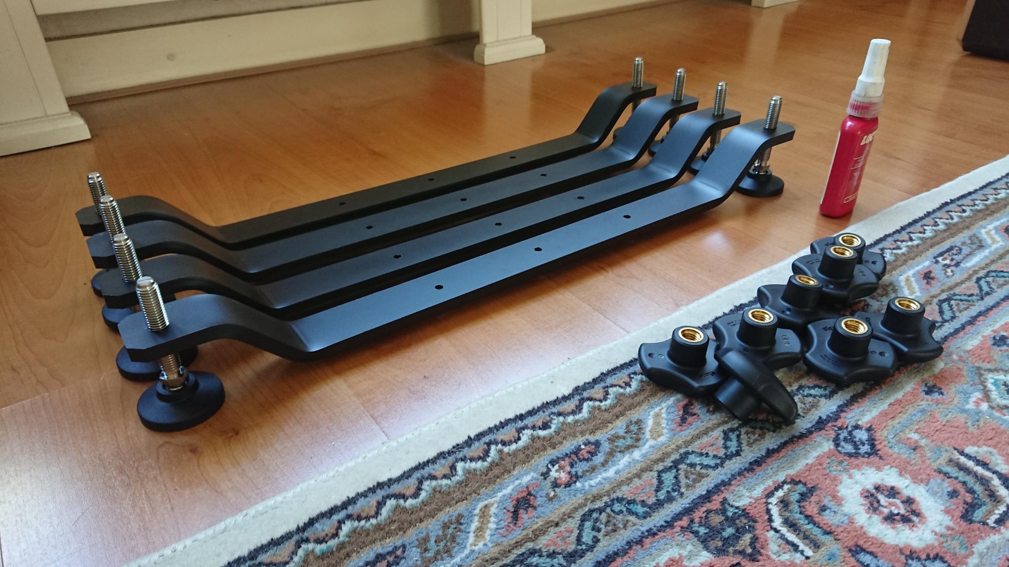

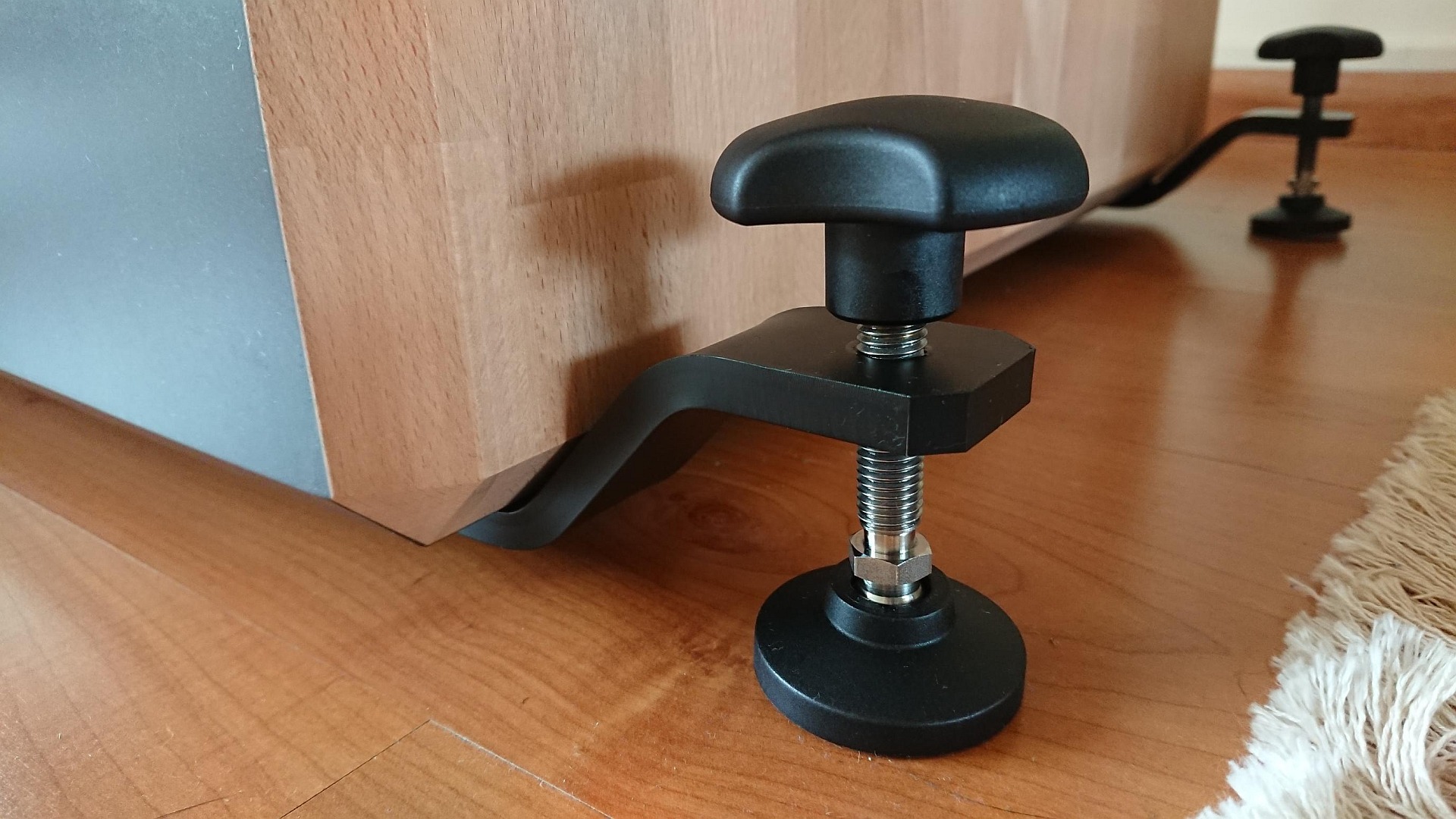

Markbakk from the Netherlands?Constructed in more than impressive ways, as you do every time!
https://www.elesa-ganter.nl/knoppen...h6SAq4bsN5vQ64d05ENHCIxcpPScttUbbFSzEmiiMXhvEHondasnl
A superb project

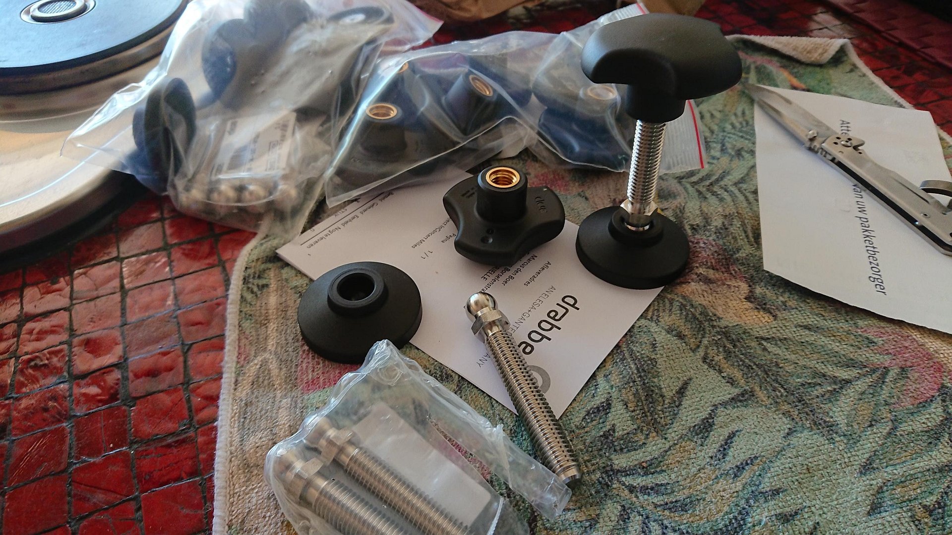

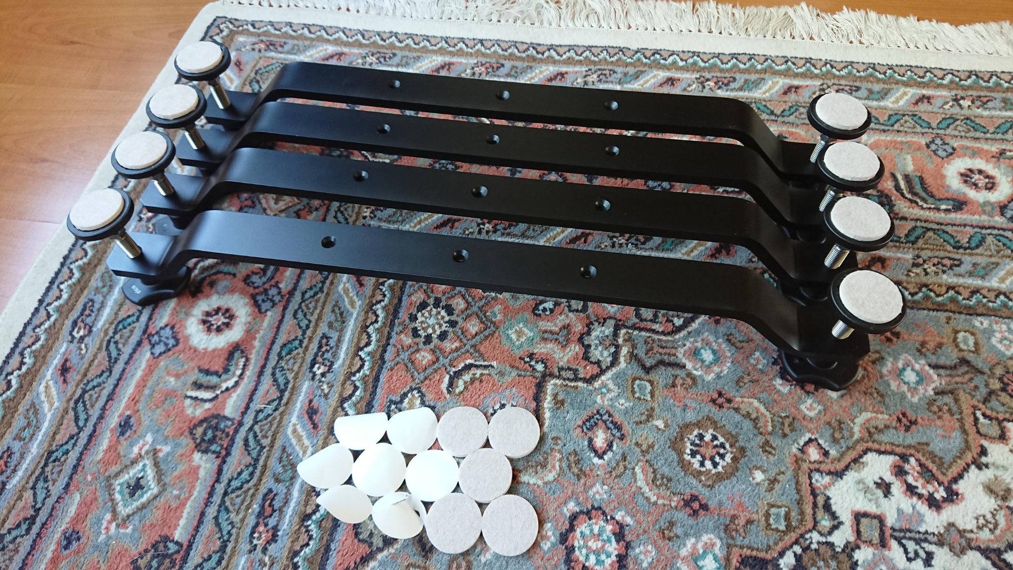

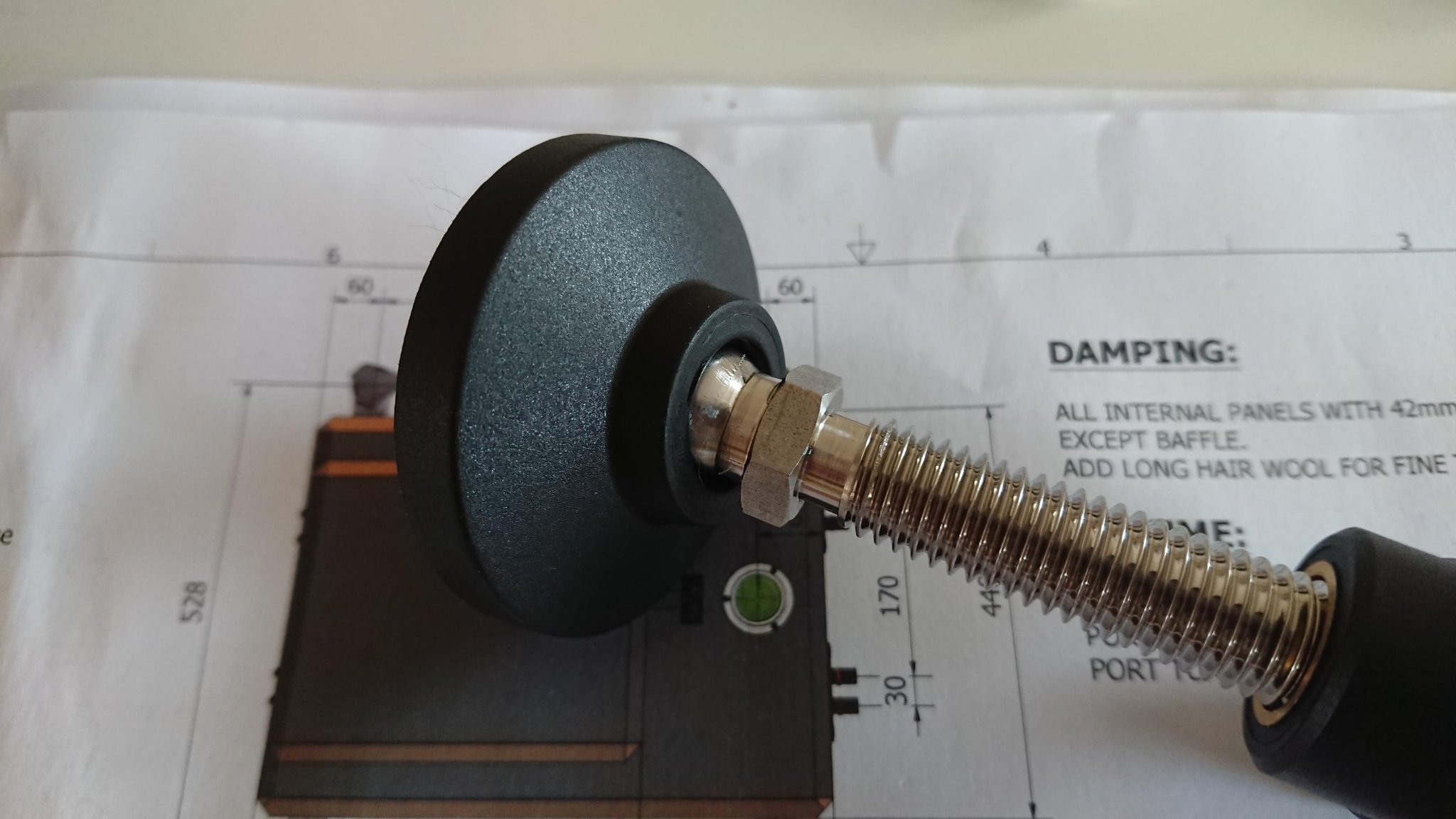

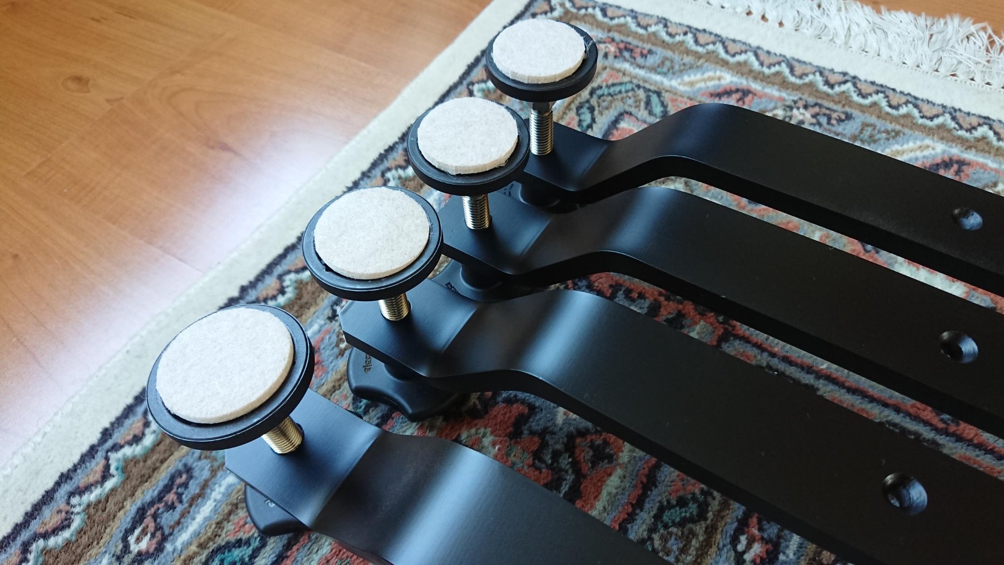

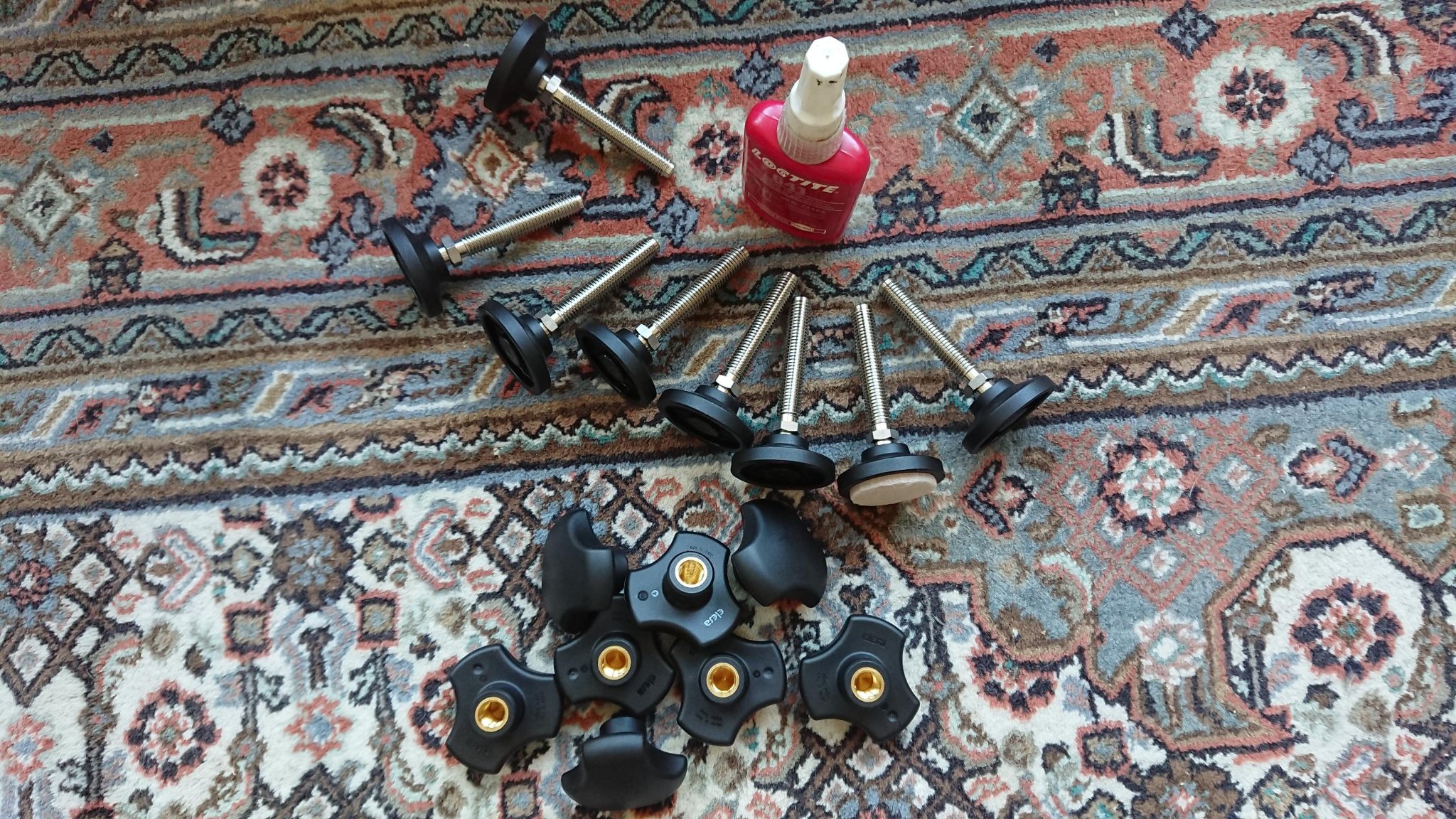

One question what model of screw feet were used for this project?
Simon
https://www.elesa-ganter.nl/stelvoe...lsb8d7u3BGgP0Ta7zzYwDKhv1FULGOgx75ejQzReprq7U

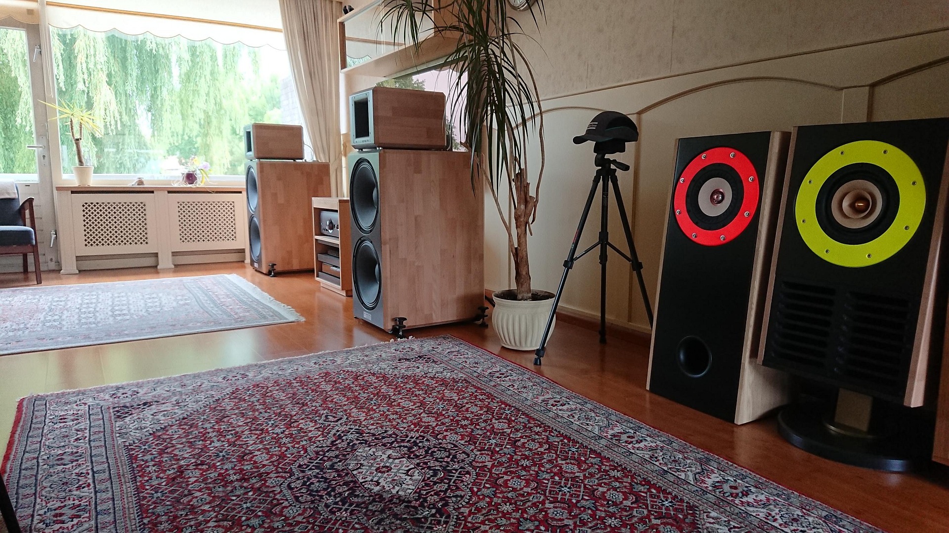

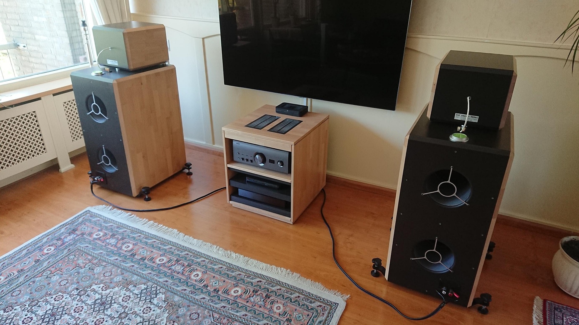

The best and most powerful speakers ever built for a living room

I like the use of the cat to absorb excess vibration. How long was the training process??

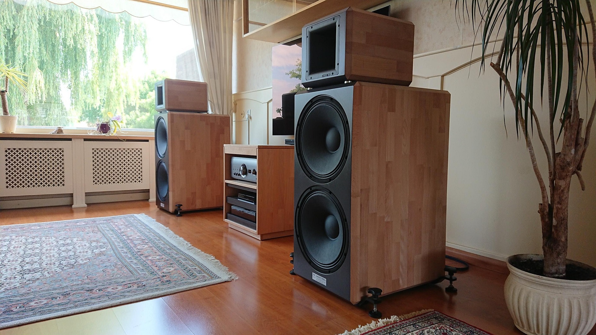

You are in Serbia? (The flag does not have the coat of arms). The stuff looks GREAT, simply fabulous. How much do you charge for shipping to Los Angeles?
The Beyma TPL-150H how are you liking the sound? The driver is like a Heil Air Motion Transformer? It seems the top enclosure is much deeper than the horn-some sonic reason? Or just matching visual aesthetics.
