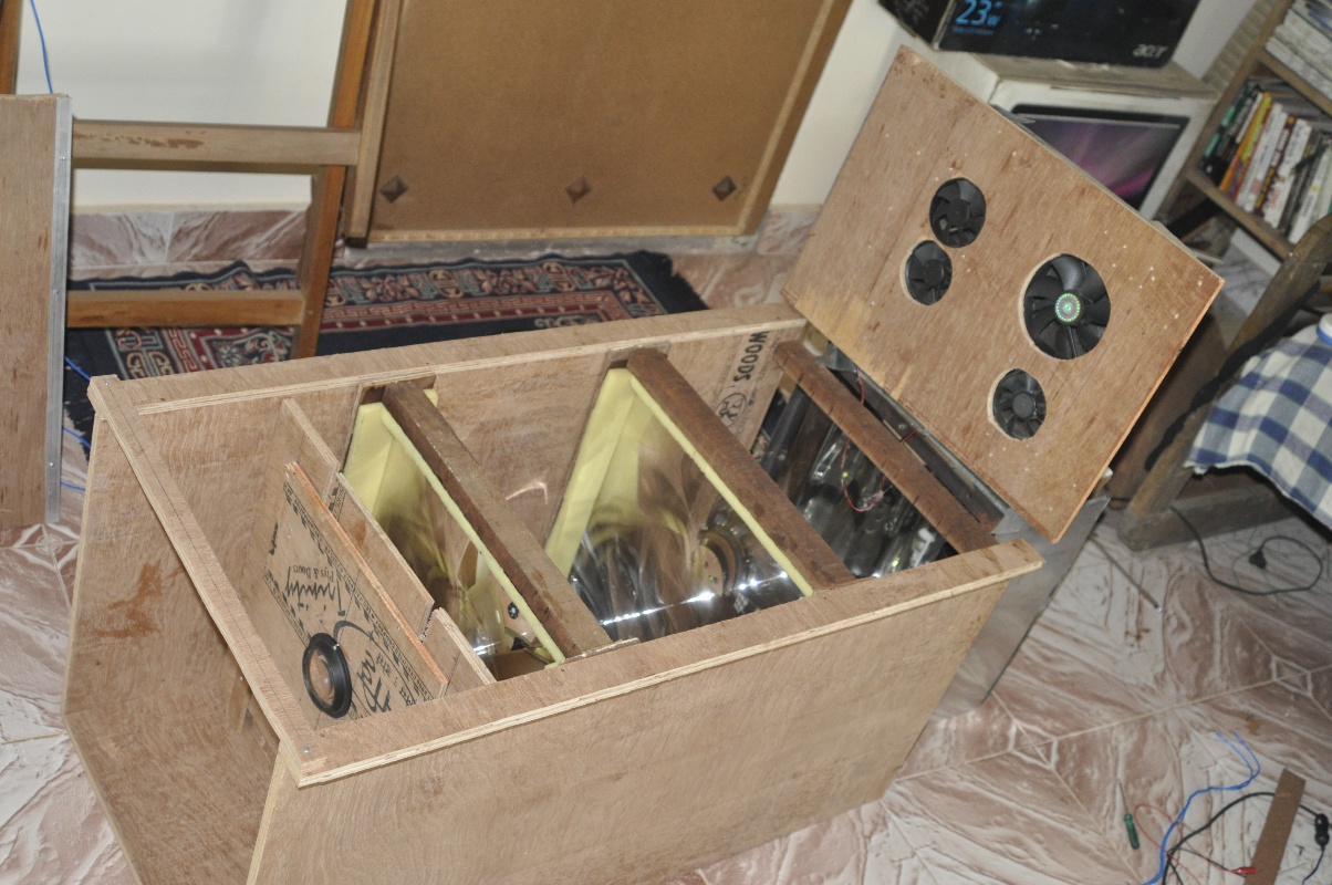

let the pics speak first.
this happens to be my third attempt and worth to share.
this time with 13.3inch ,1280x850p ( hd) lcd .
work in progress.....

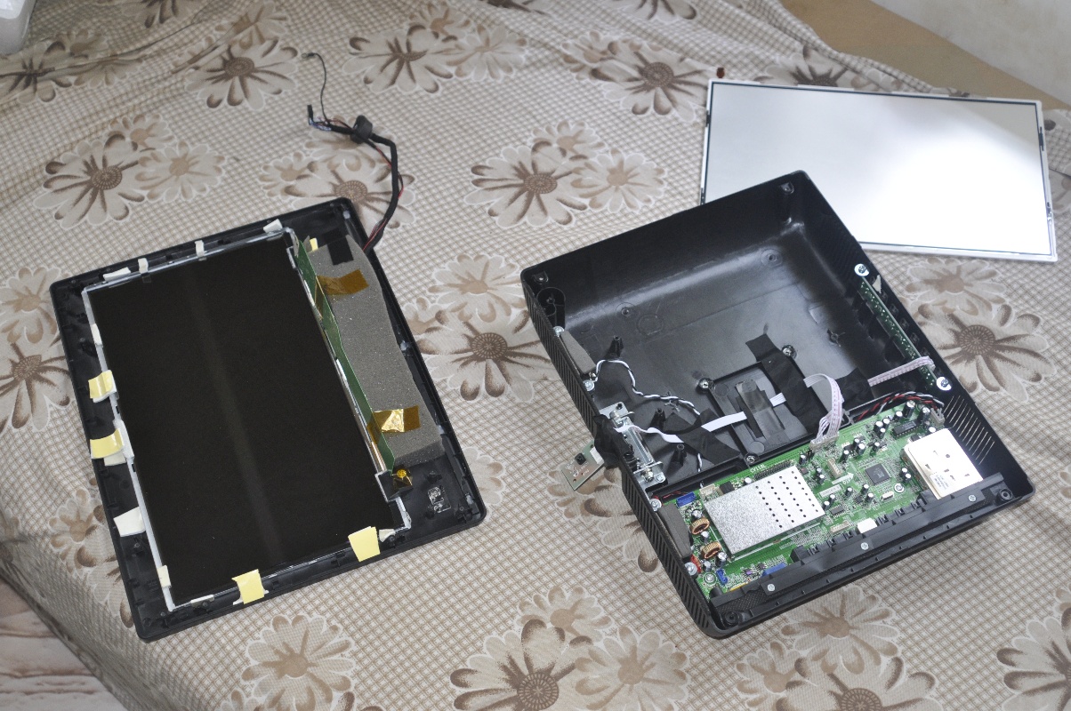

the hurdles are ,
400w MH lamp is as hot as sun. lcd display produce black spots due to heat , within seconds.
the projected image is 3 meter x 3 meter from a distance of 3 meter . too big for an average home. felt as if in front row of 70mm theater.
then i had three options,
use a 15 inch lcd monitor .
use a small chinese gaming ipad or android pad lcd which comes for 6000-9000 inr this was great idea but i cannot connect it to my present audio setup or dvd player.
then i googled and got a small lcd tv through ebay
i bought Curtis 13.3''lcd tv through ebay. it costs 124 dollars.
though it was dearer option but solved many of issues as it have remote controls,rgb inputs, blah blah.

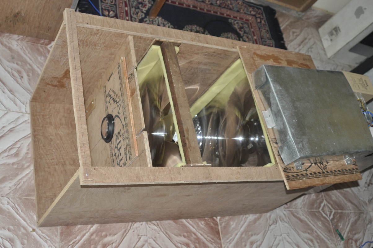

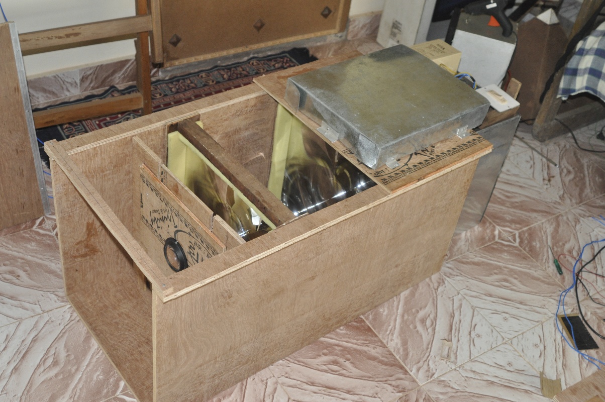

the fresnel lens are from 3dlens,330mm and 220 mm focal 40 cm wide. i think front lens of 330 mm is not sufficient i may need 550 mm for it.

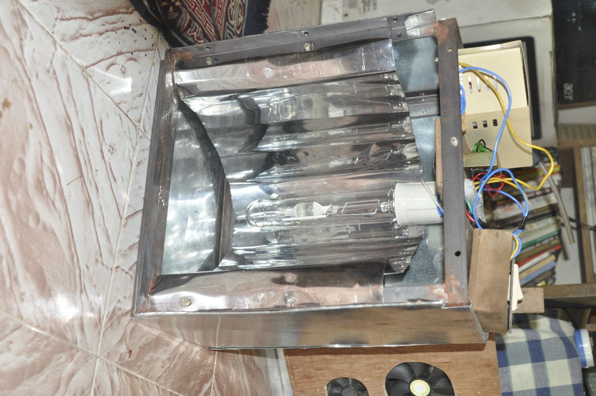

the reflector lamp shown in the figure is old one sorry for that, i uploaded by mistake.
for the reflector i used round headlamp reflector of public bus/ ambassador car. i cut the lamp hole bit larger to accommodate the mh lamp and voila light is higly focussed and intensity is stellar..good thing about car reflector is, it is metal and very shiny.
....will update regularly.

the hurdles are ,
abhineo, initially i used 7 inch (rs.3500)display. but then it was too grainy and unpleasant to watch movies.What is the LCD you are using and how much it costs? I got bad LCD and broken but thinking to buy best and cheeper for HD projection

me too faced same issues. to be clear india is not a DIY supporter in any field afaik .may it be automotive or electronics. ..sigh
so i had to order both fresnel and lcd from abroad .
got the triplet from bangalore based manufacturer.
to me 15'' lcd project became impossible and my 15'' view sonic lcd still remains in stripped condition.

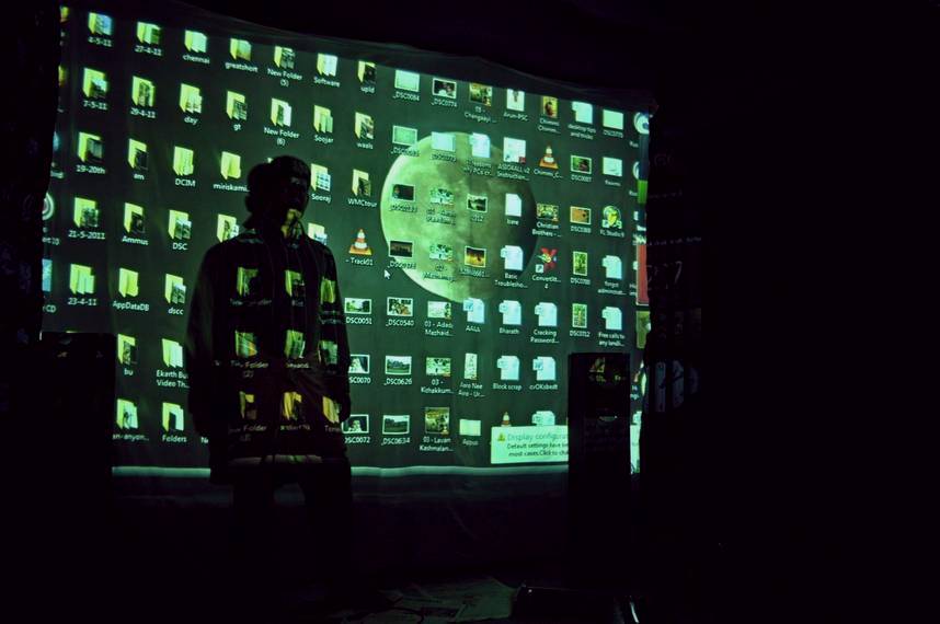

bit of updates..work in progress though...

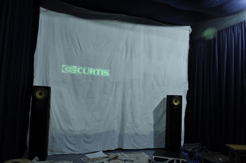

experimenting with screen.
the one i am using is ordinary cotton, it gave a bluish tint so i painted with white distember . now looking much better and brighter.
but it turned out to be opaque to sound so had to place speakers in front though subwoofers and cetre speaker still remain behind screen.
have a look at the screen size, with me standing.
quite sharp and satisfactory isnt it? (the pics look bit smudged when i resized)
note the projected image is still wider than the screen almost 1 foot on either side is on the wall. (wish i had a wider room)
so far worth the effort..!!

The result is really fantastic bro!! You can also try with Thermocol sheets am sure you will get much better result with !! coming to the point , please advice me where to face the fresenel lense in front and back side of lcd and also advice what distance should be kept between both fresenel lense and lcd !! Thanks in advance
thanks bro.The result is really fantastic bro!!
thermocol may be good for reflection but what about sound? it will completely block sound from speakers behind.You can also try with Thermocol sheets am sure you will get much better result with
in my setup groved face of both fresnel, face LCD.
collimeter or fresnel for backlight at back of lcd is at 1 inch from lcd.
at front is at 1.25 inch from lcd.(trial and error method further the distance bigger would be projection)
