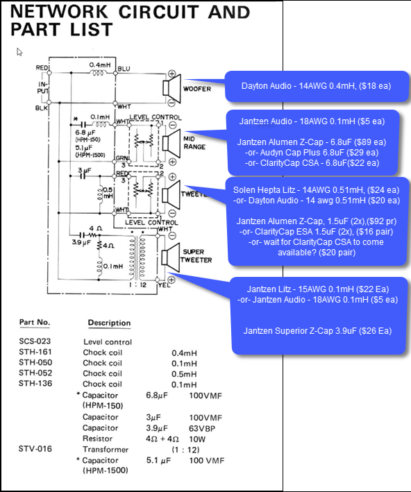

I am "Refurbishing" an old pair of Pioneer HPM-150 speakers. <Circuit below>
Am trying to follow this guy's video on YouTube: Pioneer HPM-150 Restoration Crossover He opens his bags of new parts at 3min:50s
He rebuilds an almost all new crossover from new parts (Doesn't provide the parts list...nice layouts though)
First Question:
The Inductor specification is driving me nuts. (Looking for 0.1mH, 0.5mH, and 0.4mH)
Do Ribbon Inductors (or Lintz type) even come in 0.5, 0.4, and 0.1 mH values? (Shopping at PartsExpress and PartsConnexion I cannot get a like set in Ribbon OR Lintz)
1. Are these mH values normally available -Is this the global shortage at work?
2. Is there some 'rule' around converting from a 0.4mH to Ribbon you reduce by 0.01mH <There are 0.39mH ones out there>
3. Would it change much to vary by a 1/100th on the mH value? <Take a close size>
- from reading about it seems there will be variation due to field interference between them on the tiny stock board anyhow...?

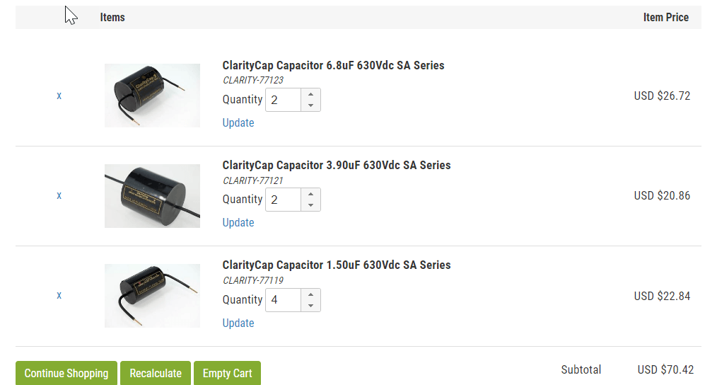

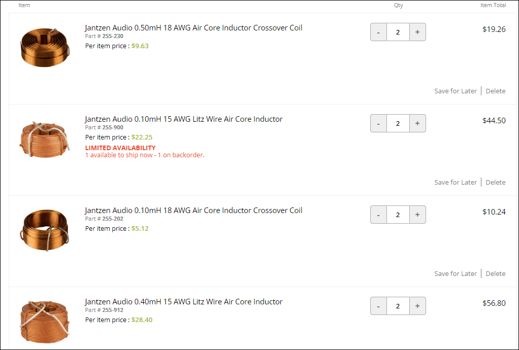

So.... Here are the Choices in Caps and Inductors. The Litz inductors are really low impedence and to be used for the Woofer and Mid (Per Link). Other two are for Tweeter and Super Tweet. + Clarity Cap SA series....running (2) 1.5uF in parallel to get 3uF
...any feedback?
...any feedback?

Any thoughts on the Clarity SA series Capacitors?
Capacitors:-
Your parts list is all wrong. Why do you want to spend money on very expensive foil or Litz wire inductors, yet list the cheapest Claritycap capacitors (SA range) with a 5% tolerance??
You should be specifying at least the ones I used i.e. the ESA & CSA ranges which both have a 3% tolerance.
Inductors:-
Litz wire for the tweeters & mids...anything above 2kHz.
Solid wire for the bass & mids...basically anything below 2kHz
See this page near the bottom of the page is a chart which shows the "Q" curves of different types of inductors...foil is too "excited"..
http://www.alkeng.com/dload_xo.html
What is better is selection of lower DCR of each inductor, & using thicker gauge wire,
For example, in my MA speaker modification thread my x-over point is 3.2kHz.....& I chose to use solid wire air cored inductors with a DCR of 1/20 of the nominal impedance of each driver as marked on the driver. I also decided to use 18AWG on the HF section.. & 14AWG on the LF section. I chose not to use Litz or foil as my drivers do not warrant the extra expense!
The LF section required a 0mH45 inductor & the driver had a nominal impedance marked on it of 3ohm. Therefore 1/20 of 3ohm = 0.160DCR.
I used a Jantzen Air Core Inductor 0.45mH, 14AWG (1.6mm dia.), DCR 0.150
The HF section required a 0mH15 inductor & the driver had a nominal impedance marked on it of 4ohm. Therefore 1/20 of 3ohm = 0.200DCR.
I used a Jantzen Air Core Inductor 0.15mH, 18AWG (1mm dia.), DCR 0.193

Based on the Inductor graph & Capacitor maximum +/-3% tolerance & Capacitor information from HumbleHomemadeHiFi =>
Then Cross referenced for what is actually available on Parts Connexion and Parts Express <Very Limited Availability> - my options are below.
What are your recommendations on the below options for a parts list <Blue>?

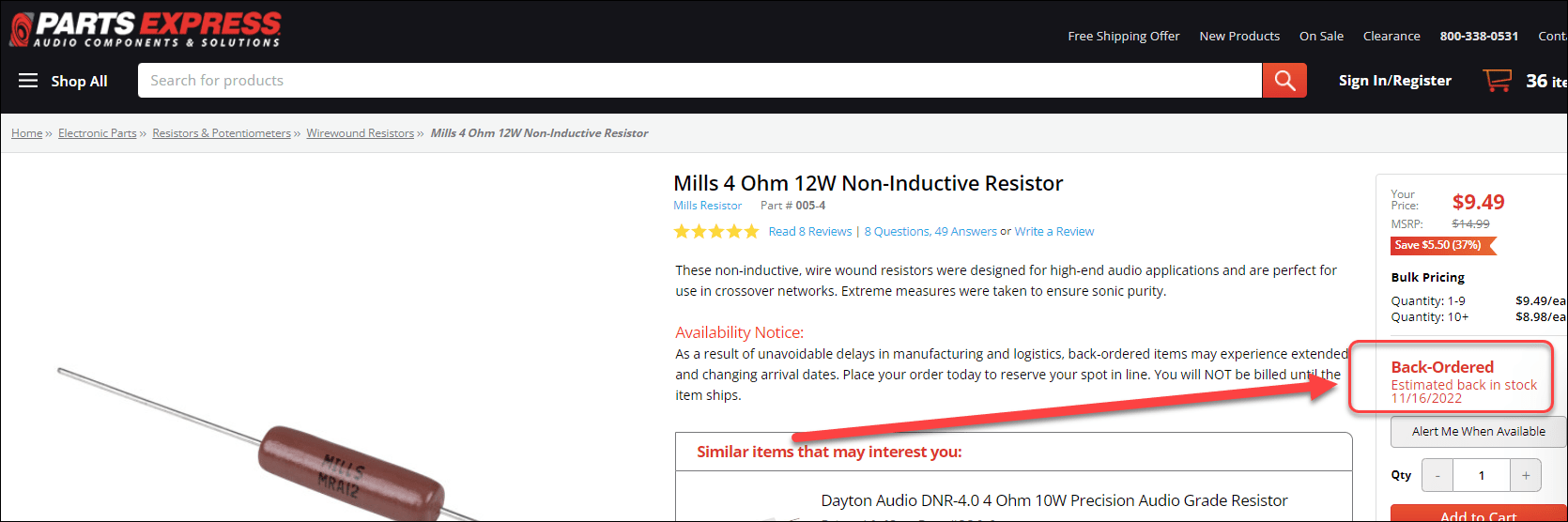

On the resistors - ok to go to 3.9Ohm? or should I work to stick to 4.0 Ohm?
4 Ohm - Not available:

Wow - Hi Fi collective does have most stuff - able to order the 3uF which isn't available over here.
Just typed 3.9ohm resistor into the search bar on hi-collectives website:-
Mundorf make a 3.9ohm
https://www.hificollective.co.uk/components/mresist-mrec10.html
They also do a more expensive "supreme" version..still only 2% tolerance like the one above:-
https://www.hificollective.co.uk/catalog/mres20080-mresist-supreme-resistor-p-4029.html
Why do you want to use 3.9??......isn't the original 4ohm??

Please double check all parts/values etc before ordering as I made this list quickly & didn't double check...
According to the web your speakers have a nominal impedance of 6.3ohm & cross-over points of 750Hz, 2.6kHz, & 8.5kHz
Woofer:-
Inductors:
Jantzen 000-0050, 0.4mH air cored inductor 14AWG, DCR of 0.14, dimensions of 50mm x 25mm
https://www.hificollective.co.uk/catalog/000-0050-0-4mh-jantzen-air-core-wire-coil.html
Or go thicker wire
Jantzen 000-0829, 0.4mH air cored inductor 13AWG, DCR of 0.11, dimensions of 56mm x 30mm
https://www.hificollective.co.uk/catalog/000-0829-0-4mh-jantzen-air-core-wire-coil.html
Mid Range:-
Inductors:
Jantzen 000-0002, 0.1mH air cored inductor 14AWG, DCR of 0.067, dimensions of 35mm x 25mm
https://www.hificollective.co.uk/catalog/000-0002-01mh-jantzen-air-core-wire-coil.html
Capacitors:
ClarityCap ESA 6U8H250V, ESA 6.8uf 250Vdc capacitor dimensions of 28mm x 33mm
https://www.hificollective.co.uk/ca...dc-claritycap-range-polypropylene-p-7313.html
Tweeter:-
Inductors:
Jantzen 000-1401, 0.5mH air cored inductor 18AWG, DCR of 0.33, dimensions of 40mm x 15mm
https://www.hificollective.co.uk/catalog/000-1401-0-5mh-jantzen-air-core-wire-coil.html
Or go Litz:-
Jantzen 000-L-0050, 0.5mH Litz inductor 15AWG, DCR of 0.23, dimensions of 53mm x 30mm
https://www.hificollective.co.uk/catalog/000-l-0050-0-5mh-jantzen-litz-wire-wax-coil-awg-15.html
Capacitors:
ClarityCap CSA 3UH250V, CSA 3uf 250Vdc capacitor dimensions of 27.5mm x 28mm
https://www.hificollective.co.uk/catalog/csa2-030-3uf-250vdc-claritycap-csa-range-polypropylene.html
Super Tweeter:-
Inductors:
Jantzen 000-1234, 0.1mH air cored inductor 18AWG, DCR of 0.120, dimensions of 35mm x 10mm
https://www.hificollective.co.uk/catalog/000-1234-0-1mh-jantzen-air-core-wire-coil.html
Or go Litz:
Jantzen 000-L-0010, 0.1mH Litz inductor 15AWG, DCR of 0.09, dimensions of 43mm x 20mm
https://www.hificollective.co.uk/ca...ire-wax-coil-awg15-7x-05mm-diameter-wire.html
Capacitors:
ClarityCap CSA 3UH250V, CSA 3.9uf 250Vdc capacitor, dimensions of 31mm x 29mm
https://www.hificollective.co.uk/ca...50vdc-claritycap-csa-range-polypropylene.html
Resistors:
Mills RES-M1130, MRA12, 12W 3.9 Ohm resistor 1% tolerance, dimensions or 8mm x 32mm
https://www.hificollective.co.uk/content/res-m1130-3r9-12w-mra12-mills-resistor-39r
Yes its not a 4Ohm, but with such a tight tolerance range of 3.86 to 3.93 Ohm..thats better than a 4 Ohm with 5% = 3.8 to 4.2 Ohm
Or you could stack a 1.8 & 2.2 ohm....& you might only need the 5w versions as its the supertweeter..whats the wattage of the existing resistors???
Wattage of existing Resistors is 10watts. I wasn't finding a 4 Ohm resistor that wasn't sold out. I like the 3.9 Ohm Mills with the 1% tolerance - good point.
HiDave : For the mid-range Capacitor - you spec'd 6.8uF ESA - there is a 6.8uF CSA available - a particular reason you spec'd ESA here, or should I go with the CSA?
That pretty much rounds out the list - going Litz for the Tweeter and Super Tweeter.
