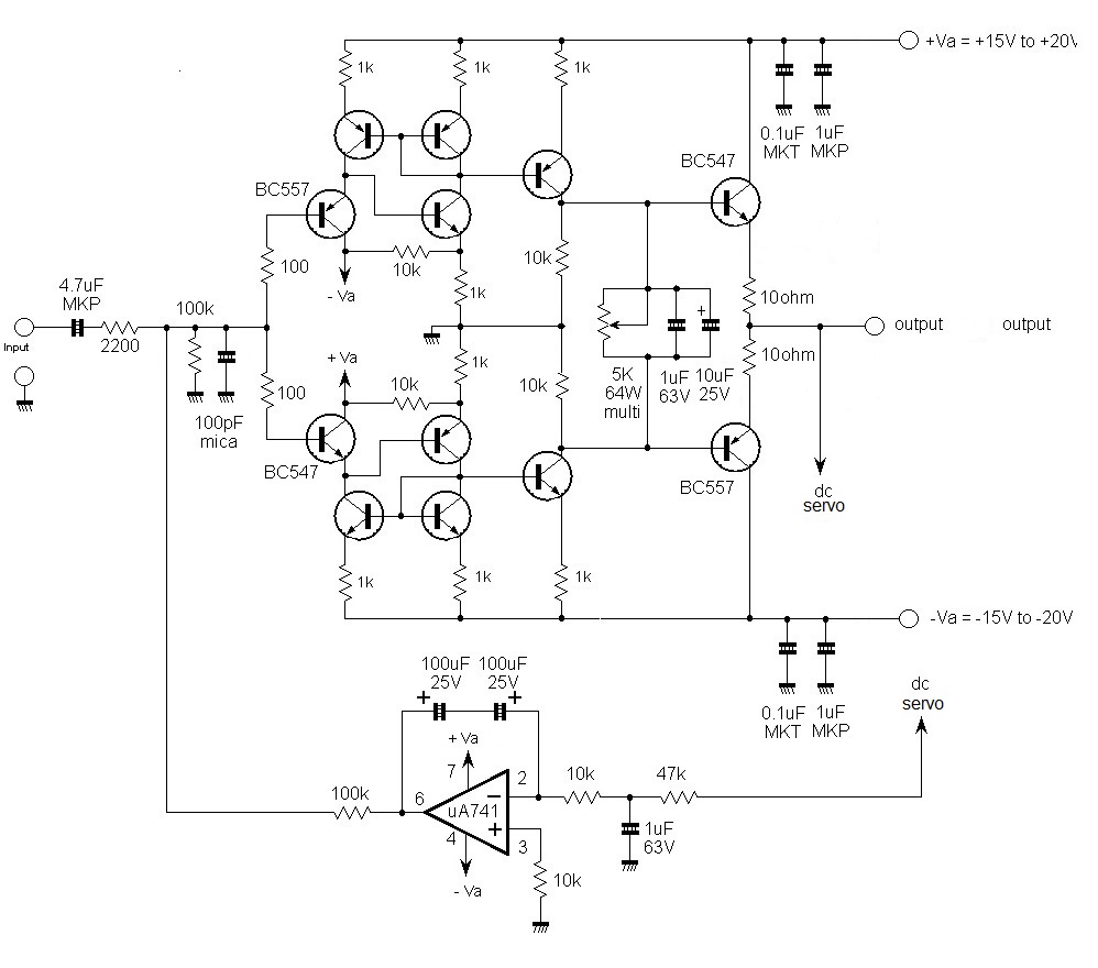

This is Ciuffolli's Pioneer Super Linear as a line amp.
All through hole, no unobtanium.
The 5k trimmer is used to set bias.
But do simulate first before building.
Real excellent performance as a headphone amp.
The Pioneer Super Linear Circuit
DC servo not necessary, in my experience.

Hi Patrick,
No problem. We are talking about an alternative to that kit. All the parts are available and also easily substituted.
I would suggest that using increased bias current to optimize the distortion performance would be reasonable, removing low current draw from the design requirements.

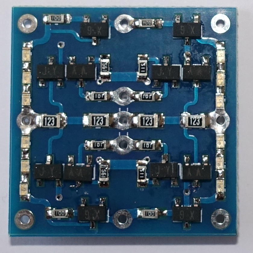

How does everyone feel about a surface mount version? All the current devices that are good seem to be in this format.
-Chris
Hi Chris,
I’m good with the direction your taking 😉
Actually, I’m starting to prefer projects with smd.
(Not interested in a headphone amp though)
Per Chris' comment any objections to 1206, 0805, SOT-23, SOT-223 packages? LSK389 is available in SOIC-8 which is what I have been using in my discrete op-amps.
I was considering using the Cordell Dh-220c front end design and doing it in smt. It is a premium using lsk489 & lsj689 but it has the advantages of being a symetrical push-pull design. Having a dc servo means very low offset and DC coupling, no caps at least on the o/p. Then there is a opa1656 which is your new base line to determine is a discrete design necessary at all these days for low levels. What gets me is why a pre-amp with gain is needed at all. What source levels are you dealing with? Do you only need a buffer or gain too? I was thinking all I need these days is some source switching and a attenuator for each channel in my power amp.
If you are new to smt use 1206, 0805

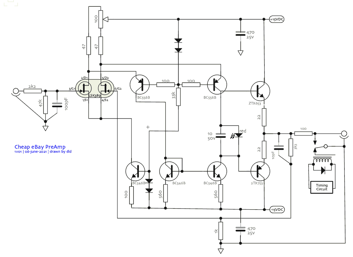

Someone else pointed this out originally so no credit to me, but the 47K resistors are not the correct value, the tail current is supposed to be 6 - 7mA so each of those resistors should see roughly 3 - 3.5mA from the fets and some additional current from the cascodes. The voltage at that node is set by the two diodes and the pnp cascode vbe. The voltage across those resistors and pot cannot be more 0.7V. I suspect those two resistors actually should be 47R. Total current for the fet and folded cascode would be in the vicinity of 7mA per side.
