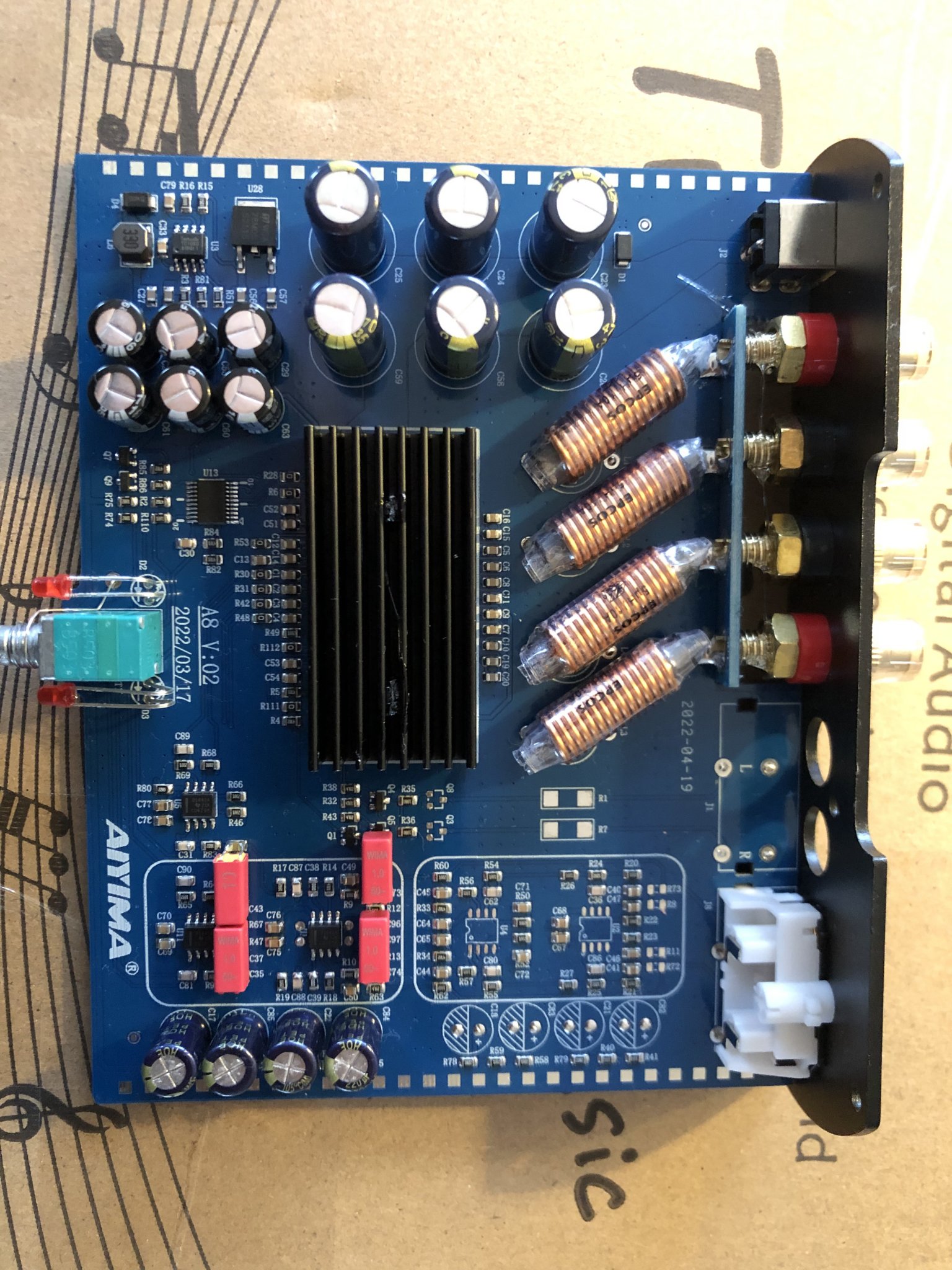

The STA326 was 24-bit DDX® 32 kHz to 192 kHz input sample rates, 96 kHz internal processing sample rate, 24 to 28-bit precision, ternary PWM output, [master gain/attenuation + dynamics control attack/release + auto volume-controlled loudness], digital gain/attenuation (+48dB to -80dB)... but most important (for me till now) was the digital I2S input (monochip true FDA, from digital inputs to PWM output)..../...STA326 were OK but it probably has been superseded by newer technology?! It is 16/44.1 limited I recall (or something like that). MA12070 (so with analog inputs) is one of the better class D chips at this time it seems..../...
My brother has a benchmark ahb2 + Gustard X16 DAC : My super tweaked STA326 is (way) more noisy, less detailed, but as balanced and nearly as pleasing to listen to (and more pleasing to listen to at low volume).
Nevertheless, i'll try the A8... (have to find a good inexpensive DAC with IR remote control).
STA326 have terribel noise.

The biggest problem with the STA326-era devices is that 24 bits of precision for the coefficients is inadequate at low frequencies. When you do the bilinear transform to generate the coefficients for the biquads, you end up with very small numbers for low pass filters (such as DC blocking or "rumble" filters). Most of those 24 bits are placeholder zeros after the decimal point, and there are just a few significant digits, resulting in quantization errors. As a result, the older Apogee/ST devices aren't going to measure as well, even though the chip can sound very good if used within its limitations. A lot depends on how the filters are configured during measurement.
ST addressed this issue starting with the STA311 chip, which adds another stage to the biquads to provide additional filtering. You can see that extra filter stage and ST's explanation on page 69 of the STA311 datasheet: https://www.st.com/resource/en/datasheet/sta311b.pdf. However, a better way to address this is to use more bits for the coefficients. For example, the ADAU1701 uses 28 bits and the ADAU146X series uses 32 bits. I can't see how many bits are used for coefficients or calculations in the MA2304DNS from the data posted on the Infineon web site.

I didn't realize enough that in 2.1 the 2 SE channels would have clean ~ 3 watt into 8 ohm from 24v supply, that might be enough sometimes, I don't think it leaves any room for dsp corrections ??
With relatively high efficiency loudspeakers one rarely plays at higher levels than 1W (full range that is). Open for debate of course but I never needed more powerful amplifiers than 10W ones. One better has some current instead of voltage 😉
The drawbacks of high power amplifiers are too many to justify their perceived necessity in many cases. Not all but many.
I agree the 3 watt SE MA12070 won't do, but even when going for two MA12070's ampchips or ampboards, the 13 watt BTL with say ~79dB efficient speaker from my "Isetta" example wouldn't be excessive 😀
Please explain the 3W SE MA12070, I missed the "SE" to be honest. Why would you do that when one extra chip is required for desired performance? Ha I see you edit on the move 🙂 Just like me.
I looked at 2.1 implementation for something like the Paul Carmody "Isetta". MA12070 with 8 ohm speakers in BTL and from 24v supply can deliver 2x12 or 2x13 watt before clipping. SE power is 1/4 of that. So for Isetta I would have 2x3watt and 1x30watt (BTL 4 ohm before clipping, the chip likes lower ohms/heavier loads so it seems).
