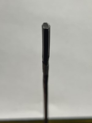

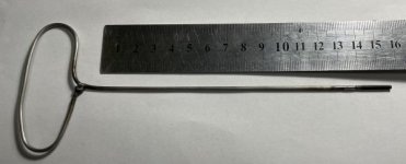

To disassembly Topping PA3s (MA12070) you need long (at least 14-15cm) thin 2mm hexagon key (front panel is screwed from the inside), use it through the rear screw holes. You can make it yourself from scraps of any small 2mm wrench by welding a long handle if it's difficult to find such size in local stores.Maybe a bit offset question: Can anyone tell me how to disassemble the topping PA3S ? So far I removed the back plate, the board slides out about 2 inches, then??? On the front side I do not see any way to remove the panel..... To get the PCB out the connector from the front plate to the PCB must be disconnected, but how? Any help would greatly appreciated.

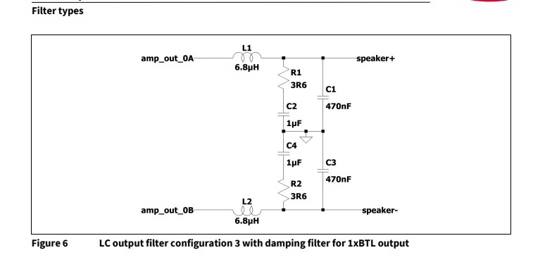

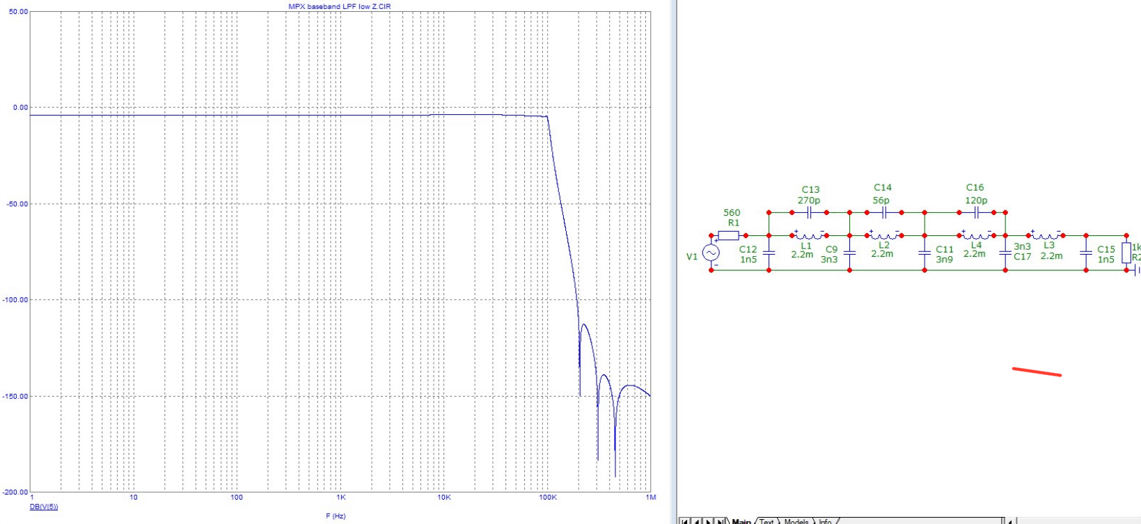

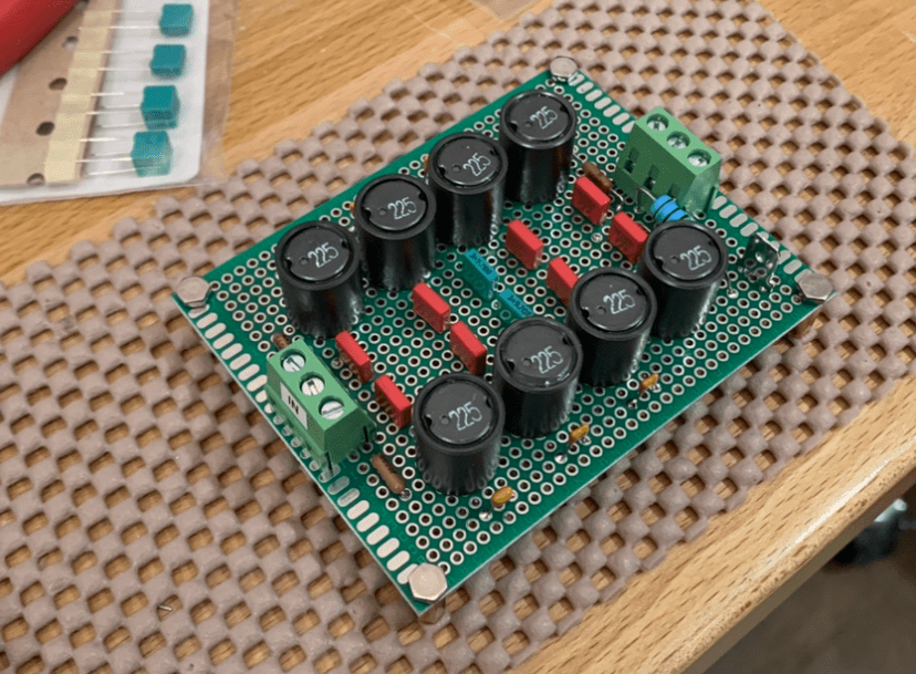

Yo need to use a balanced input attenuator helper board connected to XLR input of audio interface. Make sure not to let ground shield connect to speaker output. There is a circuit I used described in the REW distortion measurement thread. For Class D amps, you also want to use a passive brick wall 100kHz filter to prevent aliasing the data in the FFT.I tried to measure a board like that with an pc oscilloscop this week. Smoke😢
Grounded both input and output to same ground was the mistake i suspect?
But since you like it. Maybe I will order another one and measure with floating output.
Filter:

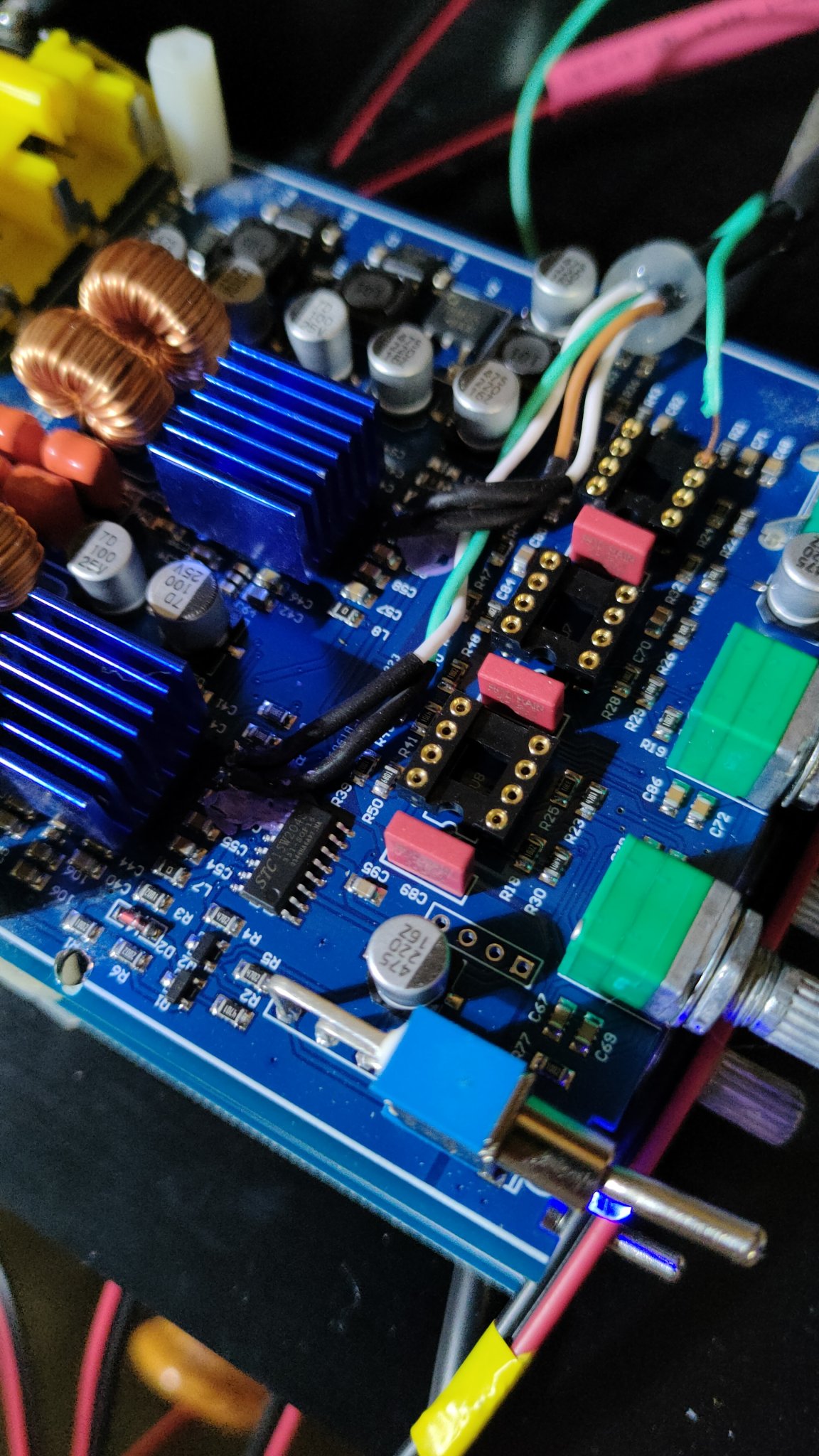

If you don't bypass the opamps you will not get close to the potenial of these Boards. The way I use them they are better than the Accuphase E303 I owned. With a differential signal straight to the input pins of the Merus Chip, you get stunning performance. I never gave any sonic impression of these boards in stock form so please don't blame me for suggesting these boards if the sonic result is just mediocre.
It is planned to remove the entire preamplification part...If you don't bypass the opamps you will not get close to the potenial of these Boards
It's still in progress...
The multichannel dac (balanced) on the right in the photo will be connected directly to the inputs of the chip with a balanced signal !

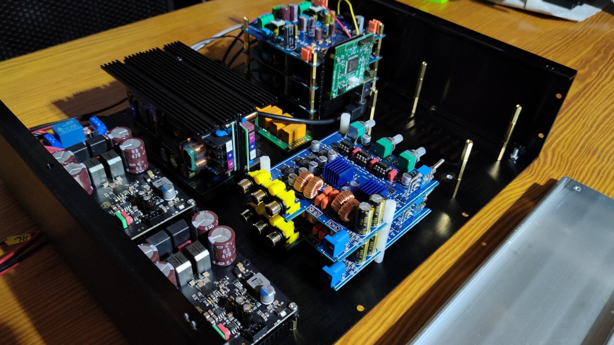

Have you figured out how to flash MCU STC to setup PMP2?I finally had time to modify one amp board!
The sound is really good! direct coupling to balanced DAC output, without coupling capacitor.
No breath, nothing! Despite the gain which seems high to me (no signal attenuation).
Thanks Radian!
No, sorry...It works very well like that.😉Have you figured out how to flash MCU STC to setup PMP2?
If MCU is here - i think that china's guys are already set itNo, sorry...It works very well like that.😉
I made first upgrade in this amp, sounds better )

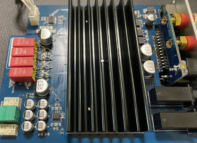

Anyone tryed to add input common mode filter? I assembled and installed the recommended common mode filter 2x100μH + 100nF NP0 capacitor and got worse results. I also tried adding a 220nF film capacitor. The sound became more soapy, less clear. I test it with dell 130w PSU from liteon and this PSU have hisown common mode filter on output, and i do not meassured it. Do you have any idea?

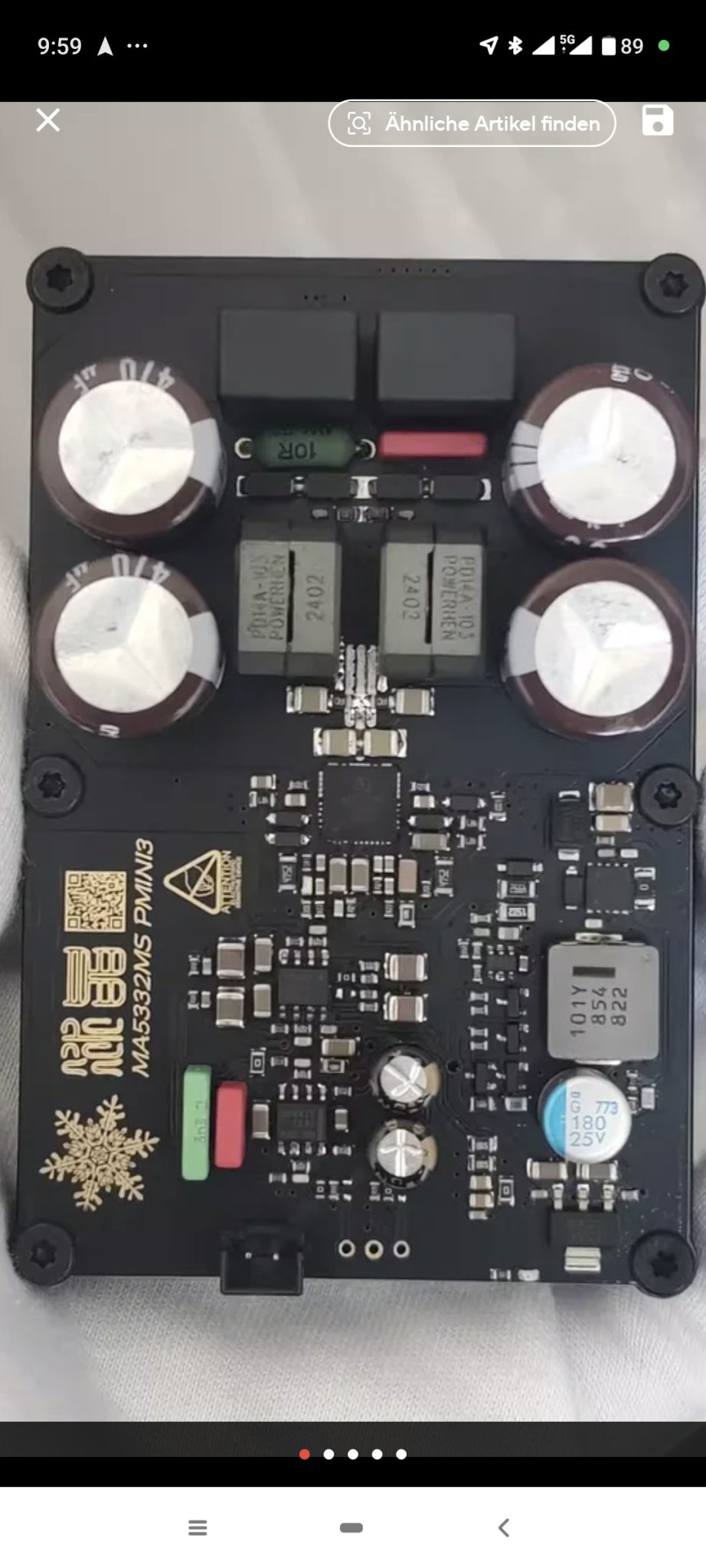

I have 2 of these boards...symmetrical entries.I ordered MA5332 mono boards
The quality of the components and assembly is exceptional!
Huge sound across the entire spectrum and surprising clarity (all the details are there), better than any TPA and ice power I've tried.....
This is huge for a 7mm x7 chip. Neutral amp, quality DAC and high resolution files required!
