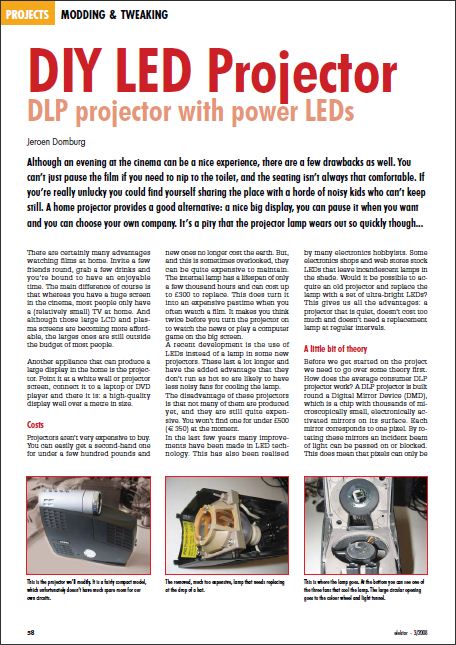

Wierd that...anyways try the link below. It is an article of a commercial projector modified to work with power LED and CPU Heatsink which has had the colour wheel removed and synchronised with the LED's. Check the attached thumbnail. If it don't work then please name me a good file host.
PS: what would happen if I deliberately broke a lamp burner. Would it explode as I hve heard they have a lot pressure. My lamp burner is just not coming out. :(
DIY LED DLP Projector Article

I've read that article.....the brightness is very low. To get the lamp out.....take a nail or something hard and pointy and chip out the white cement holding the back cap on then give it a twist with some pliers. Then chip out the cement around the lamp and it will fall out.
