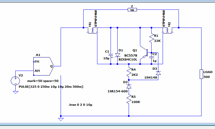

Started on a dry run without the mosfets to get the timing right. (but diodes where the mosfet drain/source diode would be).
R5 100k and C1 10uF , is way to quick and the mosfets will turn on too soon.
I put 5x 33k =165k for R5 and 31uF for C1 , that seems better.
The R4 of 2k2 didn't have enough voltage over it to keep the Q1 off. So with 4k7 I
get -1,9 V BE. I also put 100 ohm from the collector to the "ground" , to limit
current to 90 mA max ( zener voltage 9,1V) .
As far as I can judge it takes much longer than 1 missing period to get Q1 conducting and the voltage to go below mosfet threshold , or the time it takes to drain 31uF with 100 ohm. I may use the BC807 , with lower than 100 ohm. It can take 500mA.
What I'm not entirely clear about is C2 . Is it there too to smooth the ripple at the
base.
You say in post 18 that 'as soon as a cycle is missing, it makes the transistor
conduct and discharge C1'
Doesn't the transistor only conduct after C2 is discharged until it is around the
needed 0,6 V for Vbe ? So the transistor will conduct and shut the mosfets down
after the 1uF x 33k goes from -1,9 V to 0,6V.
Lowering C2 will make the transistor conduct quicker ?

From the info I posted earlier, I gather that the turn-on delay is ~3 mains cycles, around 60ms.R5 100k and C1 10uF , is way to quick and the mosfets will turn on too soon.

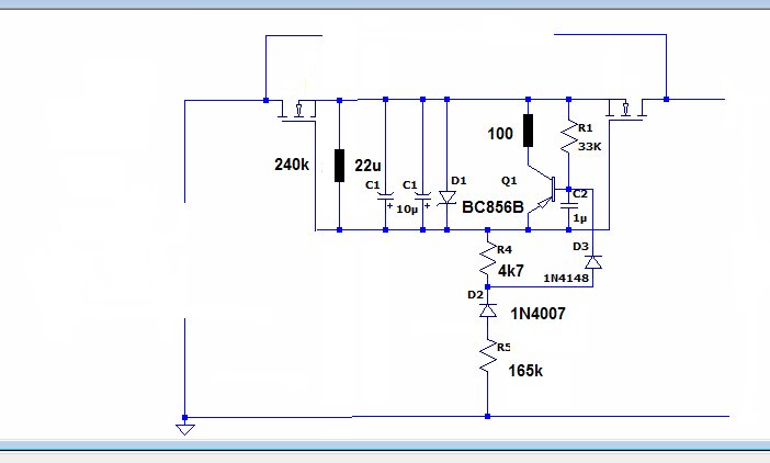

If you change one component value, the others need to be scaled in the same proportion:
Logic, but the 100 ohm is probably not necessary, as the base current is limited anyway.The R4 of 2k2 didn't have enough voltage over it to keep the Q1 off. So with 4k7 I
It might impair the later stage of the discharge, and should probably be removed
A larger cap will need a larger discharge current, but everything is linked, and the first thing to do is to decide the turn-on delay value you want.As far as I can judge it takes much longer than 1 missing period to get Q1 conducting and the voltage to go below mosfet threshold , or the time it takes to drain 31uF with 100 ohm. I may use the BC807 , with lower than 100 ohm. It can take 500mA.
Once this is decided, the rest will flow naturally, but making spot-changes here and there will not work: the circuit is a whole, and all the aspects are interdependent.
If you need a large turn-on delay whilst keeping the one-cycle reset, it might be necessary to use another type of transistor, like a small PMOS.
It prevents the transistor from permanently discharging C1. If it is too small, C1 will be discharged even when there is no interruption, and if it is too large, it will increase the reset delayWhat I'm not entirely clear about is C2 . Is it there too to smooth the ripple at the
base.
Yes, but as I said above, making C2 too small will make it conduct at times when it shouldn't.Lowering C2 will make the transistor conduct quicker ?
First state your requirements, mainly the turn-on delay, and we will see how the circuit can be adapted.

Yes but these transistors have a big Hfe , so even a small base current may not be enough to limit the collector surge current. Bipo's can't take short surges like mosfets can.
Indeed at less than around 1 V , it discharges much slower , it's more the 240k bleeder that takes over.
Timing without a digital oscilloscope , is difficult to see , I just look at the bargraph on my fairly fast Fluke. Although the goal is to avoid the very short inrush current , I think a delay of around 0,25 to 0,5 sec is best but it goes fast past the 2,5-3 V mosfet gate treshold and then more slowly to the 9 V.
The 1 missing cycle discharge is not necessary , but no more than 10 = 200ms .
Like it is now with these components , it seems more and changing the transistor to BC807 with only 22 ohm is not going to change much.
Maybe putting the gates not on the full 9 V but with a resistor divider on a lower voltage.

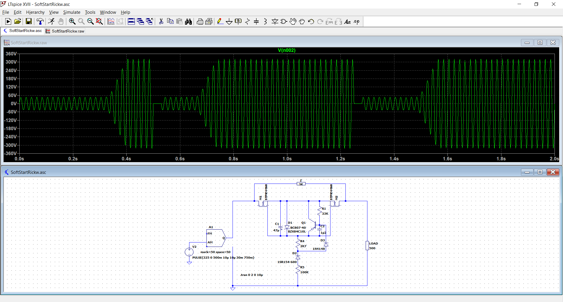

This is the circuit adapted for a longer delay.
The problem now, is that the gate voltage is rising more slowly, resulting in a "ramping" conduction for a few cycles.
If the SOA of the MOS is not sufficient, they will be blown.
One would need a snap-up action somewhere, but this would complicate the circuit.
No discharge resistor is required, because there is an implicit R1/Hfe resistor in the circuit

Not much difference . You went for higher current and a bigger 47uF.
I'm going with less than 3k for Z , so the voltage will be higher than 50 V and for
longer so the cap behind the rectifier in the SMPS will be fuller , those 3 periods of
ramping up with higher voltage should not be not a problem ... I think. But then
again the negative resistance of a SMPS input is tricky.
I have the Rohm R6030ENX , 2 for about 3 $ . Tested them , high treshold that
starts at 2,5 V , but really starts to matter at 2,8 V , so pretty high , not like the
1,25 V of a 7002. Data sheet doesn't show a SOA.
I connected them today but still without the Z bypass , and a subjective view of the
voltage rise on the bargraph , looks as if the delay maybe good enough and the
discharge too.
I do measure -1,9 V between the 9V line and the base but with a 1,2 V ac ripple.
Not keen on a higher value for the C2 . I have these short 0,5 to 2 sec power drops/cuts and I want to be sure the mosfets are off then . Your simulation shows the discharge in 1 period and I calculate with 1 uF and 33k and a voltage difference of about 2,5 V a 10 ms , so that is close.
Even if I had my frequency counter here that can measure time intervals between 2
inputs , it would still be impossible to connect it to the 230V mains to be sure of the
timing.
I guess the ultimate test will be trying it with a fuse and see if it blows because even
if there is no arc while plugging in , there still can be a big current.

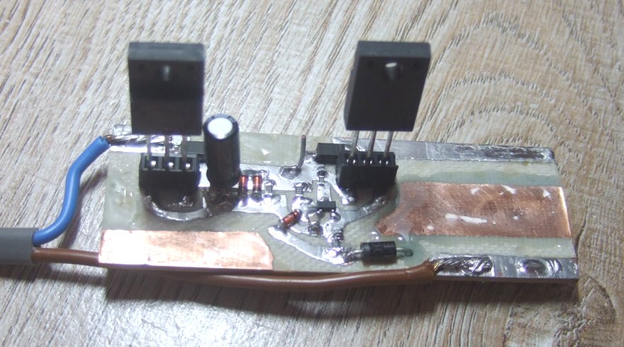

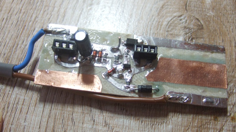

Here's pics of the PCB , with and without the mosfets : (the 33K x5 are on the other side)

Time to put the mosfets back in , and here it really paid off to use the lamp . I can
clearly see the the < 0,5 sec step between the 450 ohm or the open mosfets.
Then the WD , that is a real sparker/arcer , tried many times no sparks , no arcs ,
not that typical sound .
I'm happy with the circuit , but the neg resistance of SMPS is a bother.

Ok , today the tests with current limiters . First my idea is using a lossless resistor : a 1uF X2 cap.
25W lamp 70Vac just lighting up , no problem.
With a a small nokia phone charger no load (235V) and max load (500mA 6,3V) at
173Vac , no problem.
Then a WD (western digital) external HD supply 12 V 1,5 A , no load no problem ,
with a 12 ohm resitor and a 100mA fan , doesn't work. The ac voltage oscillates
between 50 and 200 V , and a low variable dc voltage on output . The 1 uF is
definitely out , unless you start de SMPS with very low or no load.
Next 1350 ohm with 3 x 450 ohm 5W resistors.
Lamp gets 118Vac , 38V over each resistor , so around 84mA= 3,2 W/resistor.
Nokia 203Vac , again with max load 500 mA at 6,3 V ( ~3 W) , ok.
WD with only the fan (100mA) 218Vac , again with 12 ohm + fan =1,1 A (around 13 W) no go , still oscillating between 50-230 V.
So 1350 ohm is still too high.
Tried 900 ohm , WD with 12 ohm load , no , the same oscillating.
450 ohm : WD with 12 ohm and fan : 197 Vac and 11,87 Vdc = the same as
without the 450 . So this works for 13 W output.
