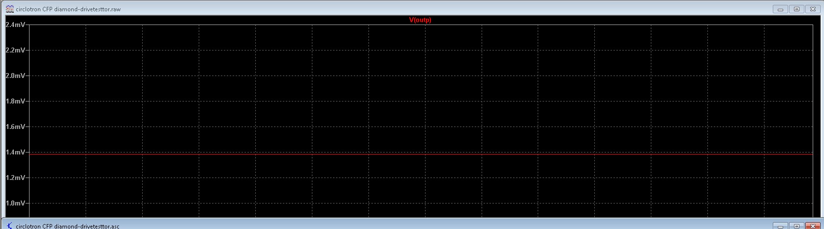

Hi kees,... the transistor models are not acting as a paired transistor and does cause the offset unbalance, this driver needs paired transistors on some places. Maybe there is a way to set LTspice for this.
Try defining perfect complements using the ako: statement (a kind of)
eg matching PNP 2N5401 to the NPN 2N5550, use:
.model 2N5401_ ako:2N5550 PNP
(place statement on your circuit or in your .include ... model file)
then change all the circuit instances of 2N5401 to 2N5401_
The underscore in "2N5401_" is needed so it is a different name to the already defined "2N5401".
Repeat for all other NPN/PNP complements.
In LTspice, (any simulator) if you place two transistors with the same type, they are perfectly identical, much better than any practical matching can achieve.
Unless you deliberately modify the models to make them different.
Jan

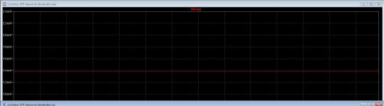

If you use the same model for several transistors, the transistors are all perfectly matched because they all use the same model. They are identical.
You can even perfectly match NPN to PNP with the technique shown by Ian above.

I did, it works, so I can design the driver on a better way, more real.
I have gordell models, so use the 2n5401_gordell in the tekst, I use models from the .cmp tekstfiles .bjt or .njf dit set more models into that tekst and pick there the transistor after first put a standart pnp in schematic. maybe that is a less better way?
Oke now I can setup the bias system, without first to cancel out much volts before it go right setup.
Thanks you guys.

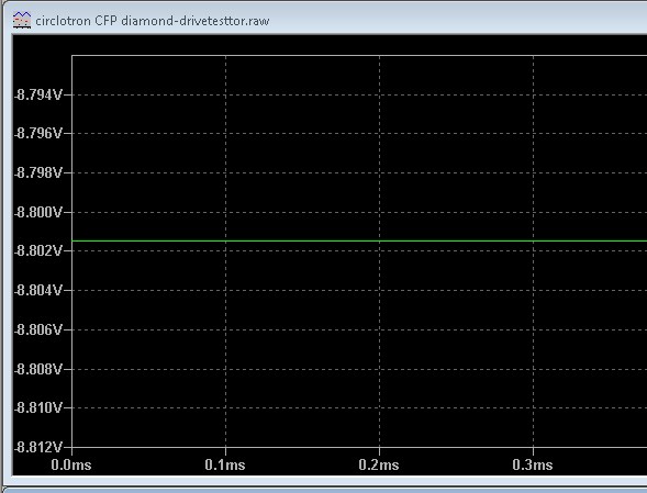

Oke, now I have tryed KSA992 and KSC1845 from X did put underscore to KSA992 and the rest as said.
Unfortanely this trick does not work here, get 8 volts offset, but it works perfectly with the 2n5401 and 2n5550 transitors. So what do I missing here.
So model has influence on this? afcourse these are important.
regards
regards
This problem with pairing transistors did only work with the 2sa970/2240 and 2n5401/2n5551.

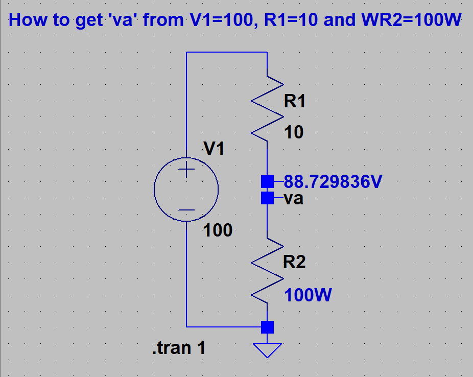

O.k. eggheads can you please solve this for me, it escapes me completely, what am I missing, it seems so simple...
The voltage shown is correct but was obtained by manual iteration 🙂 (e.g. the hard way)
Egghead is not a very friendly way to address people.
You have not specified the value of R2
Hans
Hans
