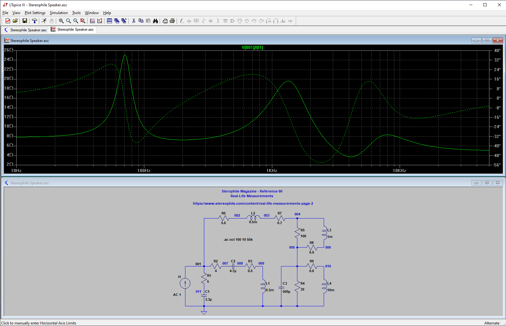

I'm helping a member with an active crossover on another thread. I feel it would be helpful if we could create a source for AC analysis which specifically has a non-flat level vs frequency, and phase which may contain non-minimum phase components, so that the behaviour of a speaker could be added to that of the crossover, without having to reverse engineer a circuit to do the same.
Sterophile Magazine developed a circuit that simulates a typical two-way sealed-box 8-ohm speaker. The circuit was published in the August 1995 issue. Here is a link to the article; see the second page for the revised circuit by John Atkinson.
Real-Life Measurements | Stereophile.com
Attached is the circuit drawn in LTspice. As shown, the simulated speaker is driven with a current source so that I could plot the impedance curve. But the node at the current source can be used as a signal voltage source that would vary according to the impedance curve. This might not be exactly what you want but maybe this will give you a few ideas.
Without the current source, the nodes 001 and ground represent the speaker terminals. I often use this "speaker" to test as a load with power amplifier designs. That's an approach to consider as well. Attached is the subcircuit SPICE model for the speaker, along with a symbol file to match. You will need to rename the symbol file to speaker.asy before you can use it.
