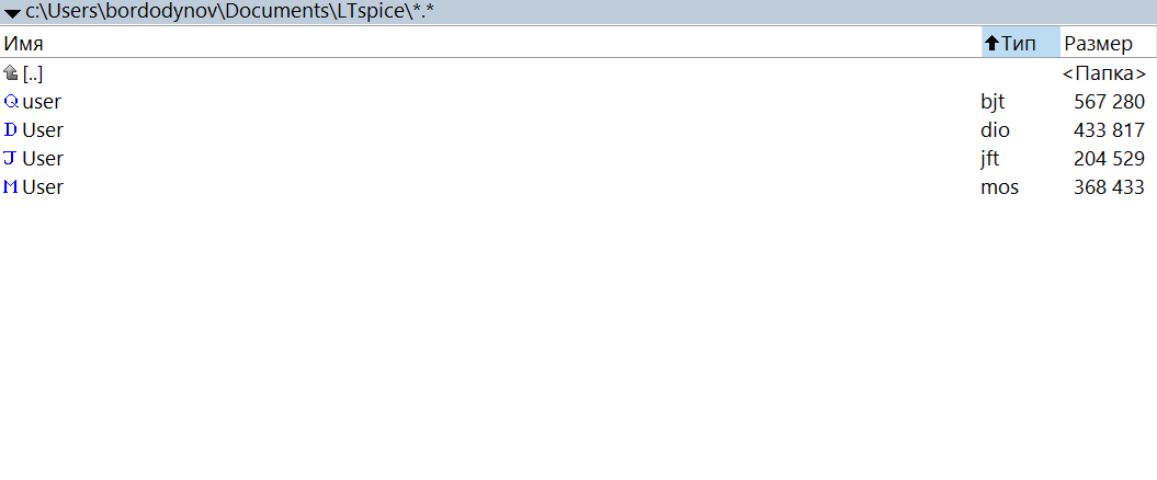

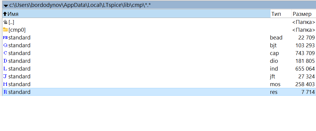

LTspice 24 has dramatically changed the approach to Standard.*** files.
So change (rename) your Standard.* files with your models to User.*. Then put them in a different location.
I will show you how I have done it.
